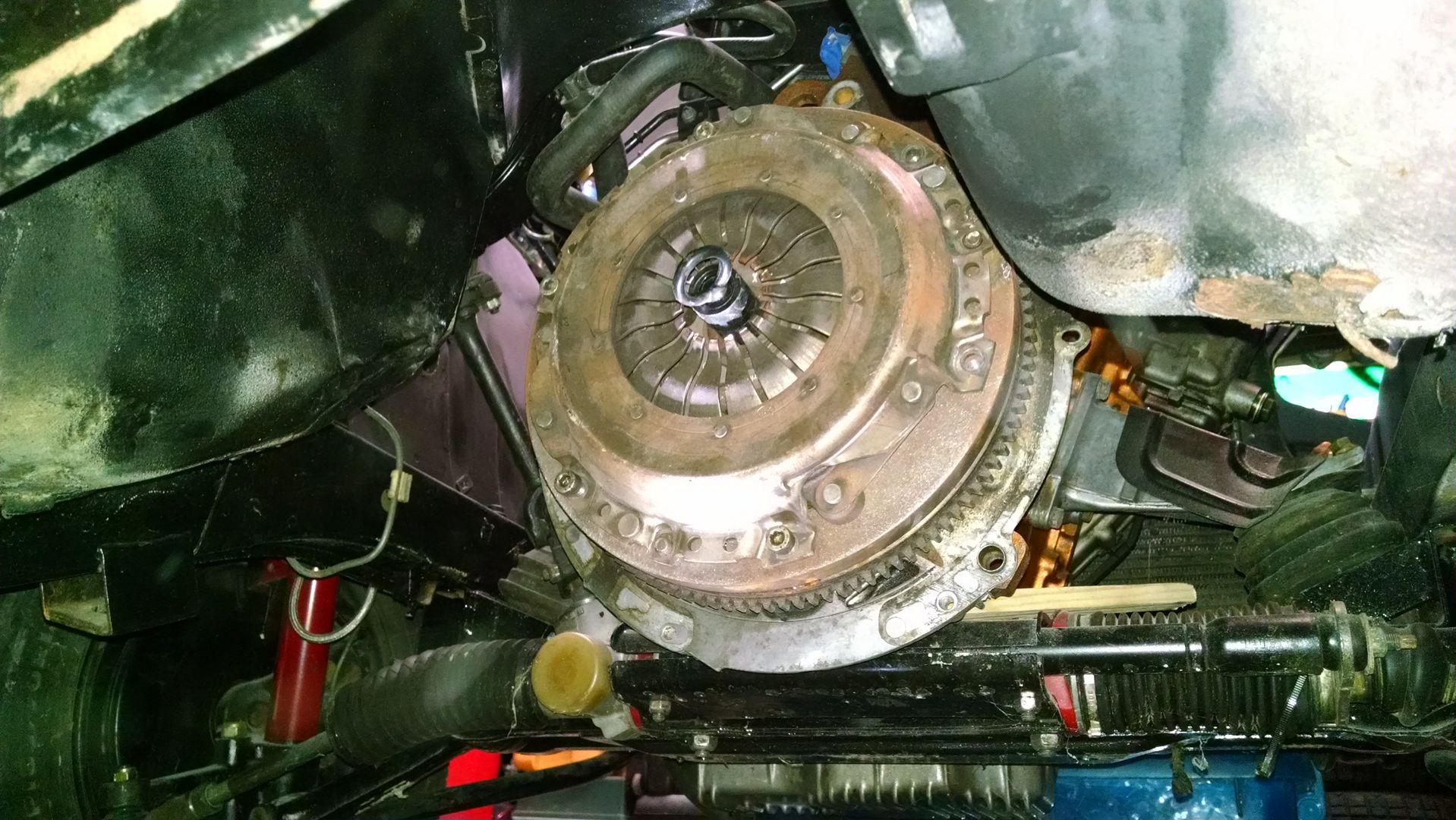

                          after doing some pre-race work on the e30 last night, had some time to fit the transmission on the e21 now that I have all the bolts.

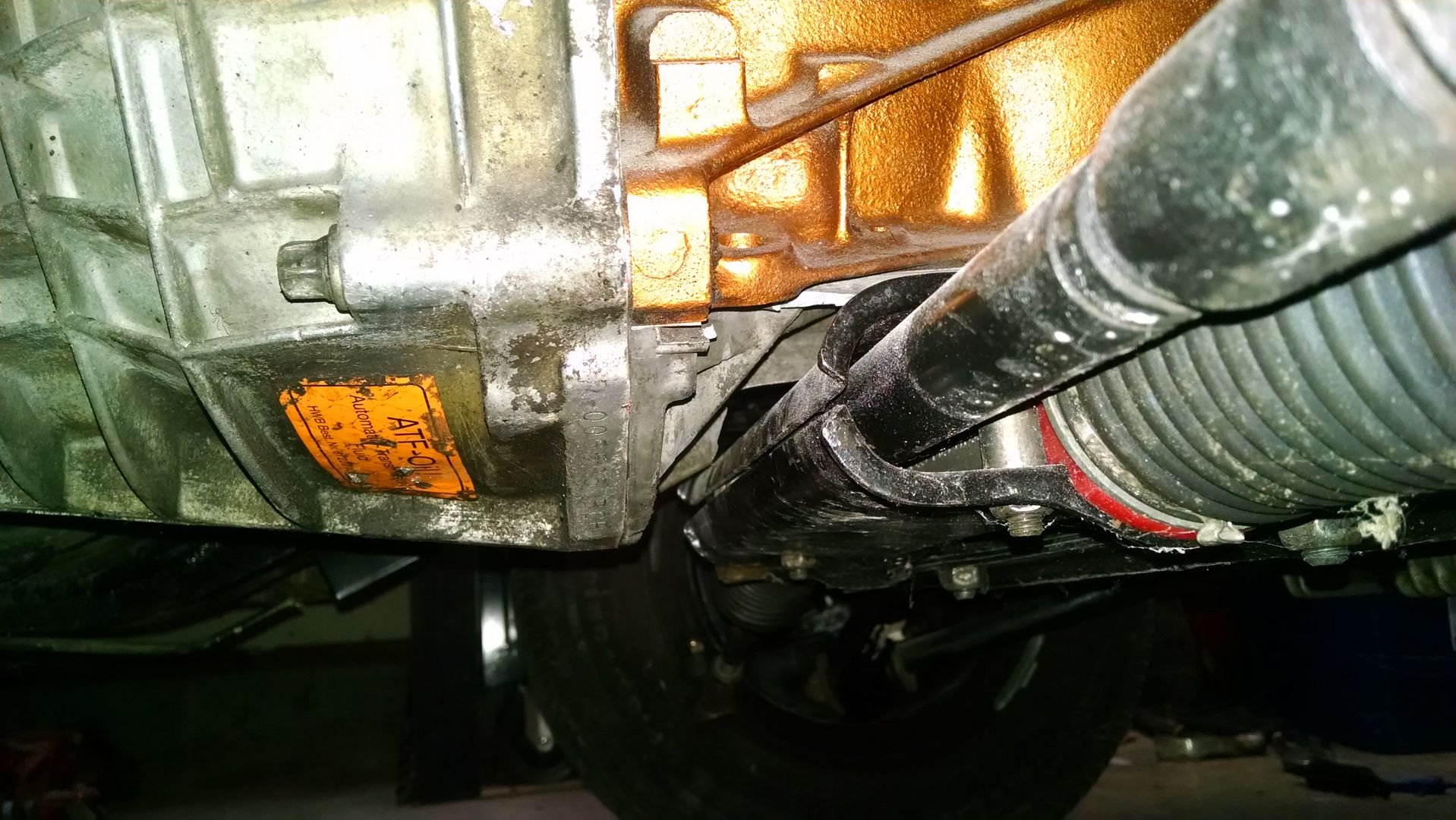

                          With the engine already in, figured I'd just bring it up from underneath and hook it up. Um....no. Not enough tunnel clearance to do it that way, unfortunately. So I went ahead and lifted the engine out, hooked it all up, and then put it all back in as one assembly. Tedious for one person to do but only took about an hour (trying hard to be quiet with the rest of the house asleep late last night, lol).
                          so, it's in. And happy to see that I clearanced enough around the rack

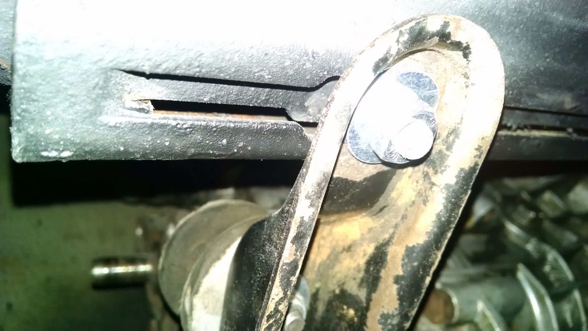

                          That said, a couple issues that concern me:
                          First, the place where the tranny crossmember sits is mighty close to the "slots" where the support bolts are removed. This doesn't make me feel all that good, so may have to do something about that (not sure what, yet).
                          Also, for some reason everything is a little bit crooked. The shift linkage is about 1/2" off centerline, and I've always thought that the engine looked just a little bit crooked. I can't really understand why, as my mounts, so far as I can tell, line up perfectly square on the frame rails. I'm probably just going to elongate the holes a tad on the engine mount arms to allow me to "straighten" the engine, IDK. I'm pretty OCD about that kind of stuff, so it's driving me crazy...
