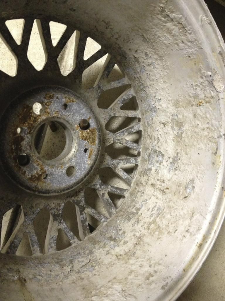

    The rims need some serious loving, but that's all part of the plan.

        is the paint actually bubbling off the rim?
          Yeah....it's pretty gross. There's corrosion under the bubbles which is where the bubbles are coming from. I have a sandblaster (but a air tank without enough capacity) and the plan is to clean them up and smooth out the pitting, I just need to find a big enough air tank. Anyone remotely near Buffalo have a line on one? I started to clean up the ugliest one with a wire wheel and I'm dreading the fronts which is why I picked up a sandblaster.
          This is the one I started with the wire wheel on. I think it'll look okay once they are smoothed out with a little bit of filler. I've seen what irish44j did with his and they turned out great!
