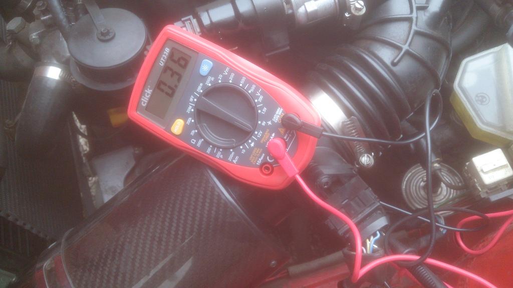

                      Gave it a few revs coming out of a fuel station last night, hit about 4,500RPM and the engine suddenly died.
                      Cranked for a while and it managed to start back up but now it runs rough, idling up and down from 1,000-2,000RPM. Disconnecting the MAF is not making any difference whatsoever but I'm not ready to say that's the issue. I'll be buying a multimeter and inline fuel pressure gauge after work today and run some diagnostics.
                      Any other known reasons for what would cause an engine to suddenly die like that? I've already replaced CPS right after the stall. Didn't make a difference.
                      Edit:
                      0.36 ignition on, 0.36 idling. I guess that confirms a dead MAF but the real question is why did it die after only 3 months?

                                MAF has been sorted. Bought a new insert and swapped Miller's plug adapter into it. Had to cut out the thermistor/IAT from the old MAF and solder it into the new one. Can take/upload photos for anyone interested.
