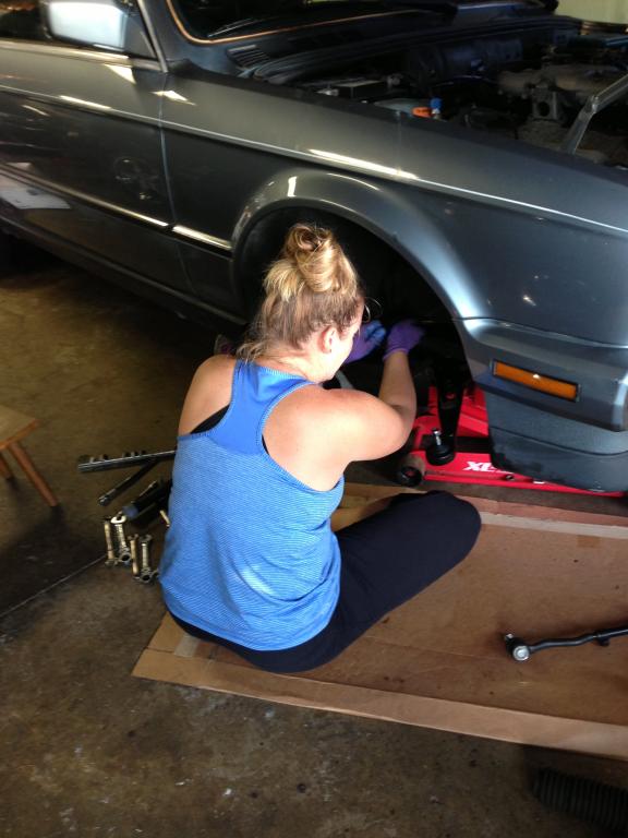

    my girlfriend was apparently more into my lest e30 than i knew.. she has had e46's and absolutely loves BMW's so when she got real excited about this car, i had to go with it! she was turning the wrenches on this car alot while i was doing customer vert tops.
    since the suspension is basically the same structure as her e46, it became a great way for her to get to know her own car better.
    she is removing the control arm, control arm bushing, tie rod (inner and outter), strut assembly, brakes rotors, bearing/hub
    FYI, we lowered the 2 17mm bolts on the K-frame (engine cross member) and let it sit on the jack to easier get to the nut holding the control arm to the k-frame

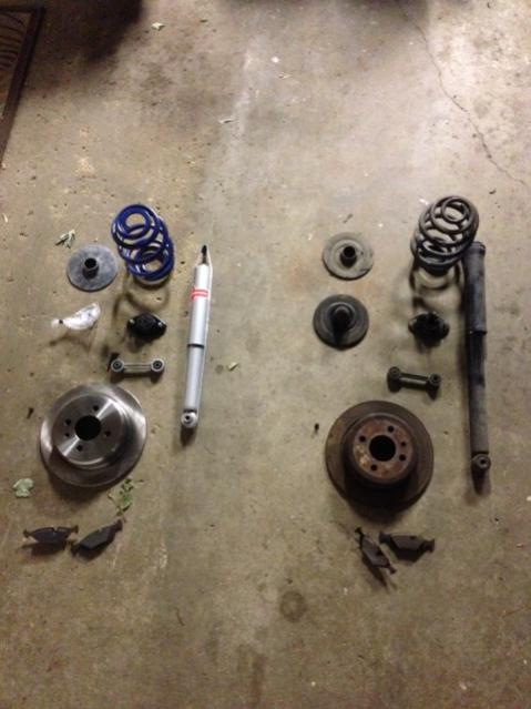

        then we moved to the back of the car - We just did each side of the car at a time.
        this pic is of the new parts installed - below i will show details of which parts were replaced as above.

          rear parts changed
          H&R sport vert springs
          spring pads - genuine bmw 3mm
          sway bar link - Optimal brand
          rear shocks - kyb
          upper shock mount - lemforder
          rotors, rear - forget which brand
          pads rear - ate
          wear sensor
          i decided that we would not replace the rear bearings at this time. in my 2 hr. scary ride home, there was no indication of rear bearings needing to be replaced so i left this alone. when this come up i'll do this. that job kind of sucks and when it comes to it, i'll just take the trailing arm off, replace the bushings and press the bearing out using the new one on my hydraulic press

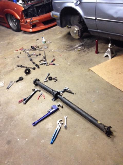

            driveshaft
            the car idled very well - it was an interesting ride home for a couple of reasons:
            the car sat for like 8 months BY the ocean so the rotors were rusted over resulting in less than stellar braking (had to enlist the help of the e-brake to make a couple of exits...)
            secondly while taking off under higher torque, there was a banging in the body of the car! i assumed that the center support bearing was shot since it did not happen at any other time. this was very un-nerving but i drove it home very cautiously...
            part of the repair and replace now included new center support bearing and from previous experience doing this job, i also put a new flex disc in at the time. it really sucks getting at the drive shaft.
            this time around, i took off the back half of the exhaust (no help from the gf here..) and removed the armor plating hiding the driveshaft. i then took out the trans supports and loosened up the rear bolts on the k-frame. i let the assembly down with a jack until i had enough room to get in there to un-bolt the driveshaft from the trans - this is where my helper came back in. put the car in neutral and she turned the wheels for me until i could get to all of the bolts necessary.
            believe me, this is WAY easier than removing the exhaust - which will usually result in many broken bolts or stripped nuts..
            so here's the driveshaft with the new parts on it

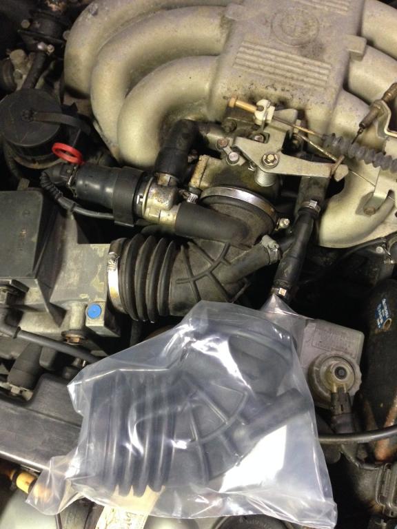

                      intake bellow - replaced

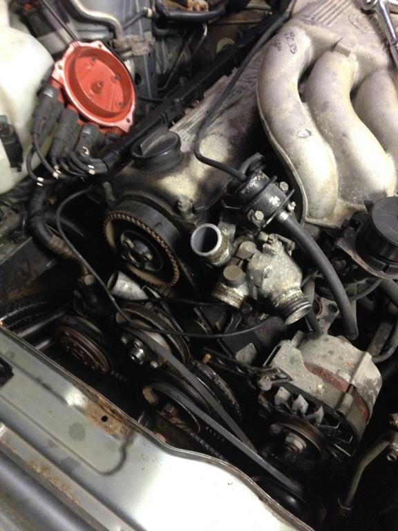

                        working on the timing belt now - it's just such a messy job...

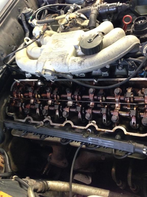

                            valve adjustment - i just jump the starter on the obd1 port to do this, i think it was port 11 to port 14. i used a small paperclip. this makes life easy - bump the starter until the cam is in the right position and adjust the valve - then repeat. this way, it usually only takes me around a half hour to do this job
