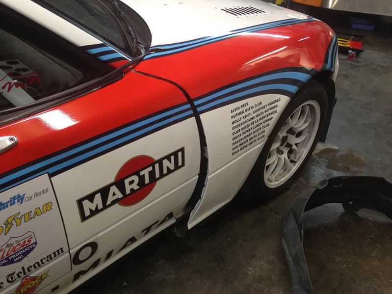

                            you could space the fender out at the rear mounting points to get a bit more clearance
                            Click image for larger version  Name:	118084d1405541901-front-fender-aero-testing-img_0928.jpg Views:	0 Size:	67.3 KB ID:	9878252
                            1984 Delphin 318i 2 door
                              my issue is more the tire hitting the inside of the wheel well rather then the fender itself (not running fender liners either) Appreciate it though. I just picked too tall of a tire. Stock height is 23.88, the r888 in front are 23.97 but these are 24.86. Shoulda went 225/45/16 =/
