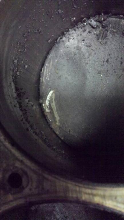

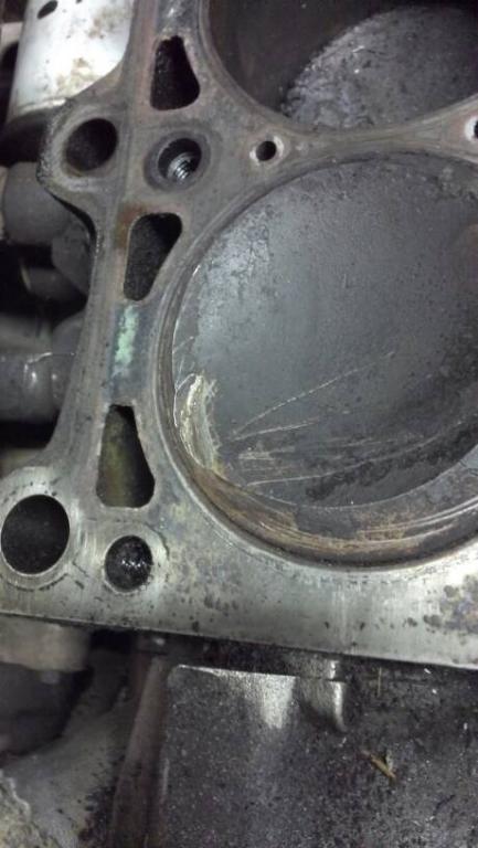

                    Here's the damage. The timing belt tensioner broke off the block. I guess its okay to run those pistons since they aren't that bad. Just clean up the gashes? I'm going to pull a head and put it on.

                      That does not look bad
                      • Thizzelle
                        • 4422
                        I'd still use them, just 2 like that?

                          Yeah just 2.

                            What junk yard did you find it in? Smooth out the gashes and run those pistons you should be ok
                              G&G on 15th and Broadway. They have 2 more E30s there, a 325i project and a 325is/es(Didnt look lose enough) I will be there again tomorrow or Friday to get a head. PM me if you want details.
                              Also could you point me the right way for properly smoothing out the pistons?
                              Thank you.
