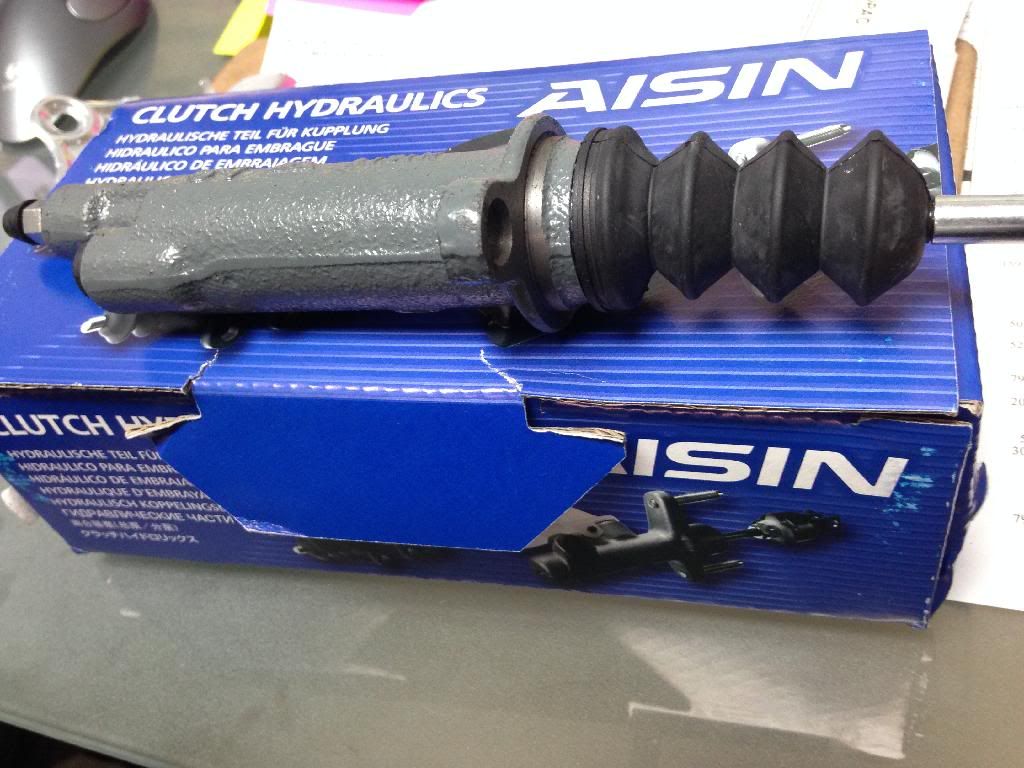

    clutch slave cylinder arrived today, we are now mocking up the driveshaft so we can send it off to get fitted and balanced
    [/URL][/IMG]

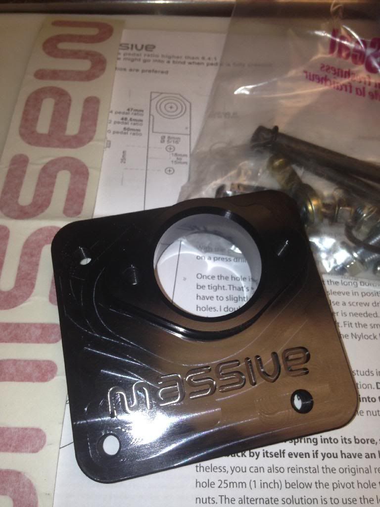

          Little update received my massive brake booster delete

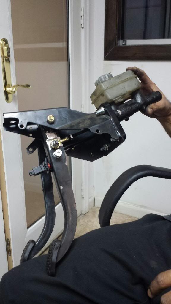

            so i took out the pedal assembly and mated the booster delete plate to the assembly.
            [/URL][/IMG]

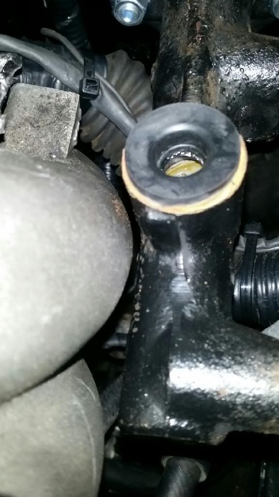

            After installing everthing the master cylinder was way too close to the intake manifold. i think im the only one that probably went with the stock master cylinder i just added a spacer to the intake side mount.... usually everyone orders the wilwood.
            [IMG][/IMG]
            [IMG][/IMG]
            i forget to take another pic of the space difference, but i got a good inch clearance now. More updates coming soon tomorrow i have to cut and weld oil pan

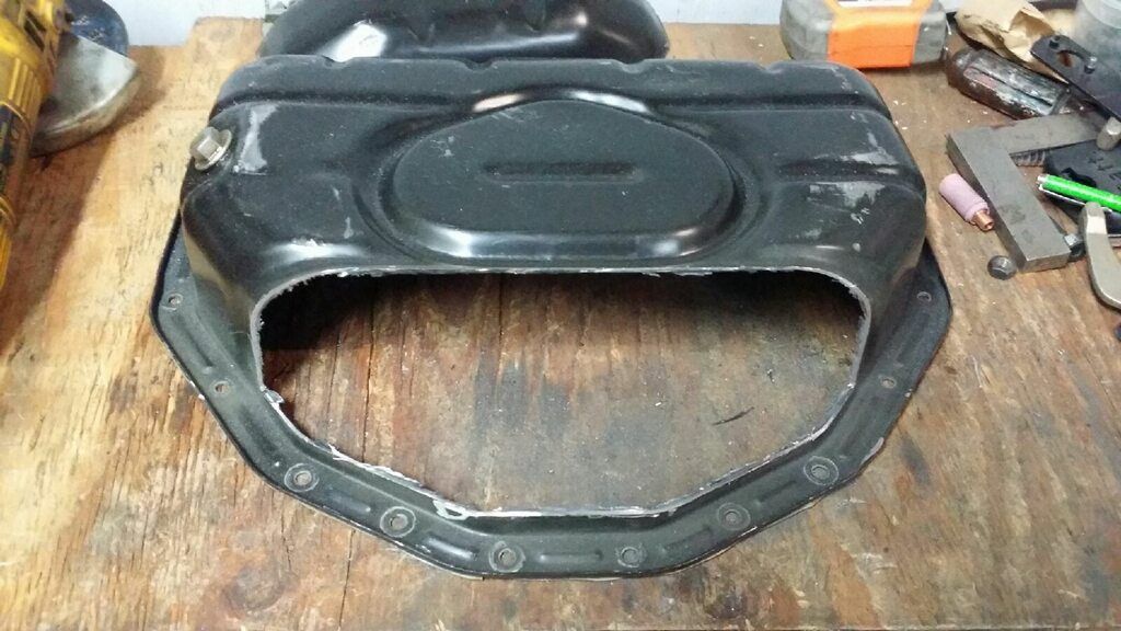

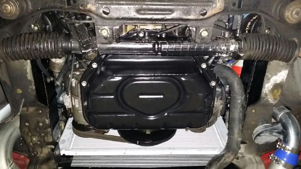

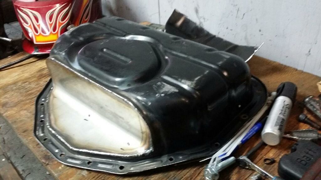

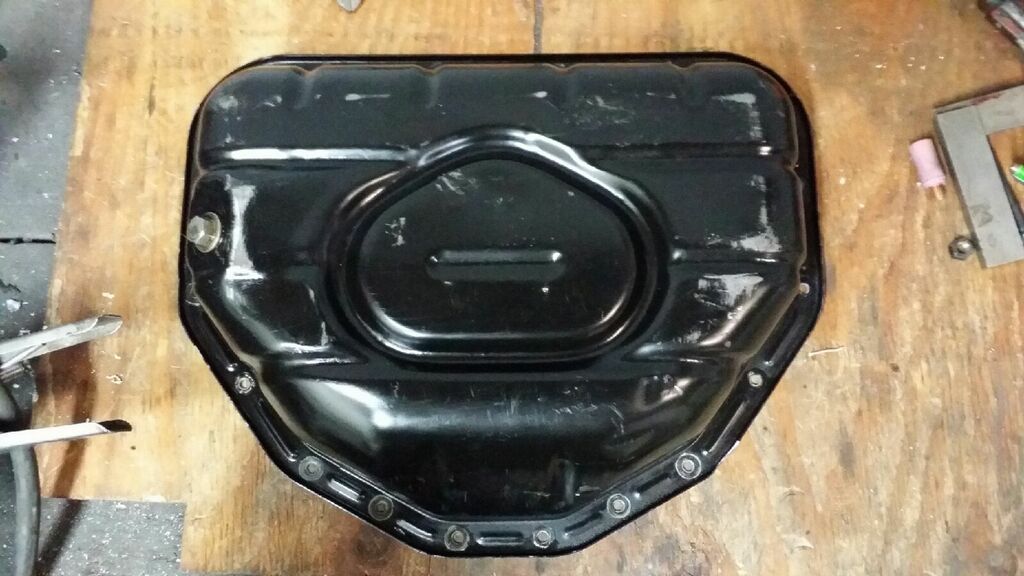

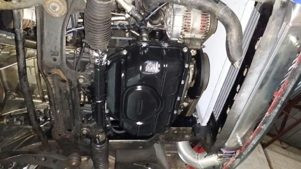

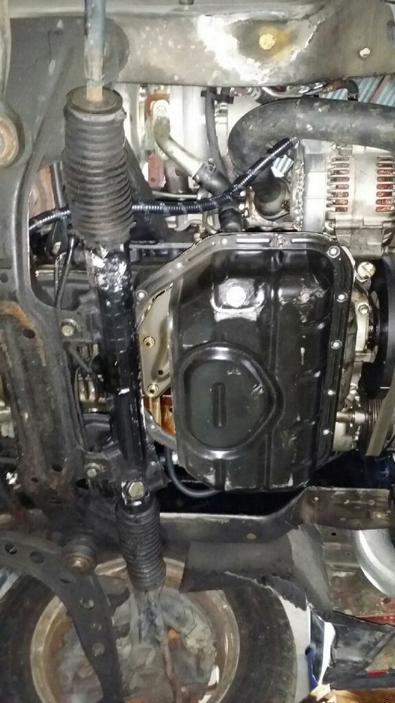

              Took the oil pan off
              [IMG][/IMG]
              cut
              [IMG][/IMG]
              Test fitted
              [IMG][/IMG]
              Welded
              [IMG][/IMG]
              Painted
              [IMG][/IMG]
              Installed Good Clearance
              [IMG][/IMG]
              [IMG][/IMG]

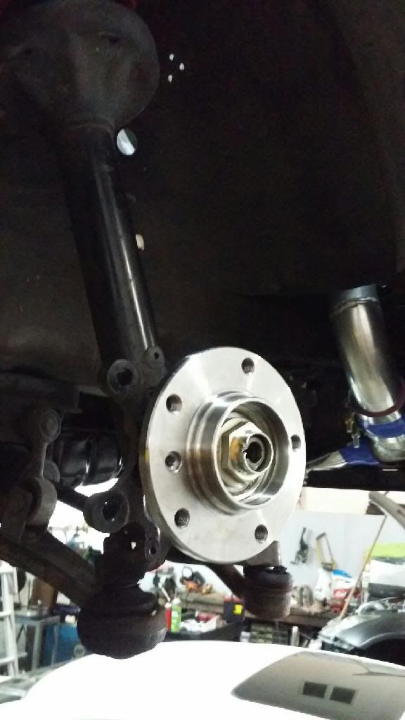

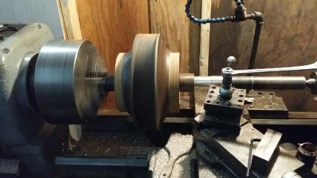

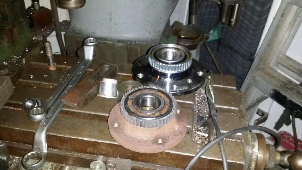

                          Measuring up 5 lug conversion. Old and new Hub
                          [IMG][/IMG]
                          Machining new sleeve for center bearing adapter
                          [IMG][/IMG]

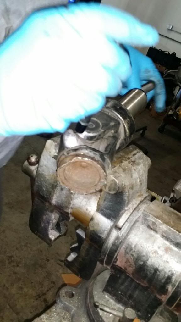

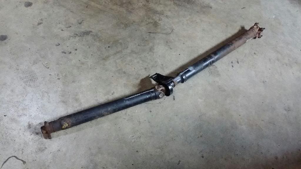

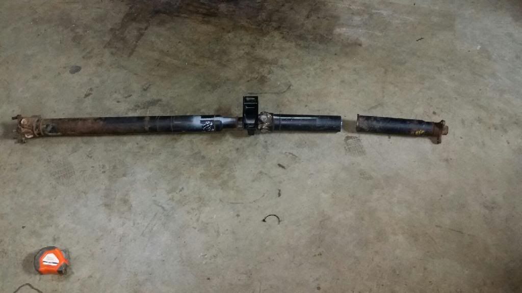

                          So back to the driveshaft because i have postponed this for some time
                          [IMG][/IMG]
                          Taking part the yolk then going to machine fit it to the shaft..
                          [IMG][/IMG]
                          Measured and cut shaft to right length.. tomorrow welding the yolk on, im still waiting for a couple brake parts in the mail so will update soon.
                          [IMG][/IMG]
                          :(:neutral::-?:):D
                          • BlkE30v
                            • 100
                            #43

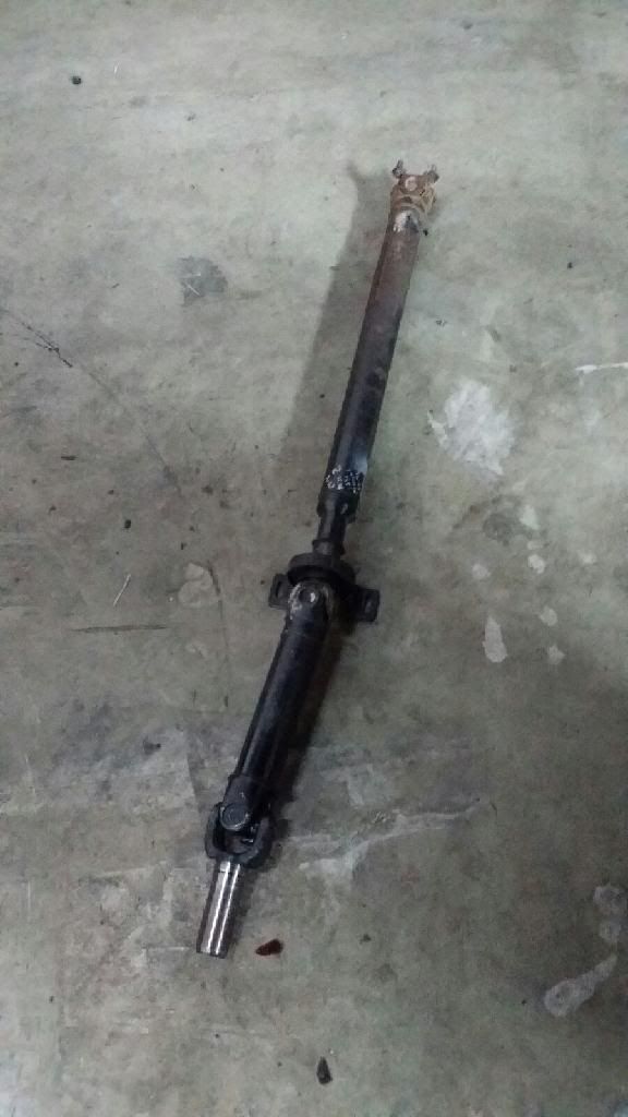

                            Got the driveshaft welded up
                            [IMG][/IMG]
                            Installed the 5 lug hub now checking out what rotor will work and what big brakes I'm gonna get
                            [IMG][/IMG]

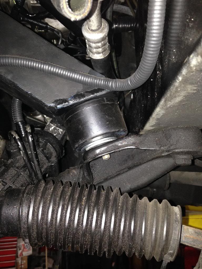

                              #44
                              [IMG][/IMG]

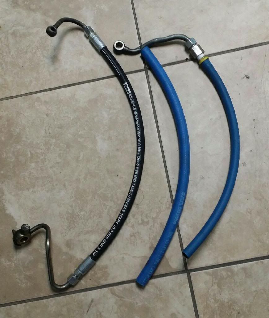

                              Bmw Mated up to toyota Powersteering lines
                              [IMG][/IMG]

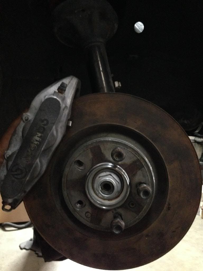

                                #45

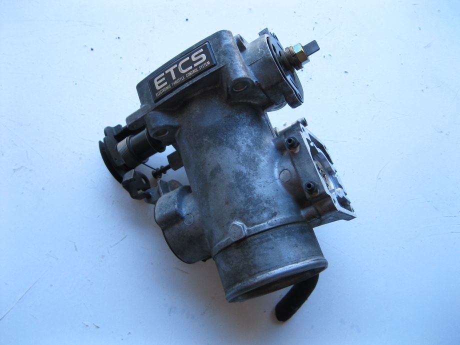

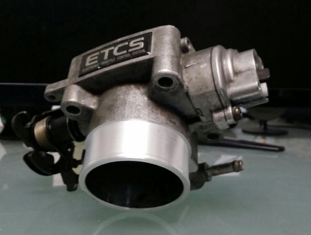

                                cut the traction control sensor off the throttle body befor/after
                                5 lug conversion is done :D:D:D im running cobalt ss rotors and calipers as my big brake set up i had a adapter bracket made up and i drilled the rotor holes from 5x114 to 5x120 here is a couple pics
                                [IMG][/IMG]
                                will update with finished product
