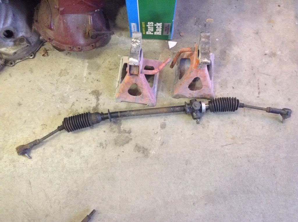

                          Small update! I found the original steering rack off the Courier:
                          But it's a little...bent.
                          I was going to have it repaired, but I took a quick look on Ebay UK and found a remanufactured RHD Spitfire rack for just over $200!
