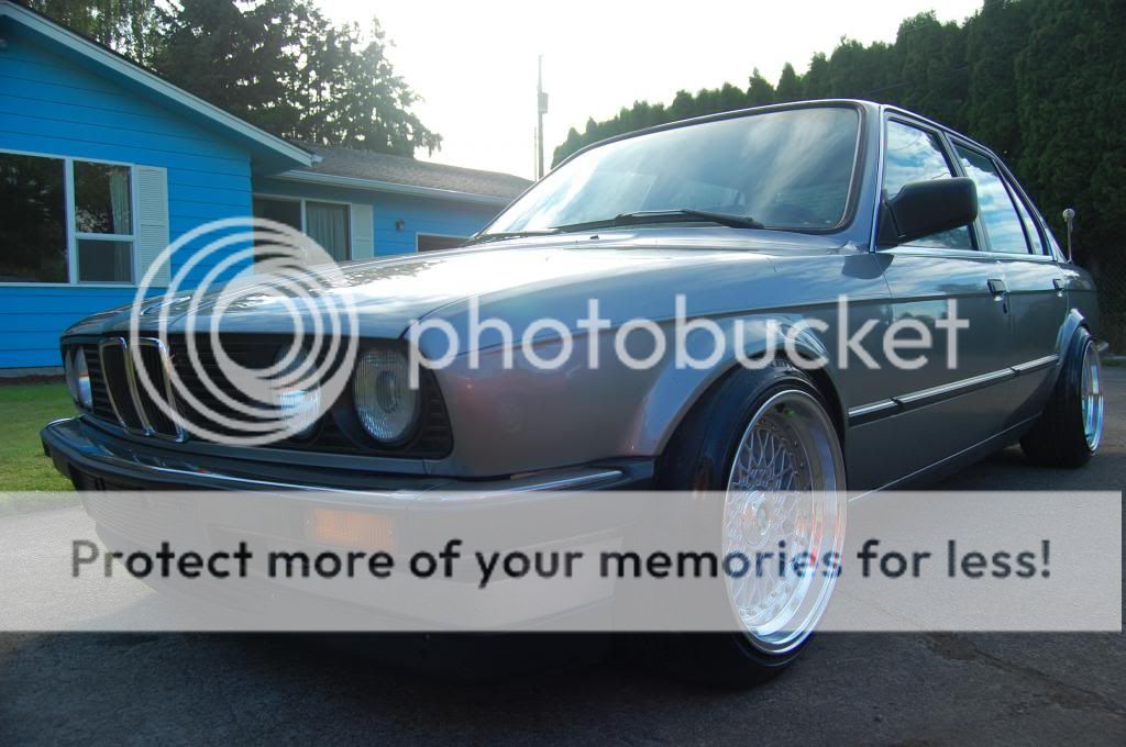

    Starting a new thread for my next round of modifications and updates to my 87 325i sedan. I sold my M3 so my sedan needs to take up the responsibility of being my year-round daily once again. I also intend to start participating in auto-x as well as other motor sporting events so the car will be going in a couple different directions at once.
    Upcoming work I have planned:
    Full 24V air conditioning retrofit. (most parts already acquired, PF condenser and 16in 3000CFM A/C fan already installed)
    S54 OFH and oil cooler. (have everything waiting sans Vac AN10 adapter and Vac banjo bolt)

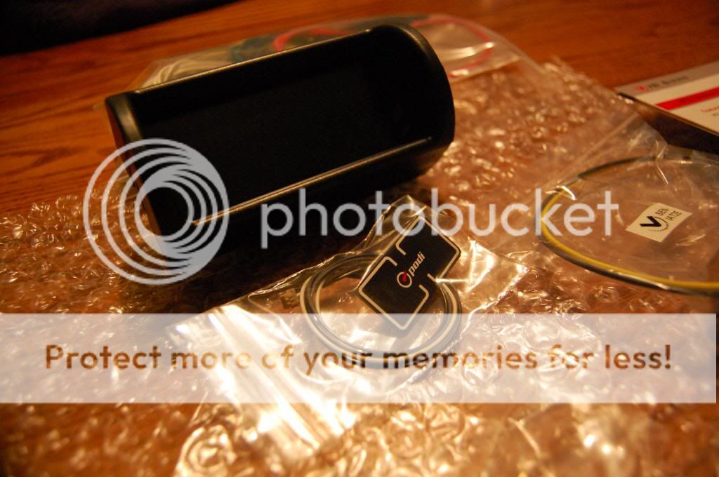

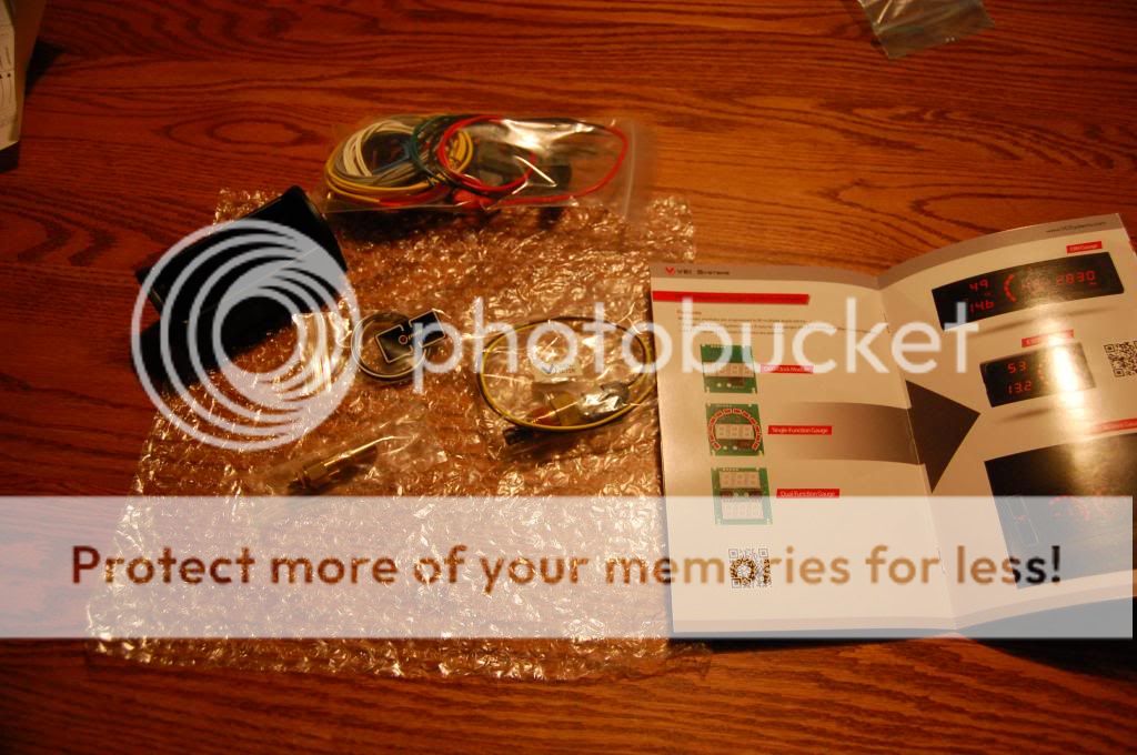

    Fairly comprehensive array of gauges including voltmeter from jaywood and Podi ventgauge
    Wheels and tires appropriate for "sporting". Konig wideopens already bought and wrapping them in 225/45
    Replace 80 amp alt with rebuilt 140 amp unit

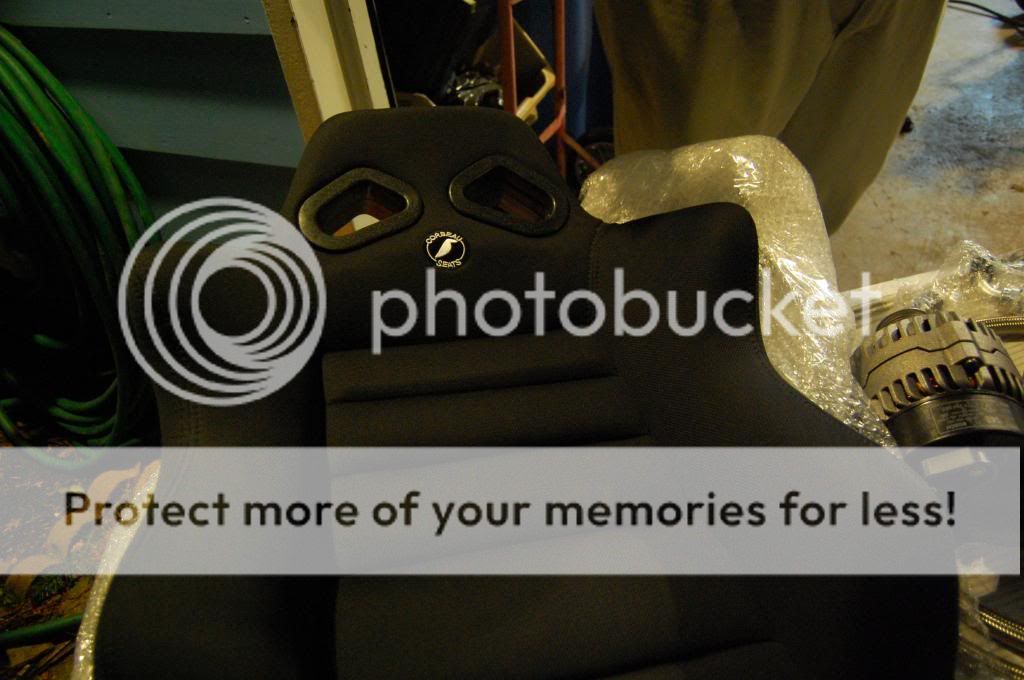

    Replacing my ebay SRD replicas with Corbeau TRS.(Bought and installed)
    Installing my IS skirts I have had sitting around for a few months
    Install my ArcAsylum rear sump kit I have had sitting around for years (when I find the motivation to pull out a perfectly good running motor)
    On to some pickers for the clickers.
    That is all for now. Good to be back in action.

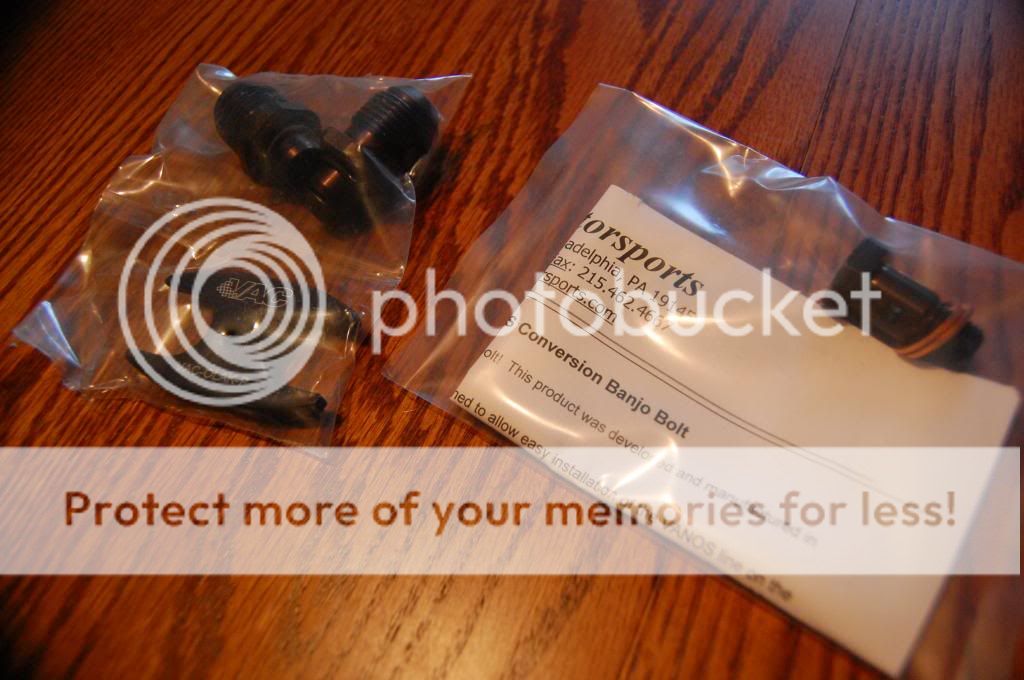

          My order from VAC came in today.

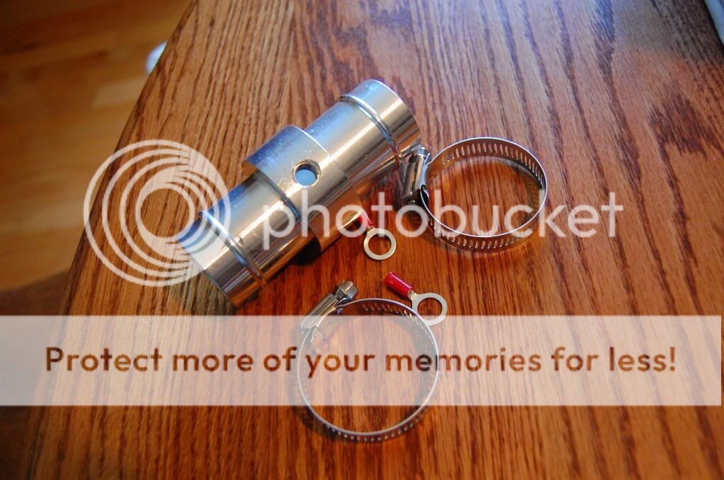

                    Got my temp sender adapter from Steiger performance today. Thanks to Matthugie for helping me find the right one!

                            What temp are you sensing with the adapter?
                            • Wishno87
                              • 6025
                              Coolent going into the radiator.

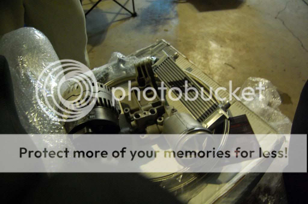

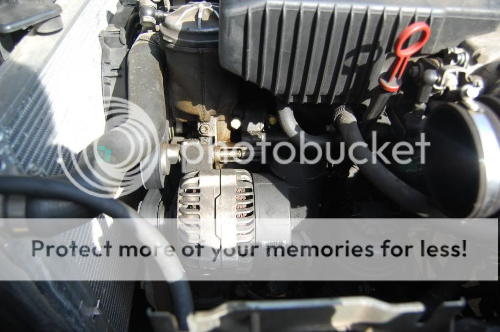

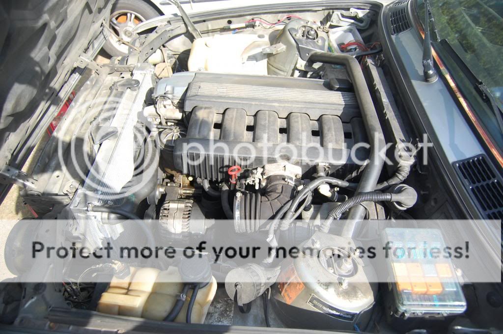

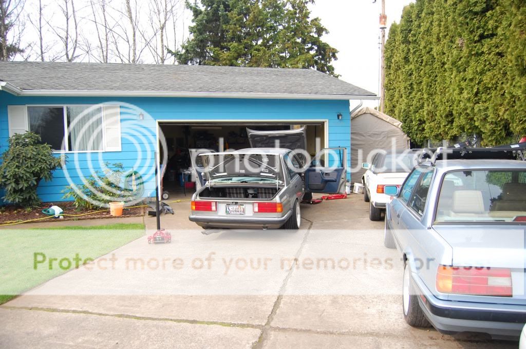

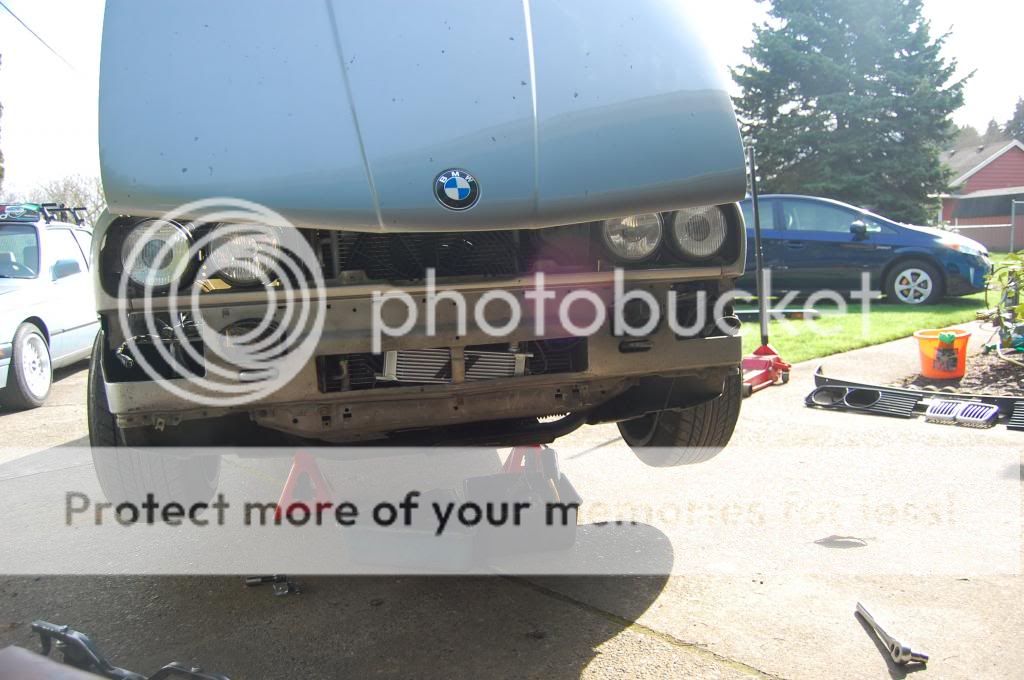

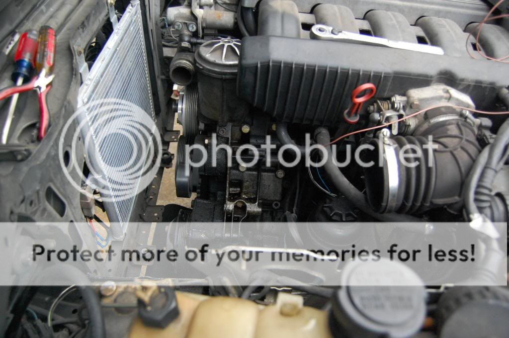

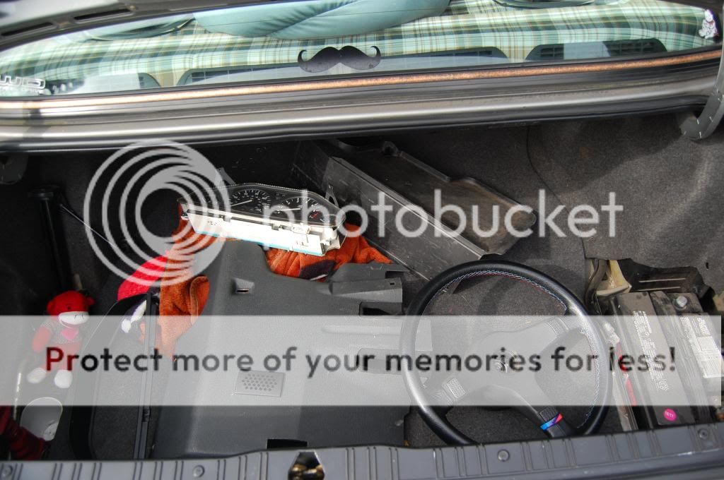

                              Got the parts out.
                              Stuffed it in to check clearance.

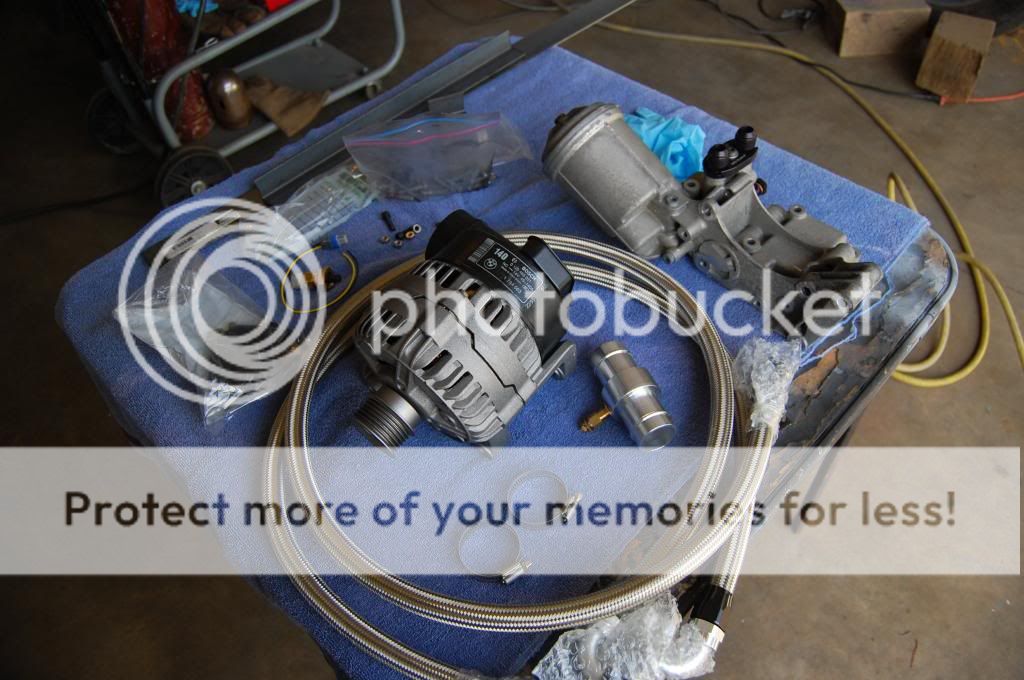

                              Old 80amp alt

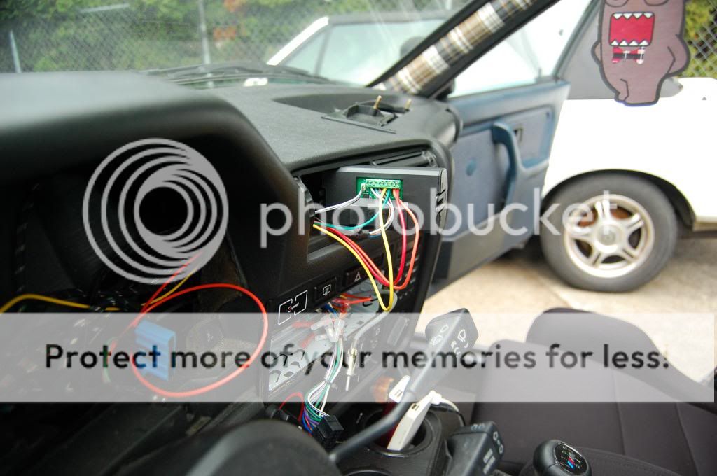

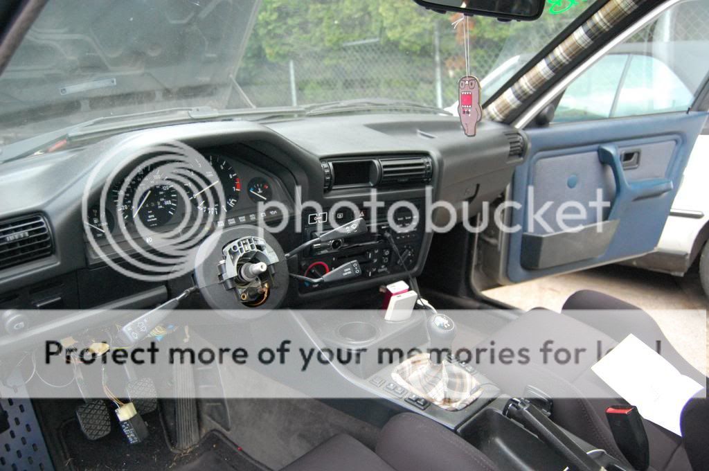

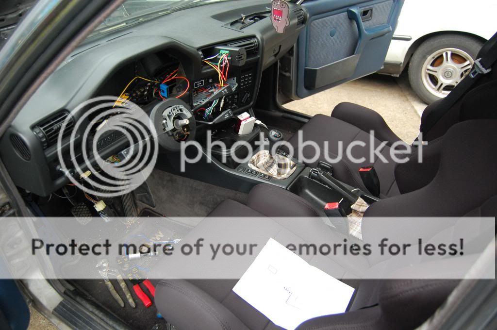

                              Making room to route wires for vent gauge.
                              Getting things plugged in.

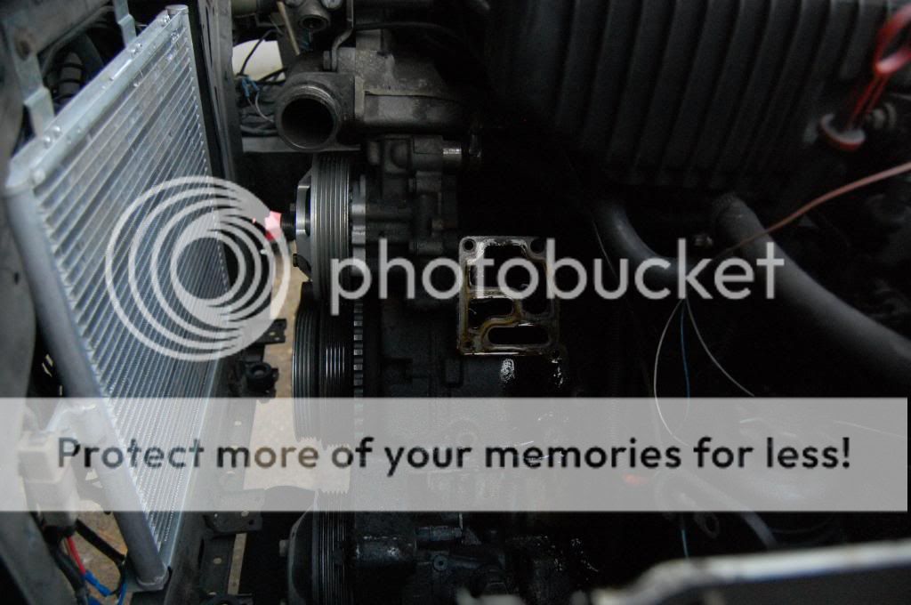

                              Getting the alt and OFH removed.

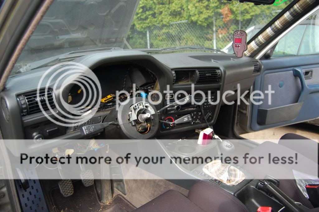

                              Interior coming back together.
                              Old alt and idler pulley.

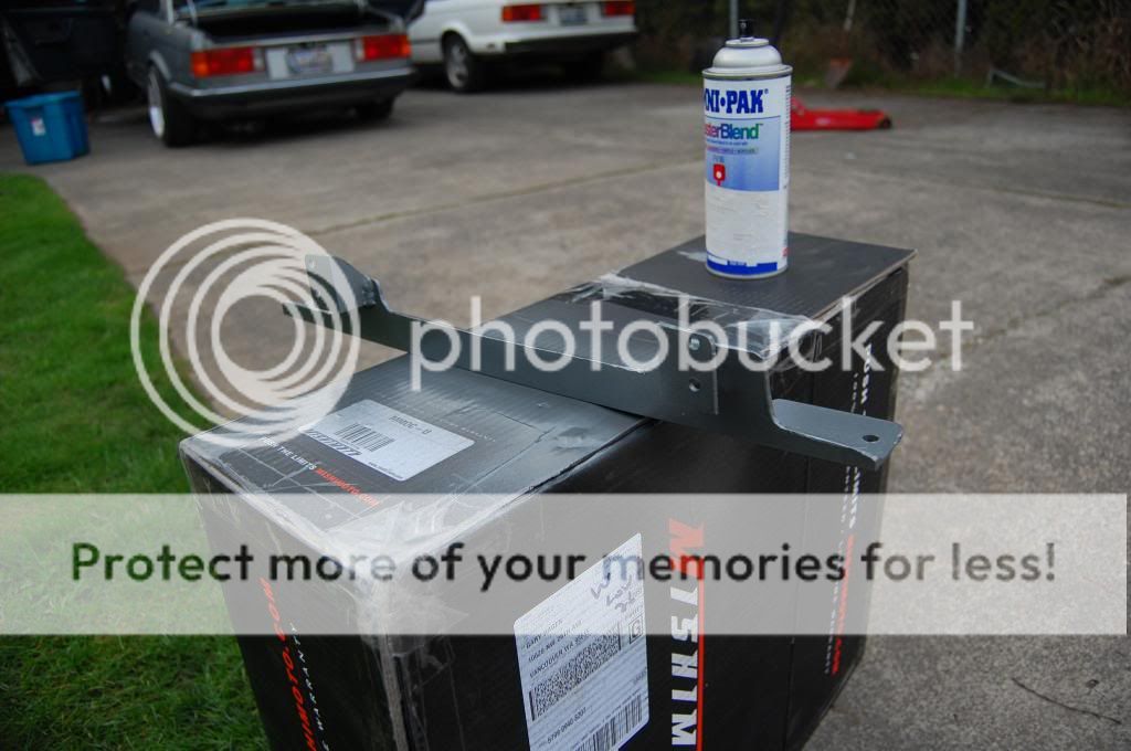

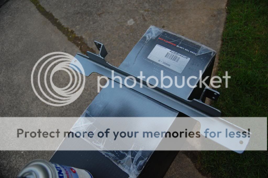

                              Bracket for oil cooler.
                              Painted it body color.
                              Thats all the pictures I have for now. It started getting late and I was running out of time to finish it. The oil cooler system has been working great and I have no leaks so far. I have only gotten the oil warm enough for the thermostat to open once or twice as of now but as the weather warms up that should change. The hoses were way too long though and I would like to get some shorter ones when I get a chance.
                              The vent gauge has been doing nothing for me though. I have yet to buy the wideband and the oil pressure sender is on its way but the coolent temp and air intake temp do nothing. The coolent temp reads way to high all the time (70F when its actually closer to 40F) and once it gets to 225 it just reads "high". The AIT always reads "low" no matter what I do. I ran an extra ground to each sensor and connected it to the same ground as the gauge but still nothing. Cannot say that I am impressed at the moment.
