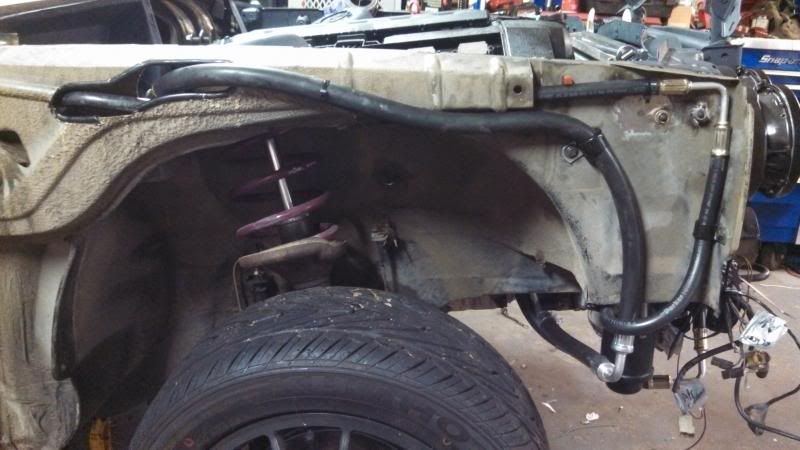

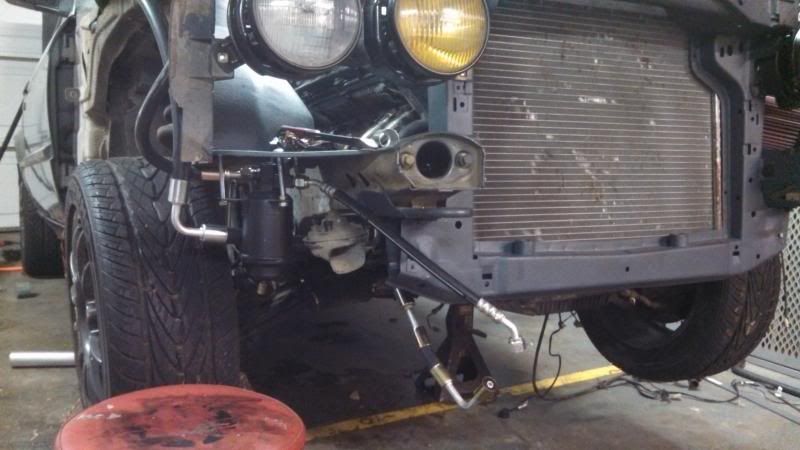

          started to get the a/c lines in order. hidden from the engine bay, and getting a larger condenser. The company sent me the wrong one. need one more fitting and the right condenser. hoping for an ice maker in the GA summer.

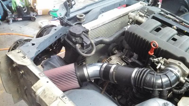

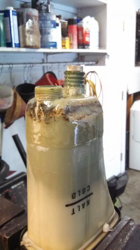

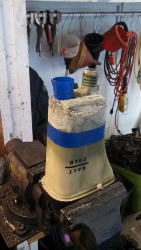

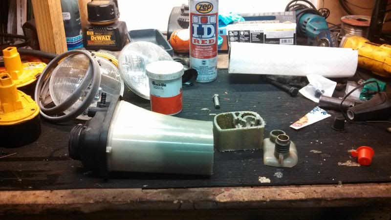

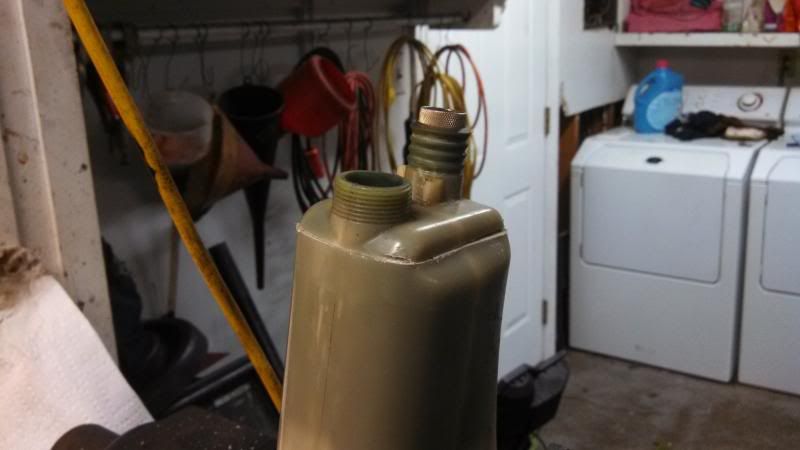

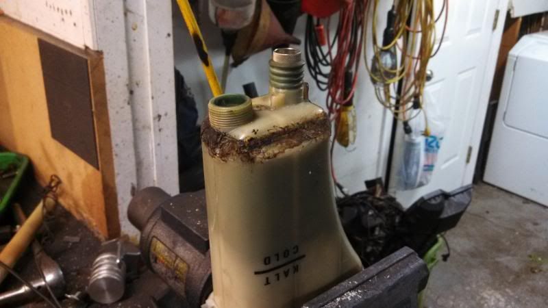

          Which coolant reservoir should i use. i can mount this volvo one a little higher and make for a clean looking install. or i can use the shortened e36. both of them will be a regular gravity system. the e36 bottle was gutted when i modified it. opinions?

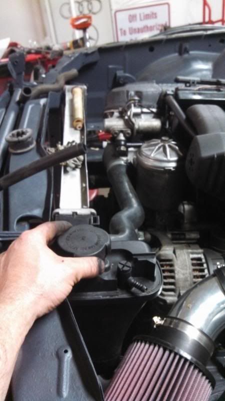

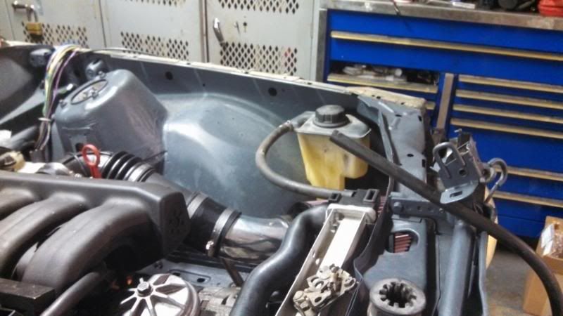

            well i decided on the E36 bottle. Got it mounted up, hosed in...

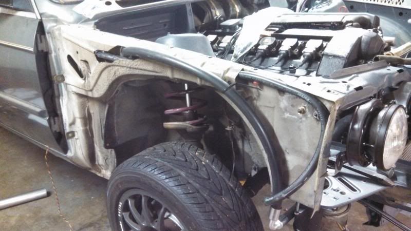

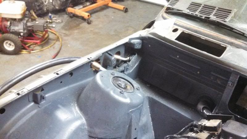

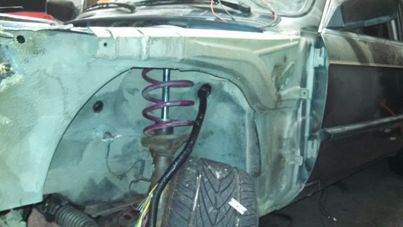

            ran the wires in the fender well. i had to stop tonight. i will be extending the harness where needed to an exact length. i need to get the condenser and fan mounted up.
            Got the brake lines ran and connected. clutch and brakes need to be bled. among alot of other misc. things.

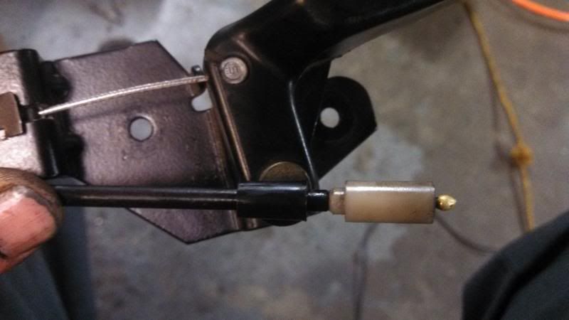

              got a hood release cable made a bicycle shop for $10. just had them make the sleeve about 4" longer and i cut the cable to length. it is a twisted stainless wire versus the original solid. i used a brazing rod and brazed the end of the cable to lock the feral in. one more thing out of the engine bay.
              crimping the a/c lines tomorrow. i am going to try to use the press made for hydraulic lines. i figured its worth a shot. i would not go with my original suggestion on Techchoiceparts.com. They called the day after i ordered and said the condenser i wanted was not in stock and they sent me a different one once i got the specs on it from him. wrong size and had the discharge on the wrong side. they also sent me a wrong fitting., and it was a day late. i have to pay for shipping on the replacement parts. WTF?

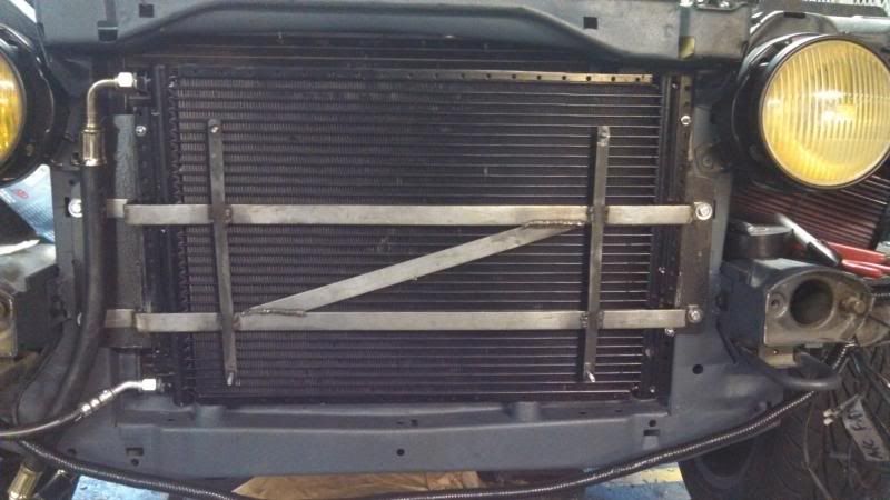

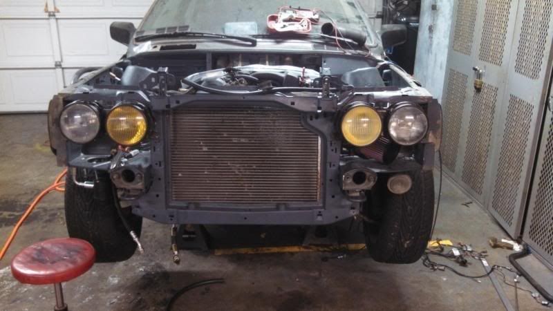

                New condenser is here. Lines are made. Harness has been ran and extended and hidden. Need to mount condenser, fan and put the shifter on. This weekend I will do this and also fab up some new es valance mounts out of steel.
                Looking for late model fogs, E39 Fog lights, cool cheap 17 5x120 wheels.
                • meanEG
                  • Oct 2013
                  • 562

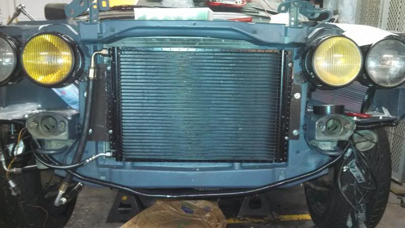

                  condenser is mounted, woohoo. made the last a/c line. need to put a vacuum on it tomorrow. i am going to mount the fan and make the vALANCE MOUNTS tomorrow.

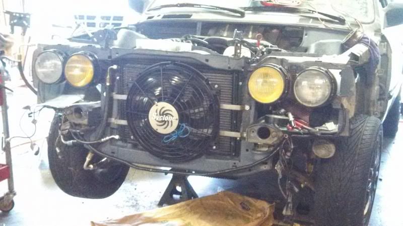

                    made some more progress this weekend, and wasted alot of time. i hate being a perfectionist.
                    This is where most of my time was wasted. this fan is just too fucking thick. messed with it, messed with it, even cut up my valance (already was bent up anyway). Finally had to return the fan and i ordered a flex a lite 119 pusher lo boy. only 3 3/16" thick vs 4" on this 398 FAL. If i was using a stock condenser and a 14" fan than maybe it would have worked. i was cold a/c and i do not want any overheating problems. this is why i went with the 16"

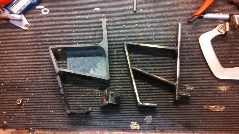

                    Made some new indestructible ES/IS air dam mounts
