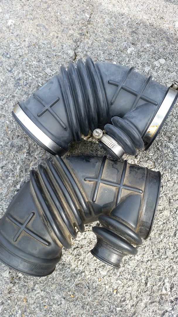

    First off, I am not a fan of the poly mounts. I swapped in poly engine and trans mounts and even with a new guibo and CSB the vehicle shook like mad. It was bad at idle, got slightly worse under throttle, then settled at certain RPM. Still worse than stock at all RPM.

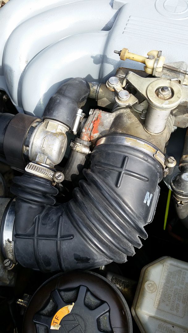

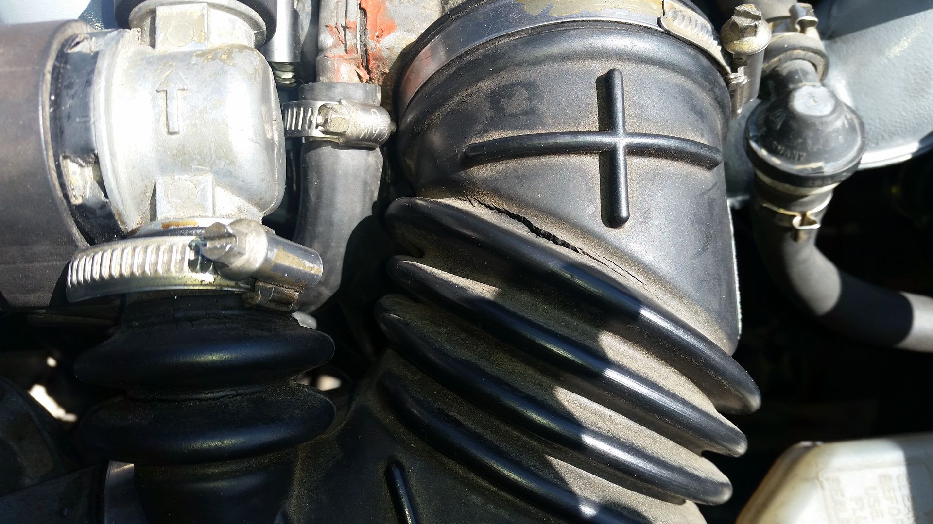

    I also had the (noted) leaky vacuum hoses and intake elbow. The oil filter housing/oil cooler fitting also has a leak.
    Parts to the rescue!
    New elbow, IACV hose, vacuum hose, oil cooler o-ring, engine mounts, nuts, washers, and some gently-used OEM trans mounts (those I had sitting around).
    The easy stuff went first:

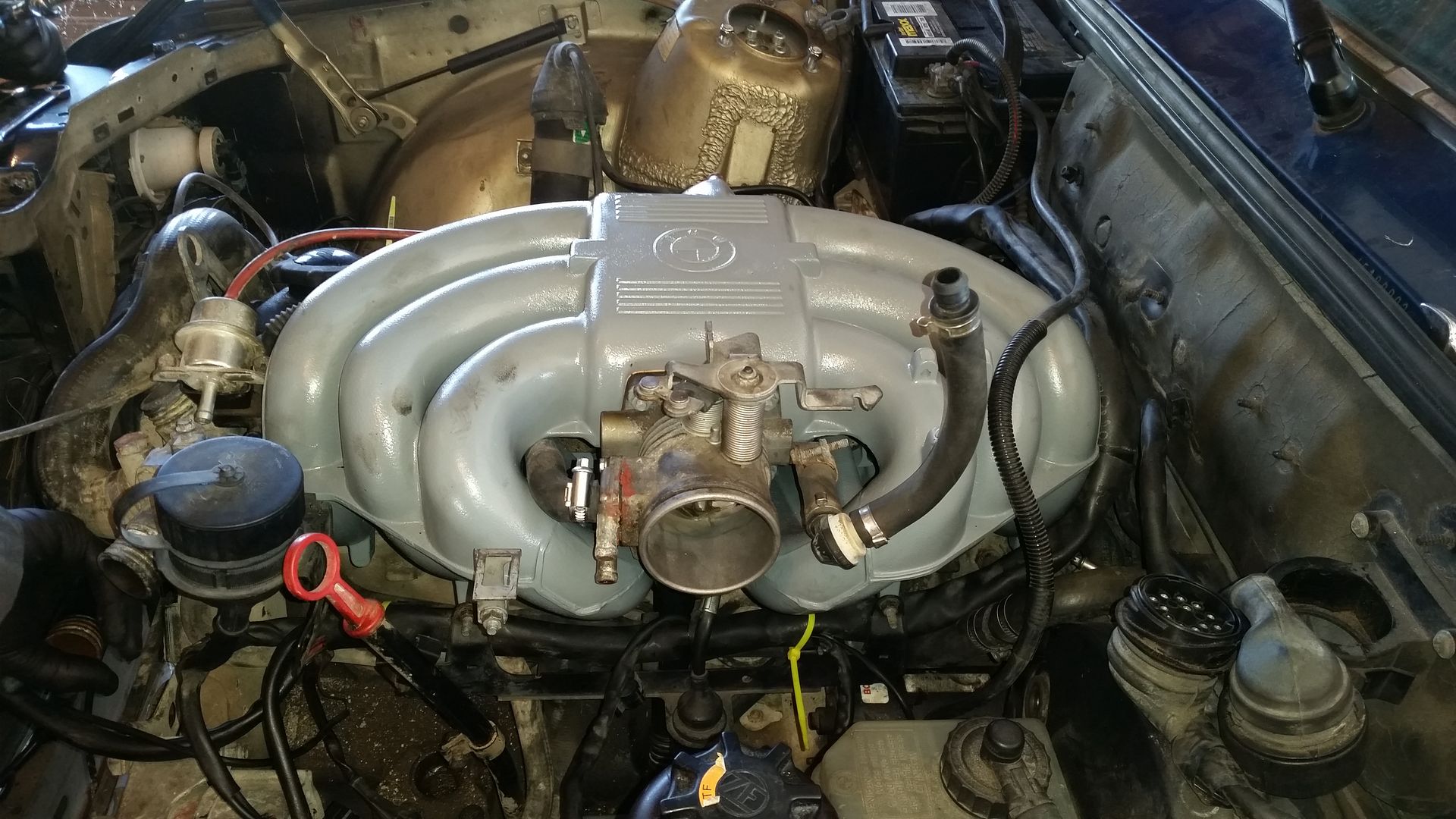

    OEM intake elbow
    And installed with the IACV hose:
    Fuel rail vacuum line:
    So with that done the idle settled down quite a bit but it still vibrated like crazy.

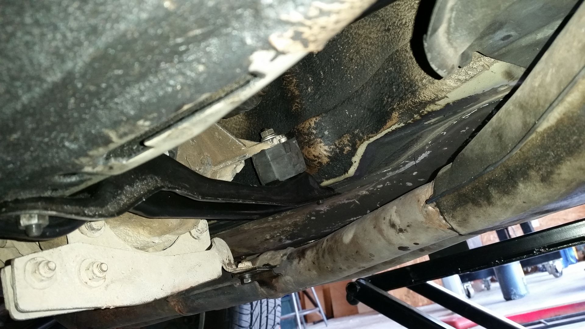

    This Saturday I installed the OEM mounts. Up in the air:
    Started with the trans mounts:
    After those were in I re-started the car. It was up on the lift so I did not drive it but if I had to make a guess I would say that about 90% of the NVH went away form changing the trans mounts. Had I not been lazy I could have stopped there and gone for a drive but I had new OEM mounts so I decided to give them a shot. I might go with some 320i auto trans mounts (23711109173 ) but we'll see how these do.

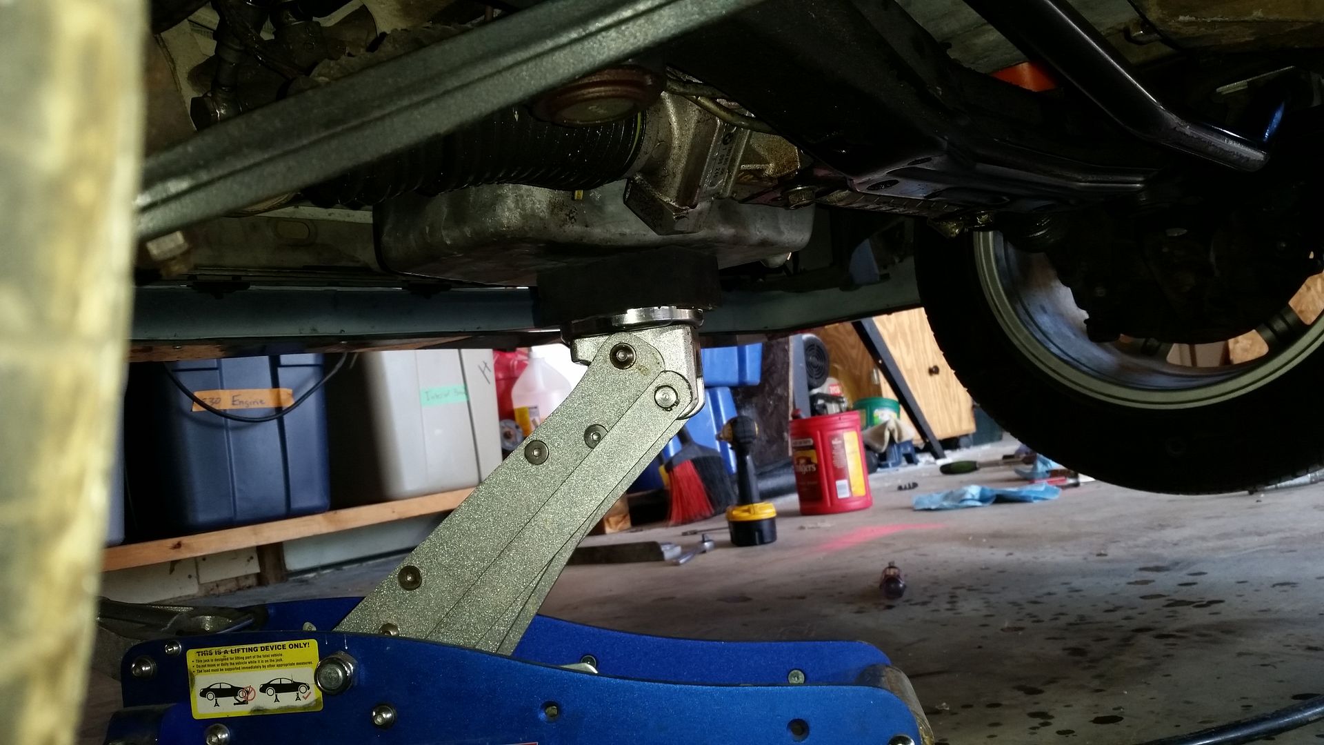

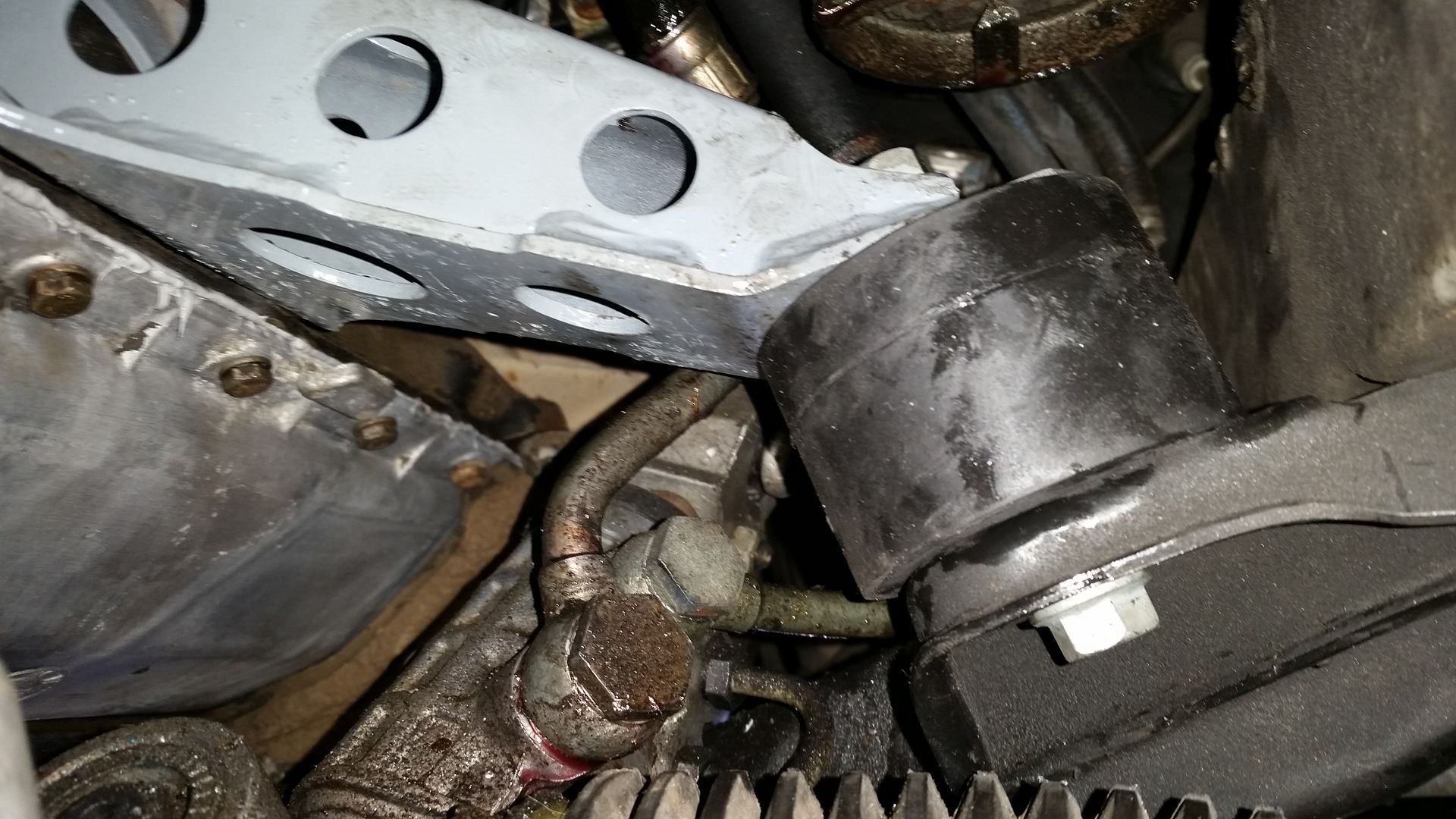

    I supported the engine with a jack (I had a rubber block to protect the pan) and swapped in the OEM motor mounts:
    With that done I re-checked the idle and everything was smooth.

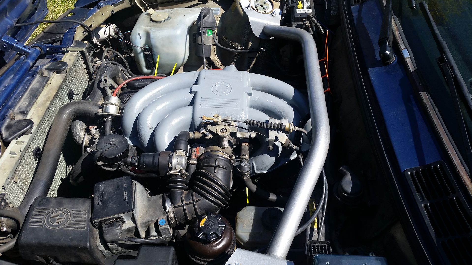

    Lastly, I had the hood up and decided to snap this shot:

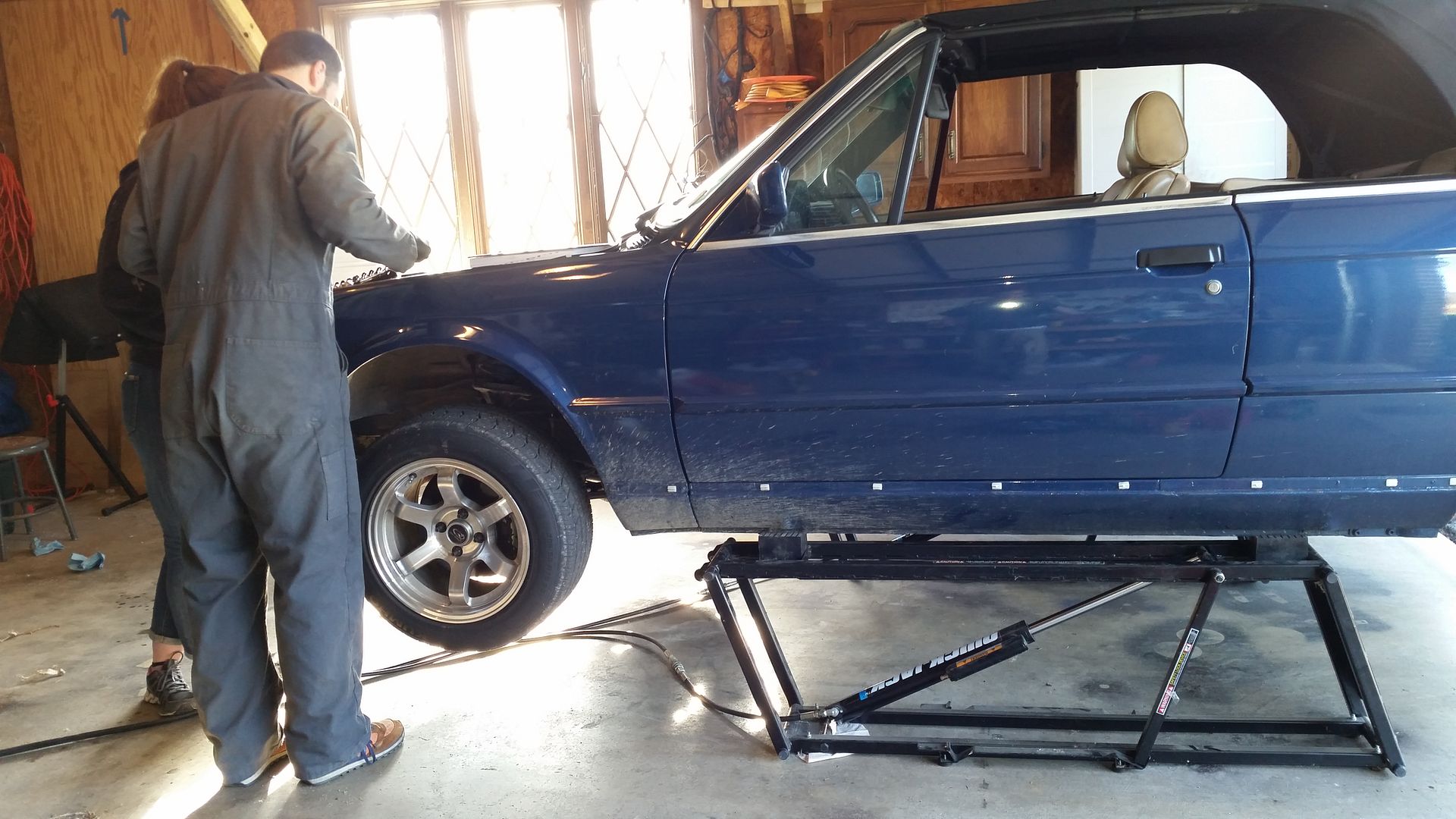

    replied

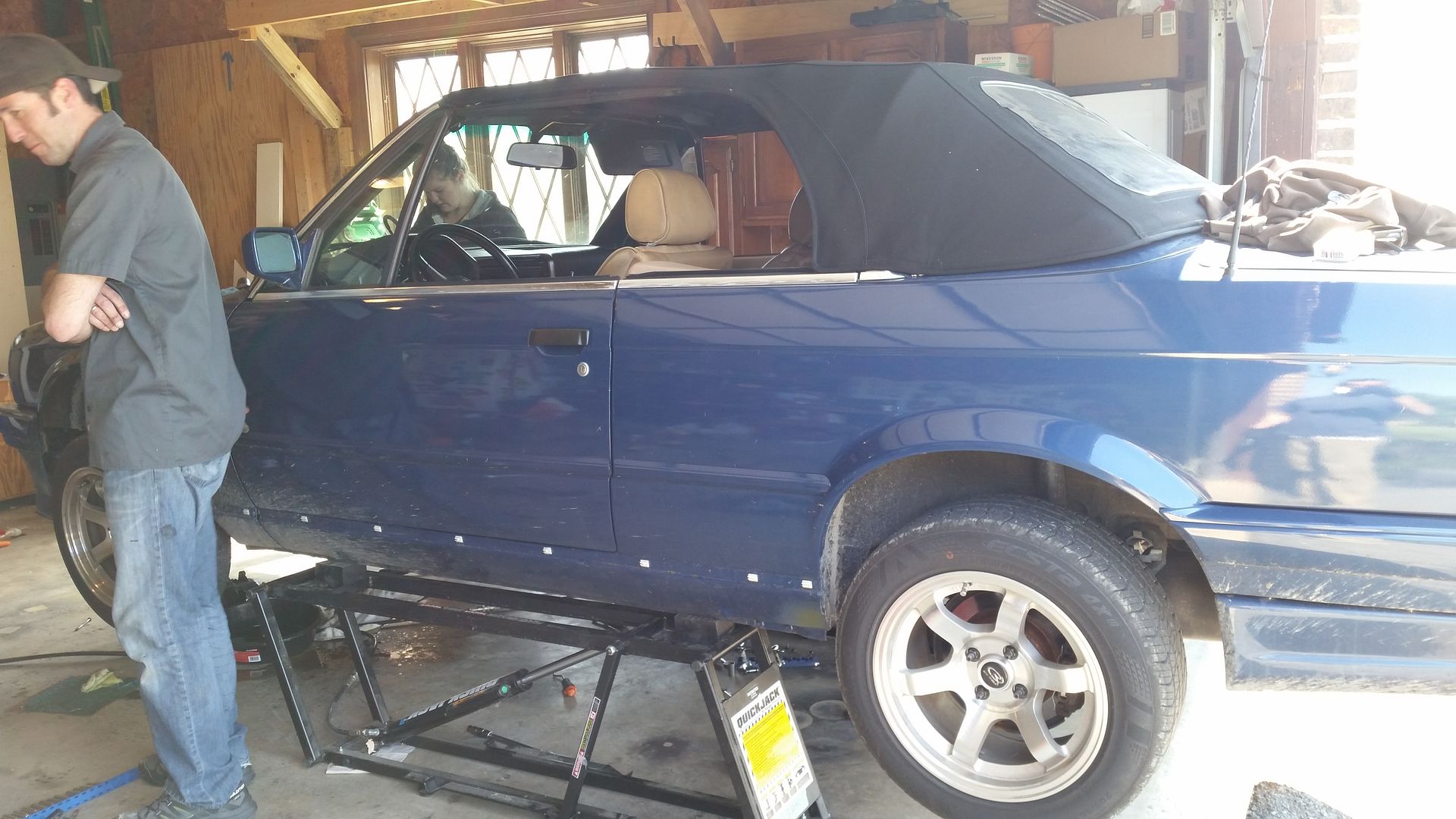

    SWAP DAY!

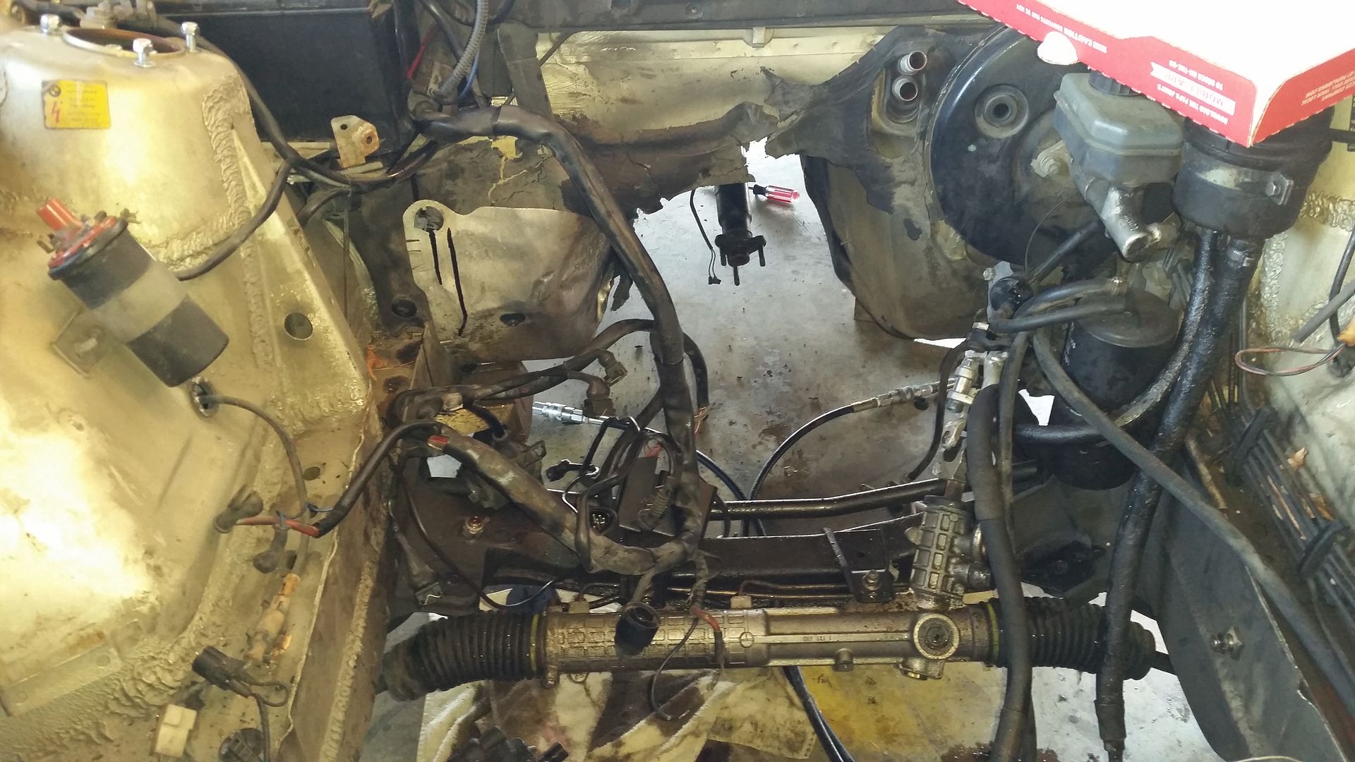

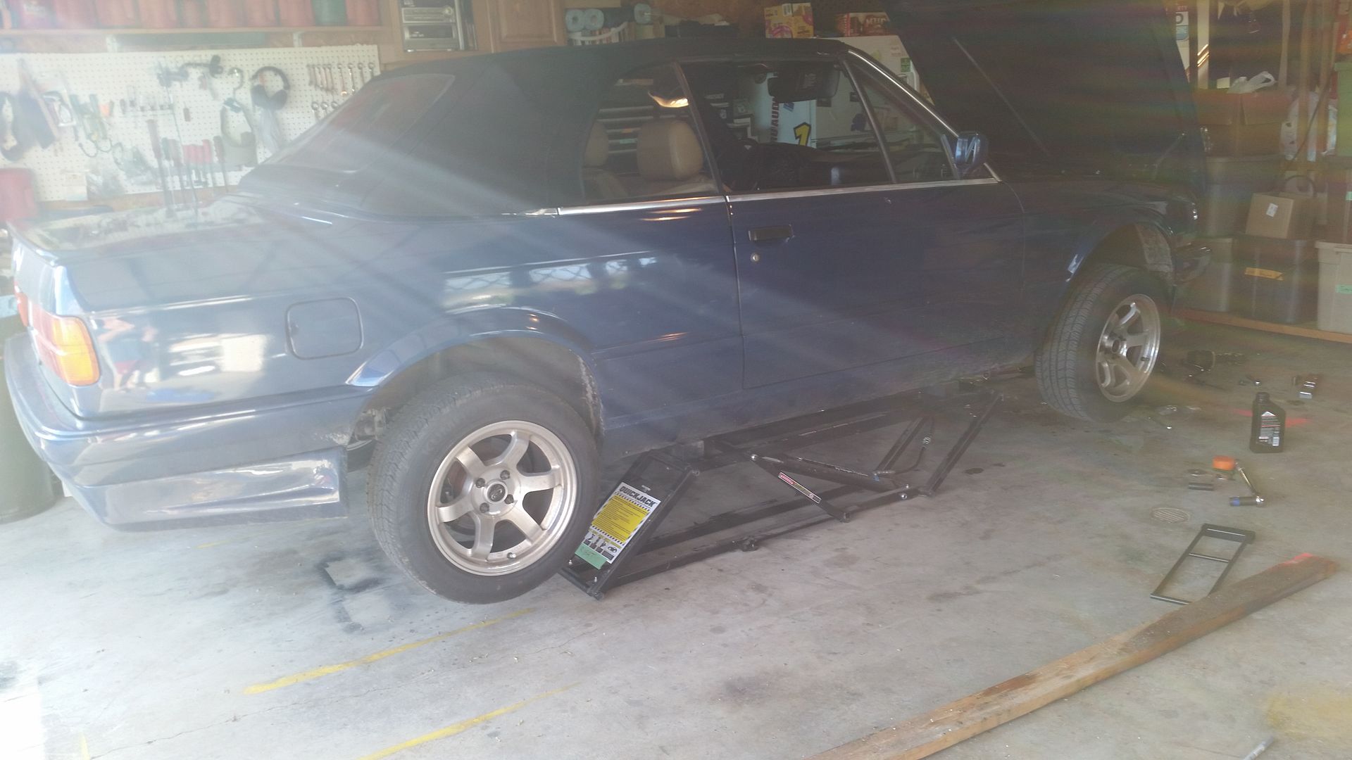

    Car up on the QuickJack to ease the disconnecting under the car:

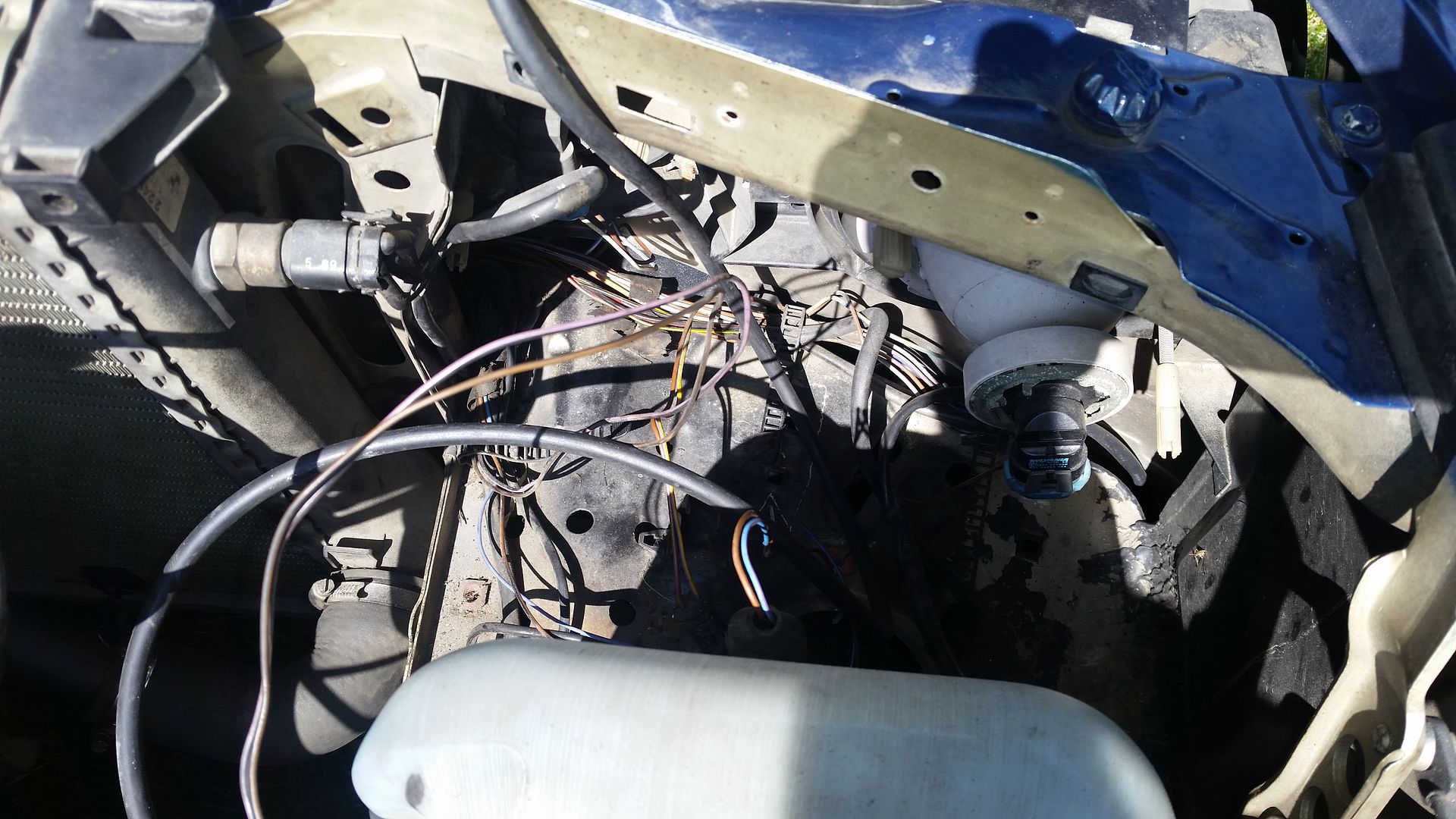

    Wiring laid back and disconnected:

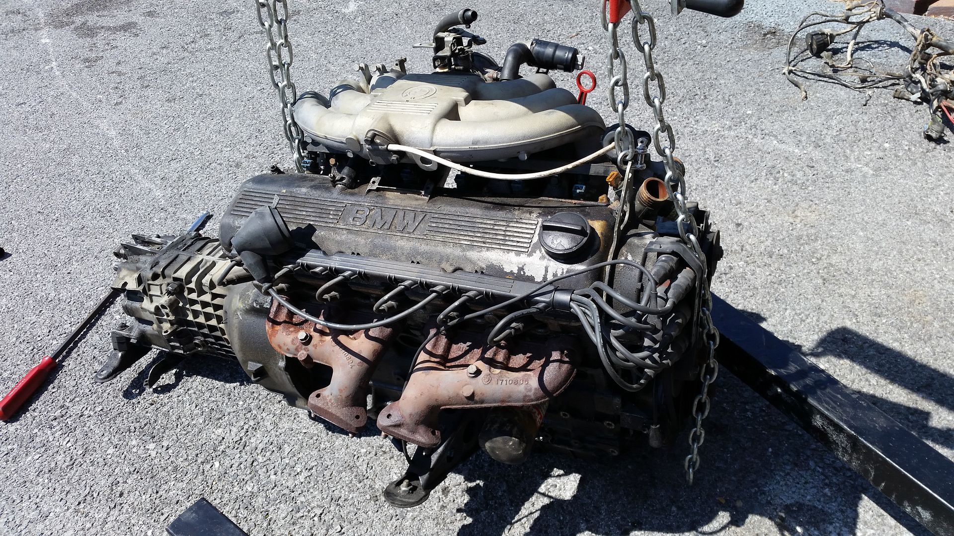

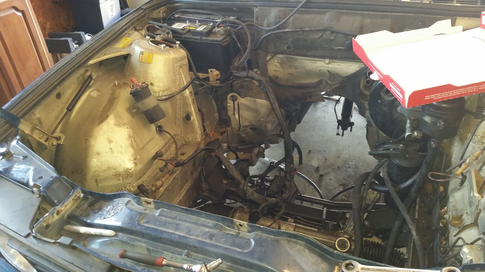

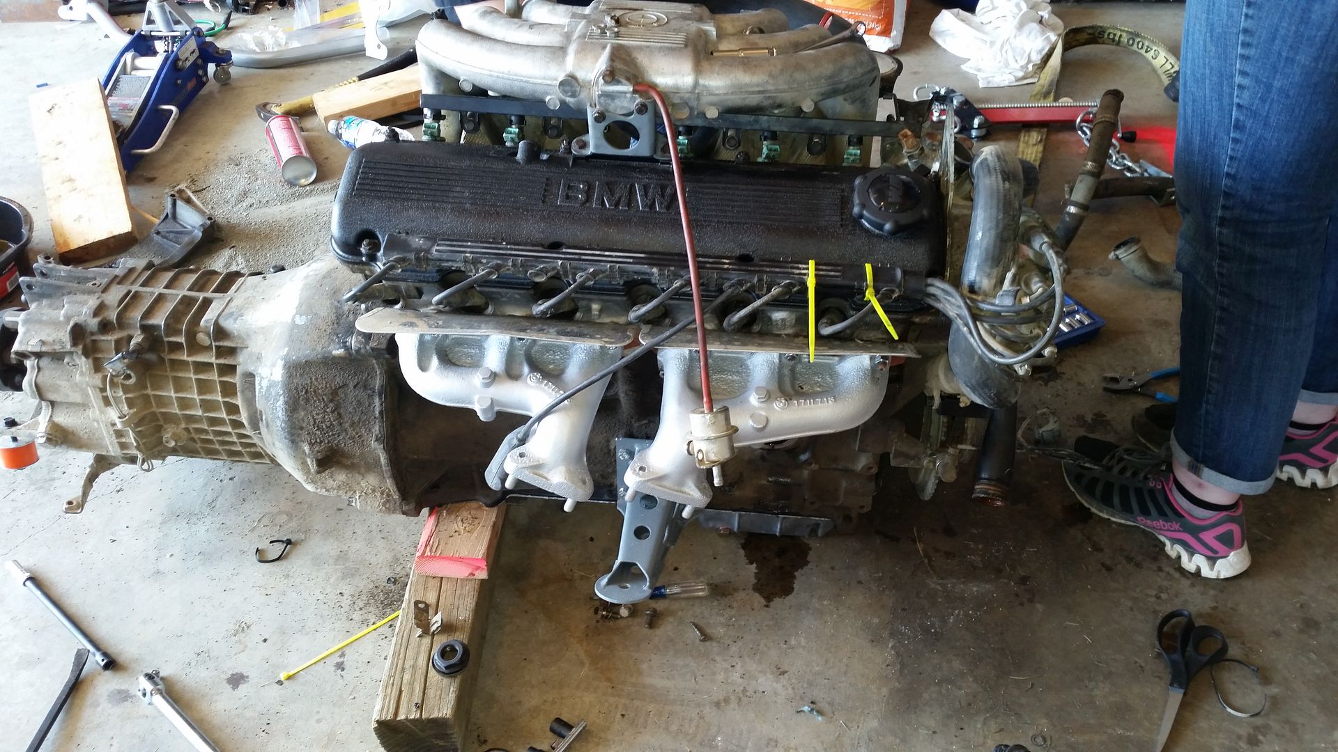

    Obligatory engine removal photo:
    Old Motor / trans out:
    We needed to pull some components and transfer them over but the motor was not terrible:

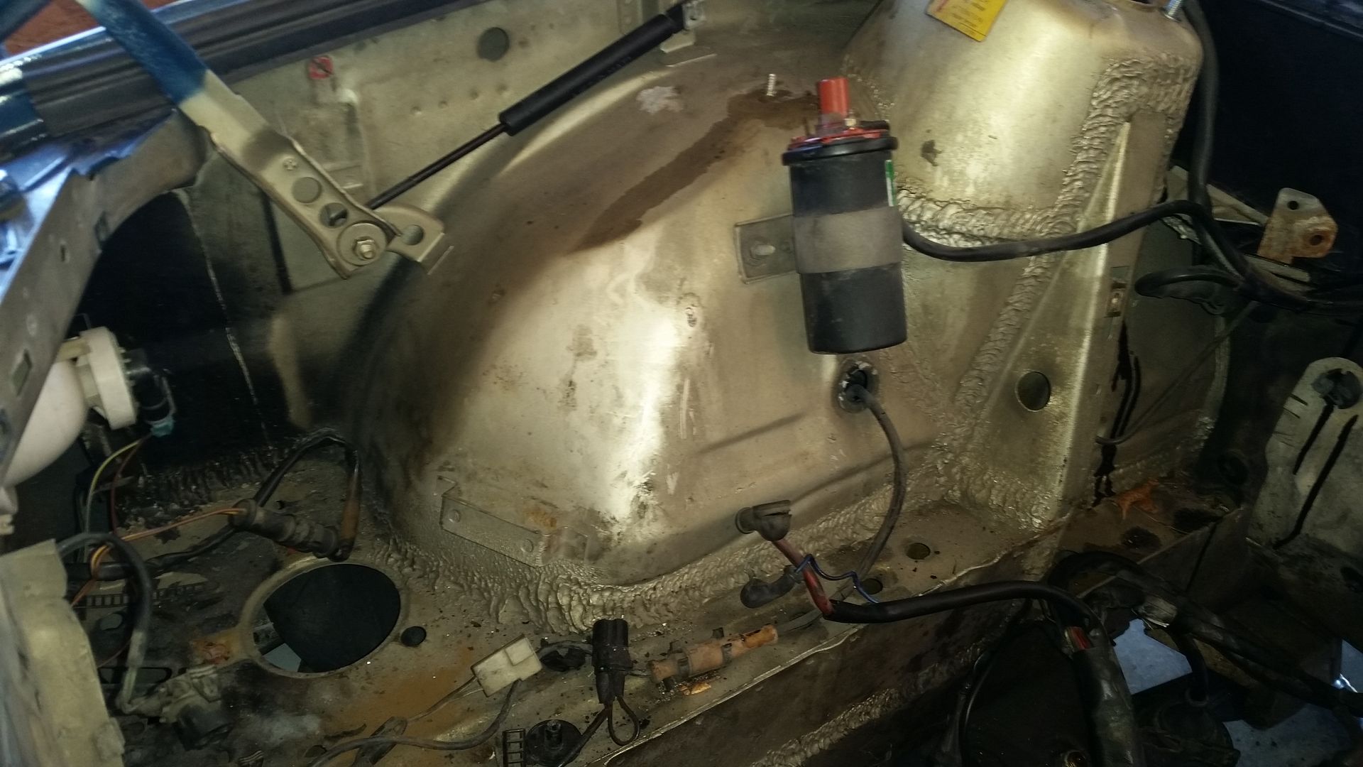

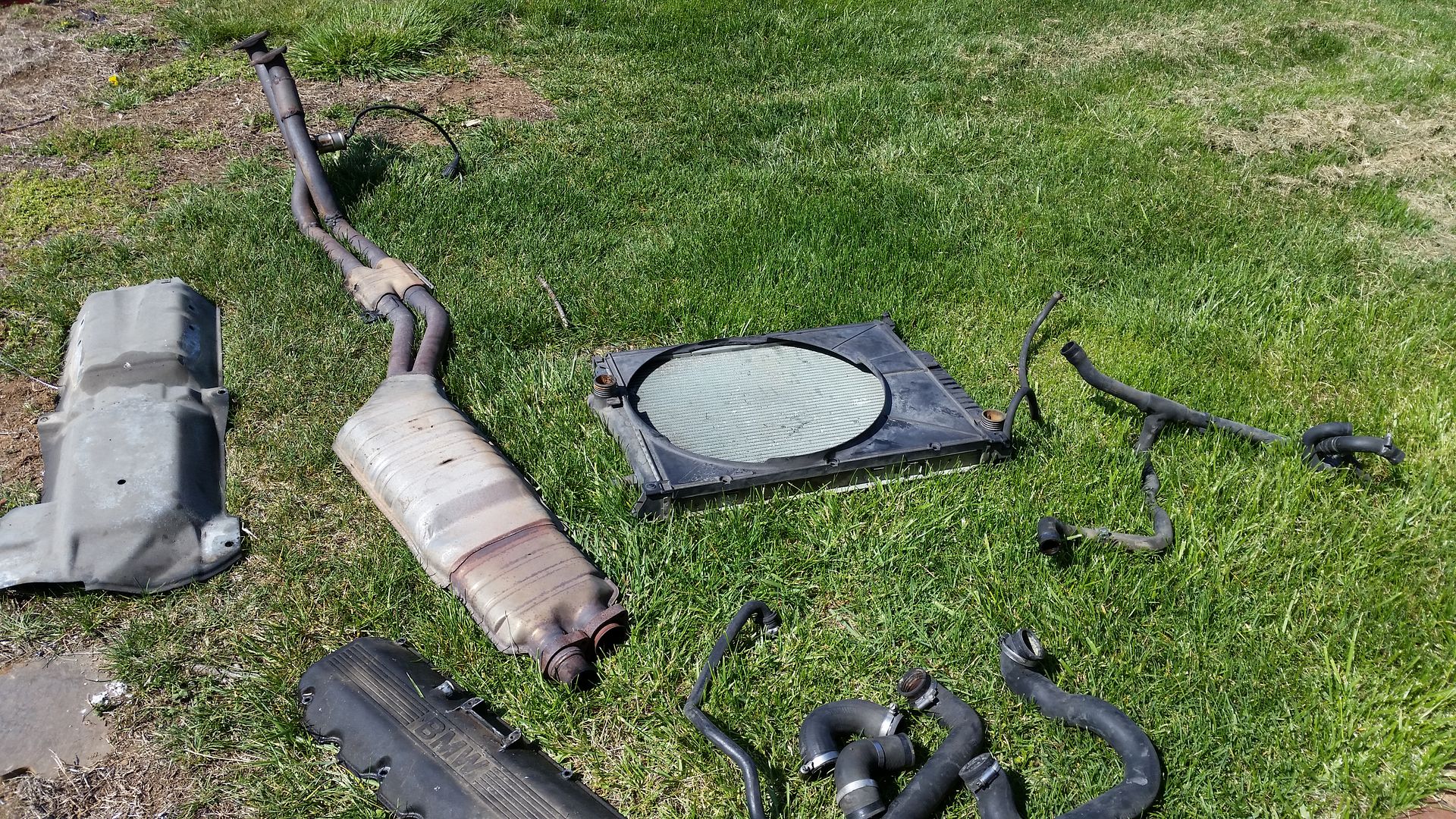

    I had not planned to pull the A/C parts but they were not functional and I can't see myself going through the addition of A/C. I did keep all of the lines and components but for now everything is out of the car. There was absolutely no charge in the system.
    It really cleaned up that side of the bay:
    Mandatory pizza break:
    We removed the transmission because we intended to swap the TOP and seal to my existing trans but then I decided to try removing my output flange and swapping it over. It worked without too much of a headache so we went with the new trans.
    We double checked the TOB:
    And the clutch / flywheel:
    Here is Josh re-installing the trans:
    Here are the 2 different small flanges, side by side:
    Parts pile:
    New motor almost ready for install:
    New motor in place:
    (Almost) all buttoned up:
    Cleared out passenger corner area:
    I'll need a new one of those...
    Electric fan conversion installed:
    Leave a comment:

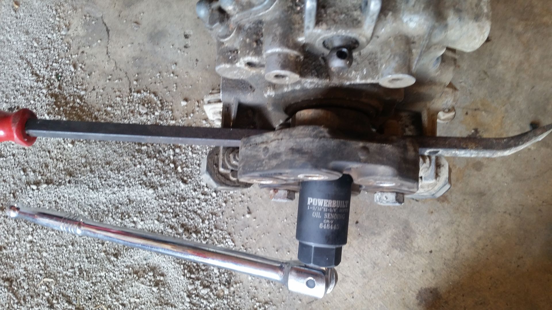

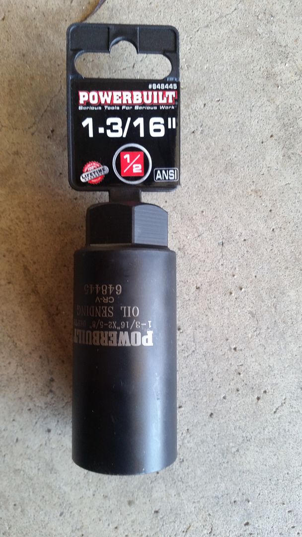

    I had also ordered the appropriate thin-wall socket to remove the nut, which was a huge PITA but did come off.
    The Powerbuilt 648445 socket:

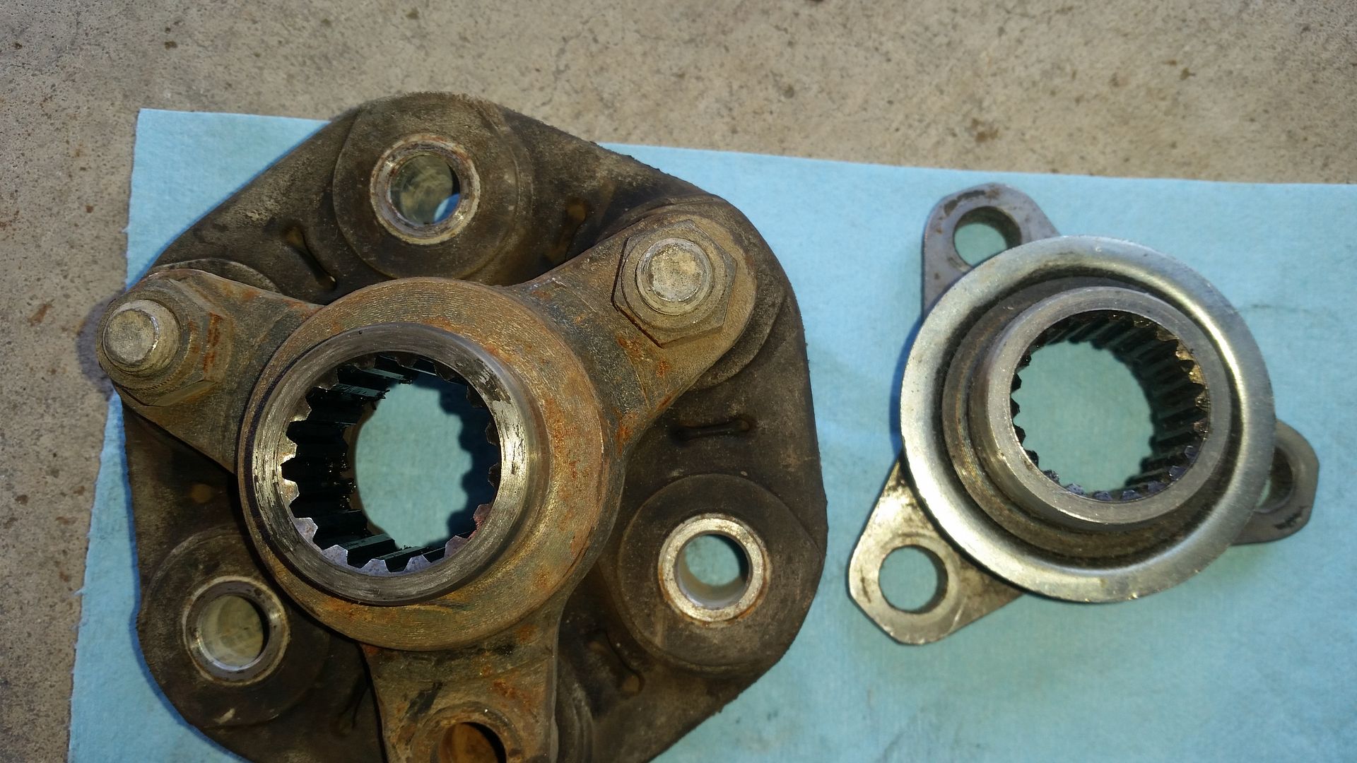

    The new flange (more in a moment) and a spare large output flange, for comparison:
    Notice anything wrong? Look at the splines. All wrong. The flange sent to me was NOT the right one. I was not aware at the time but it became obvious shortly.
    I removed the existing large flange from the new engine/trans with a breaker bar, a cheater bar, and some brute force:
    I tried to install the small flange, at which time I realized the issue with the splines. At first I was not sure whether the issue was with the fact that the trans came from an e28 or whether I had the wrong small flange. I had a panic where I had to come up with multiple options to resolve the situation. Options:

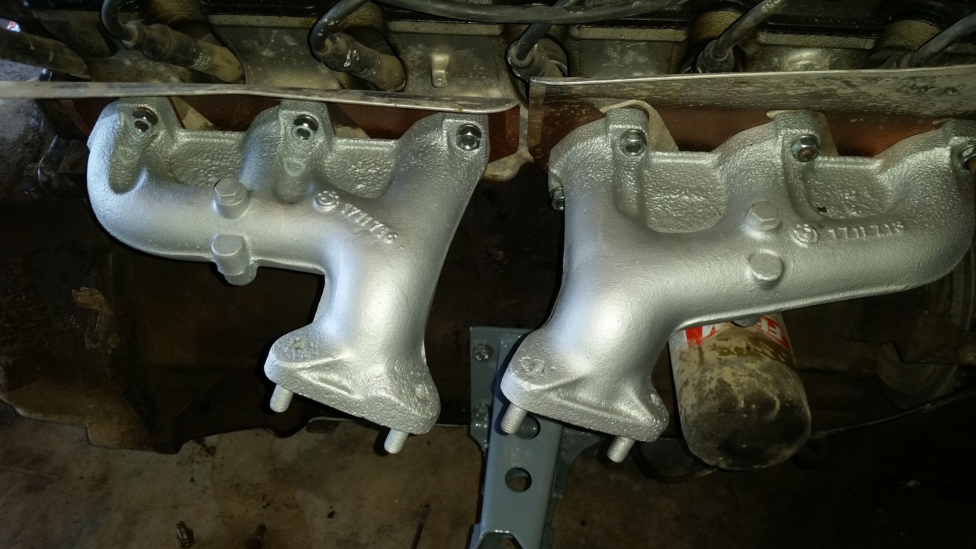

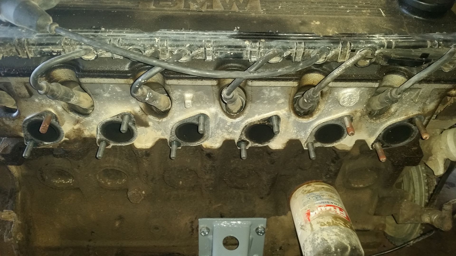

    I installed my missing exhaust studs and mounted the manifolds:
    At this point I was done for the night and was awaiting the AM push to swap the motor. I SHOULD have installed the fresh IM and valve cover that I had but for some reason I decided not to. I would have saved 15-20 minutes the next day but it was not a big deal.
