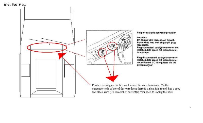

                Back when I had my 318is had the same problems. Every Vacuum hose in the system was destroyed . Replace them all, cleared up the mess under the intake. Still Idled only marginally acceptable. Theres a plug somewhere on the firewall of these 318is's , that will literally make your car run crappy. try researching it. If its plugged in, unplug it. I think thats what solved the shitty idle on my old 318is (New owner found it)
                  They are great cars, I always miss mine alot!
                  This diagram from M42club.com show's what Tim is referencing. Did it on my car and it helped out my idle issues.

                      Thanks for the advice fellas! I'd heard lore of that plug and I believe that it's unplugged on my car already. It's certainly not something that someone would think about to try though. I'll have to double check though.
