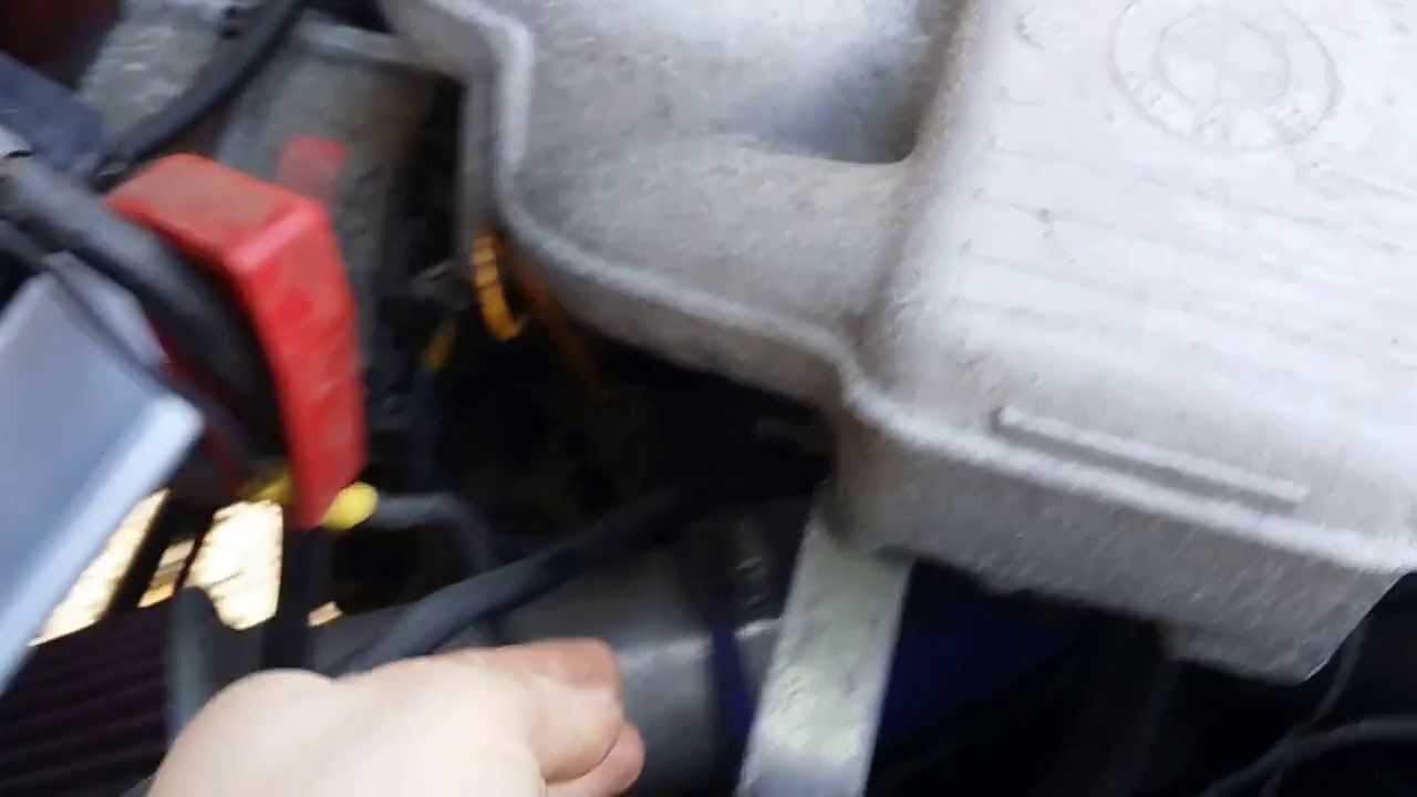

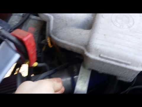

        I had bought this set of Epsilon wheels years ago for $200 picked up on eBay. I pulled them apart back then, sandblasted and repainted the centers gunmetal grey. They sat for a while and then my friend suggested that they might fit this car. Being early Porsche fitment, adapters were needed. I went with the Raceland 20mm adapters and I bought a wheel stud conversion on eBay. I had to machine the front adapters a bit and I 3D printed some hubcentric rings to make it all work. The tires are 205-50-15 Dunlop Direzza ZII.
        I later did a bit of fender rolling and pulling to ensure no rubbing.
        Last week I did a bit more work to the car, zip screwing some sheetmetal down to the floor to cover the heel sized hole that the accelerator pedal was hanging though, pulled out the center console because it was kind of ugly and none of it worked anyway, I installed an M20 throttle body, and I changed the squeaky fan belt.
