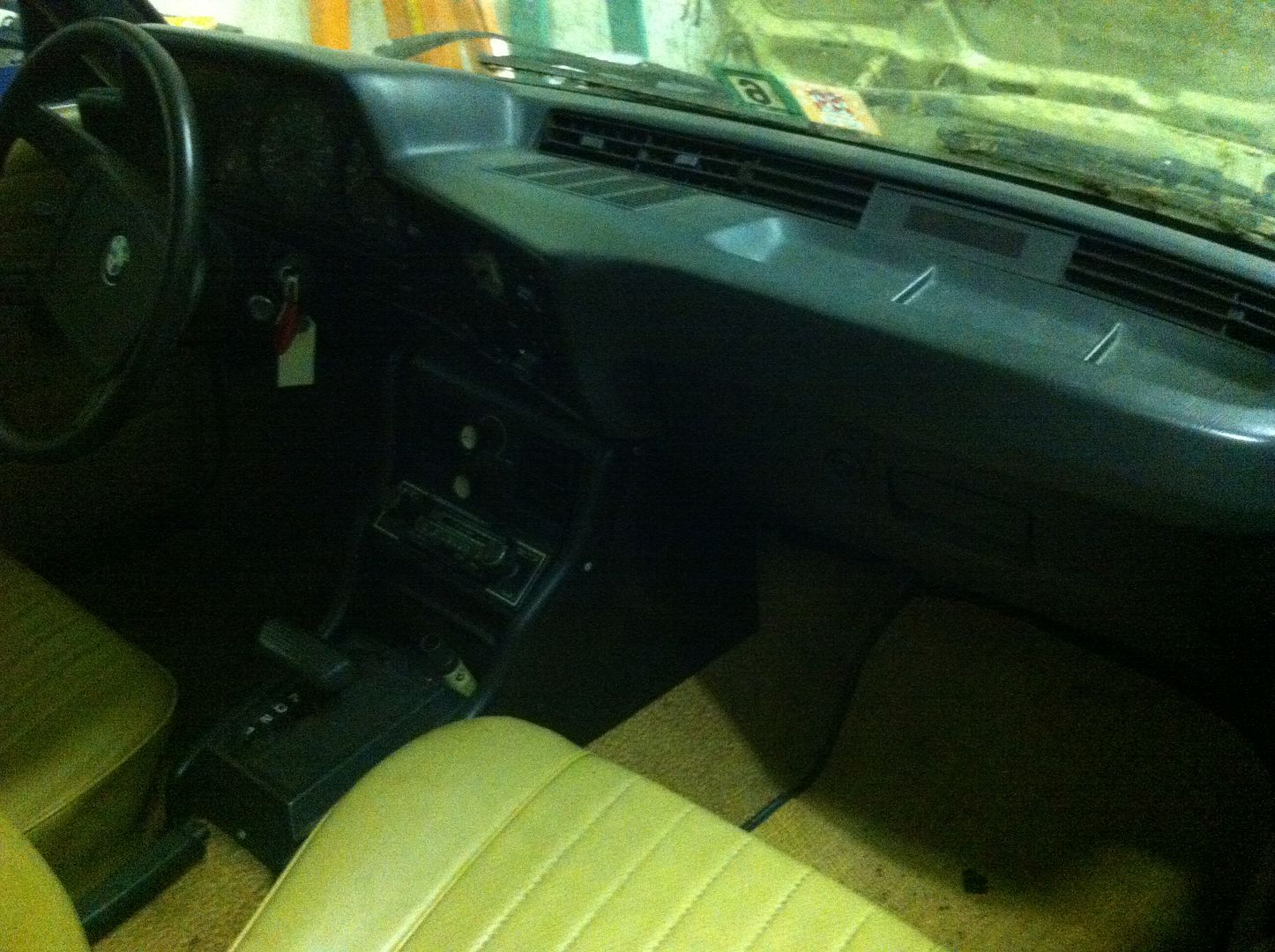

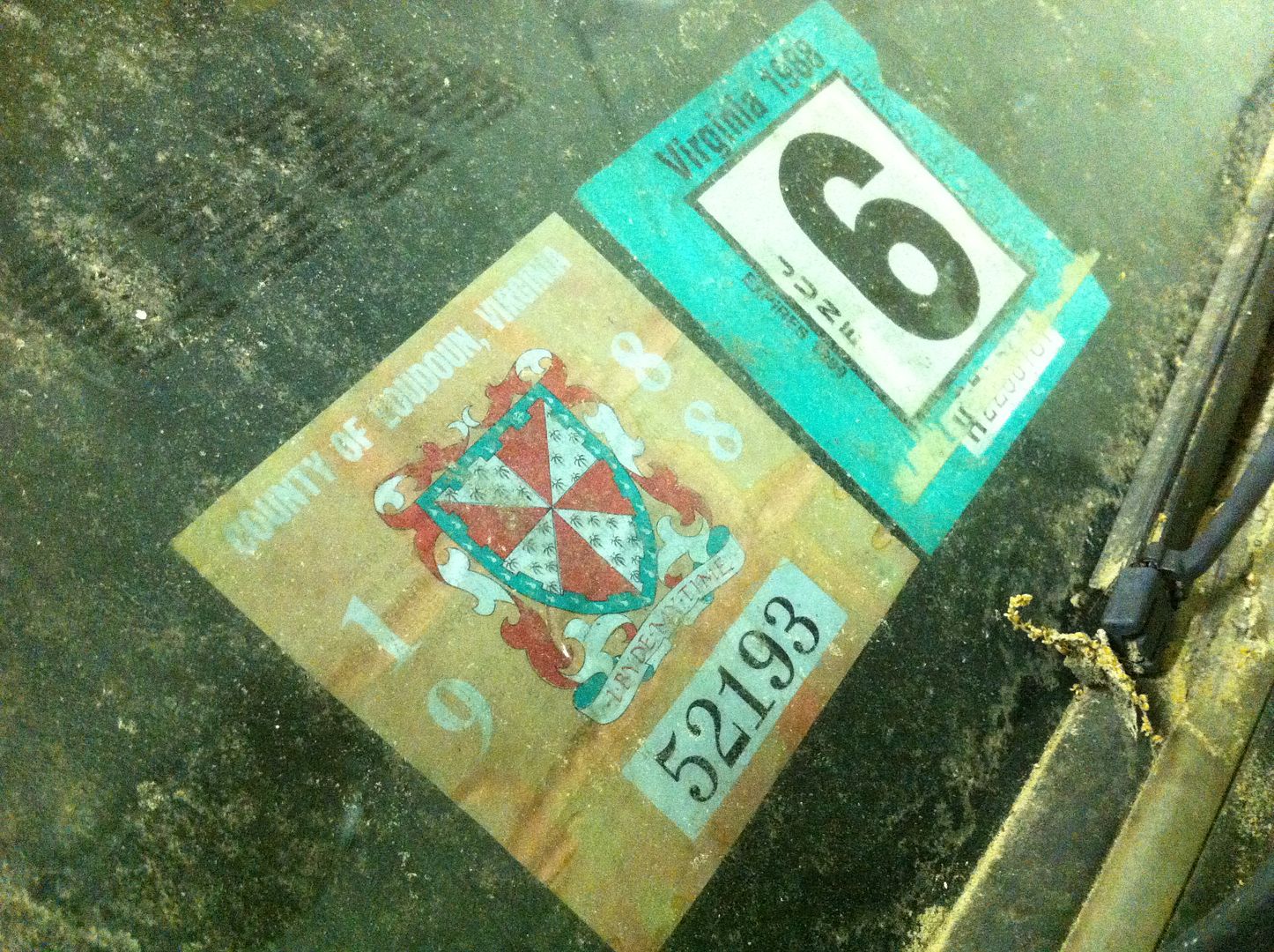

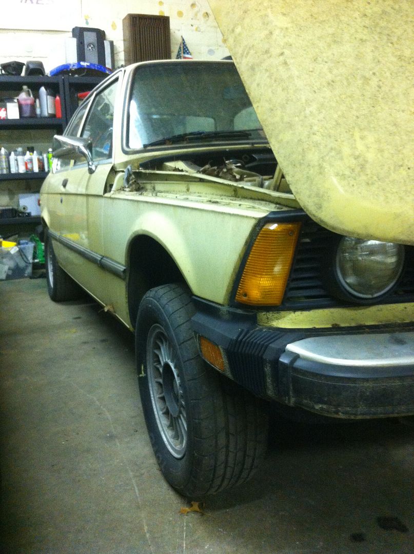

    I bought this 320i from a buddy of mine that was "thinning" his herd of vehicles. It was a package deal along with a 95 318is. It has been sitting in a garage up north somwhere for more than two decades. Hasn't seen road use since 1988 (at least here in VA). At some point the M10 crapped out so it was pulled. The previous owner started getting all the things replaced on it that usually go bad when cars sit but then lost interest again. I am going to try to keep it as close to stock as I can with the exception of the wheels and suspension. An M42 drivetrain will be swapped in along with a hybrid getrag 245/ 240 or just a 240 if I can't find another decent 245. The color is Seirra Beige and while it looks like cat piss now I think it will clean up decent. All the important stuff is there, chrome, nice dash, all the switch gear, had 77 brakes already swapped in, cleaned and resealed gas tank and it has a really nice set of seats. This project will be fun for me then it goes up for sale. Shortly after I bought this E21 a 69 1600 came up for sale and I will be turning my attention to that car. This 320i would make someone a really cool bmw just to enjoy driving for what it is without having to worry about the body, paint etc.

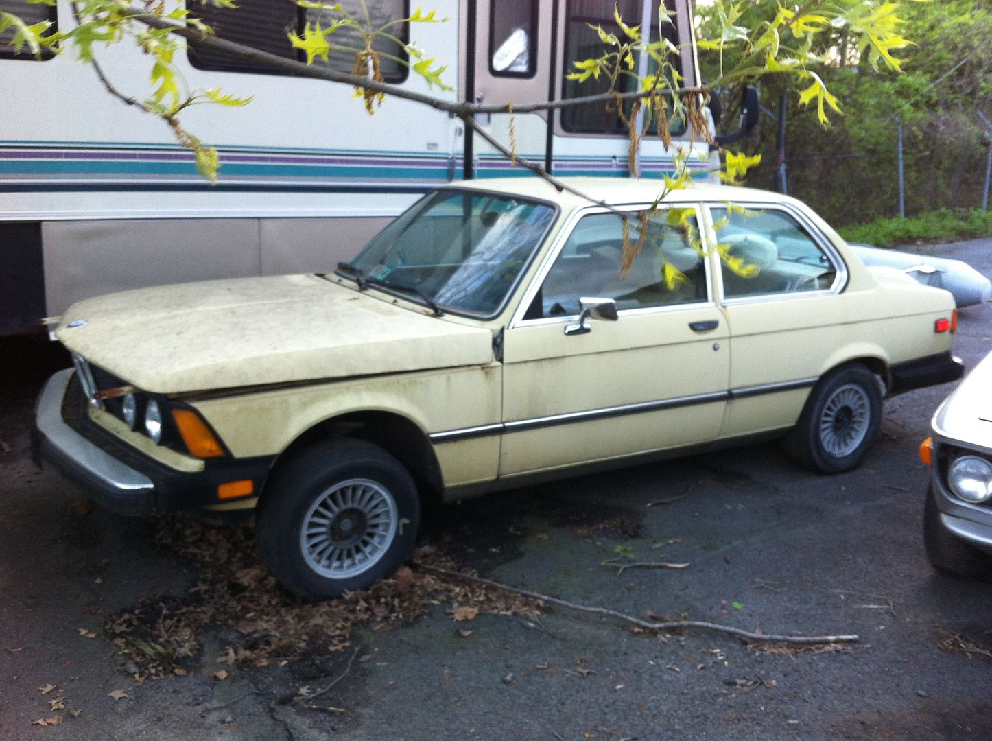

    This is where it spent the last three years after it was removed from storage.

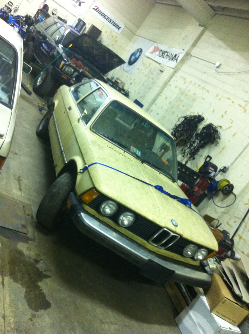

    Here's some pics just after I brought it to the shop:
    This poor E21 has waited a looong time to do what it does best!

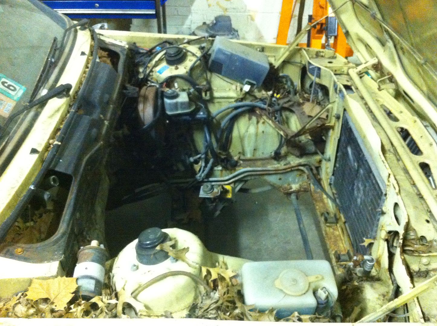

    Nasty Nasty engine bay, some rust in there too but nothing I'm really concerned with.

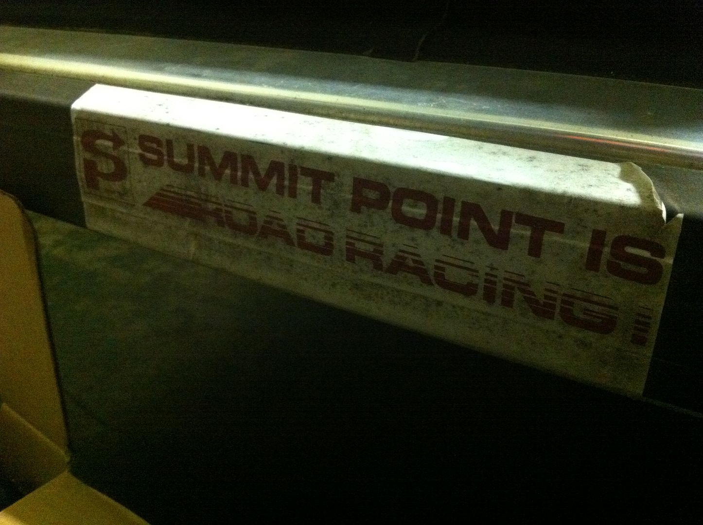

    Totally rad Summit Point sticker, I hope this lasts because I am not taking it off. Way too cool and period correct.

      That bumper sticker rocks!

        I know it's such a neat thing to still have it on the bumper after all these years.

              Right now I really really need an E30 upper and lower M42 pan so I can test fit the engine and build my mount arms. I am going to try making arms that you don't have to modify the subframe to use.

                Send a copy of it (bumpersticker) to Vistaprint or some where like that and have a couple of new ones made up.

                  you're also welcome to bring your subframe over here and use my engine to mock it up (my engine is on a stand, that's how I did it). I found that modifying the subframe was extremely easy though. Again, if you want to come mock it up, you're more than welcome.
                  I'd offer to loan you my oil pans but my upper pan is already on there with ultra gray so it's not coming off anytime soon ;D
                  You'll have to grind down a few ribs off the back of the upper pan to clear the steering rack (which I assume you already know but might as well remind you).

                      btw, if you ever get that Summit Point sticker re-made, get me a couple!

                        Cool car. And I wouldn't mind me a couple of those Summit Point stickers too :D.
