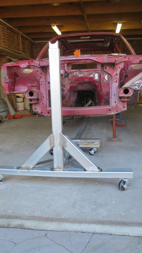

                        Finally have some updates on the build, been busy teaching myself how to TIG weld.....Which felt like I'd be crap forever!
                        Here's some pic of the rotisserie that I've nearly finished..
                        Welding all that up gave me so much experience in controlling heat and managing my puddle. Next up is to finish the rotisserie and hook the car up to it and start soda blasting the crap out of it and cutting out rust and welding it up.
                        sigpic Build Thread - http://www.r3vlimited.com/board/showthread.php?t=345799 -

                          Taking my sweet time....
                          Through my massive post uni degree break I sort of dragged my feet with the car.... Upon finding out I'd gotten a grad job at a massive fastening company in Melbourne, it made me kick my self into gear and get some stuff done. I'll let the picture do the talking..
                          Finally got my rotisserie finished and painted
                          Just trying the figure out the best way to mount the bracket on the car without damaging the body..
                          Started welding the body where rust was a serious problem
                          Still need to smooth over some parts and maybe do another weld pass.... This was probably the hardest part to weld as getting it sit in place and not move was a challenge and then welding it another!!
                          Fun fact about the donor piece going in. The replacement piece had a lot less rust on it that got cut out, whilst trying to figure out how to bend and shape a new piece to weld; I'd gotten wildly frustrated with my lack of skill. 5 minutes later dad come walking in a uses a panel beating hammer and dolly + blowtorch and shapes within a couple of minutes
                          I know the weld's aren't the best but with my tig welder not being able to use a pedal controller, I'd often have to do a couple cold weld to now blow holes in the metal.
                          Whilst the welding was happening I thought I'd strip the interior of any paint and insulation to find more rust and surely I did
                          This stuff worked wonders stripping paint!
                          After I've got all my welding done I'll be taking the car to a sandblaster to have it stripped so I can get it ready for under-sealing and paint :D:D:D Any comments and suggest are welcomed!
