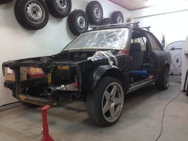

    Back i 2011 i bought my self a 1990 mod BMW e30 320i. The car came with a lot of parts like complete original m tech 2 bumpers, sideskirts,wing , new front fenders, exhaust and so on.
    The previous owner had changed the rear inner and outer fenders. And i was told that the car was almost ready for paint. After some time i found out the there still was a lot of rust and the car was far from ready to get painted.

    The pictures in this first post is what i did on the car before i went to college

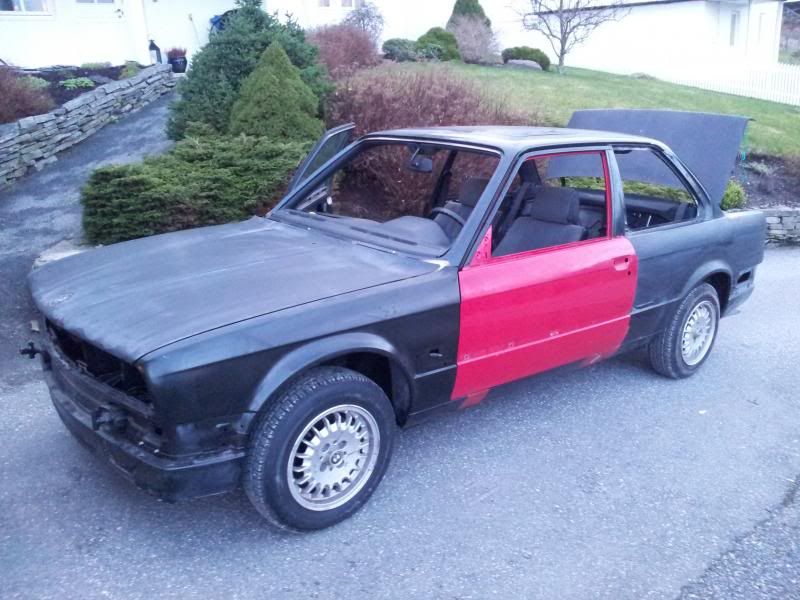

    The day i baught it.

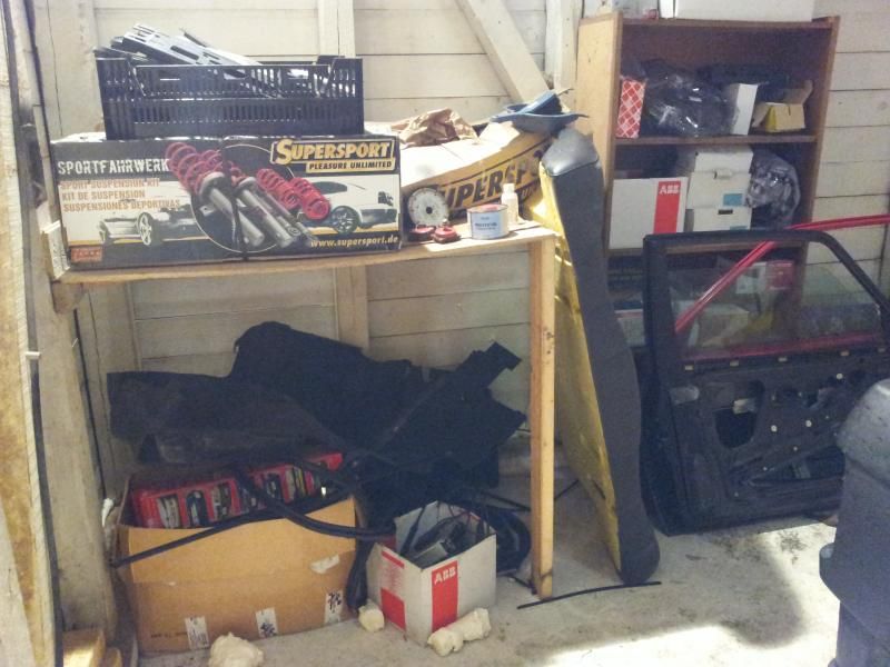

    Parts
    Test fitting the m tech bodykit

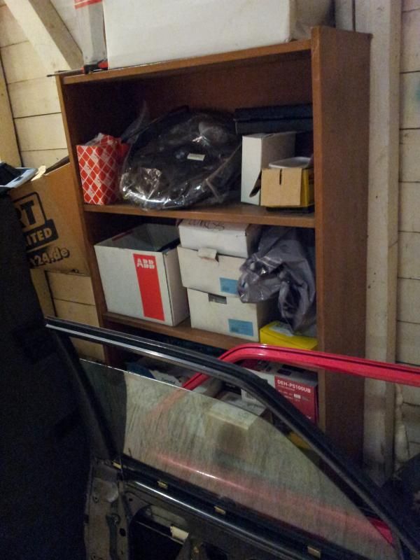

    Doors in god condition
    Driver side
    Passenger side.

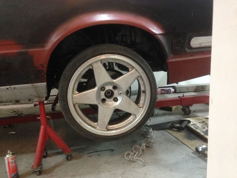

    Rolled the fenders.
    BSX 16x9

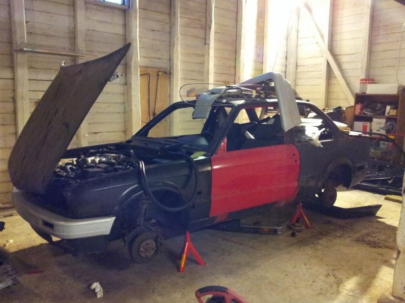

    Thats about it.. The car got stored in my dads garage till JUNE 2014.

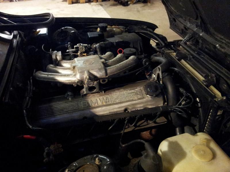

      Her is a update on what i have done after i graduated college. The next updates will come along the way when things are done. :)
      First ting i did after i graduated was to by my self a BMW e46 320DA Sedan.
      The plans have always been to change out the m20b20 with something bigger.

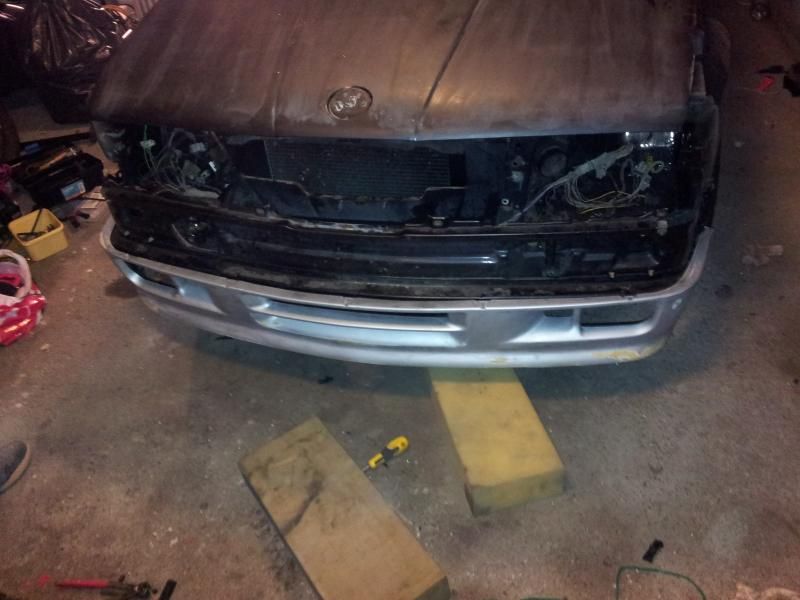

      Disconnecting the engine harness
      BAM
      Front suspension out !
