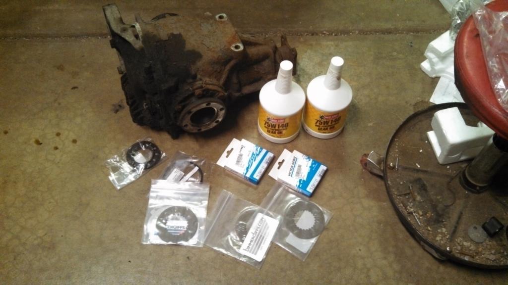

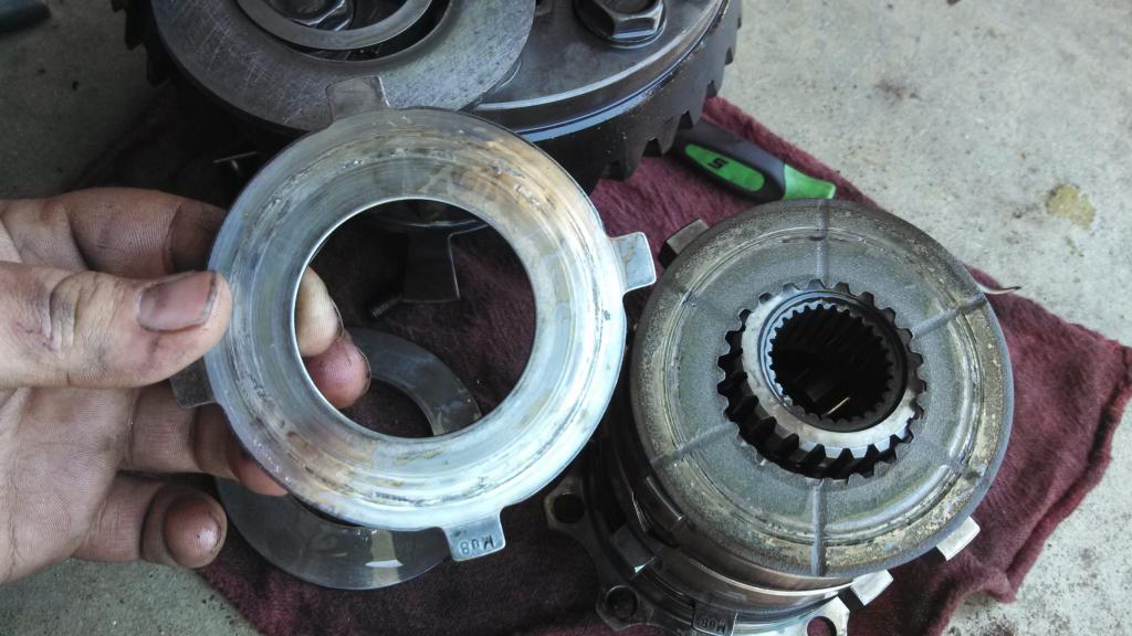

      Diff was rebuilt last fall and upgraded to a triple clutch using clutches from bummerdiffs.comClick image for larger version
ID:	7173670Click image for larger version
