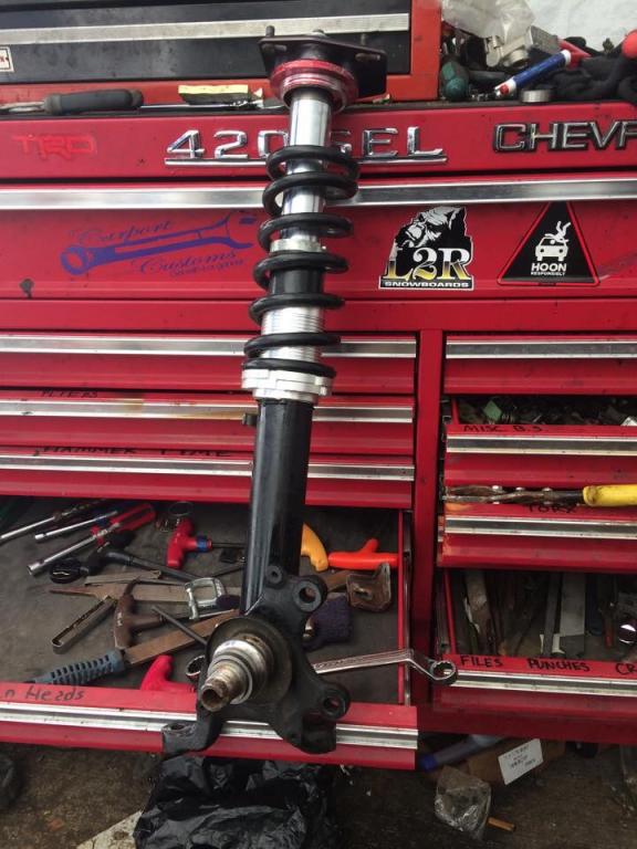

SUSPENSION GAME-
Bought 6 cyl. Strut housings
2 1/2" ID 240sx rear springs
GROUND CONTROL camber plates(love everything made by them! Highly recommend all GC!)
325ix biLstein HD strut inserts
- I cut approximately 2" out of the strut housings, welded them back together, ground welds down and welded adjuster perches.
Bought IE 25mm front 22mm rear swaybars with billet rear sway mounts
Solid steering guibo (plan to lower my steering column around an inch or so?)
Eibach 750 rear springs (want shorter springs with same rate so I don't have to cut these:/)
Oem replacement rear shocks

SUSPENSION GAME-
