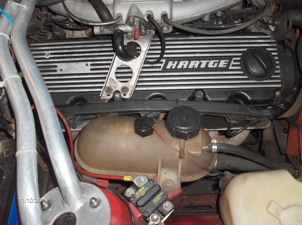

    First I see the hartge valve cover, and strut bar..Ok I could always sell those for some cash. Then I could not help but check the side of the head, just to see what I might have. At first, it was so dirty, I saw nothing, but then after some spray cleaner...there it was on the side of the head 'h26' Hartge. So I knew I had at least bought a car with a few good parts:).
    Then the fun began. Started talking to lots of people on the forum: Raul ,Barron, Scott, Ryan, and others. These people know their hartge cars. First thing Raul said was check for the oil cooler sticker....yep oil cooler and the blue sticker. Then the rear strut bar.....yep there. Suspension, yep the hartge blue springs...in terrible shape. Last of all, I checked for the hartge headers...yep still there...not in very good shape.

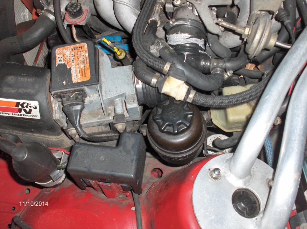

                      Next: I decided that instead of just fixing the one gas leak I would change out all the rubber lines and the vac lines...how do you like that intake boot....fixed that the week I got the car.
                      Now the only problem was when I fixed all the vac leaks the idle was bout 1300rpm. So, I figured the timing was advanced....yes that was the problem! I took the car in to have the timing belt done and it was 13 degrees advanced. Few other crazy problems like the bent throttle bracket were fixed and now the idle is at 800 and runs great.

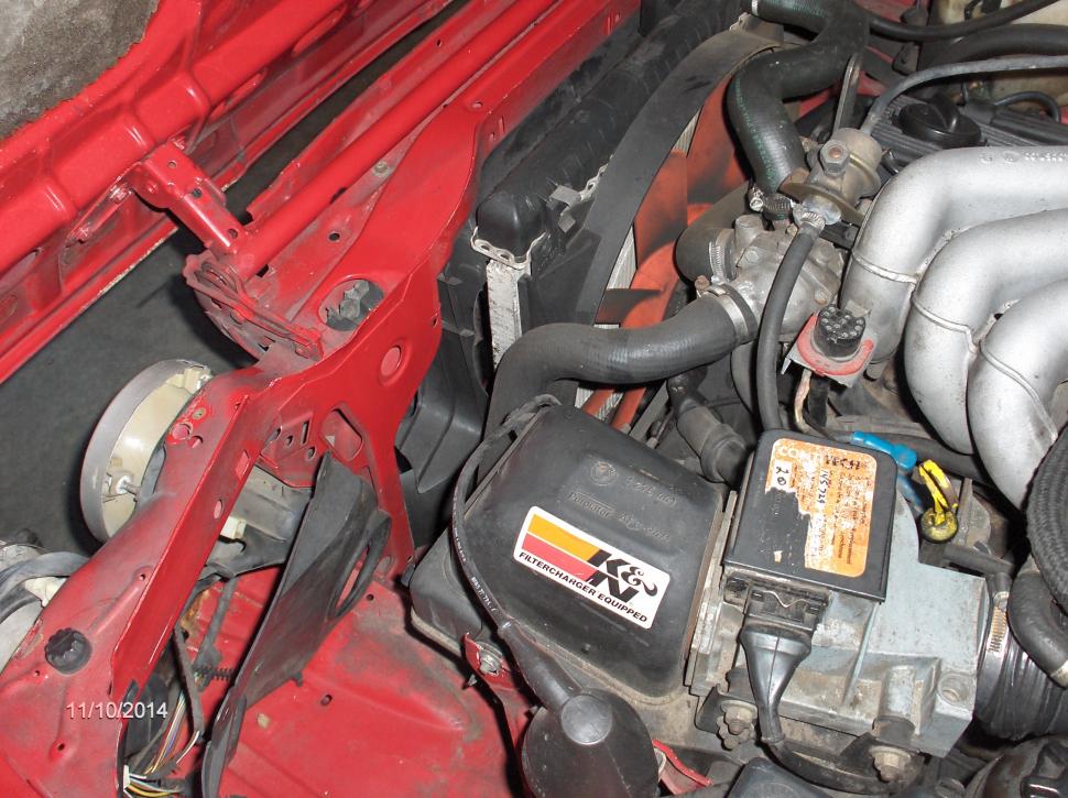

                      Might mention here that during this time of November I pulled all the parts I could get off the front of the engine so I could check the timing belt...
                      I cleaned everything and put it back together along with a good used alt...the one in the car was shot:).
                      Not sure if you can see where the throttle bracket was bent. Not sure why it was that way, but now everything is back to normal.

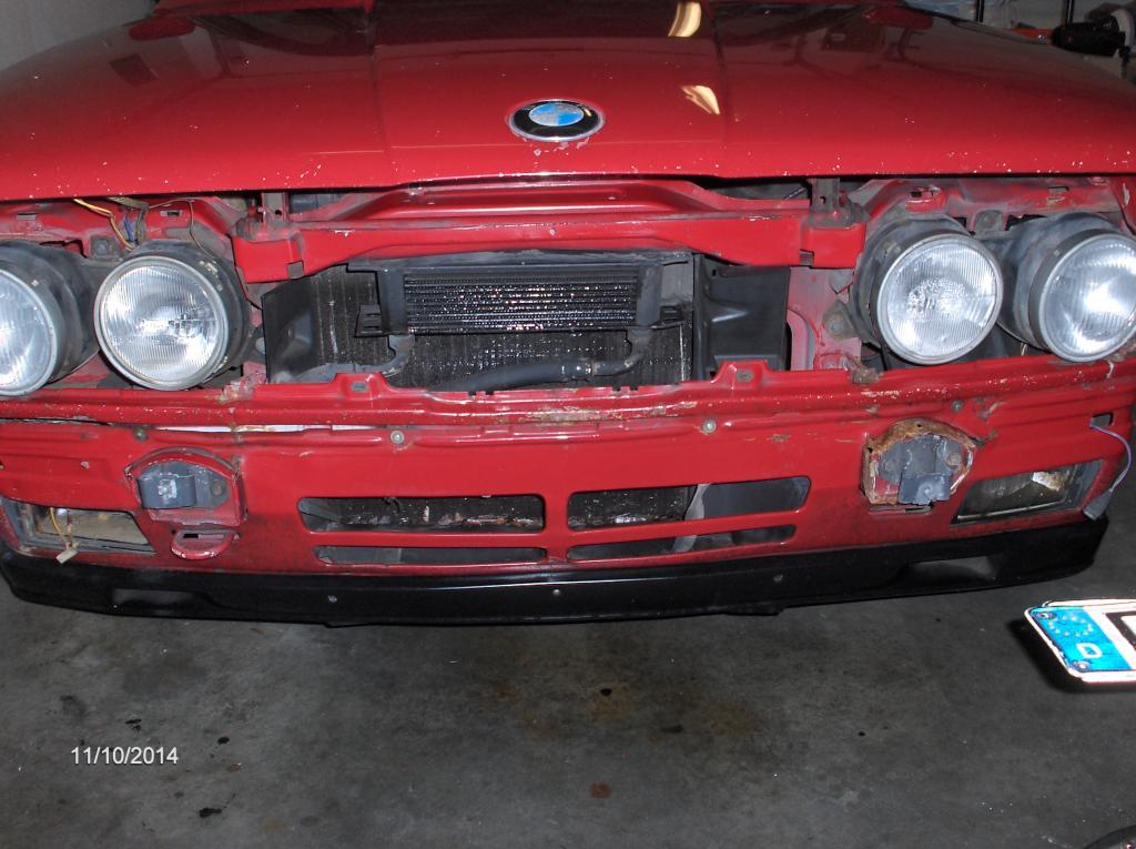

                      Might mention that everything you see in the front end picture that would come off was taken off and cleaned and sanded and repainted:)
