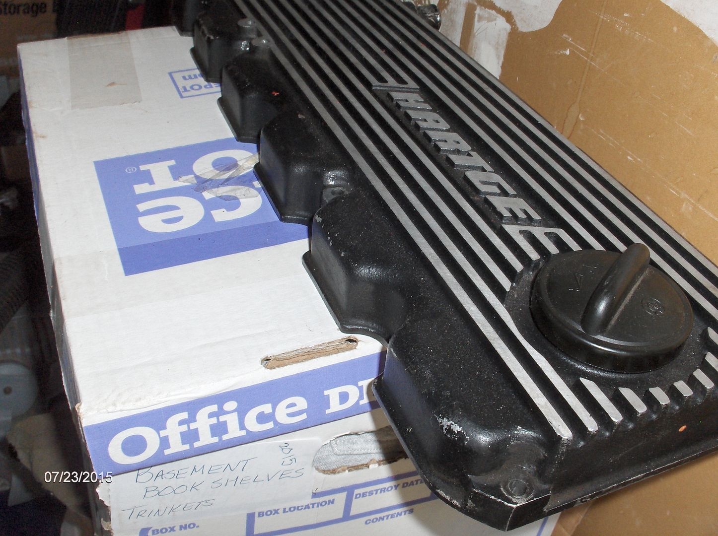

    Here is the next item to be put on the car after the valve cover goes back on tomorrow.......
    Might just paint the valve cover for now. Power coat is 95.00 plus shipping.....

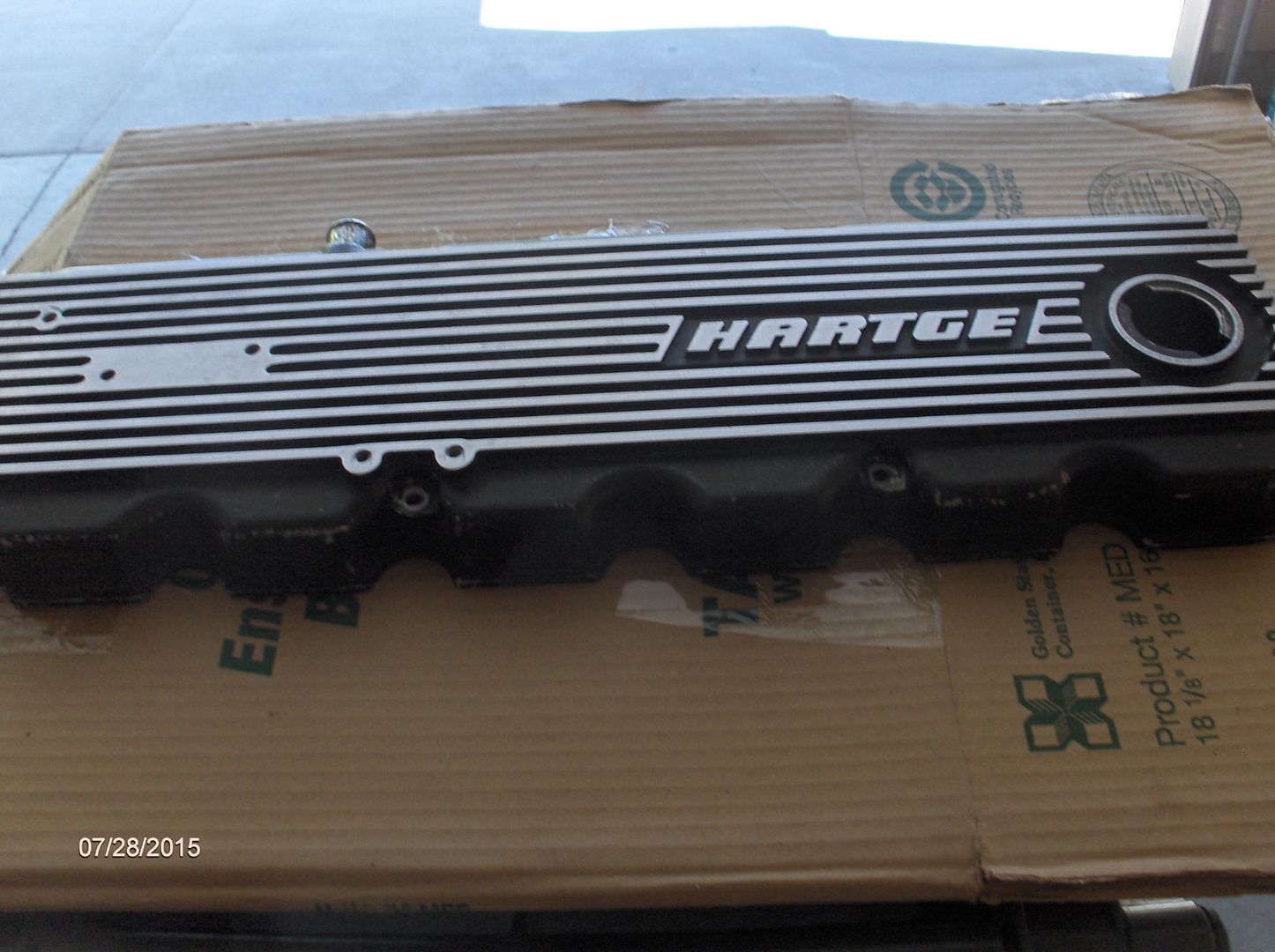

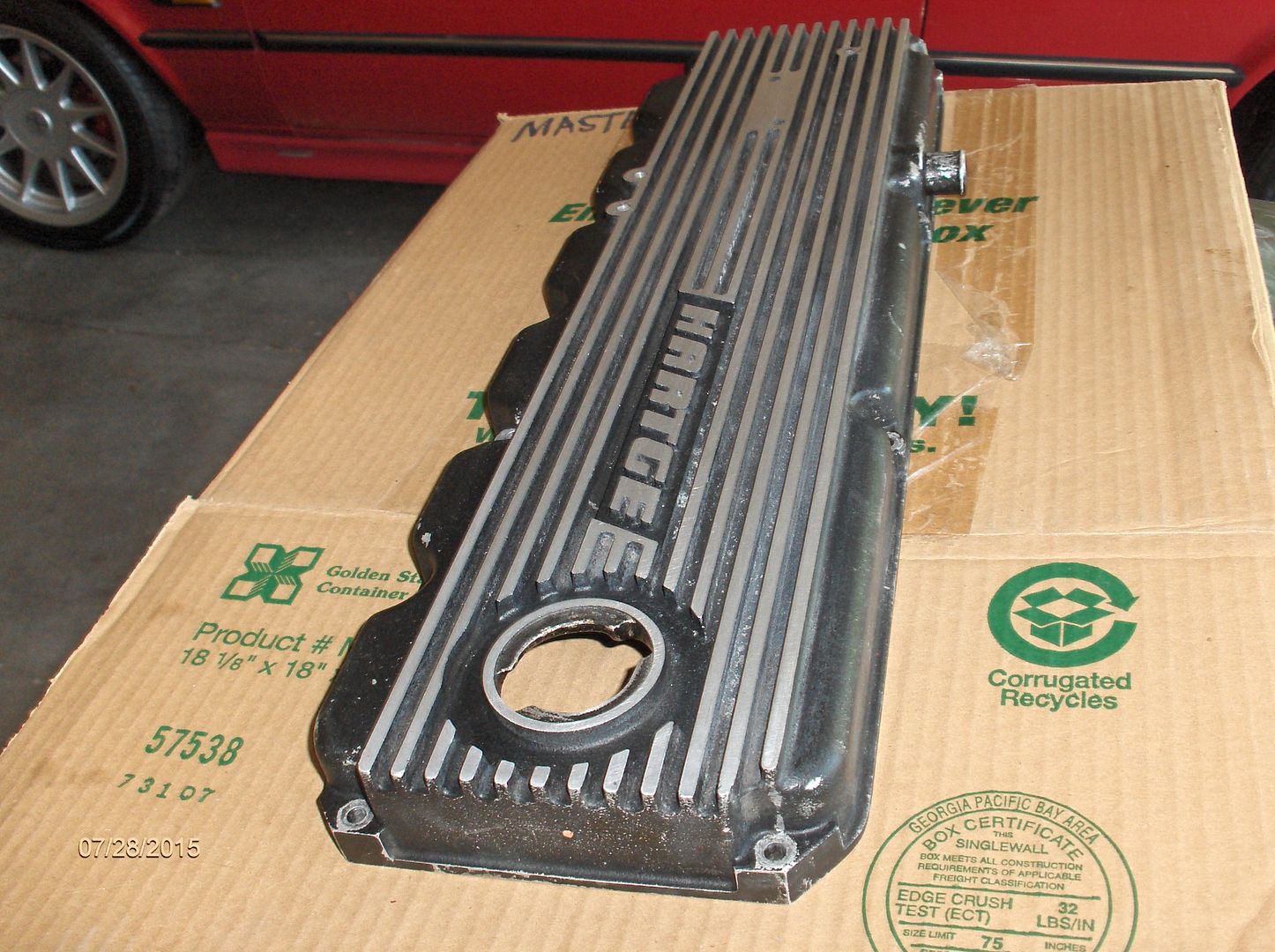

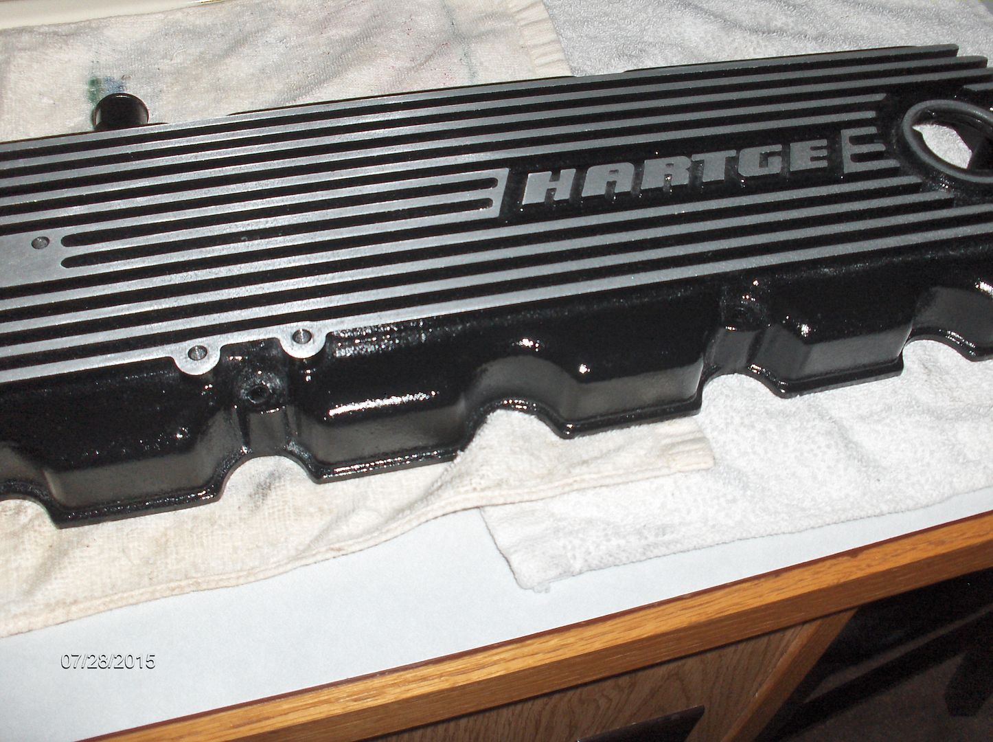

              valve cover done
              Got the valve cover painted, will get pictures up soon. Turned out pretty good...not as good as powder coat, but will do for now....
              Will take it out tomorrow for a little fun drive....finally:)
              jm

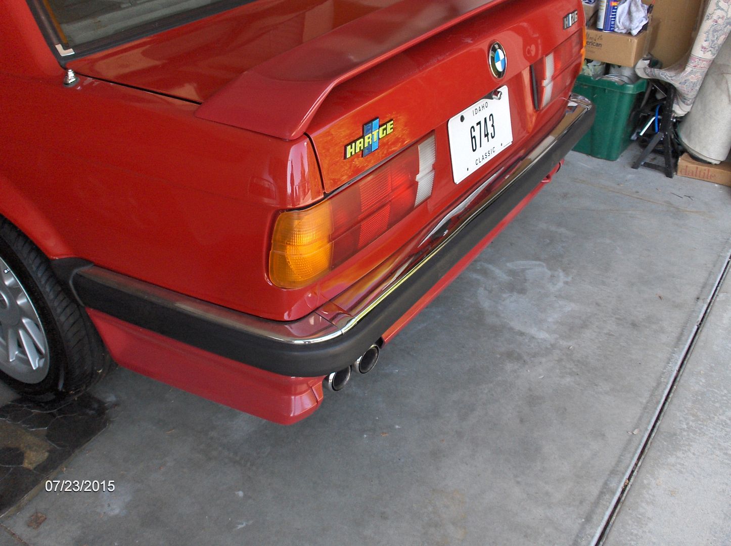

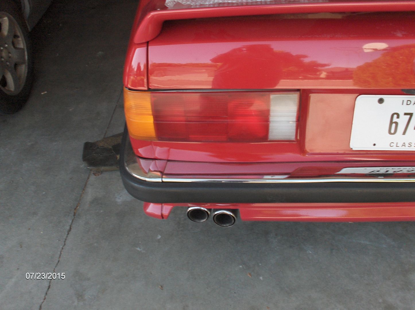

                    #249
                    forgot to post this:)
                    one more hartge part on the car:)

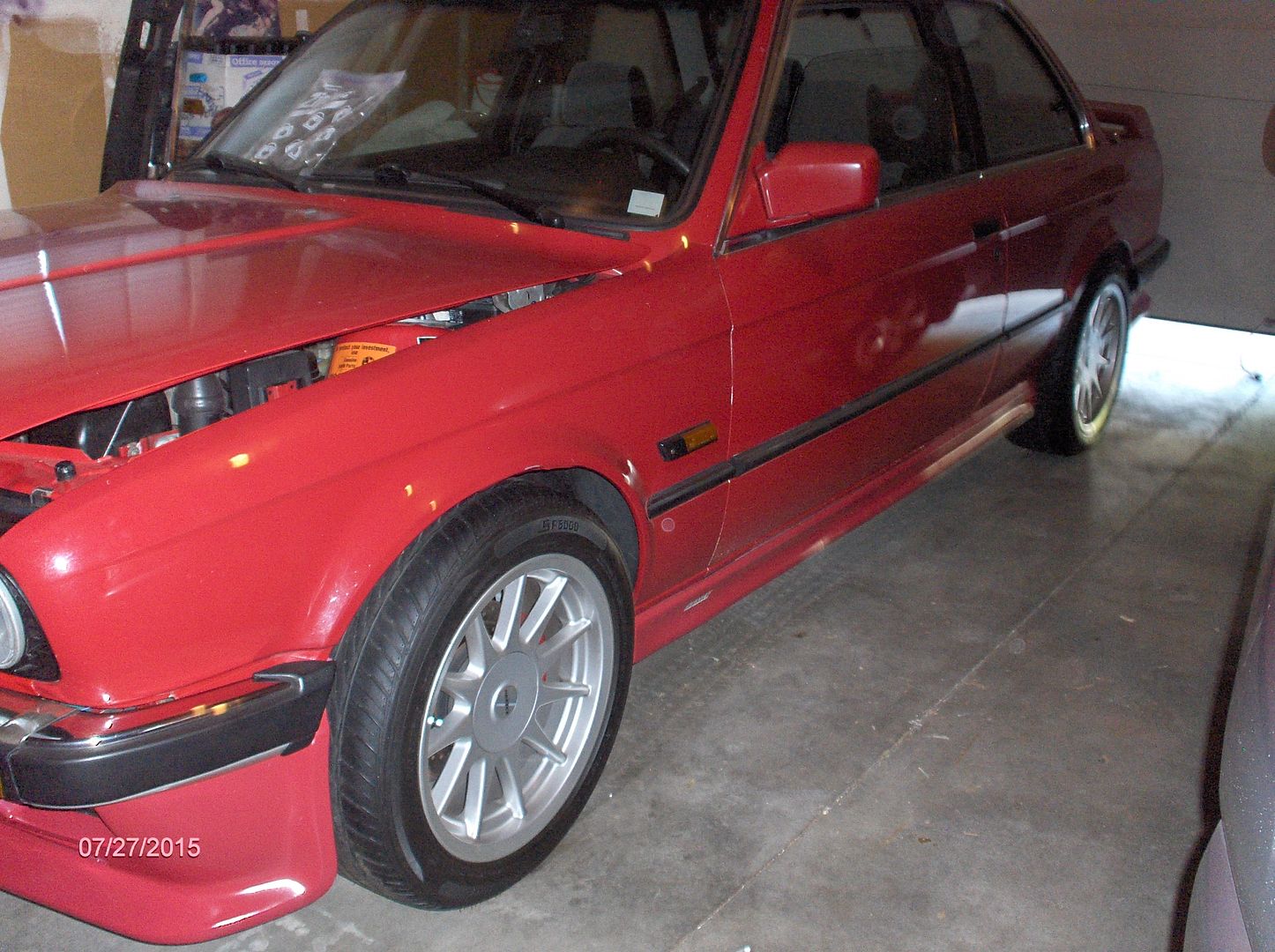

                      #250
                      That looks very sharp.
                      Your paint photographs nicely, hardly in need of a respray.
                      Super clean bumpers!

                              #254
                              thanks
                              Looks like the car was painted a few years back...might not be original paint....It looks like about 7.5 out of 10 in real life, but it is really nice for an old e30:). Maybe next year the car will be taken apart and repainted. I just don't want to do a super cheap or expensive job on the car....
