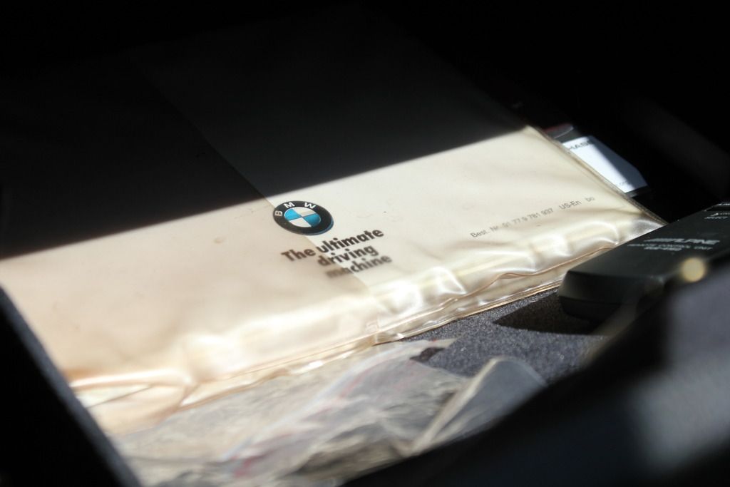

    Lots of original documentation and booklets

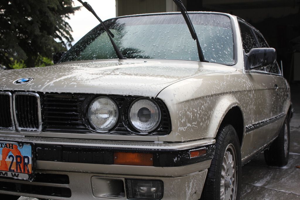

    On Sunday I had to study a bunch since finals are just around the corner, but I managed to clean out the car a bit and have a closer look at the condition of the paint. I am fairly pleased and must say that this thing has been babied for most of its life. I cannot see any indication of accidents, any respray or damage to the body. All panels have the original VIN stickers on them and all gaps are fairly even
    Bath time
    Cleaned up quite nicely
