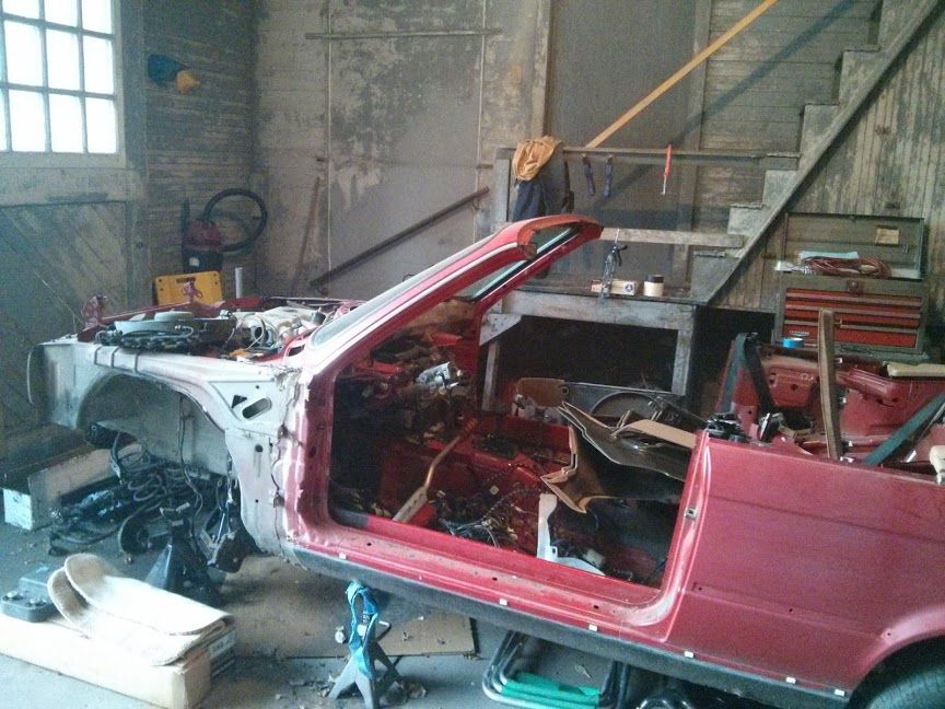

          Small update. Summer has been busy, no time to actually get anything done. Work may put me down south for a couple weeks in October though so i want to get this thing ready for the Tail if i have any spare time.
          First order of business: Finish stripping the parts car and get it gone.

            OK, anything that can be unbolted from the parts car has been removed from the parts car. I just need to sawzall out a couple pieces of sheet metal that i want to keep and it will be ready for the scrap yard!
            Starting next week, I begin project 'While i'm in there'.
            It started with me wanting to fix my power steering. Since i had a spare sub-frame, i figured i'd swap weld in reinforcements and have it power coated then just swap the entire assembly. Obviously, i'd do engine mounts while i was in there. Since the entire front end is apart anyways, it seemed only logical put in new control arm bushings.
            Well, once i started driving the car again in April, i was reminded of how bad the shifter linkage is. Since the exhaust is already going to be dropped to do the sub-frame, i might as well take the opportunity to tackle the shifter linkage. Realizing that i was going to have both the exhaust out and the driveshaft disconnected, I concluded that it would be a great time to put new rear sub-frame bushings in too... while i was in there. Hold on though, without a rear sub-frame or driveshaft, this would be a great time to replace all my fuel lines too... while i'm in there.

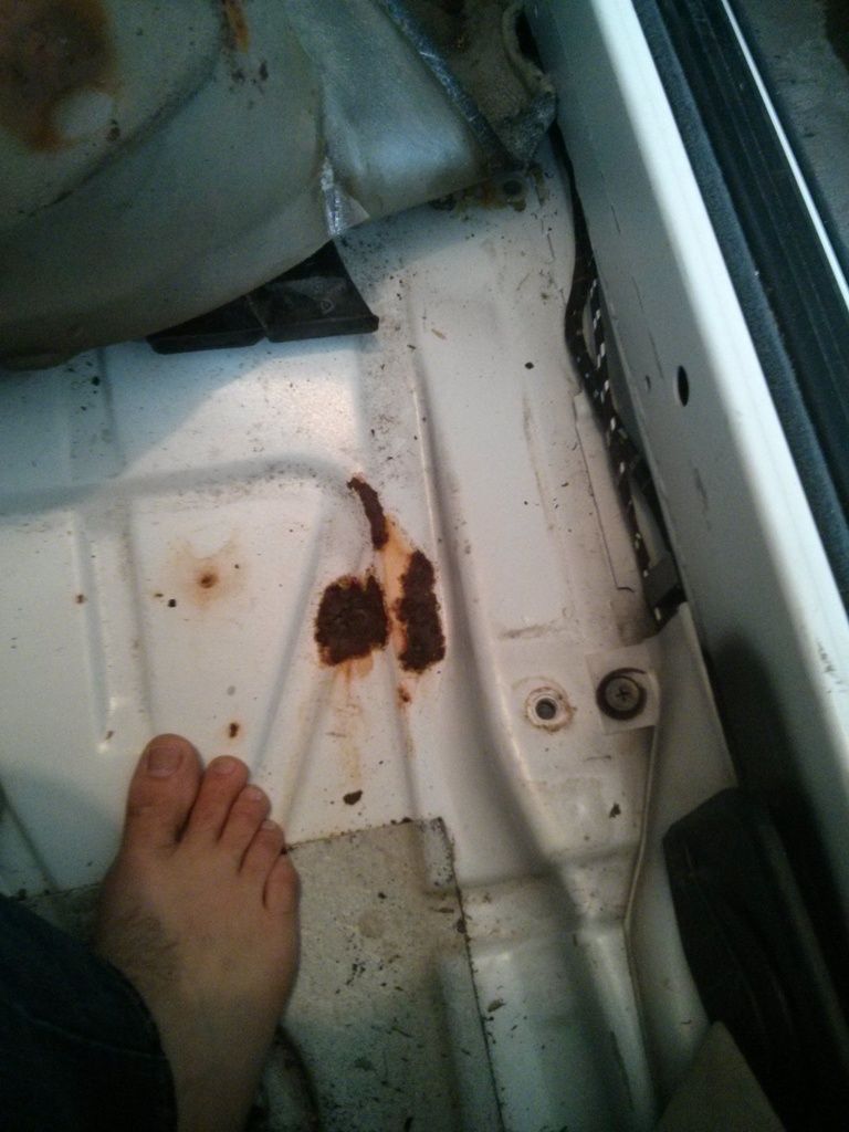

                          Last year, i noticed some rust in my floor pan.
                          As my final act of disassembly, i cut the pan from the parts car. Now i wait will Friday for the scrapper to come get it and haul it away.
