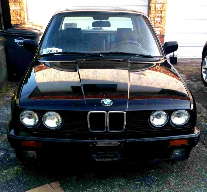

    About 2 weeks ago I picked up a 91 auto e30 for $850. The tires were worn out and it "needed some work".

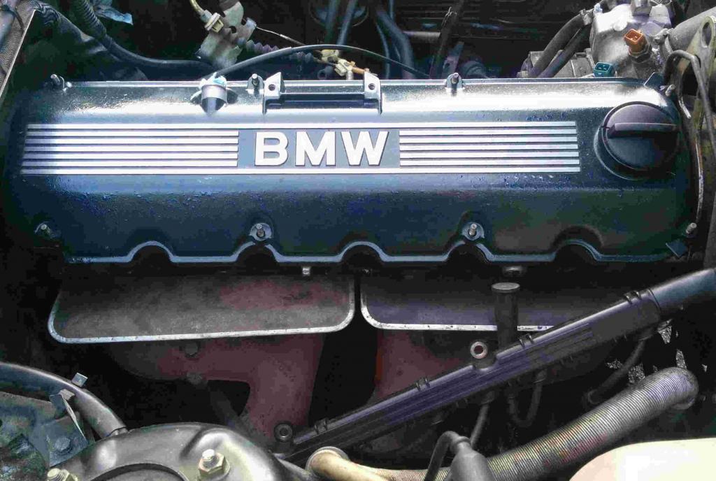

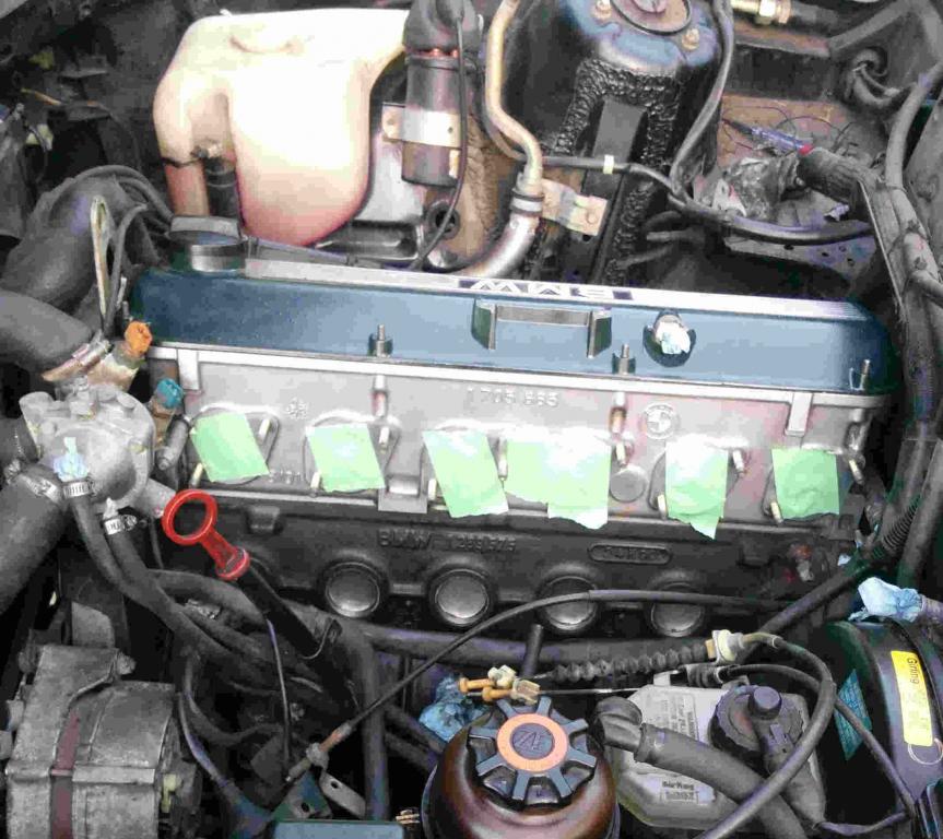

    Now with everything cleaned up, and a freshly painted valve cover... I have to wait... For parts... But that gives me time to adjust the valves while the cover is off.

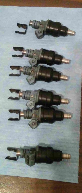

    With the intake already off I decided to rebuild/clean my injectors while I am in there.
