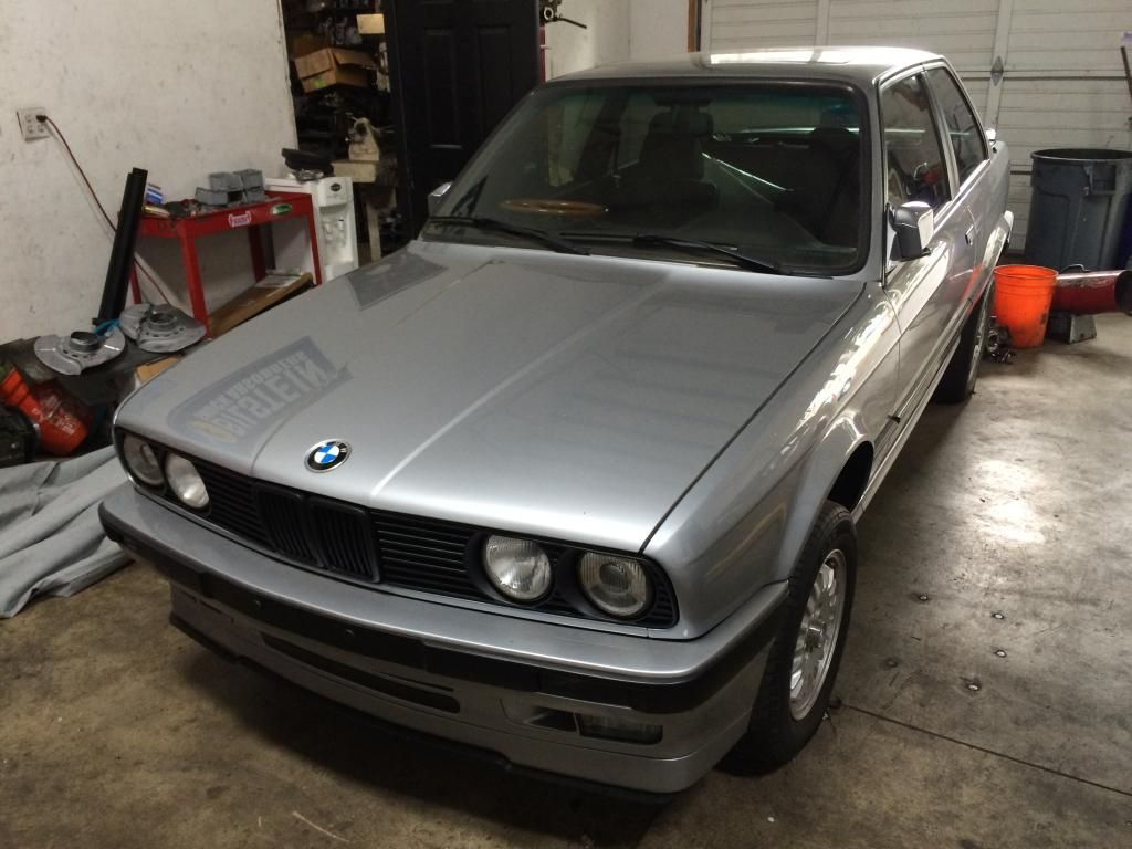

    This little project has been in the works for a few years. I've always had an end goal in mind for my cars, and while this wasn't quite the direction I originally had intended, I'm happy with what the end result will be. I always really liked a well sorted plastic bumpered early model, so that was my original goal. Never was real big on the late arches and big tail lights. Of course, an S50/52 was the only reasonable option for me (power vs. cost reasons) and it had to be 5 lug. I had the perfect parts car for it, so the search began for a clean, stock early model car that I could hack up and otherwise destroy :)
    I bought this car from RyanG in 2013. It's an '89 325is with a fresh professional respray in Lachssilber. I wasn't thrilled about it being a late model, but with how nice the body and paint was, in addition to the price being right, I jumped on it. It was parted out, due to failed smog/inspection, courtesy of an OBD1 S52. I was quite nervous about buying a car sight unseen from 600+ miles away (never have done that before and since this car), but all in all, I got a fair deal. It saved me from having to have my red car repainted (that's another ordeal in itself), and ultimately, left me with a much, much nicer car.

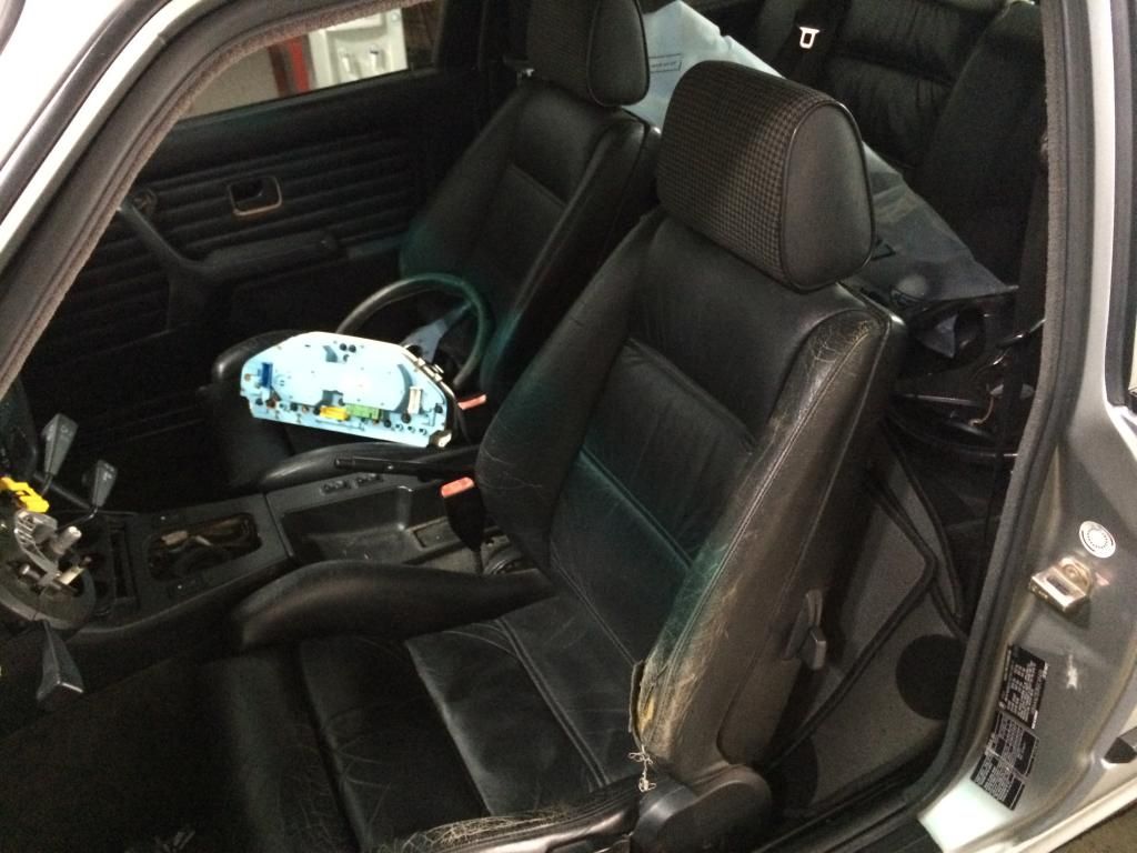

    Interior
    black E30 M3 front heated/rear seats
    new MT2 370mm wheel
    new ZHP knob
    new OE E30 M3 shift/ebrake boots
    early model anthracite carpet (darker than late model stuff)
    perfect dash
    refurbished cluster w/ red needles, silver trim rings and new SI board
    Alpine HU/Alpine component speakers/MTX 12" sub/Lukebox/PG 900.5 amp
    map light mirror
    custom ashtray gauge pod for volt meter, oil temp and oil pressure
    VDO vision gauges (probably holding off on these for a bit)
    Racing Dynamics dead pedal
    ACS pedal set

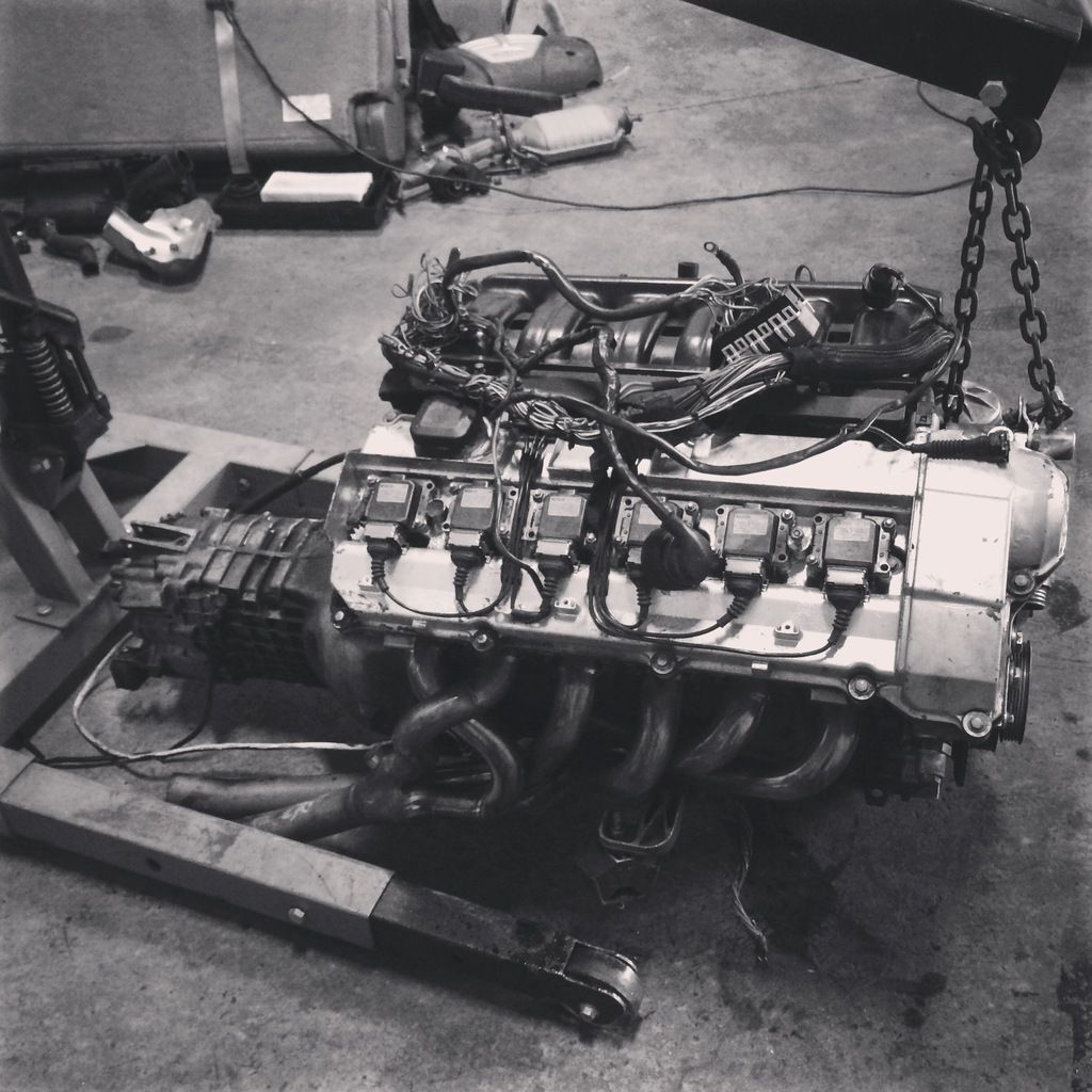

    Interior was in, but no drivetrain or suspension at this time.
    S50 from my red car. Needed an oil pan and a clutch.
    In the process of rebuilding E30 M3 brakes
    M coooooop diff cover
    S50/G260 ready to go in!
    S50 in!

    Roller shots my brother took the night before Picnic.
    And, finally at the picnic. Photo credit to "hankolerd".

                    It's a mostly stock S50 with 21# injectors, Supersprint long tube headers and a TRM tune. I imagine it's around 230whp or so. I have a 3.5" MAF and Dinan CF intake I need to get around to fitting, but the MAF really doesn't make a difference at all.
                    I debated ripping it all apart and doing oversized valves and Schricks and making a really fun, healthy NA motor, but when the HG lets go, I'm going to do a low boost turbo. It's only money
