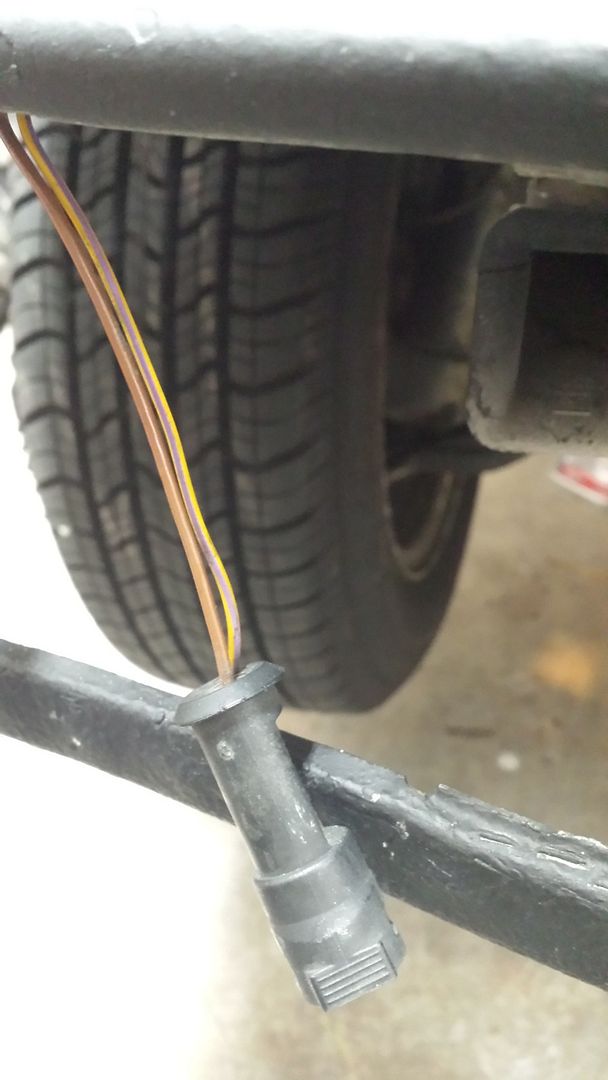

            And I found the issue with the fog lights in my DB to plastic bumper swap:
            In a not very proud moment, I realized I have the fog wiring.. just when the iS dam was removed, the harness was not completely disconnected. I need ZKW fog pigtails.. or just order new plugs/terminals if I knew the part number.
