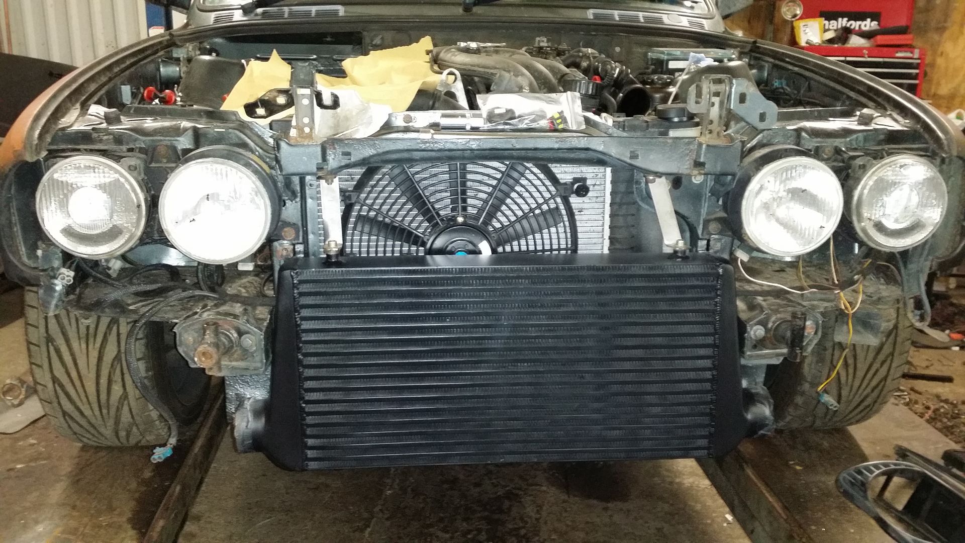

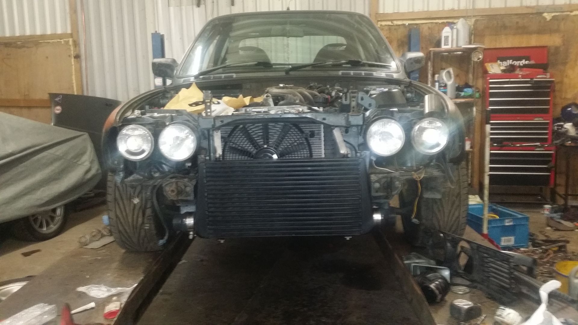

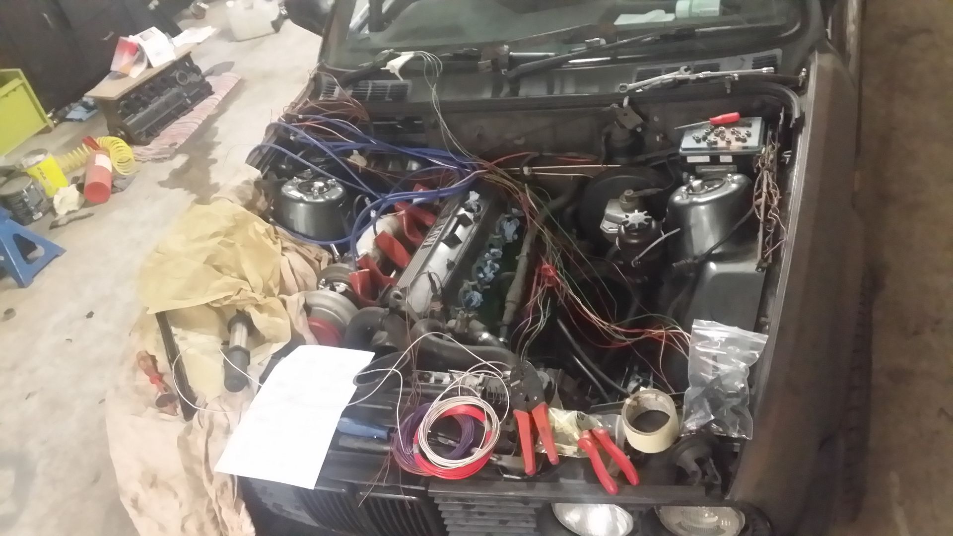

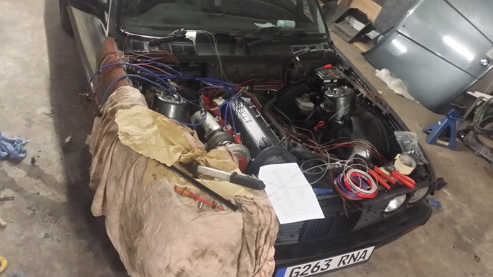

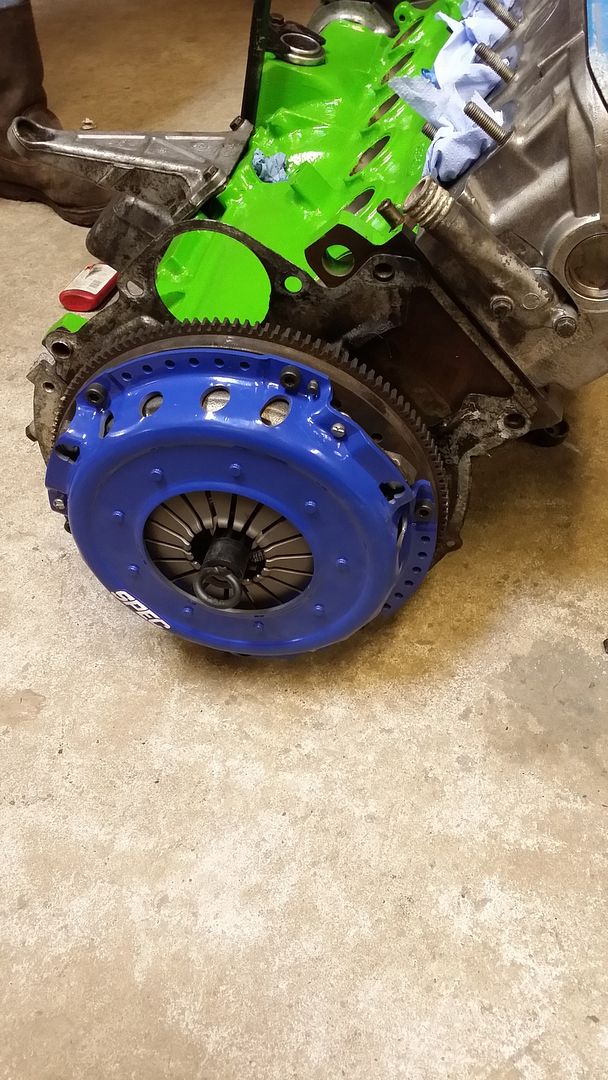

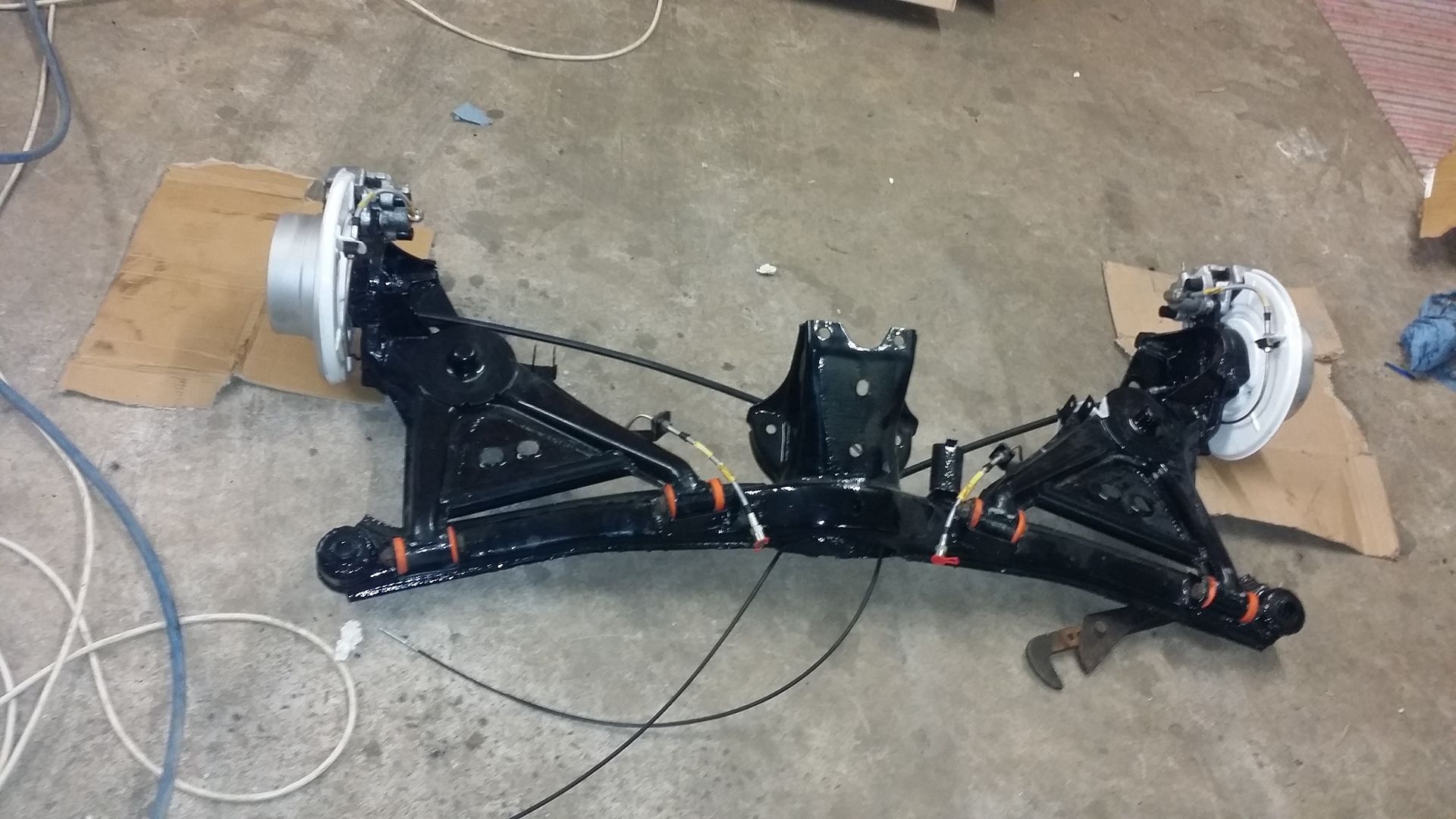

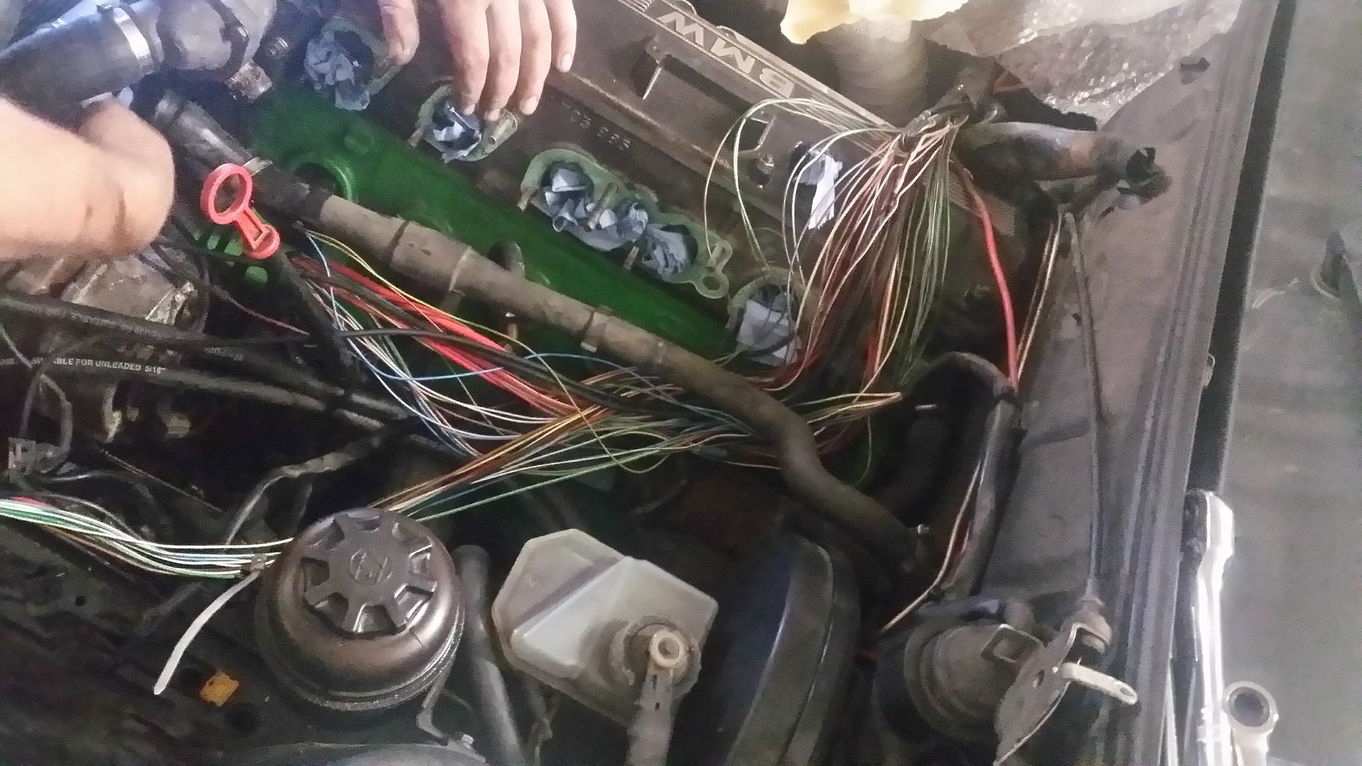

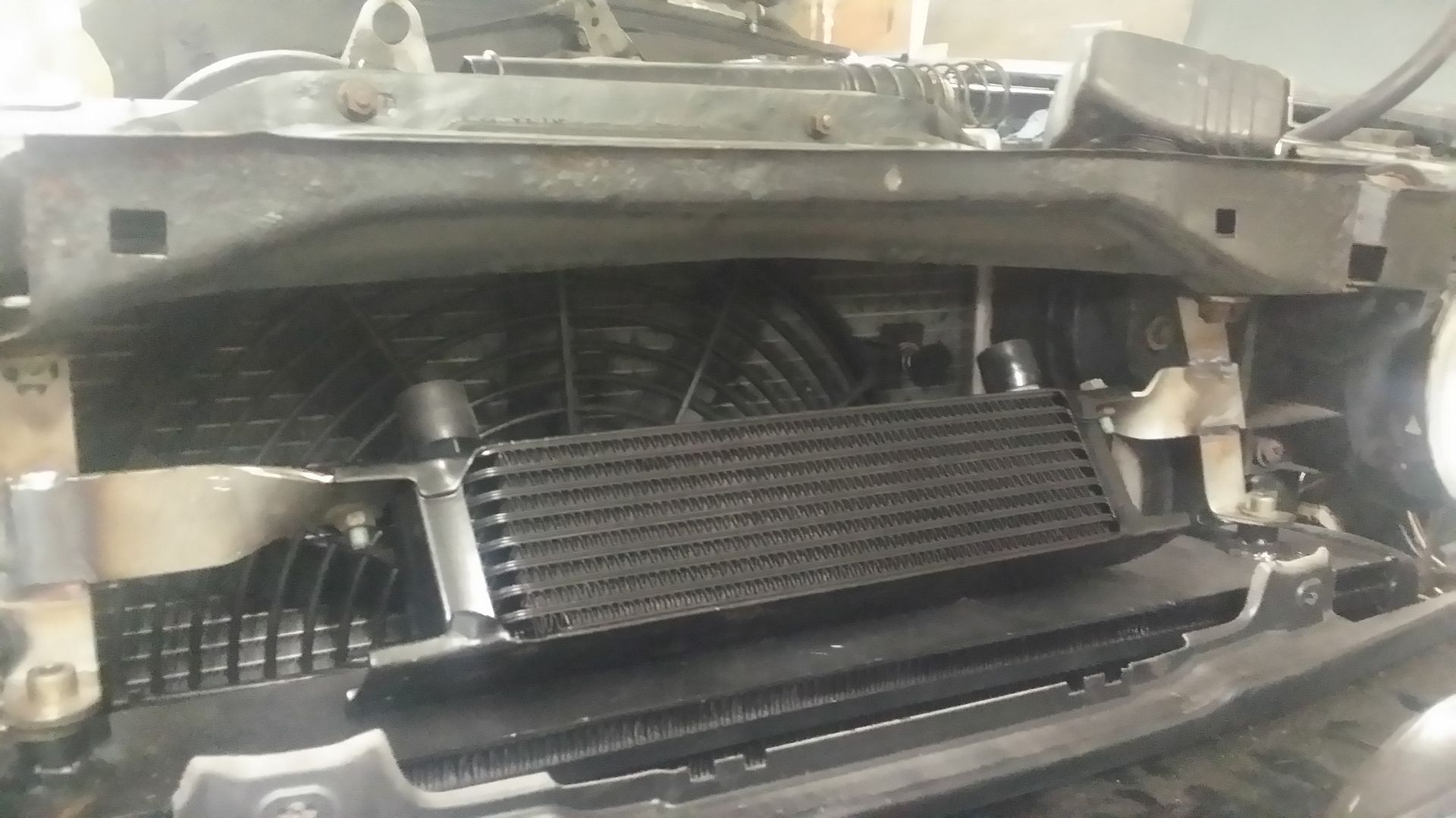

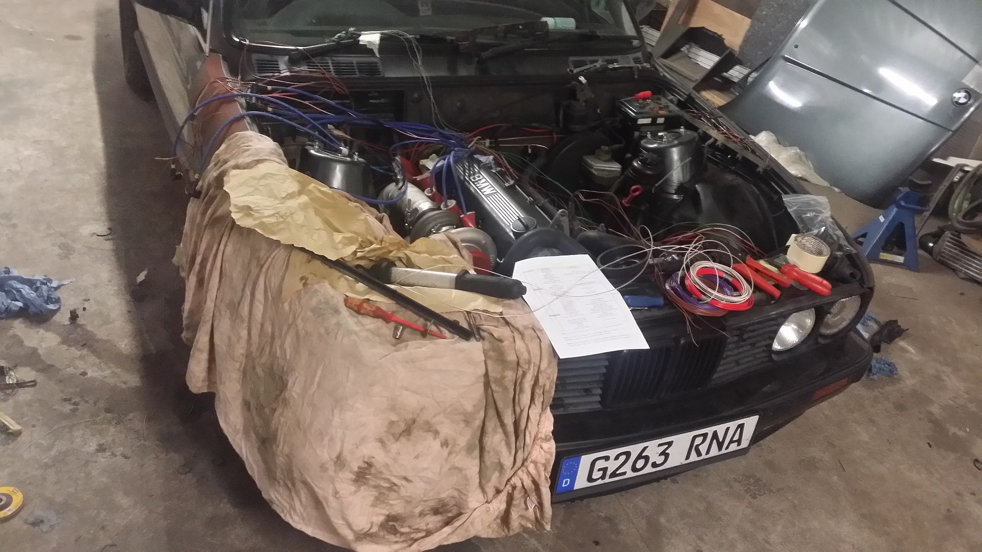

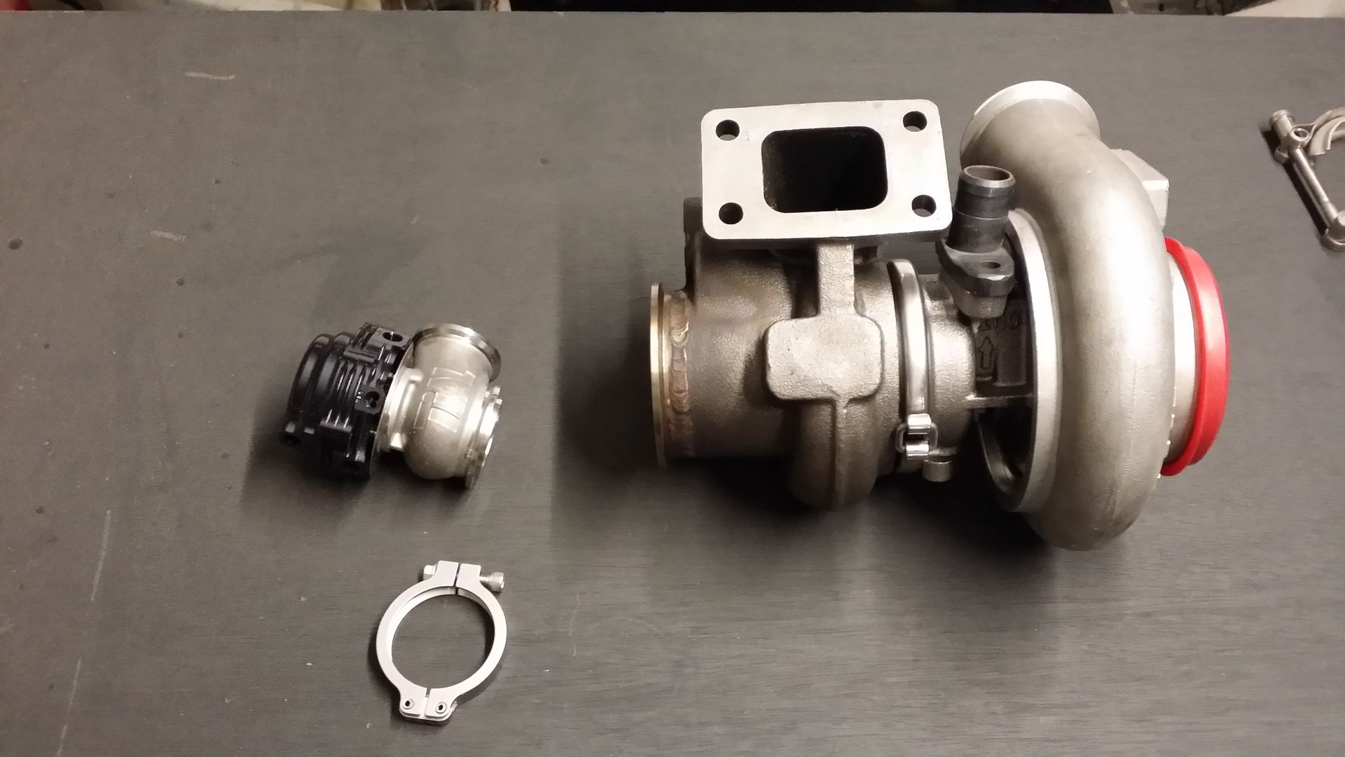

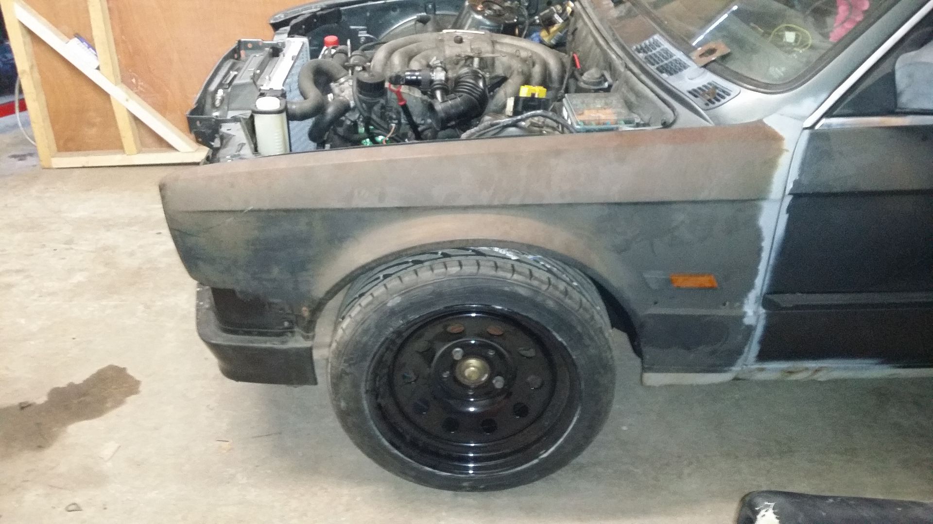

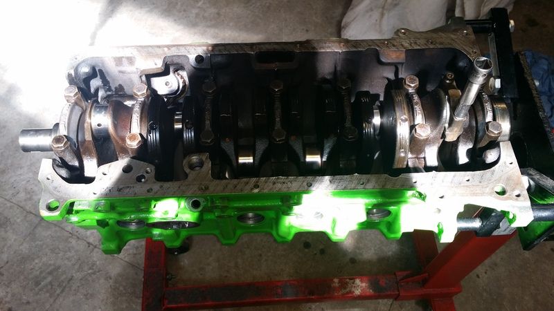

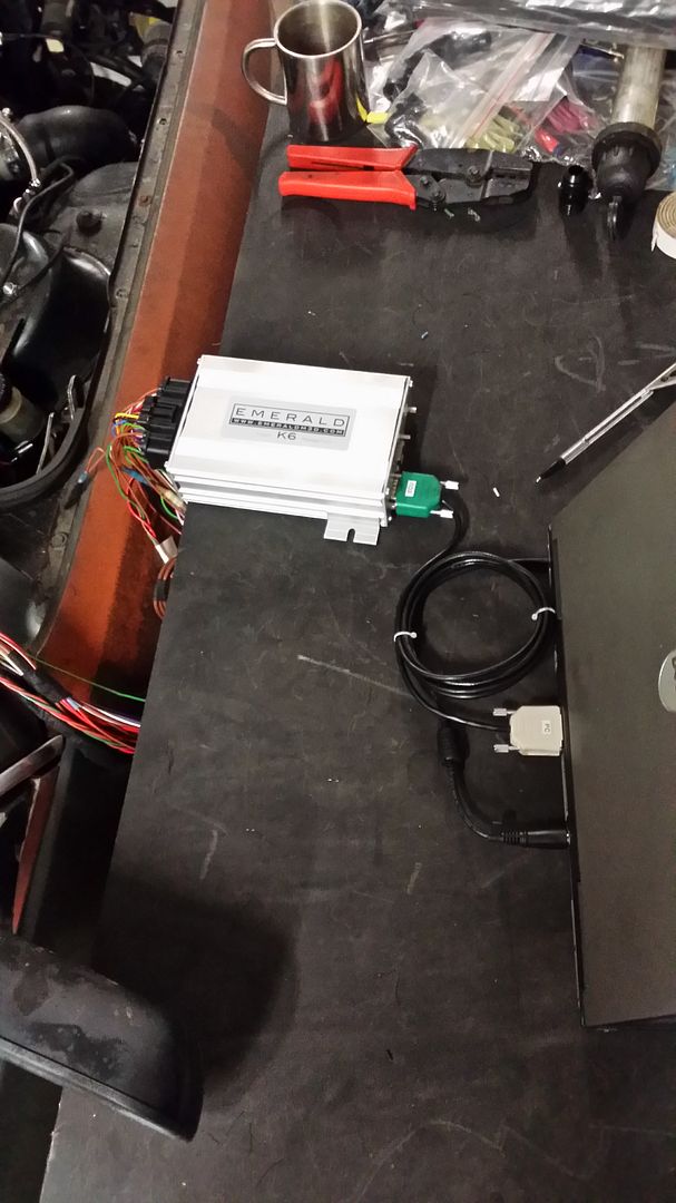

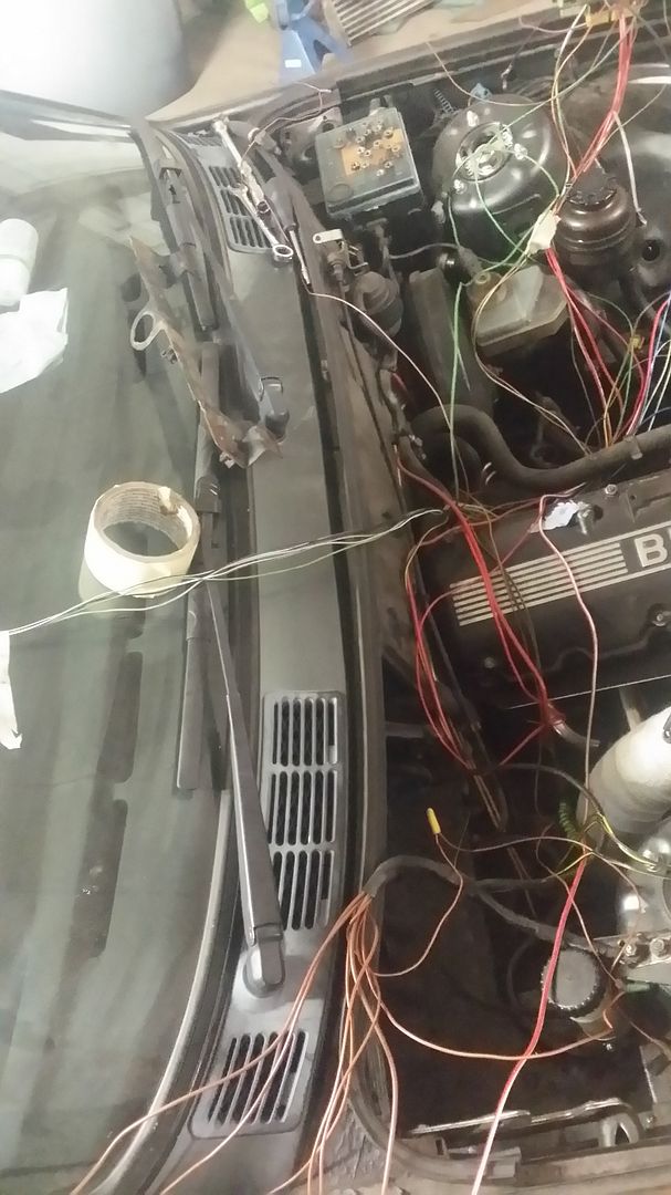

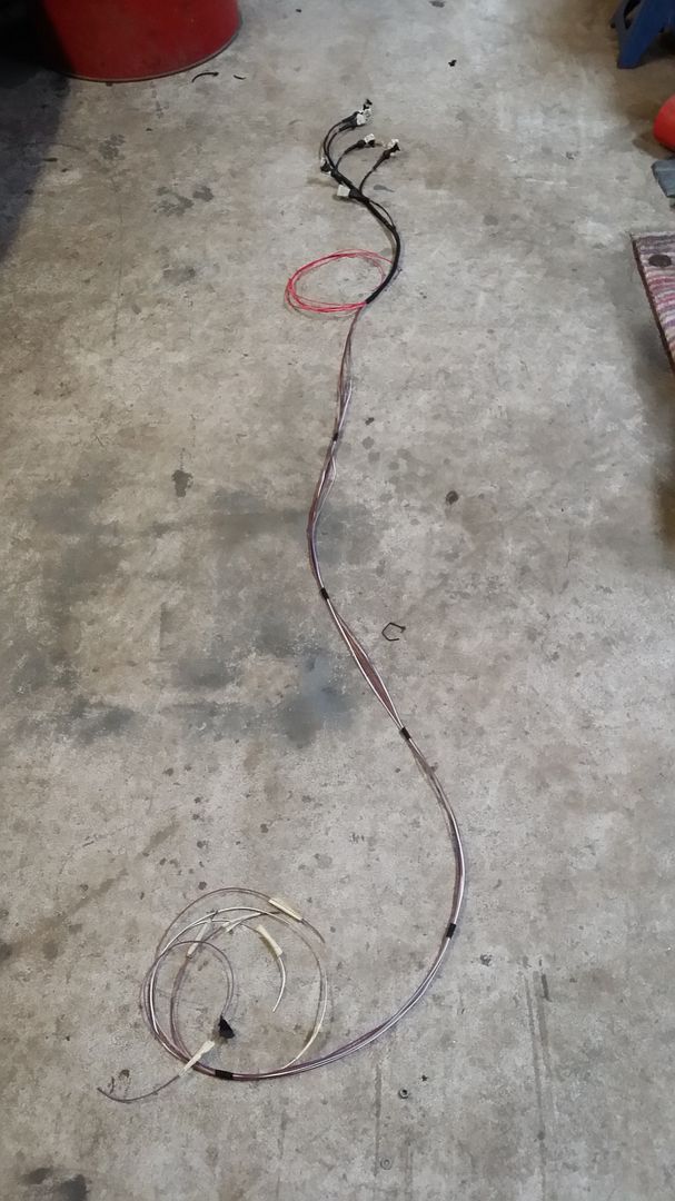

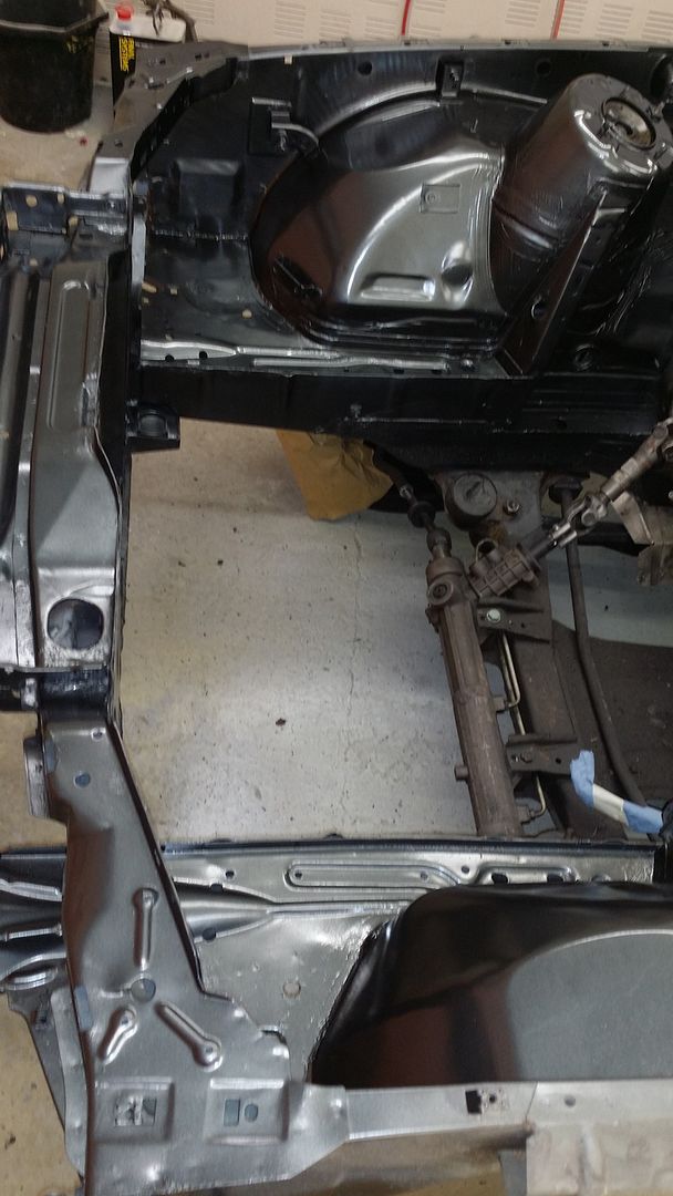

Hi guys .

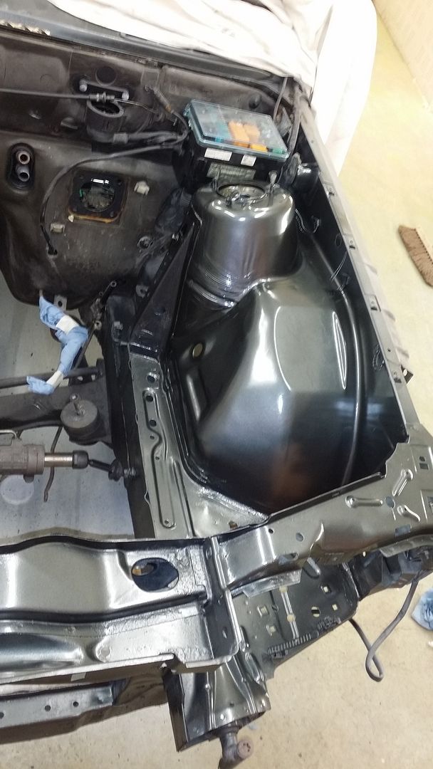

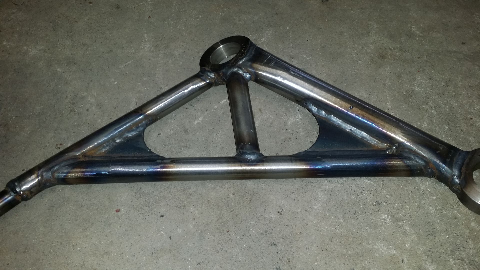

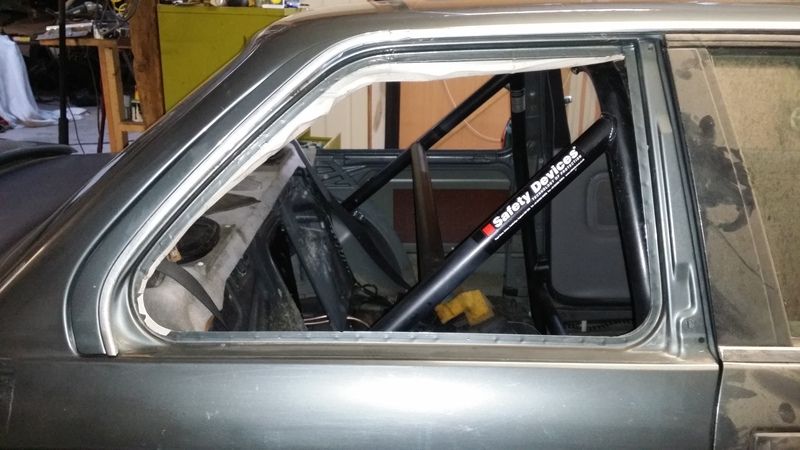

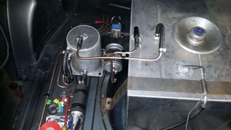

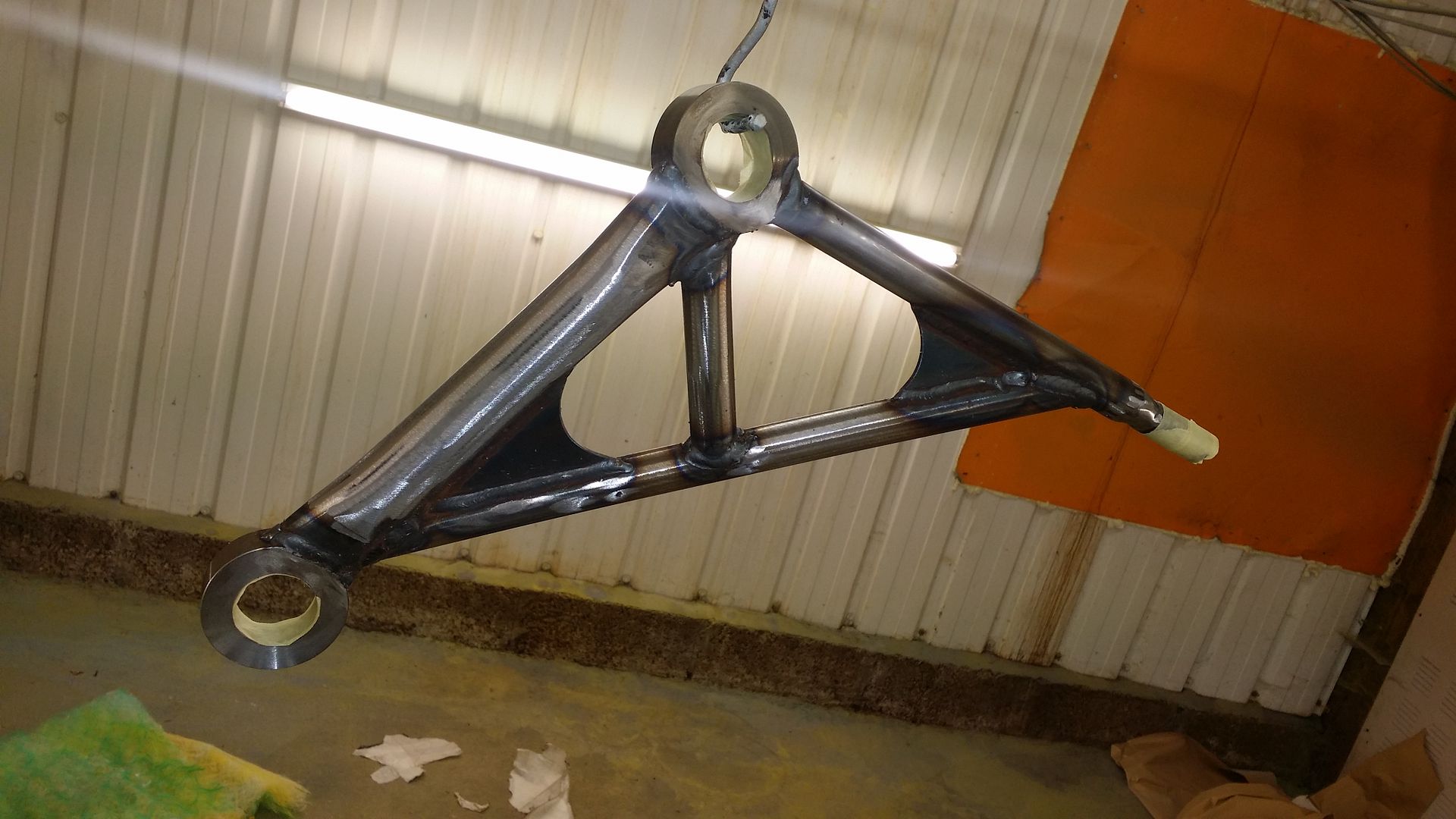

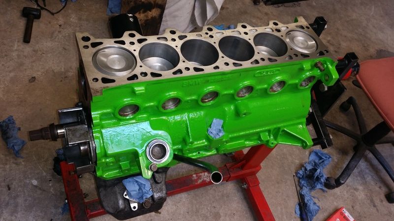

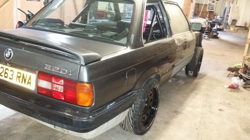

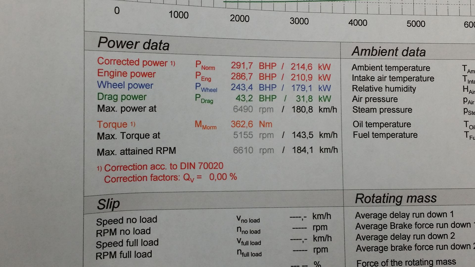

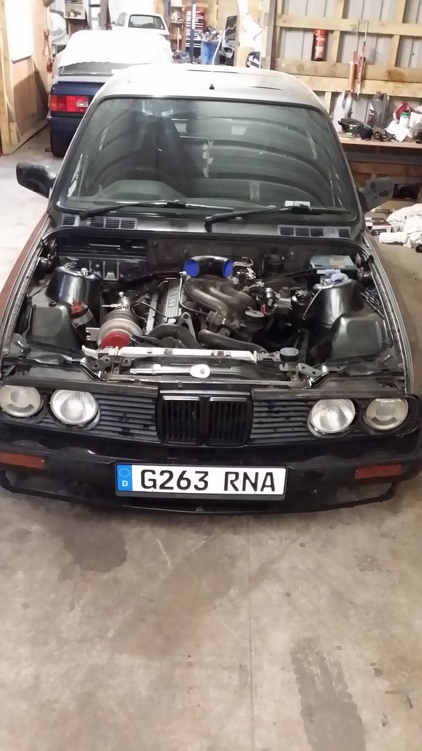

This is my project e30, was ment to be a scrapper that had been at the unit for a while having parts raped from her, all that was left was basically a shell (and in the same exterior condition as she stands todate :P ).

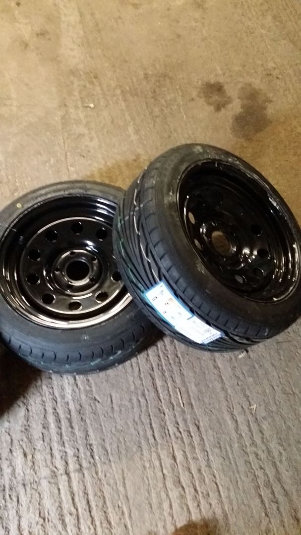

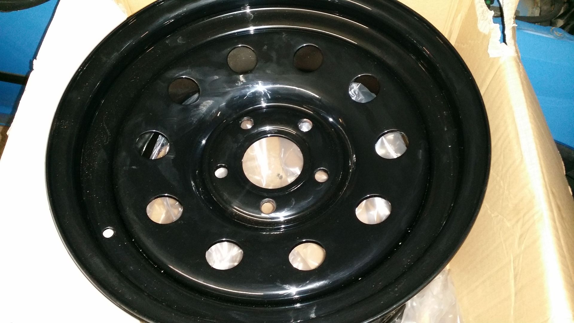

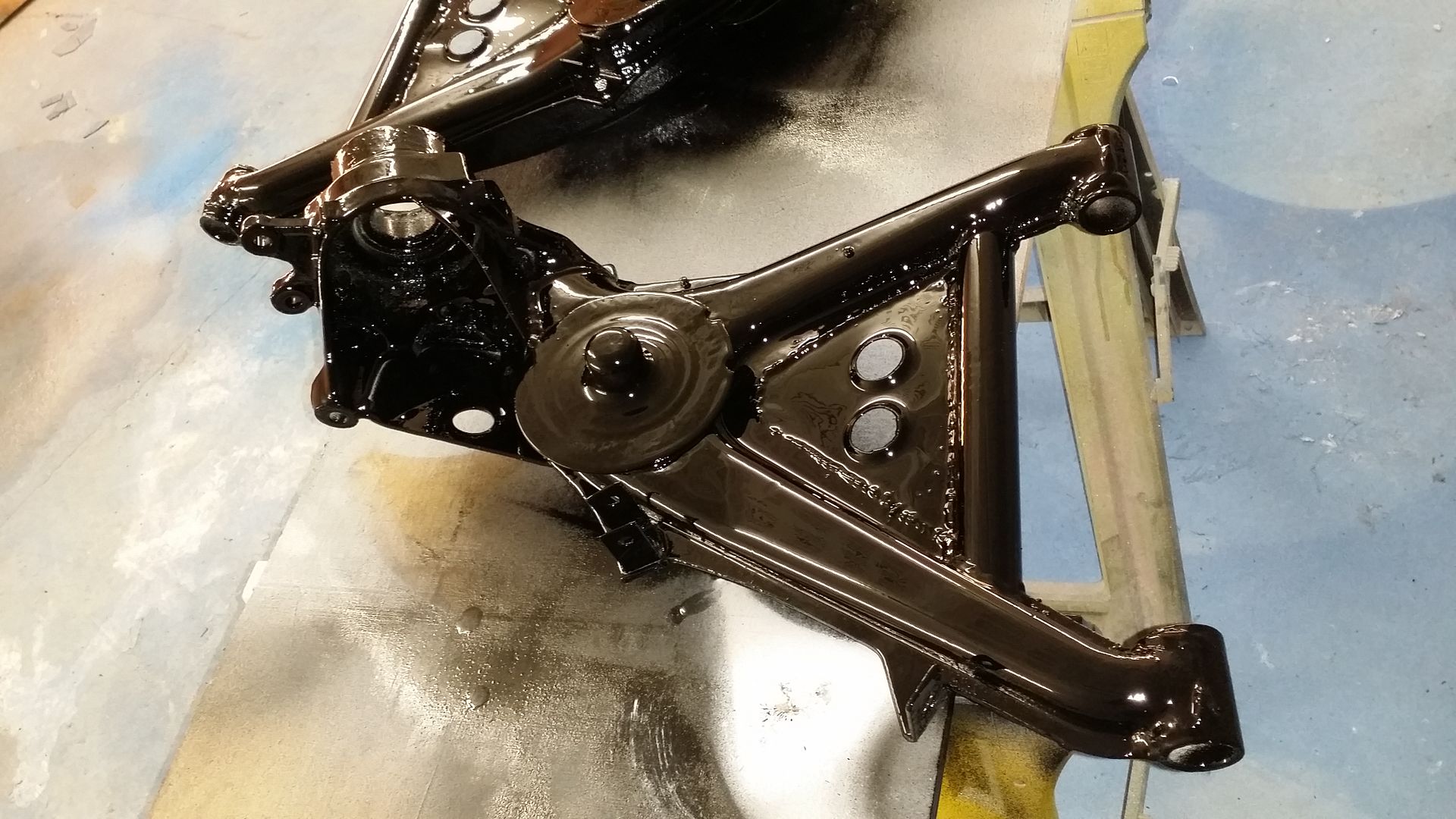

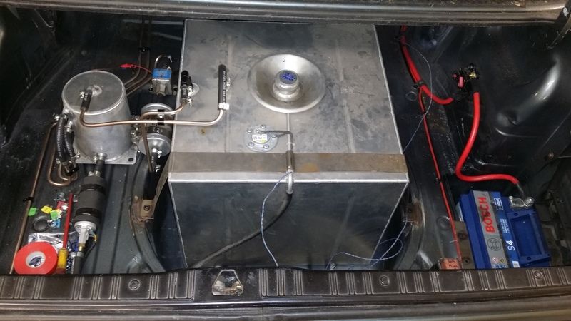

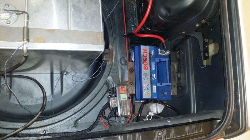

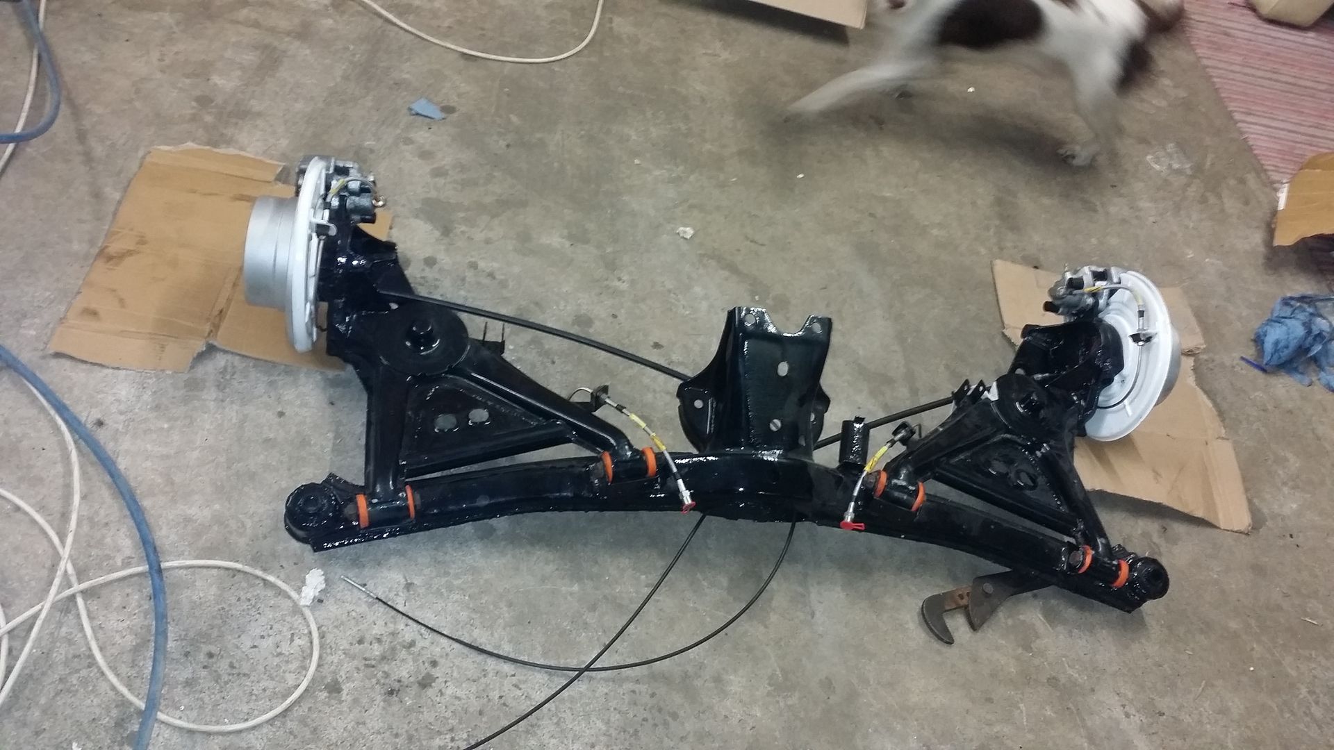

I'll let the pictures do the talking,

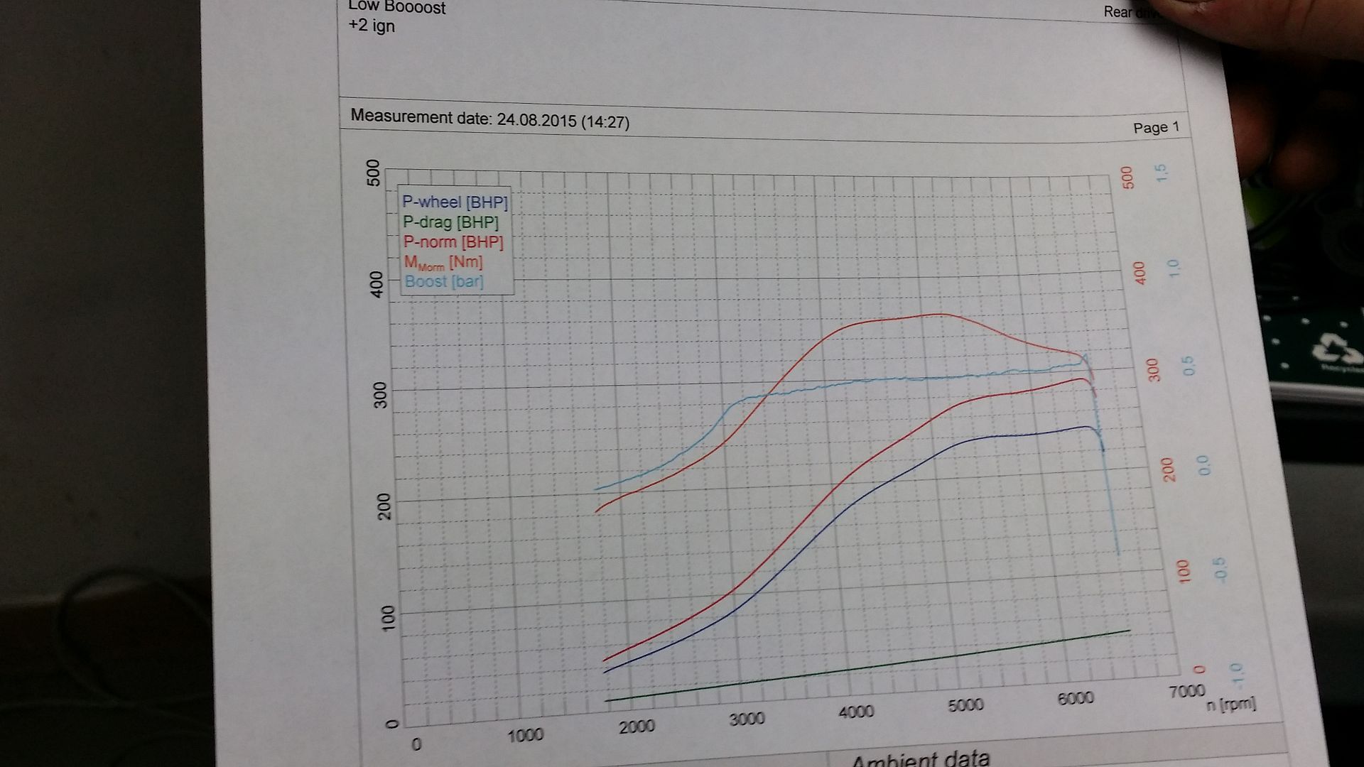

spec is as follows (i think.. i may have missed stuff )
m20b25 lowcomp block+head
328i rods
ARP mains
custom m20 pistons

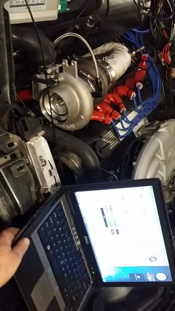

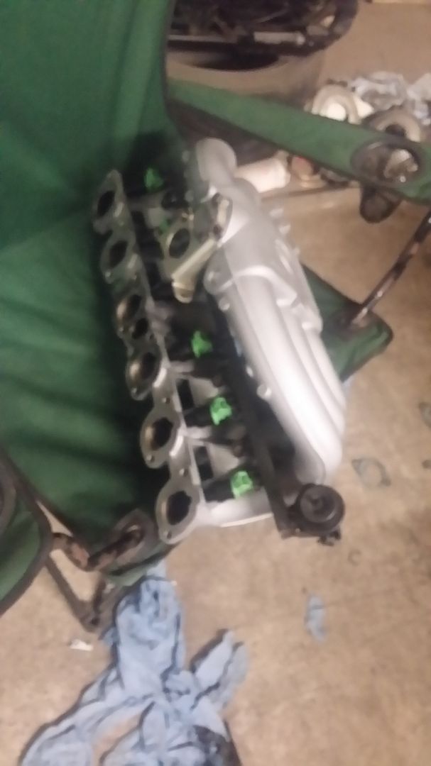

enlarged throttle body (TheEngineShed - pm for prices)
440cc injectors

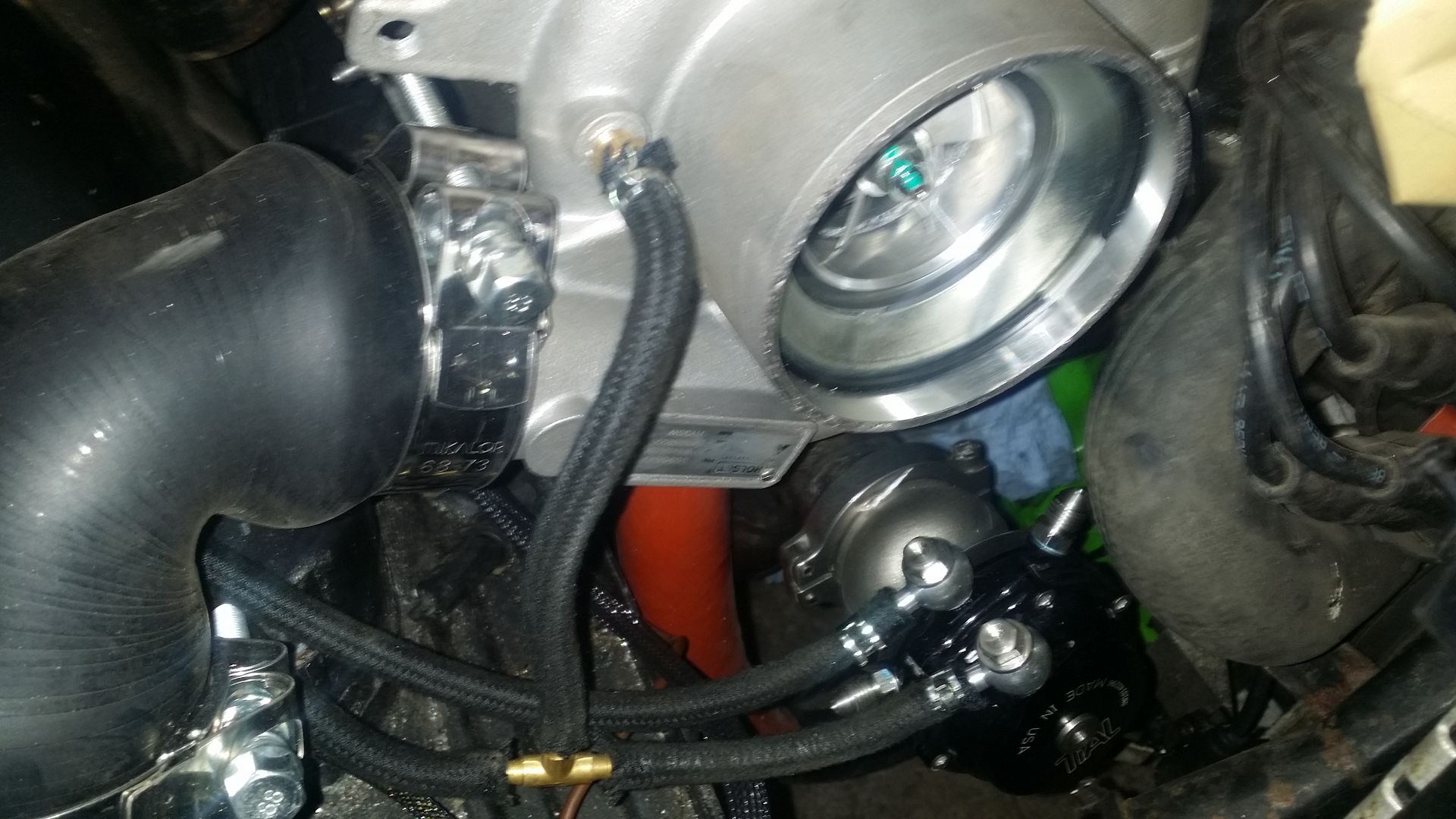

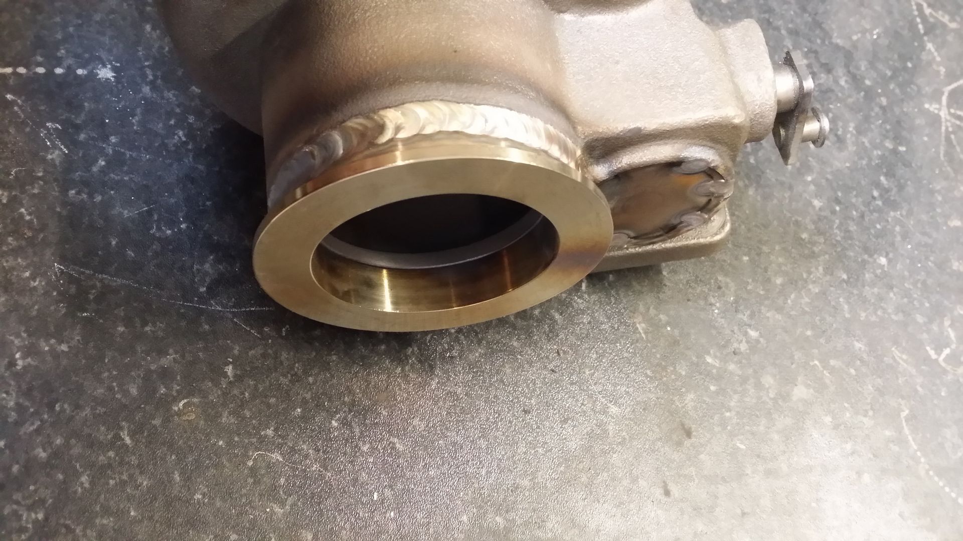

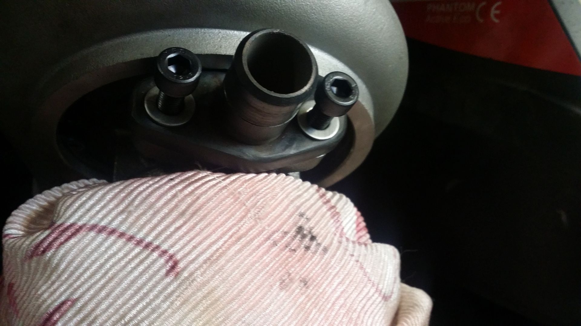

Hy35 turbo (custom exhaust housing)
Tial wastegate 38mm mvs
3" exhaust
screamer pipe
Wallbro 255

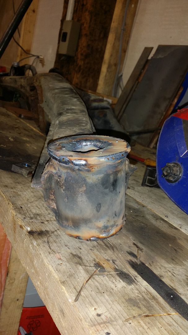

Emerald ECU

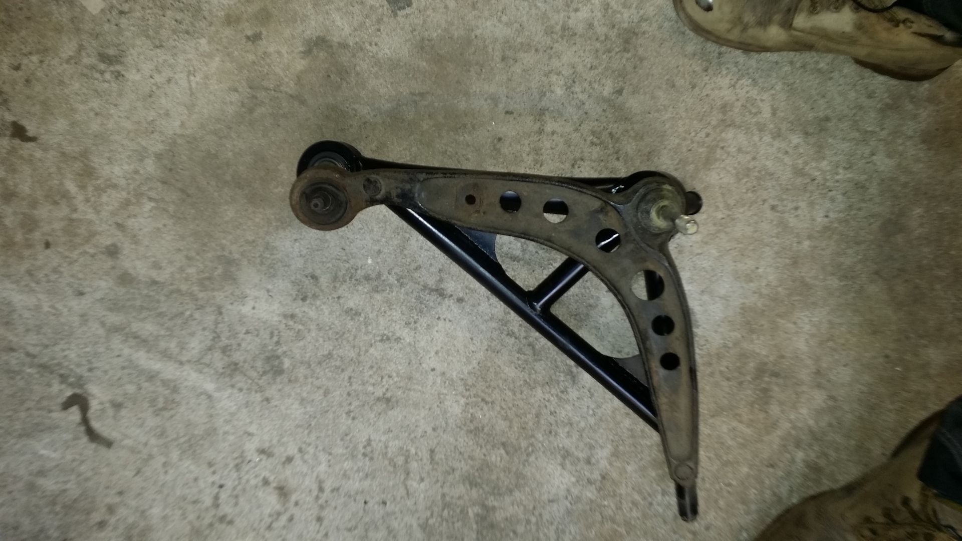

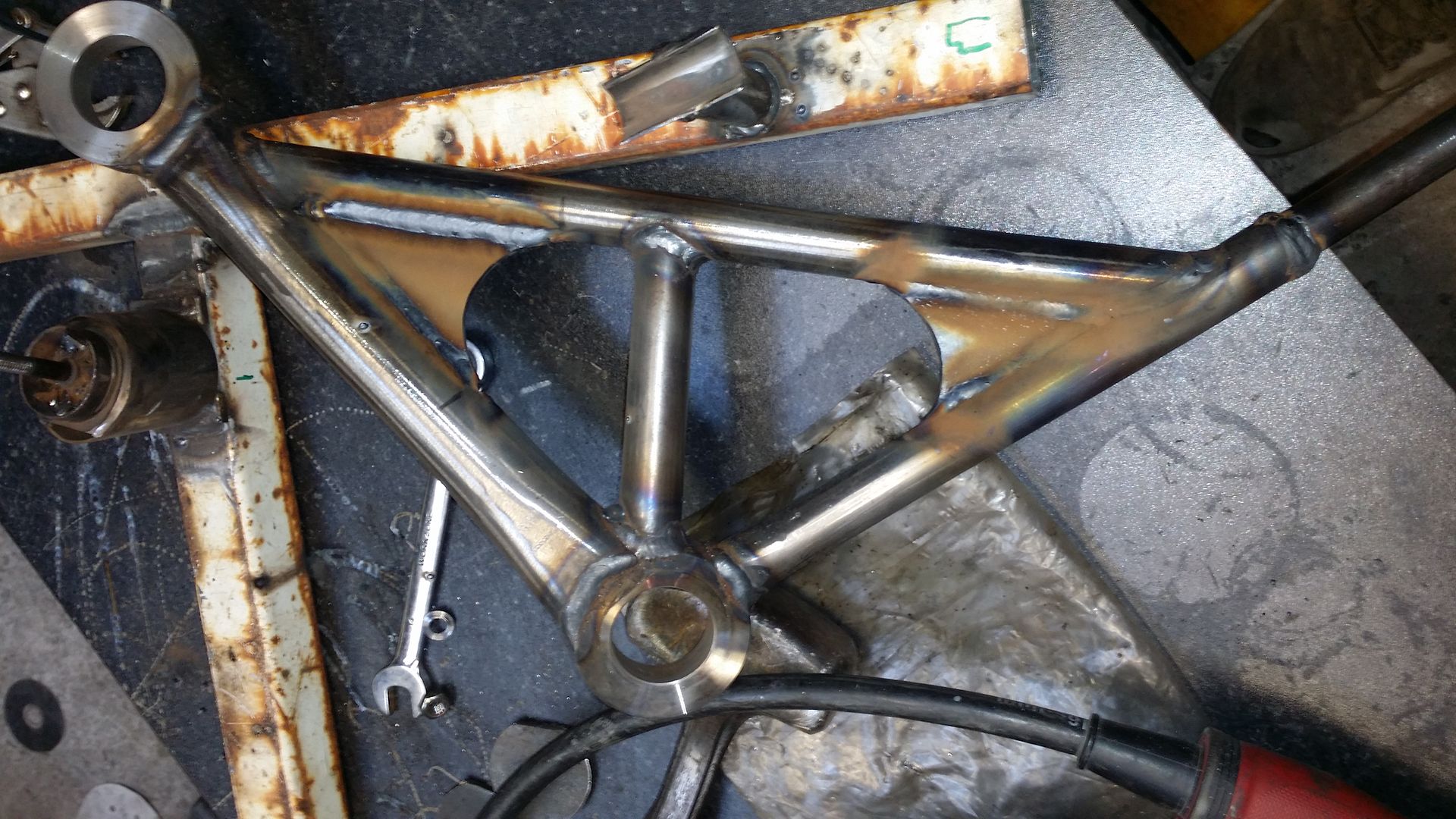

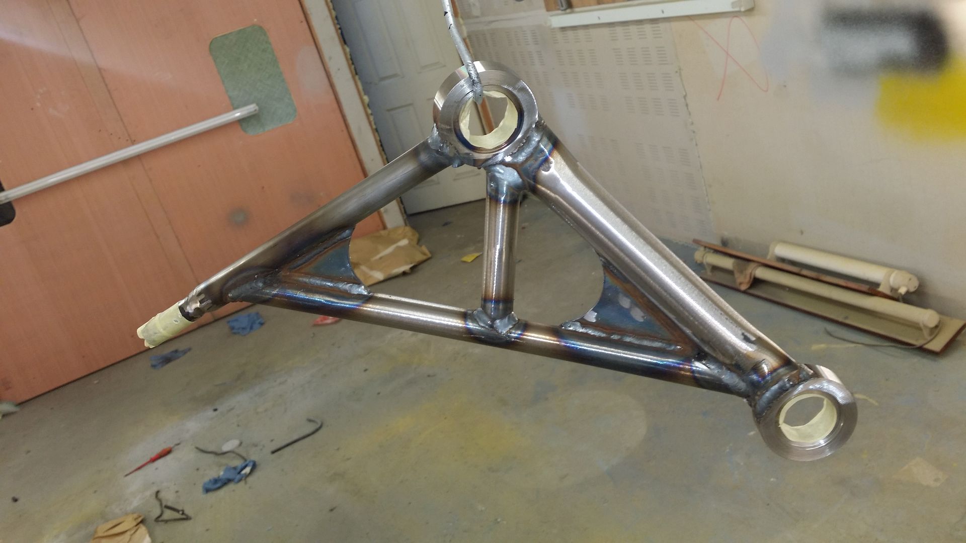

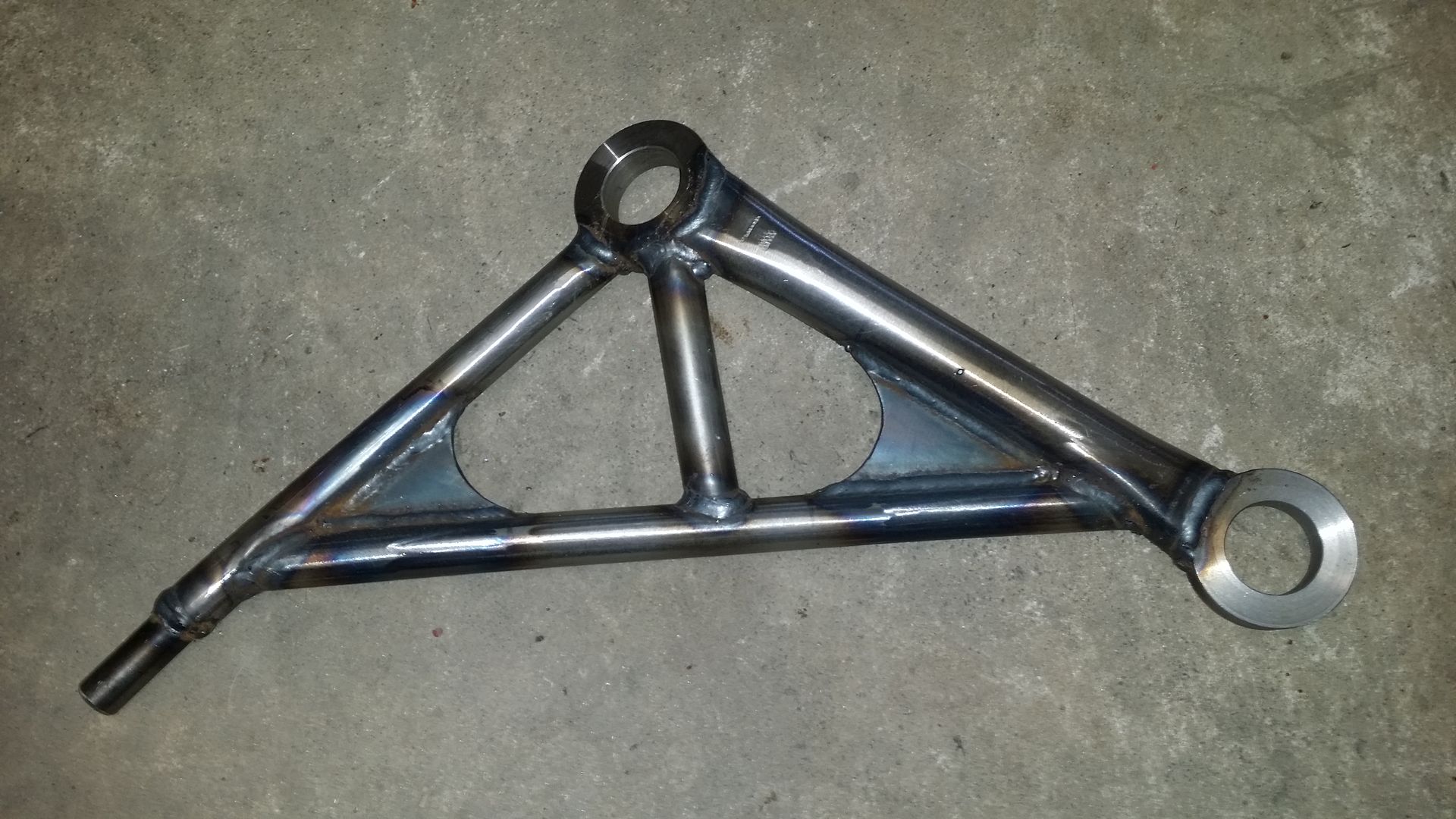

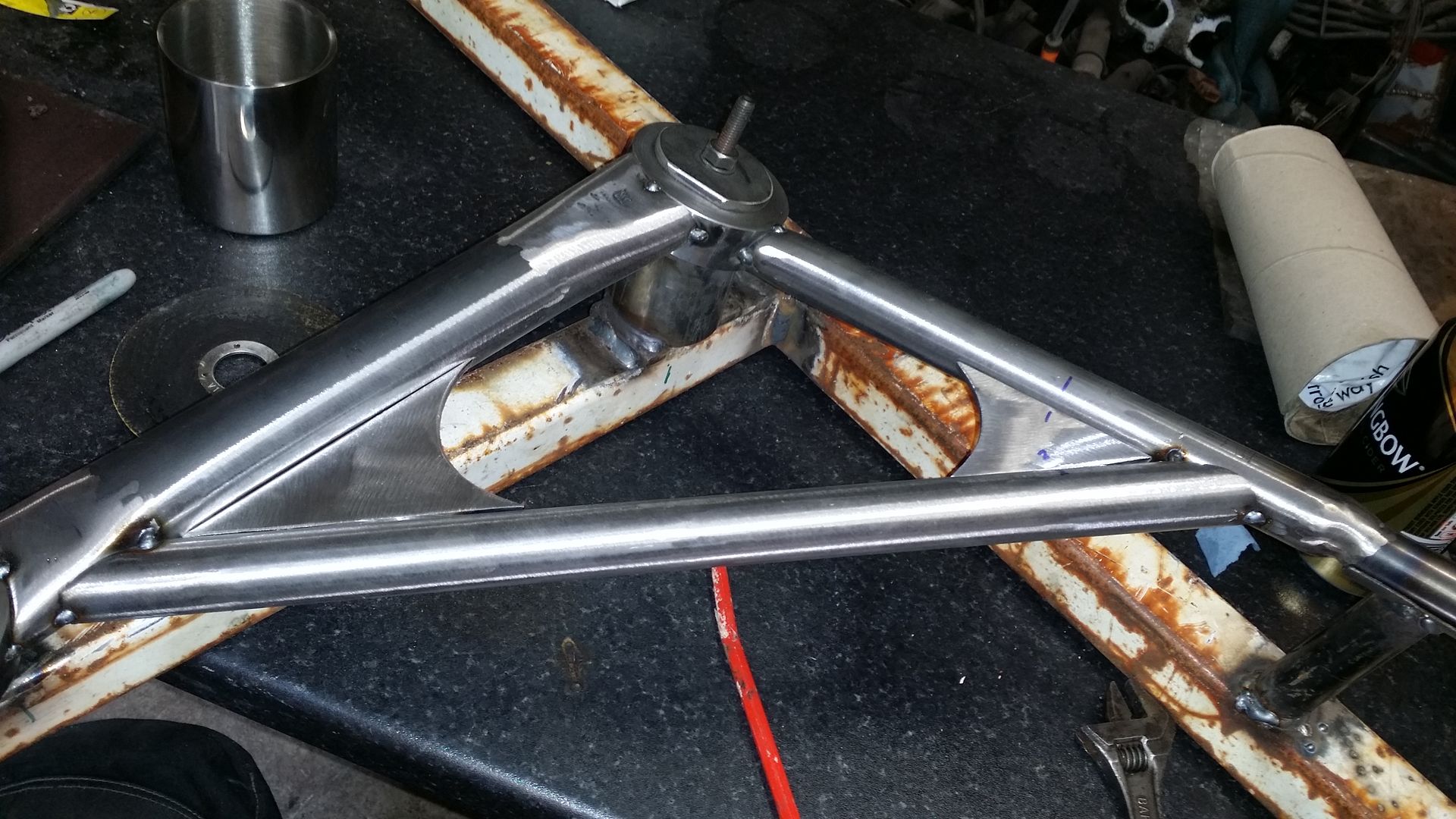

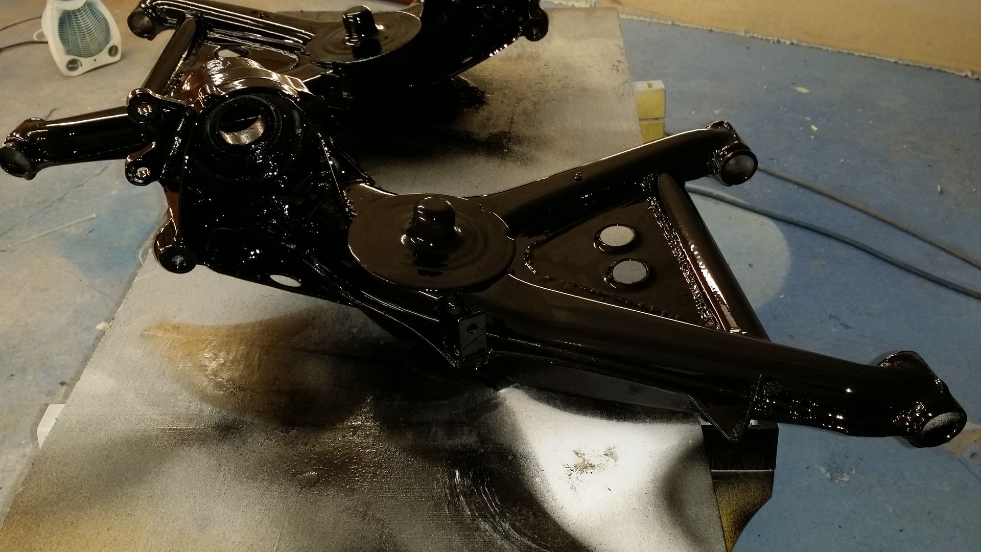

Custom bottom arms for 5 Stud conversion (sets for sale pm for details)
solid mount rear end, strengthened rear arms
H+R springs.
enjoy :)
440cc injectors
