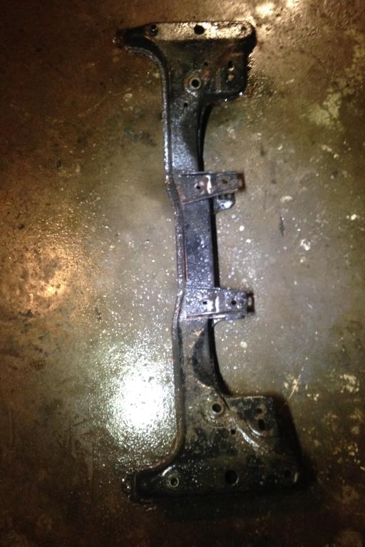

            Made some progress. Nothing exciting picture wise. E36 rack is in, new tie rods, sway bar bushings and shackles, end links and all new hardware are in subframe and in car. Motor, and trans mounts are in. Just waiting on my FCABS to come in today or tomorrow and new control arms will go in. Deck lid is shaved, cut in and will be painted sometime this week. Now to get on the phone and order wheels. Those will be a 5-6 week wait so should be just in time for summer.

                Redoing any of the front suspension? See new sway bar links and mounts, new sway bushings too? Mine fit super tight and I will need an extra set of hands to reattach the sway bushing and bracket. Or was going to use a zip tie or a longer bolt to help squeeze them together... the bracket back into the chassis.

                  Yeah, prob going with Ground Control next month. The wheels killed the budget for this month but wanted to get the order in so I could have them in time for summer. New bushings also. Literally everything I took out got replaced, nuts,bolts, washers and errrythang. I struggled with the bushings for a bit the it hit me. 2 sets of vice grips! First one at about a half inch apart and the second one tight enough to get the bolt through and nut on. After I get the suspension I'll get these on. Also have a x-brace hanging on the wall waiting to get in the mix.
