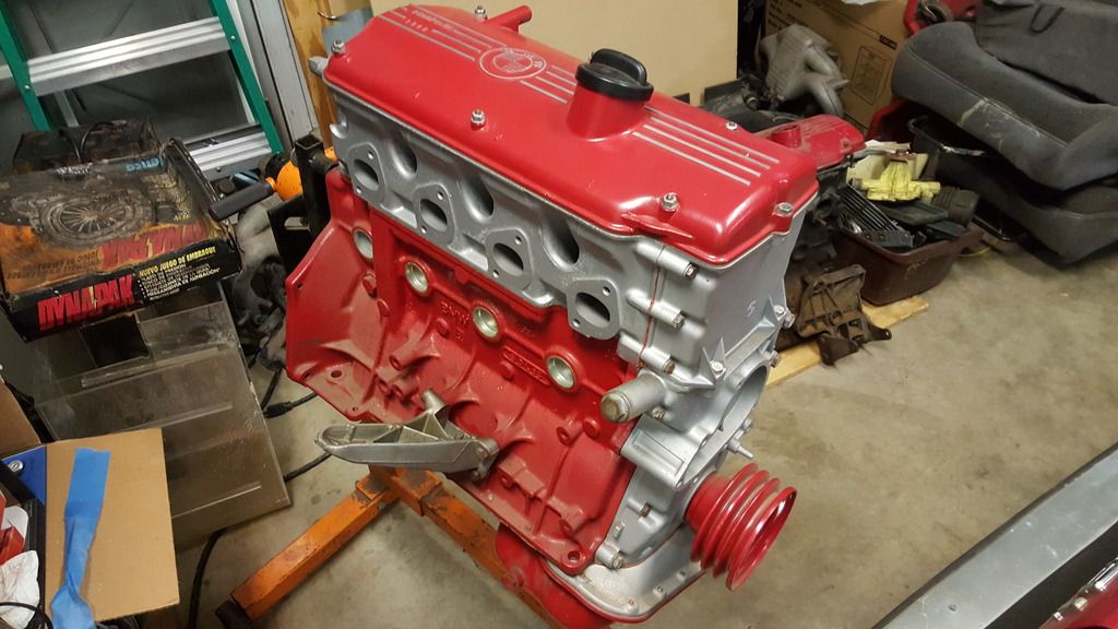

    This thing will not go back in. Can't sell it either. 2 months now, no bites.

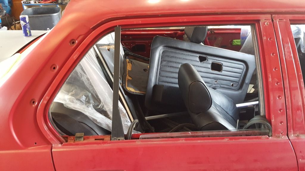

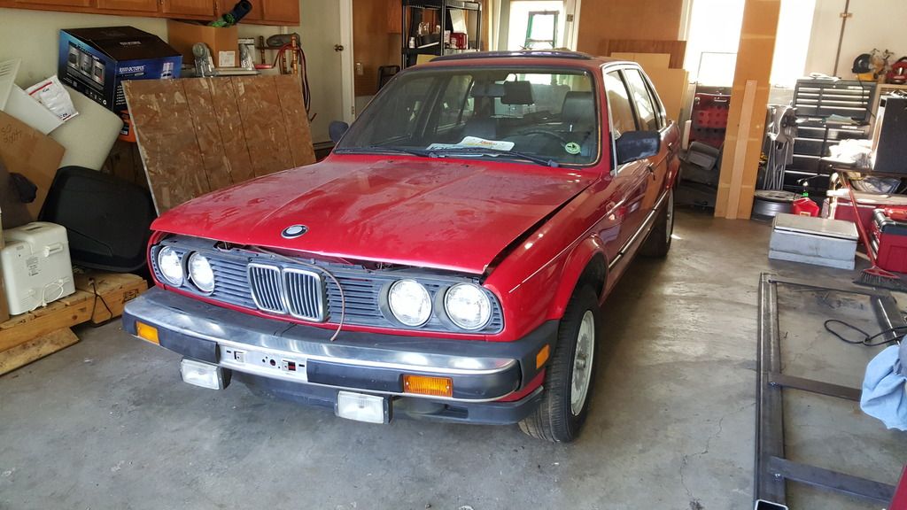

    The car is starting out in what I thought was really decent shape.

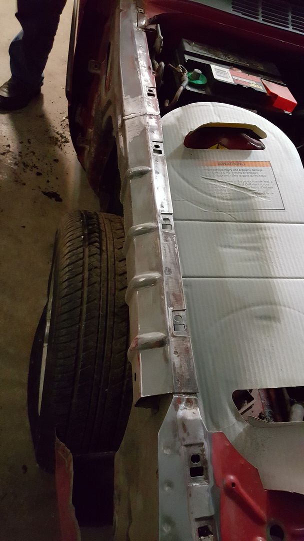

    Due to damage on the body lines and someone dropping the hood. I've decided to buy a new hood and fenders. Also the front end is off of another car apparently?..

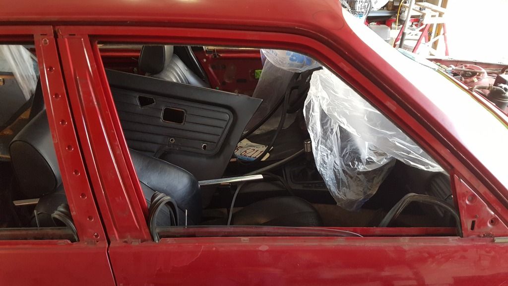

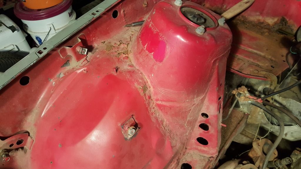

    Rust removal and self etching primer. I removed the fender sealant to the best of my ability as well.

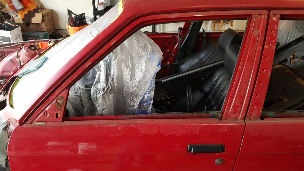

    Peeling clear coat before (Driver Side)
    Peeling clear coat before (Passenger Side)

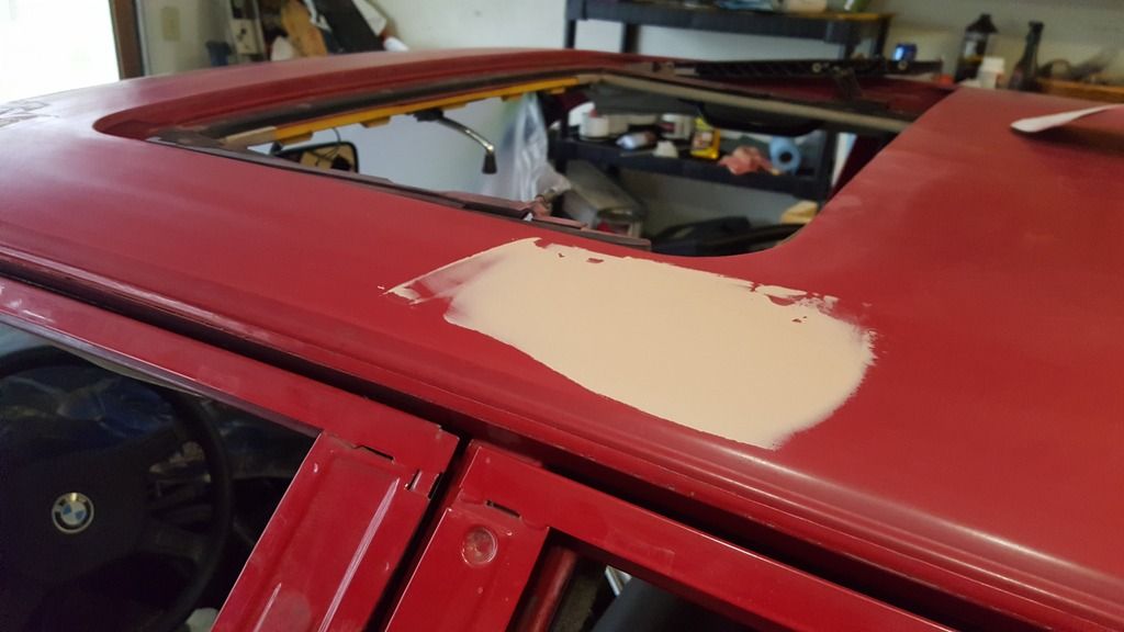

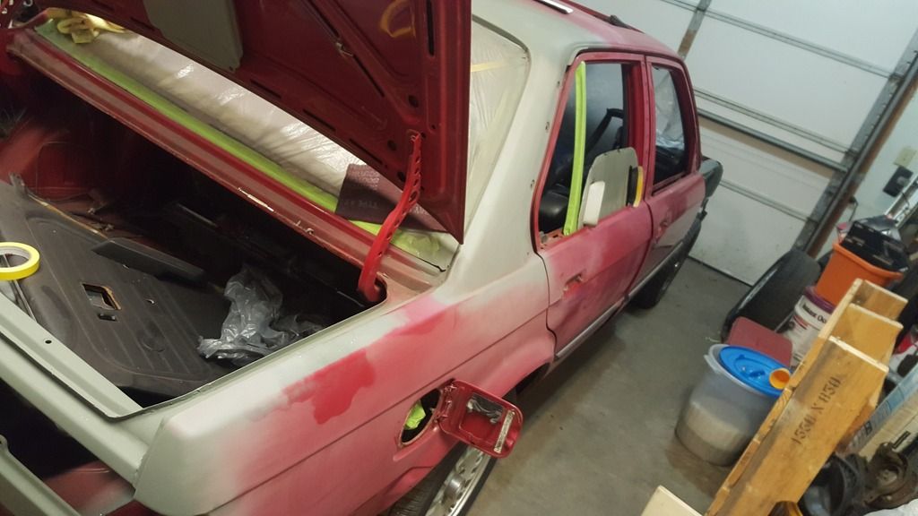

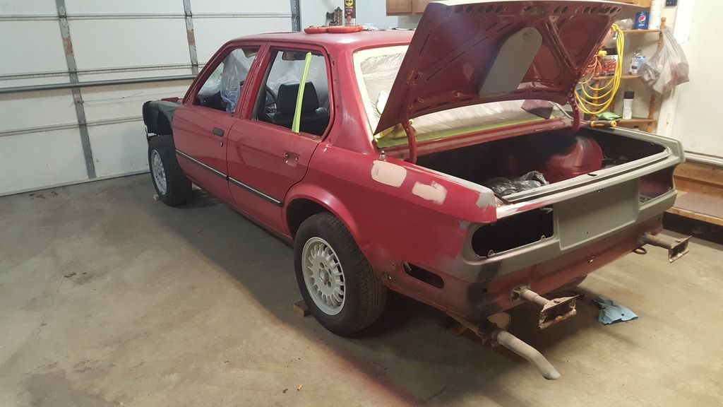

    Body work started on both sides. Tons of small dents here and there. Slow process but necessary. The trunk section has rot behind the driver tail light section. I will most likely use filler to get it's shape back after ruck removal and conversion.

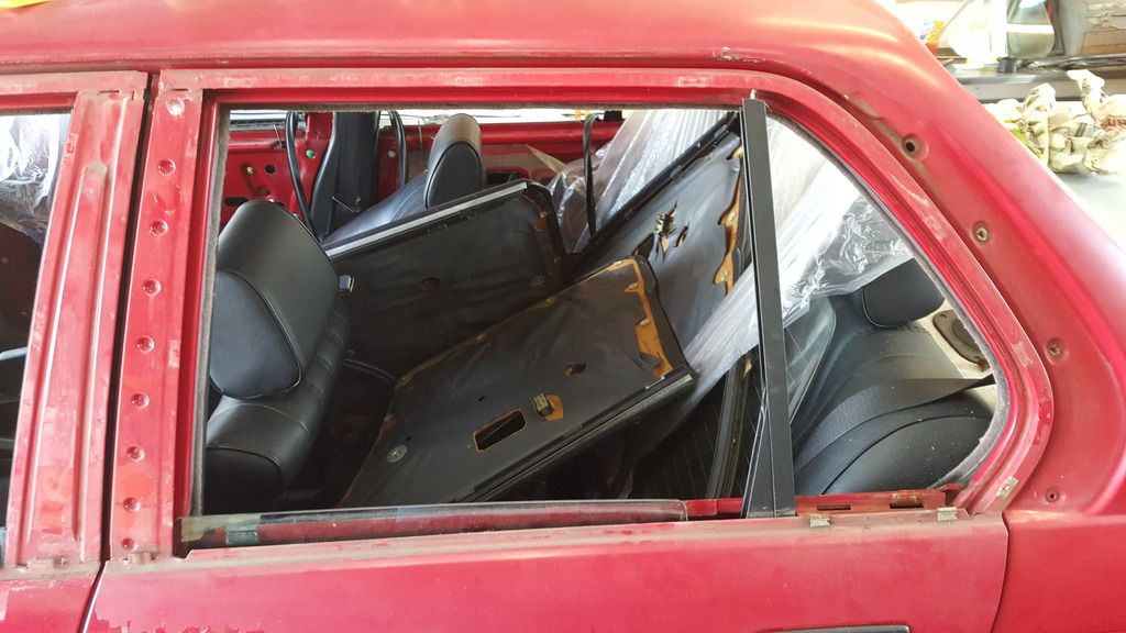

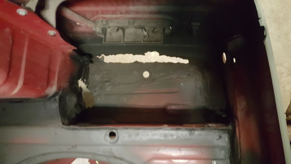

    The trunk didn't fare as well. There are holes on both sides. Driver side will be patched with glass. Thinking I'll have to put new metal on the passenger side.

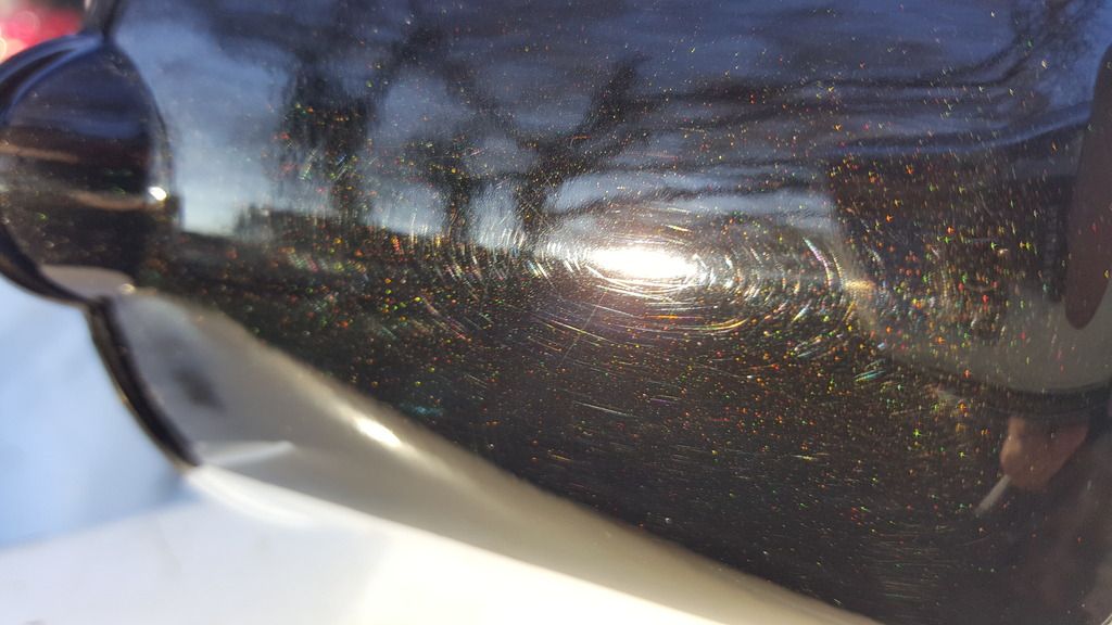

    For reference, this is the color I am using. Saw it, ordered it, no going back.
    This is dipped in the can, clear coated with cheap clear so I could visualize in person.

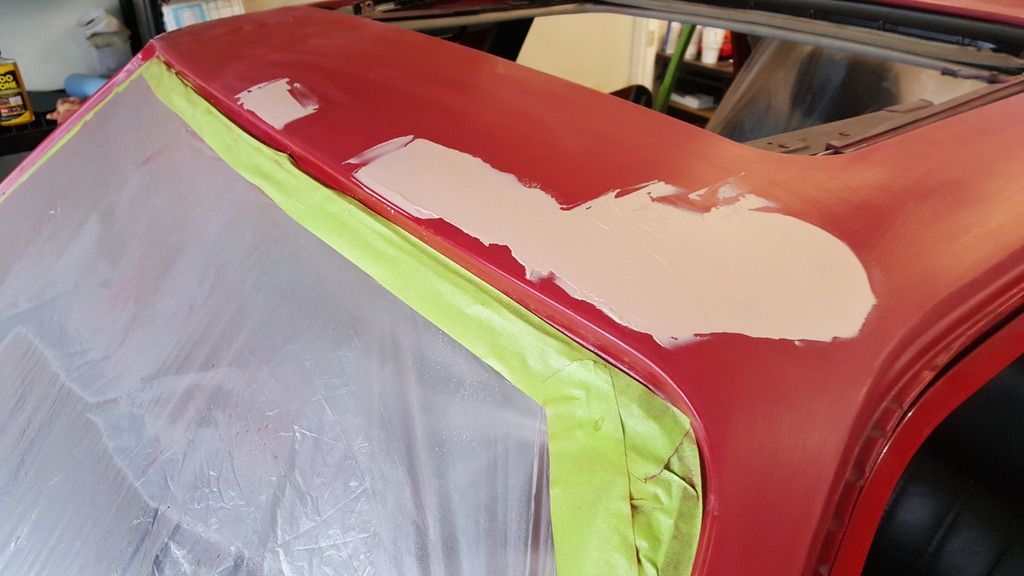

    Some more body filling. Small dents I don't really care to pop out.

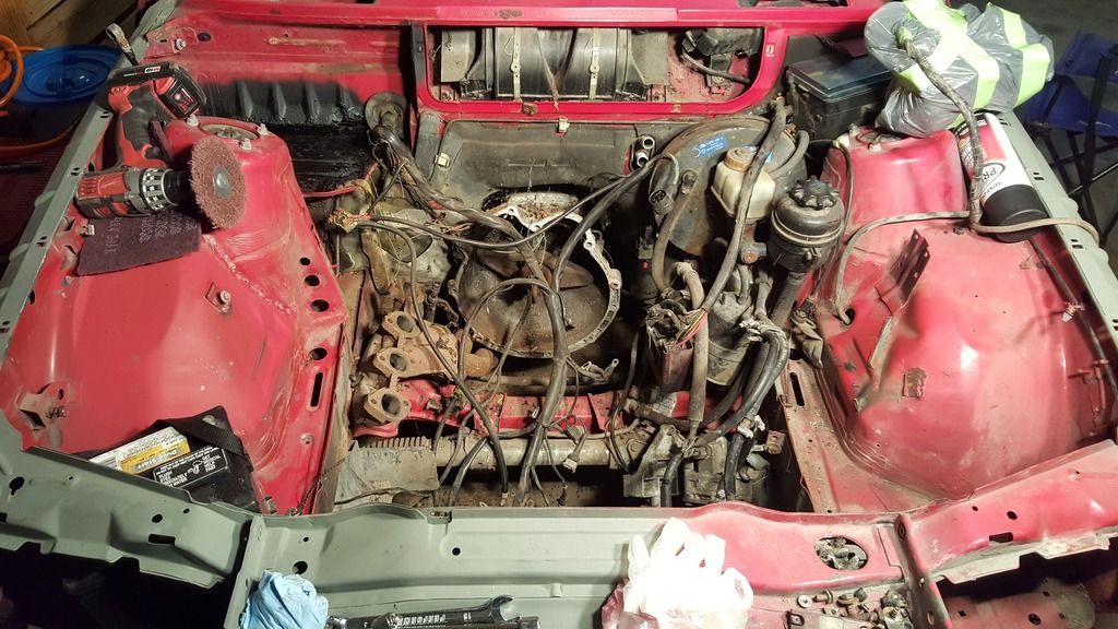

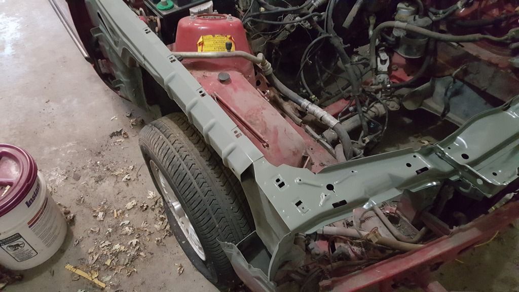

    Cleaning the A/C system out and removing everything from the passenger side of the engine bay.

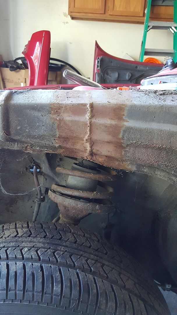

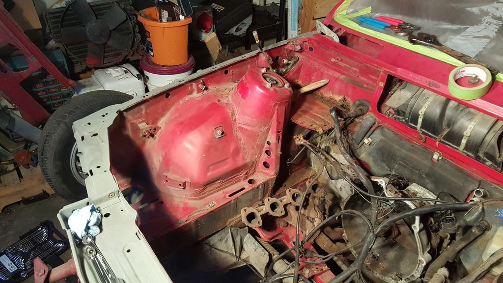

    I've got some rust where the apparent front end swap wasn't sealed properly. I'm going to be flapping that out.
    Here I am with most of the front end disassembled. Using a Chase Bays brake system so I can start pulling that stuff out. Most of the wiring is all pulled out and double bagged. None of the connectors were marked. And I'm swapping. So I may just tuck the fuse box in the car and do away with the rest.

                    The M10 I have is fresh 100%. I just cant see myself putting it back in. Thought about doing an ITB setup on it or throwing the CT26 turbo I have on it. But I just can pull myself to do that. I want more power.
