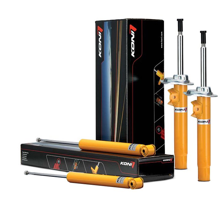

      Koni adjustables, pre-valved by Ground Control for my spring rates:

      The current bistlein struts are extremely firm, and I have reason to believe one or more struts is actually damaged. I can hardly take it anywhere in Seattle without feeling like I am going to rattle the car to pieces. My goal this winter is to get the new struts/plates swapped in, and then go through all the maintenance items to get it running and driving oem+. I think I will raise it another 1" or so, to max out what the ground control system allows. Starting next year I plan to attend a couple auto-x/track sessions to start learning where I want to improve on the car. After spending a couple of days on track with the M2 in Palm Springs in March I am honestly not sure if I want to keep the M3 long term, or if I want to swap it for a 1M/M2 in the future. Once I get it driving like it was meant to again I will have the tools to make that decision ;D

        Yep, strut was not mounted correctly and was damaged, let alone the strut nut was not able to stay tight, which led to them clanking around as everything was loose.
        New Koni struts and GC plates arrived:

            I am replacing the struts and camber plates. The bilstein struts are the wrong size for these camber plates, which is why they got ruined in the first place. The Koni single adjustable's in the photo above are my new struts. Ground Control pre-valved them before shipping for my spring rates:
            Front: Eibach 0600.250.375 - 6”x2.5” @375 lb/in
            Rear: Eibach 0500.225.0450 - 5”x2.25” @450lb/in
