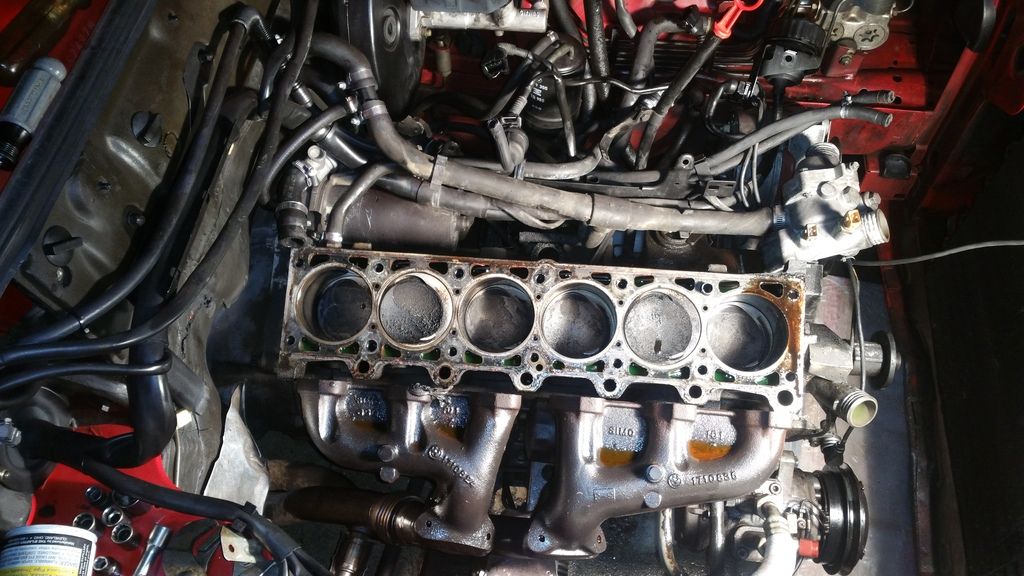

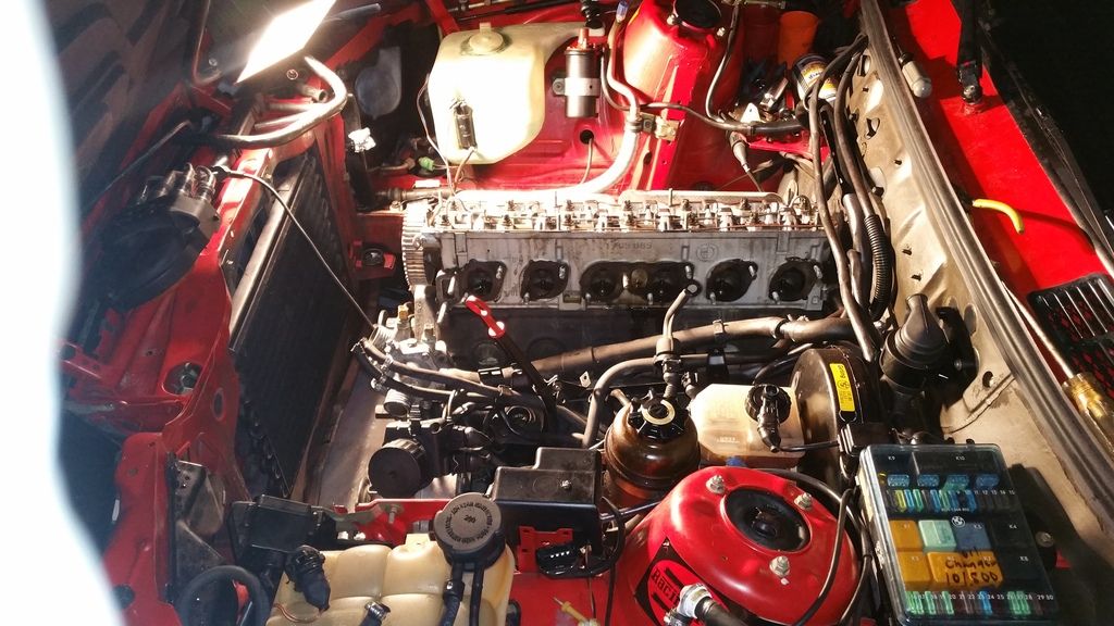

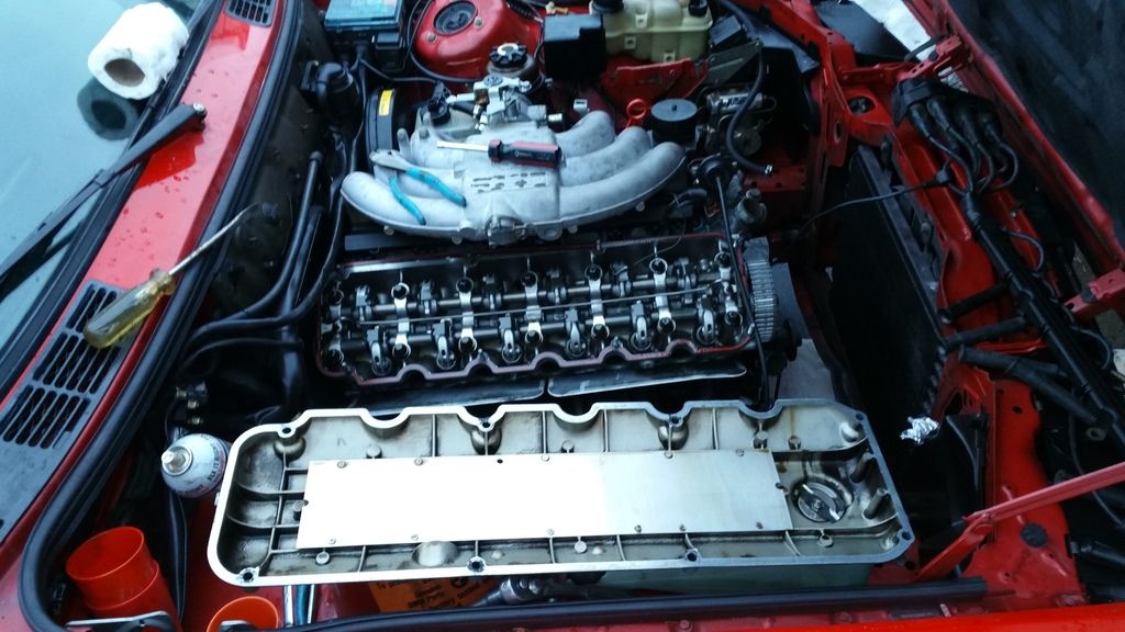

    So I blew my head gasket and decided to just start replacing shit, also painting my intake and valve cover.

        head reassembly
        ARP's and head gasket on, also a generous amount of copper gasket spray
        also replaced my engine mounts while I was in there, made a huge difference on my car shaking when idling, both were torn in half and my engine was shifted over about 5 inches from where it was supposed to sit :???:
