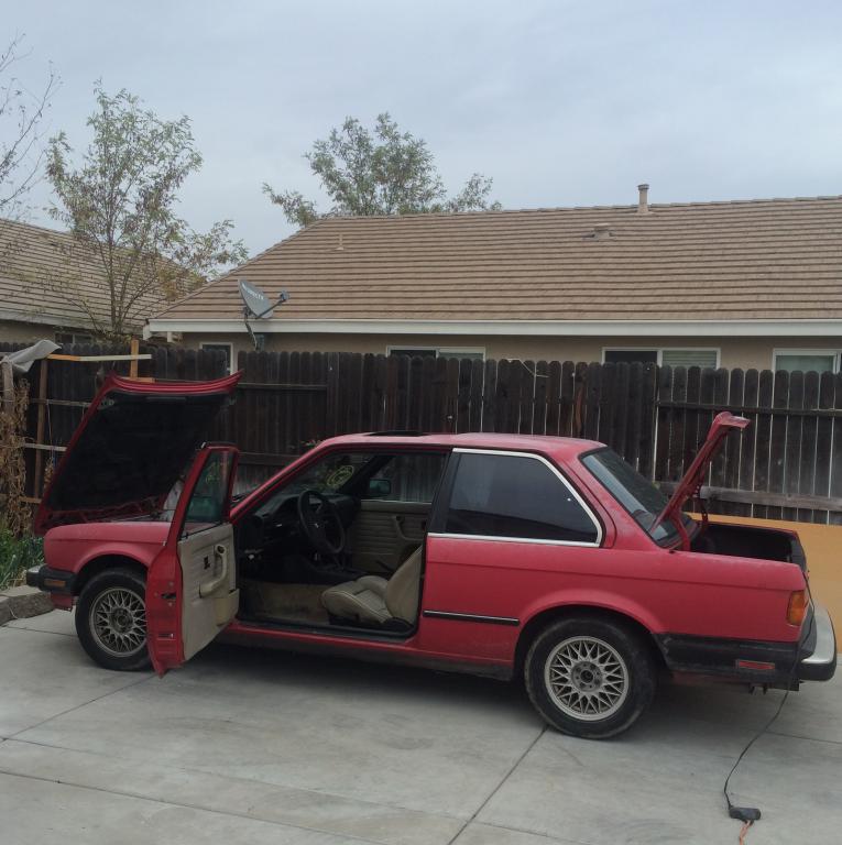

    My brother and I bought an e30 last year over copart and did not see the car before buying it since it was 300 miles away. We won it for a bid of $150 (super stoked) but with all the copart fees it came out to around $400 and shipping, 350 more (twice the winning bid ). Now a little more than half a year later, we have begun digging in and having some fun.
    Currently, we are removing the engine and tranny and want to clean up the engine bay a little. I am also welding up a rear valance from a 1989 325is that we cut off at pick n pull.

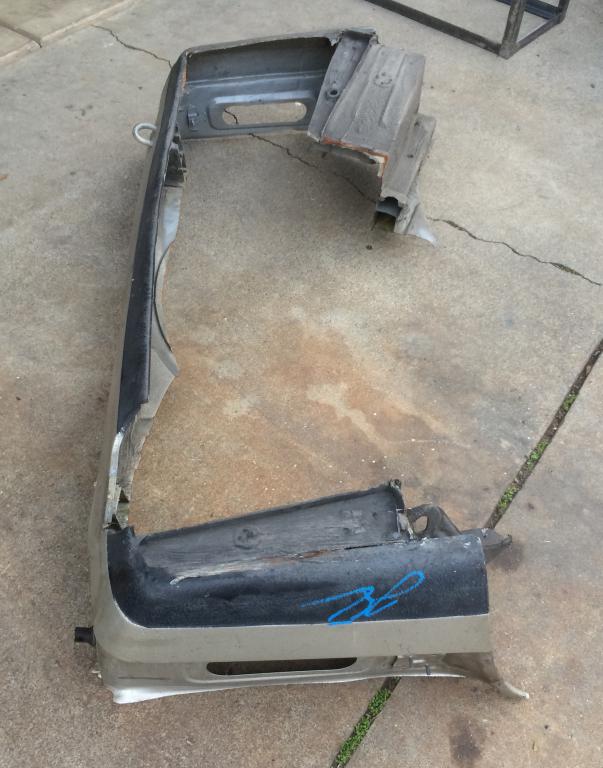

    Rear bumper and valance progress.
    The valance was cut off a 1989 325is from pick n pull. A good blade made the job so much easier.

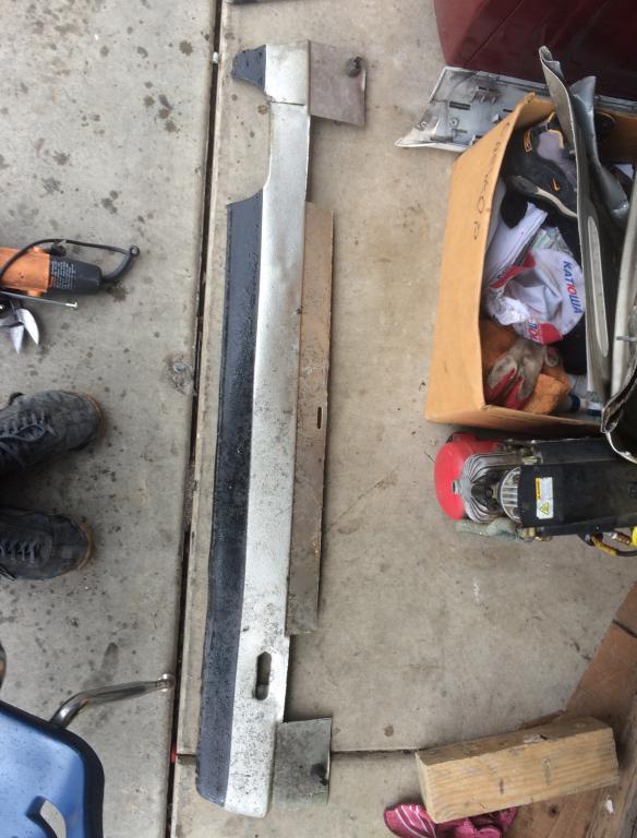

    I then cut it into three parts to make it easier to test fit it onto the car.

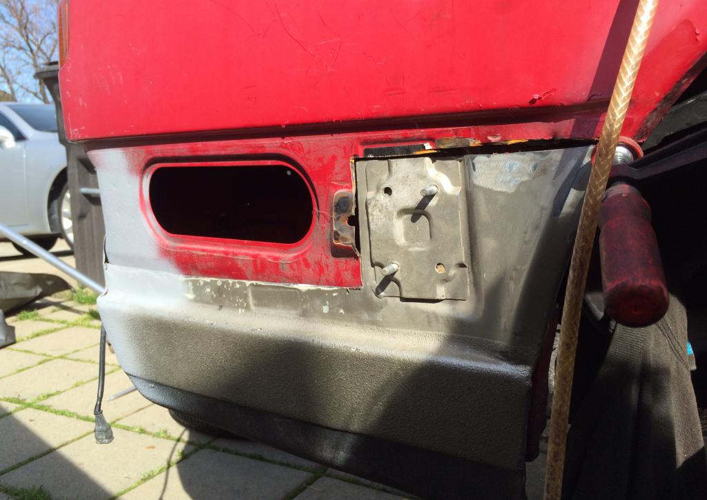

      after rewelding the three pieces together and trying to test fit, I found that it was impossible to just weld on the the valance without getting a huge gap on both sides. So more cutting was needed.

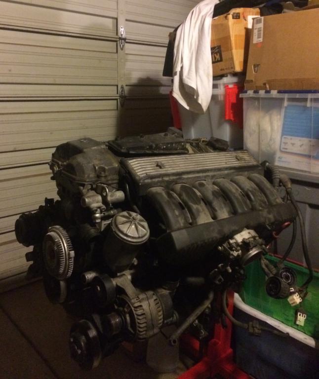

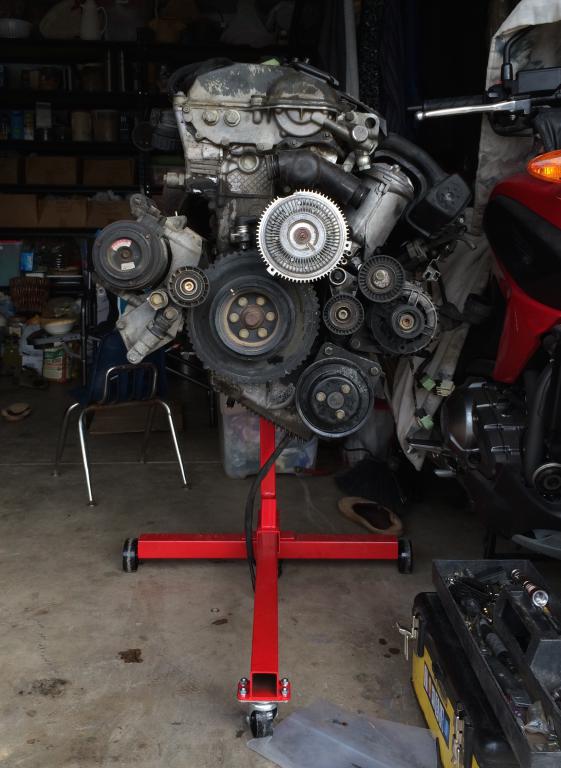

        S50 it is!
        I was looking for s52's and was about to go get one until I came across a s50 being sold for relatively the same price. Since it was from a dismantler, we were able to also get brakes, the whole front suspension, tranny, and exhaust with two cats off a 1995 m3.
        I plan on removing the head and taking it to a machine shop and changing all the gaskets and seals that I come across. Hopefully it wont look too bad down there.
