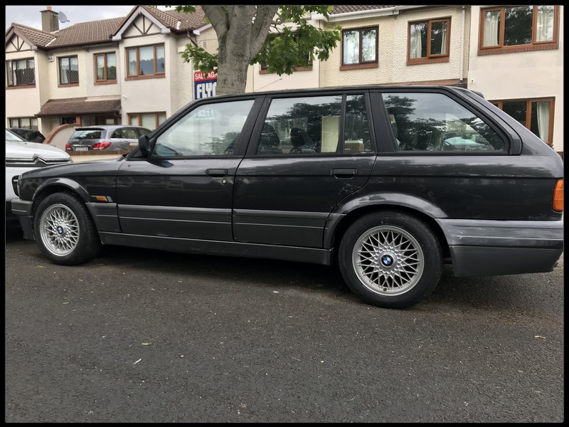

          I booked the car in for a roadworthy test, and decided to drive it back home a few months back. It became apparent pretty quickly that the car wasn't ready for the quick test I was hoping for - few electrical niggles with the indicators and brakes, tracking way off, and a fuel hose that's flowing more petrol across my road than into the injectors themselves (craked fuel hose just before the pressure regulator). All in all nothing major at all, but the test was quickly cancelled and I set off working on the car as soon as it arrived home.
          First up was the eyebrows - a job I'd been looking forward to since first setting eyes on the car. I even managed to sell them after removing them.

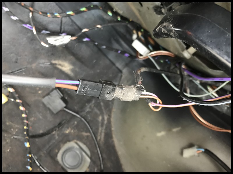

          I removed what was left of the loom and speaker wiring, and soldered it up to a new ISO block connector.

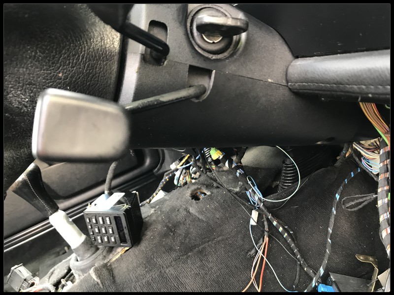

          Next up was removing a heap of relays and crappy wiring put in place for the tow bar and various old alarms.
          The wiring block at the ignition switch was chopped, so it was tidied up as best I could. A connection was had also been made inside the C101 plug to the ignition wire which just fell apart on contact. Would have been a nightmare for me to diagnose had it gone of its own accord, so was the perfect time for it to break.

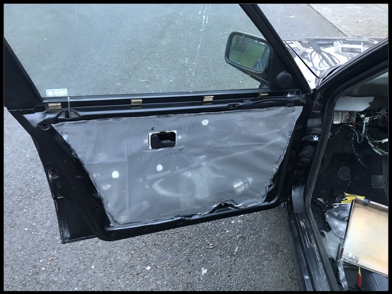

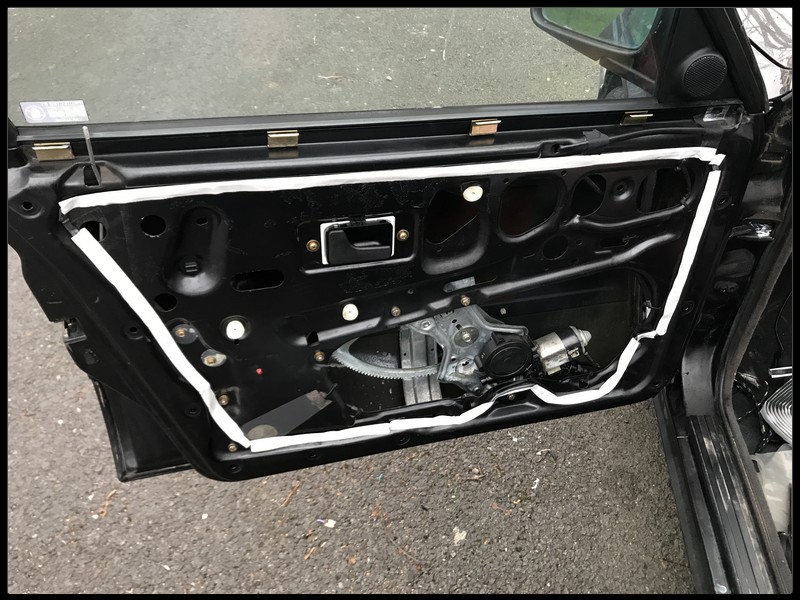

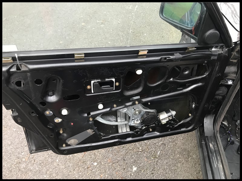

          I picked up the four electric window regulators and looms - but as I rapidly found out, the window loom isn't separate from the rest of the loom, and it was slightly daunting on first sight.
          Didn't take very much time at all to sort it out. Used tesa cloth tape to tidy up each section -
          Fitting it up was all pretty straightforward - I snipped off the existing connectors for the back doors, and soldered in the new one from the loom with the electric windows. For the front I removed the pins from the new loom for the windows and just inserted them into the existing door plugs. Fitting the regulators for the front results in a few scratches - but it worked more or less first time. Took about 2 mins to realise that it needed a relay added to the fusebox, but it was all good after that.

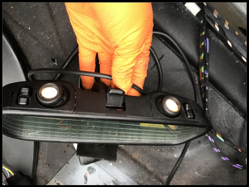

            The maplight mirror that the car came with was connected to nothing - but thankfully it still had its connector in place. Was able to buy a reproduction loom for it - it connects in by the passenger side speaker in the footwell. The connector was pretty badly oxidised so I was a bit concerned it mightn't work, but some electrical contact cleaner and a bit of abrasive action had it looking better. Thankfully it all worked first time.

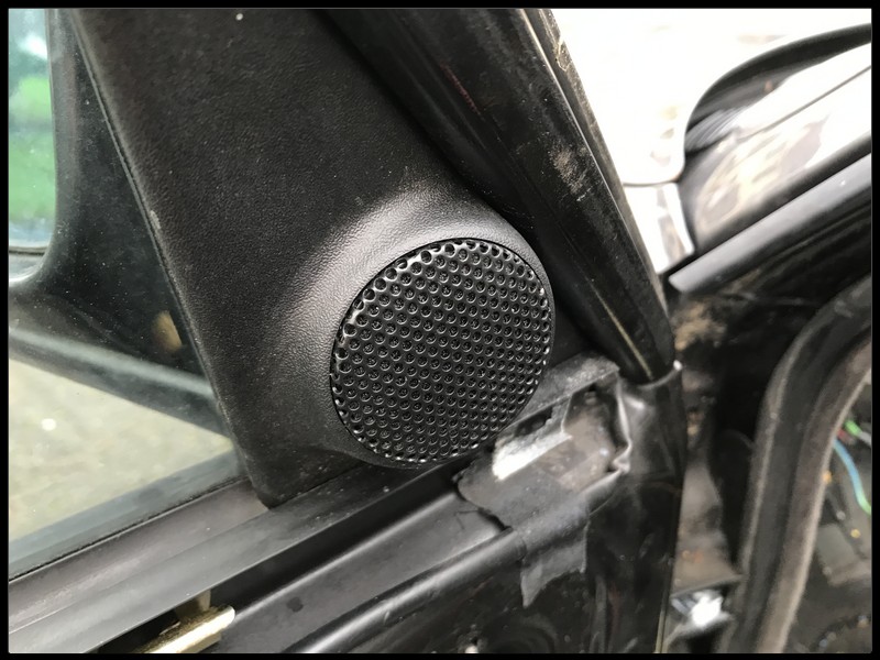

            Also salvaged some OEM tweeters from my brothers cabrio before it was sold - they were never connected up properly in his car, so I have no idea what they sound like. I'll be buying some Rockford Fosgate component speakers for the footwells which have the built in crossovers and additional connectors for the tweeters like the original BMW premium speakers would have had so connection should be easy. Still undecided as to whether or not I'll remove the actual tweeters from these and connect in the new ones which will arrive with the new speakers - sounds quality would definitely be better, but its low down the list of priorities.

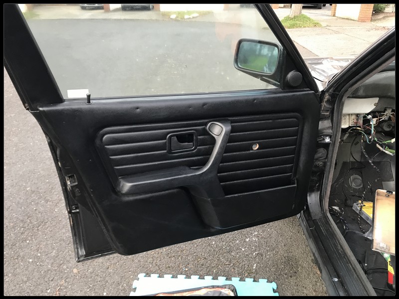

            With the electric windows all fitted - I could stick some doorcards back on. Its important to have the weather proof membrane back on the doors - so I ordered some from a VW specialist on eBay. I used butyl tape to secure it as recommended.
            The doorcards are being kept - but they'll be getting a retrim in a while.

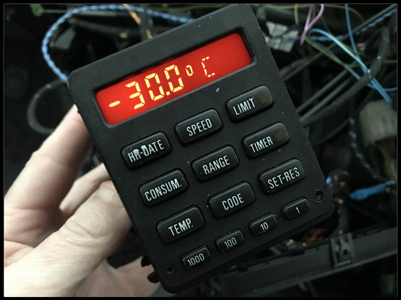

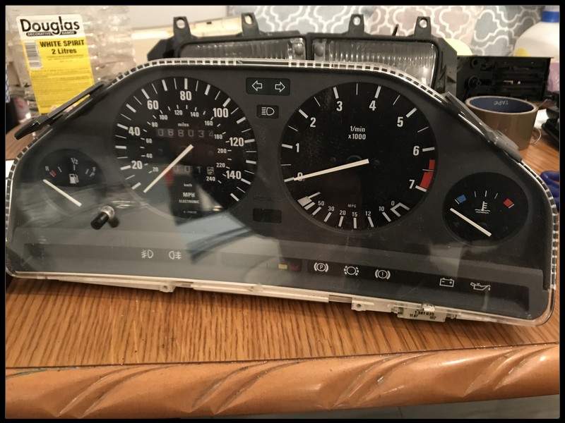

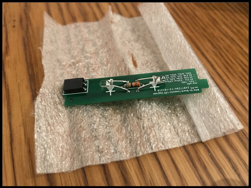

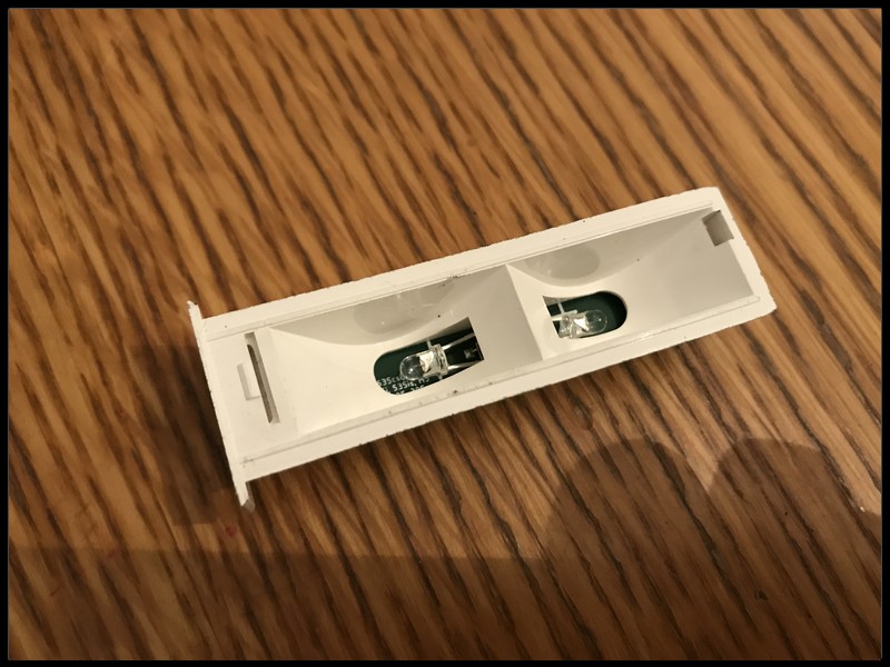

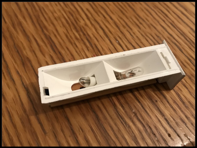

              Another small job sorted - the OBC I bought had a very dim screen. Depending on who you ask, the problem is either the bulbs in the lightbar on their way out, or the LCD screen giving up. I've no intention of dismantling this car again, so decided to replace both. I sourced an LED lightbar from the US, installation is a case of just clipping the new board in place of the old circuit board.
              New lightbar -
              Old bulbs in place -
              LEDs in place -

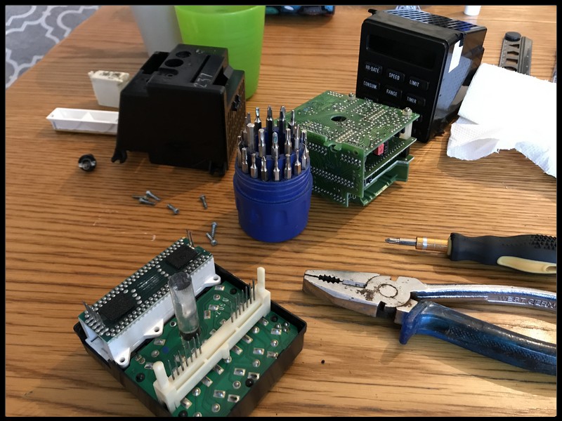

              Taking the OBC apart is simple enough - you'll need a mini screwdriver set, some brute force, and some patience.

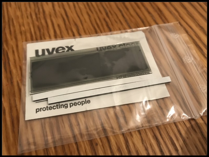

              Up until recently, your only hope for a new screen was a used one. Partsworks in Germany have started supplying brand new screens now for a variety of the OBC's (6 button, 13 button etc). Cost around €35 delivered and arrived well packaged with fitting instructions.

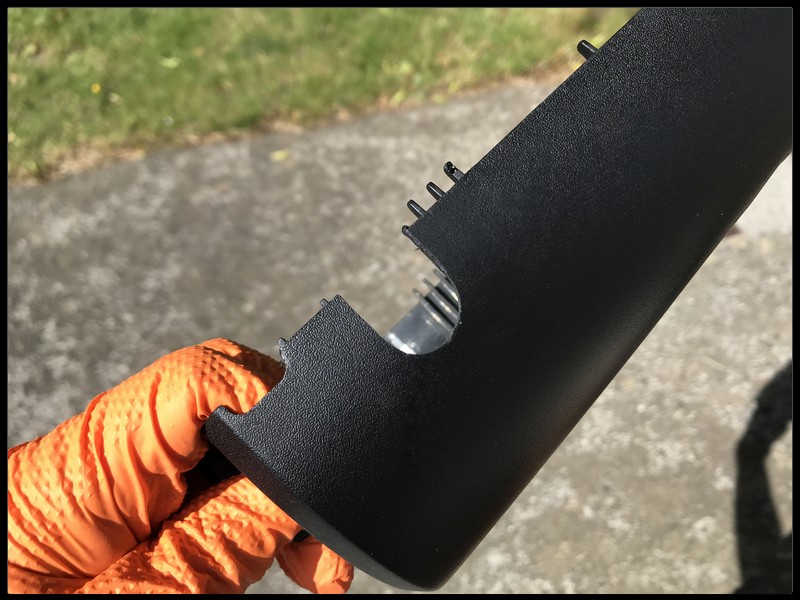

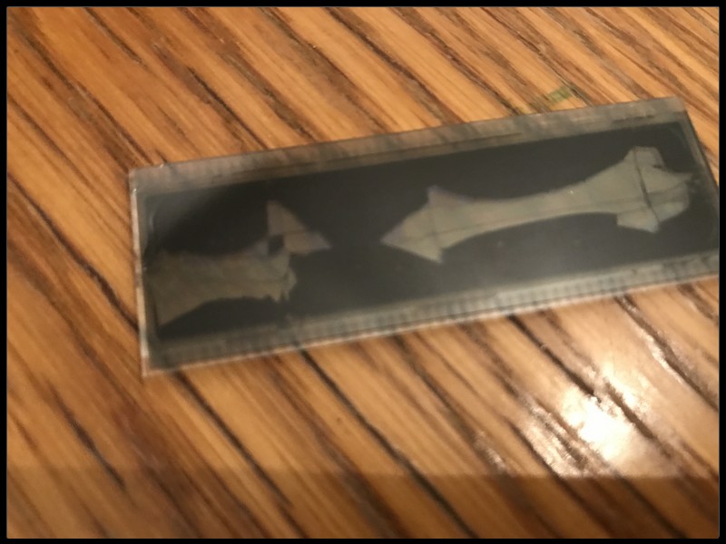

              First attempt at installation was not a total success. All fitted up fine, but on clipping the back of the OBC back on, there was an audible cracking noise.
              Not ideal - am not entirely certain what went wrong, but after an email to Partsworks they supplied a new unit for postage costs only, which was unexpected to be honest. New screen fitted up easily enough, I was very careful tightening up the screws for the screen holder in case that caused the initial problem. Fitted it to the car and worked perfectly - nice and bright. Temp sensor is still to be fitted :)

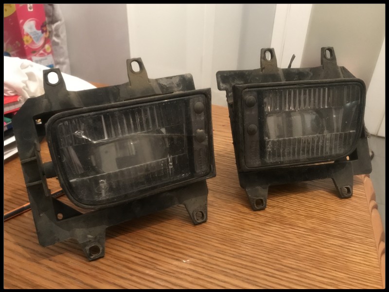

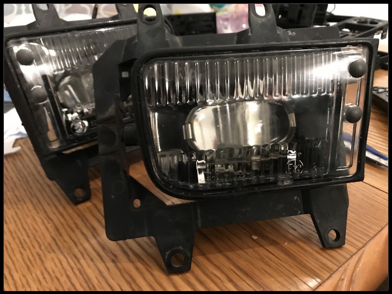

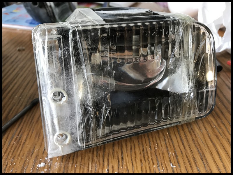

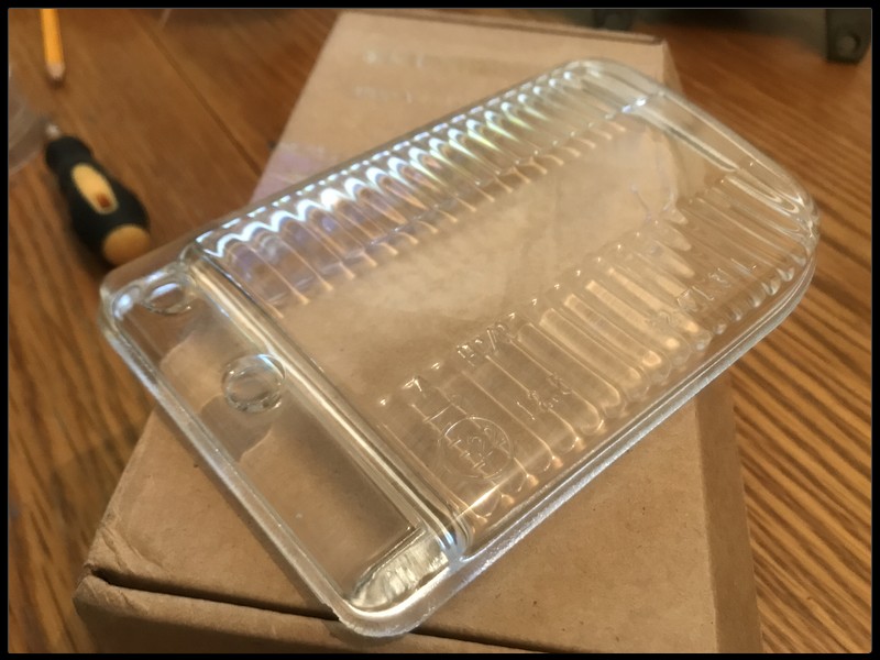

                Picked up a set of genuine foglights which were in need of some cosmetic work. There are loads of aftermarket fogs for sale on eBay for very small money, but they have plastic lenses and I'm happier going with the OEM ones. One of the lenses was cracked, but the other way fine - just grubby. Bought a set of glass lenses from eBay - seller neglected to mention that the holes for mounting and adjusting them weren't actually drilled out though.
                The issue with the hole was only discovered after I'd bonded the new lenses on - so had to drill them in place.
                Thankfully the glass didn't explode once the drill hit it - carefully removed the outer seal from the original lenses before removing them and bonded them on as well. Makes a nice improvement anyway.

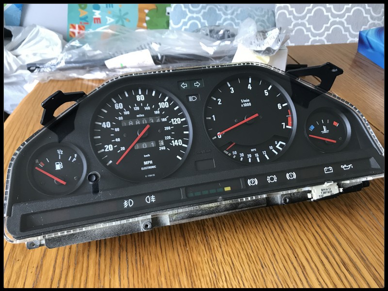

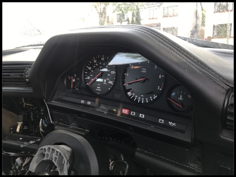

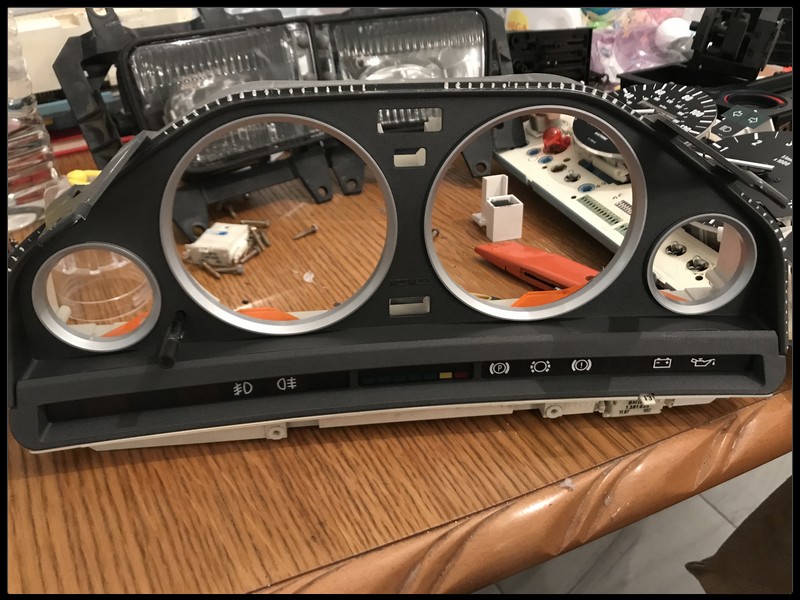

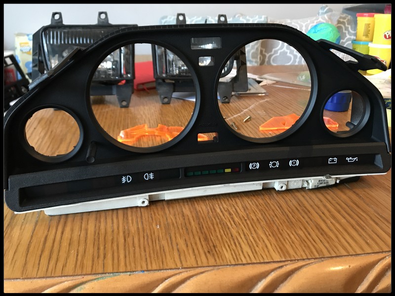

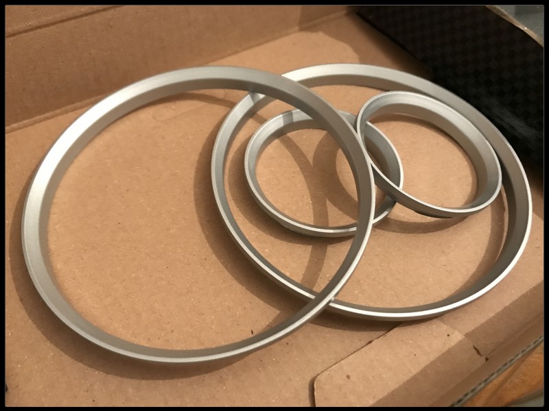

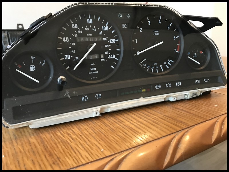

                Being a fan of Bavarian Restorations' work - I decided to make a subtle change to the instrument cluster. Overall - the existing cluster was in great condition -
                Bought some satin silver gauge rings from eBay -
                Split down the cluster and fitted the rings -
                Sprayed the whole lot in satin black trim paint -
                And reassembled -

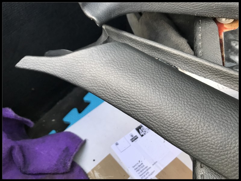

                Finally, started fitting some of the trim pieces back which I've been having retrimmed - these have a plastic vinyl covering from the factory, so went with a newer equivalent. I could have spent extra on real leather for these parts, but its not really necessary - very happy with how they turned out. Just waiting to get my headliner back before fitting the rest of them.

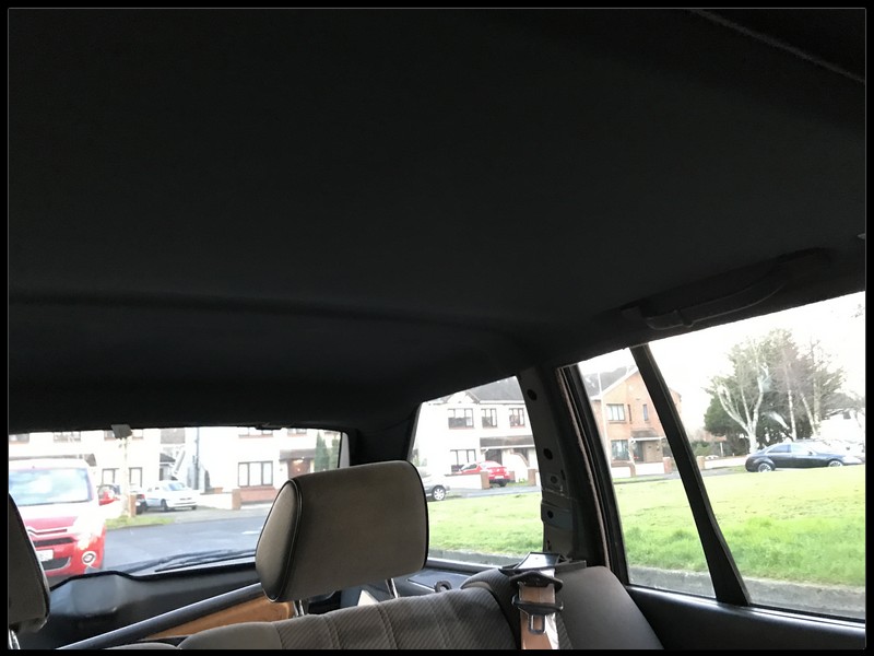

                  Have one an absolute mountain of work with this since the last update - but don't have much to show for it. First up was the headliner - thankfully the touring has a solid headliner like an E36, so fitting it not a windscreen out job like the 2 door / 4 door. I had it trimmed in standard black headliner material - its foam backed and has a nice quality finish to it.

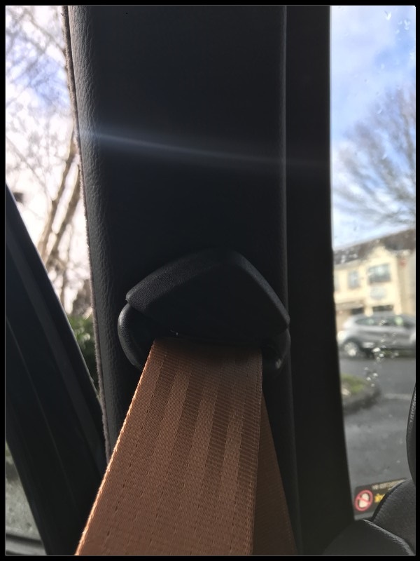

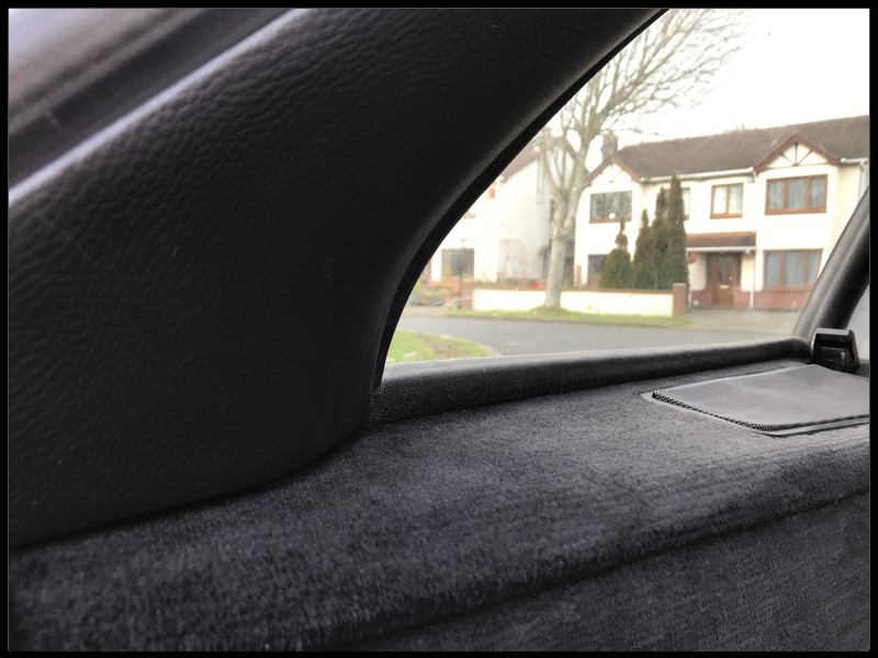

                  With the headliner in place I could put in the B pillar trim - and the new seatbelts. Had these custom made in the UK to match the interior which will be going in.

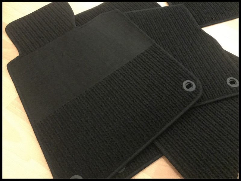

                  Managed to get some very good quality floor mats in similar style to the OEM country mats - got a boot mat while I was at it too.

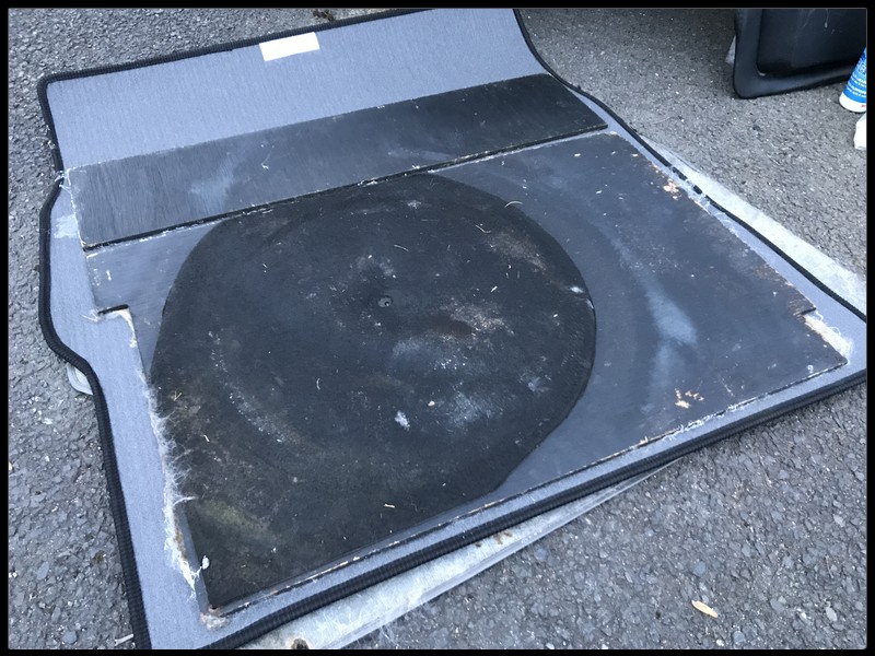

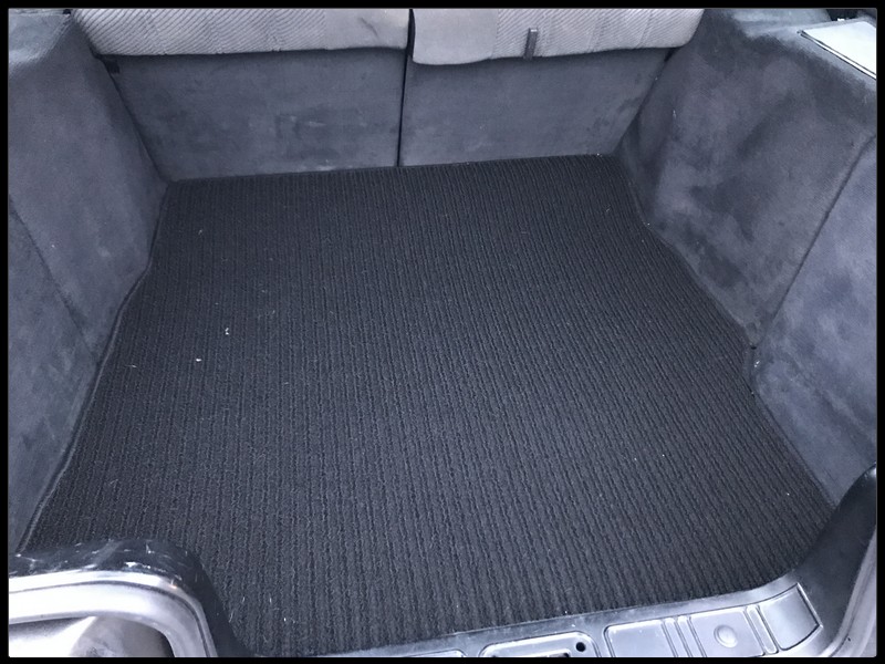

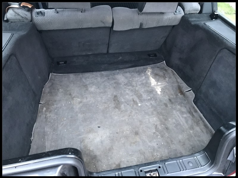

                  Boot carpet had seen better days...
                  I removed the wooden backing from the old mat and glued it to the new one -

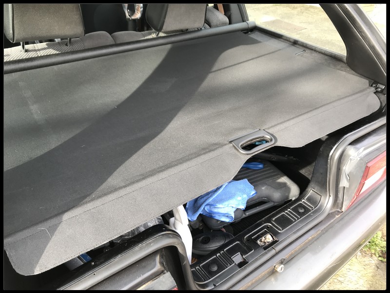

                  The parcel cover was also totally scruffy - so ordered some marine grade canvas, as well as an E46 touring cover handle -
                  At this stage I discovered the roller blind mechanism was shot - I managed to get a replacement one from Germany. Its working better, but not perfectly as the blind is quite heavy and the new blind is only rated to 1.5kg, so I need to load the spring up properly again and see if I can get it working properly. If not I'll end up ordering a good used one.

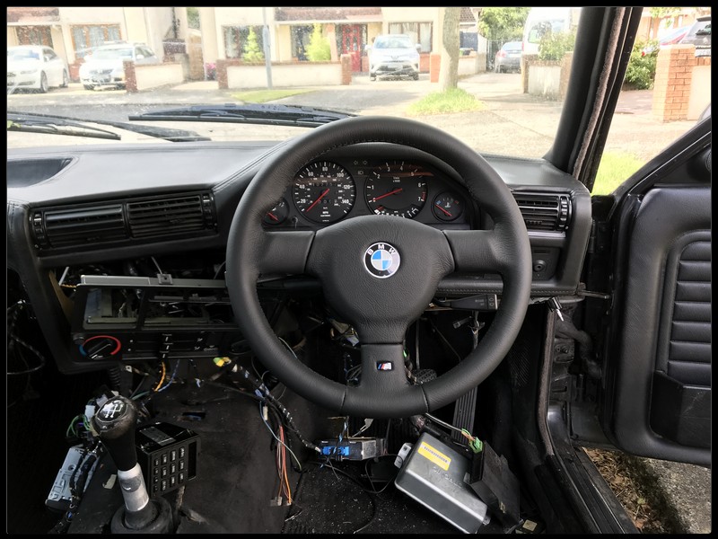

                  Having the dash back in meant the steering wheel could finally go in -
                  Needed to alter the steering trim to account for the new cruise control stalk - having a dremel is a prequisite

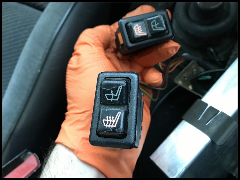

                  And last but not least - the seats could go back in (again) meaning I could test the heated seats, and thankfully they worked first time. The E30 is a joy to retrofit bits to - they all just plug straight in, and the heated seats are no exception.
