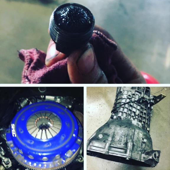

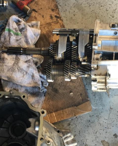

              Got tired of hearing tons of noise and whining sounds from my trans, decided to drop it and split the case to rebuild it

                Is it hard to put the case back on?
                  Haven't got there, but I can't imagine it would be, least not especially.
                  I just stood it on it's tail in a 20 ton press and supported each side with a jack-stand on the slave attaching points then pressed the case out..
                  Wasn't a big deal, didn't need a BMW tool.
                  Not that you can find g260 tools/small parts anyway.. :devil:
                  They're too inexpensive and still fairly robust. Give it 10 years and there'll be a market for rebuilding them.
                    UPDATE! Trans has been back in the car, drives about the same, 3rd may still give me a little hassle but oh well.. and it still leaks, no matter how many times I try to reseal it..
