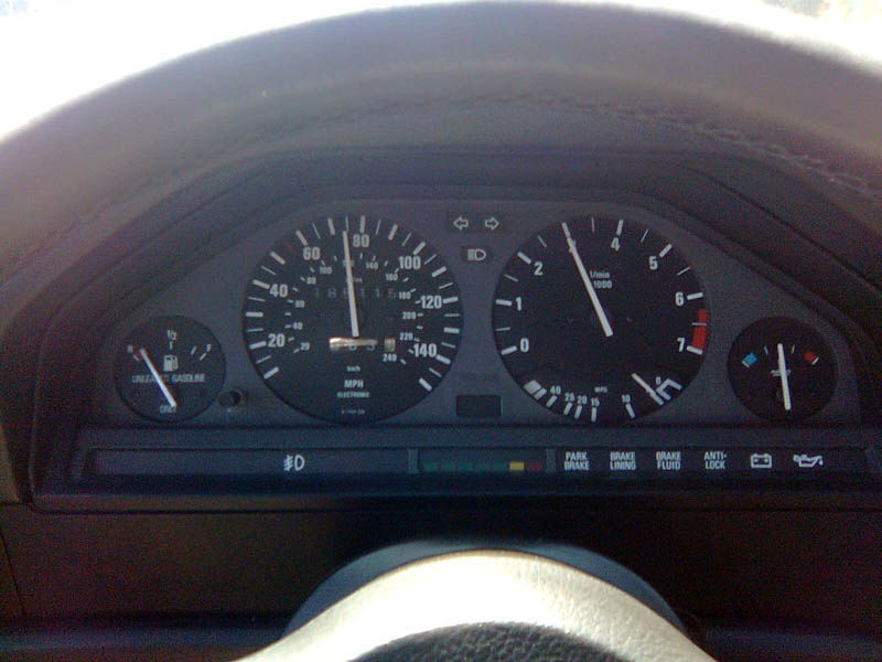

                            Installed check engine light bulb today and replaced the front strip for the indicator lights in the cluster with one from a non-abs car. I don't want to take chances with BAR asking me why my ANTI-LOCK light doesn't work etc.
                            more like it
                            little bit of cleaning
                            ready to swap
                            no more chrome cluster rings, I think i'll stick with this look for now. those chrome/plastic rings in my experience also block the light from the light bars inside the cluster.
                            check engine light
                            Done for now

                              Very nice Jean! Keep the chrome rings off, it looks great! I totally forgot about polishing the plastic piece. When I do my cluster I'm definitely doing that.
                              I assume everything has to be American spec on the cluster, that will be a bitch to do for me hah. It looks awesome though, fully functional gauges are very hard to find and really make the difference while driving.
                              What is your check engine light wired into to make it illuminate?
                                My bet would be the engine computer...
