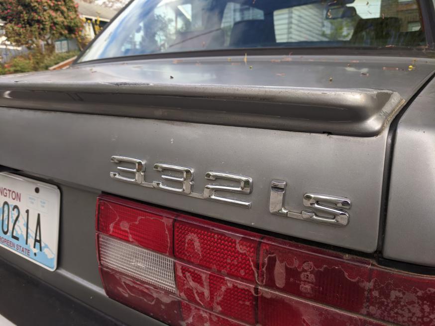

  • Metallated
    replied
    Originally posted by jeenyus
    this is awesome.
    As far as those rear taillights go, it looks like you used a 1k clear coat (probably). i'd highly recommend using a 2k clear from an auto paint supply store. I did mine that way like 5 years ago and they look just as nice as they did when i first did them. I live where our winters are harsh and i've still had zero issues/fade.
    Thank you!
    And I appreciate the insight into the tail lights, I got them the way they are off of a parts car, and the peeling has been getting progressively worse. I will definitely try the 2k clear.

  • jeenyus
    replied
    this is awesome.

  • Metallated
    replied
    Originally posted by Skarpa
    Neat Emblem! Especially the fact that it's in the older style. Where did you get it from? I've been considering a custom emblem and actually modeled it in Solidworks. The price for a 3D printed stainless was just a bit steep for my liking. Although mine of course said "ARMO"
    Hahah thanks. You can just barely see from this angle but it is actually just two 325 badges stitched together!
    Like you I wanted to machine one, but now that my school's machine shop is closed I will have to wait. Most likely I will try to machine it out of aluminum (much easier to machine) and then chrome plate it.

  • Skarpa
    replied
    Leave a comment:
  • Metallated
    replied
    Swapped out the emblem to better represent the displacement.
    I was tempted to leave it stock, but so much of the rest of the car has been messed with by previous owners I don't think it makes much sense to worry about keeping it original. (Also yes I need to clean up the glue strands around the new emblem).
    I really need to re-clear the tail lights, but I have tons of time because of COVID so I'll get to that soon.
Name:	332 emblem.jpg
