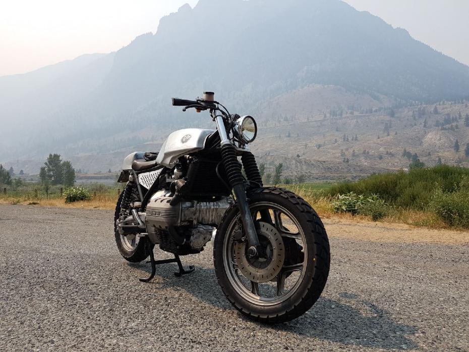

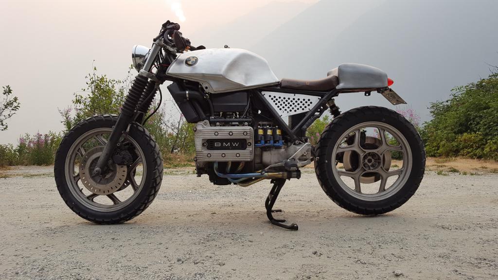

            So - to keep it interesting - here are two photos of the BMW k75s I built this year. I like them to operate as well as possible but look a bit scruffy. This is partly because that's how I like to spend my limited funds, but also because pretty things make me uncomfortable.
            The e30 will be similarly flavoured - but at least will have paint.
