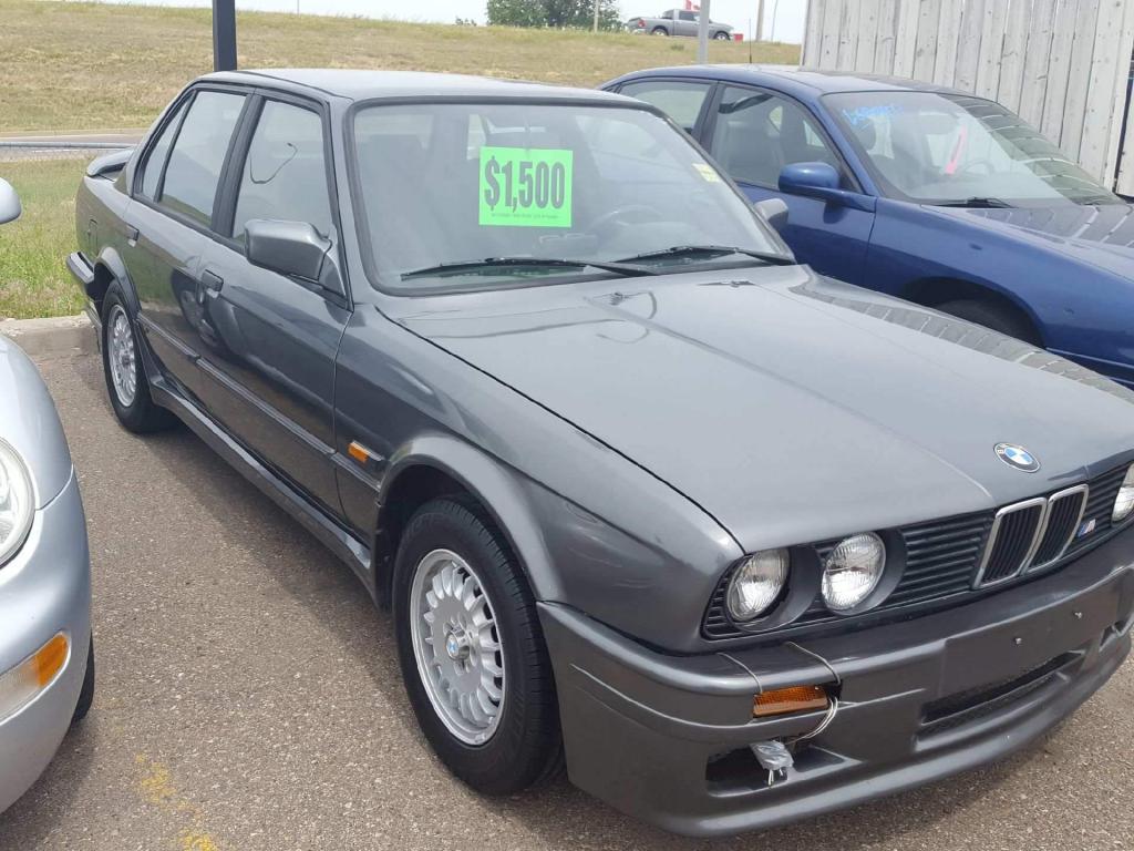

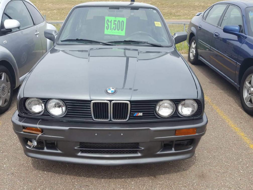

    you should probably post a picture of your car so we can actually see if its a I or an E car. As far as sourcing parts, look for a parts car thats in bad shape, i.e blown headgasket, small fender bender etc and take everything you need.

      I've attached them, This was at time of purchase, (front bumper is fixed). Is this what you had in mind or were you thinking engine?
      because yes it has this:

        Post up a pic of the car!
        I'm curious to see the mtech kit on it, because an early model is traditionally fitted with an mtech 1.
        Also, you're right about 325i not being available that year.

            I put attachments on that previous post, is it working for you? If not I’ll try to figure out how to get them up…. Forum newbie here. Anyways I’m pretty sure it’s an Mtech II but let me know, I’m getting everything else wrong so you never know.

              The pictures show us a grouping of body parts, it certainly isn't a full Mtech I or II kit.
              It looks clean from the two pics you posted. 4k over a single winter is a decent budget, hell a kick ass budget, relative to many R3ver's.
