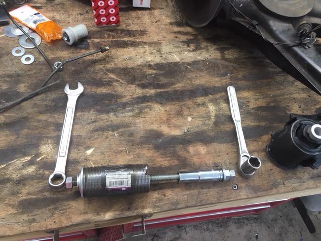

This is the tool I made to remove the trailing arm bushings. It's a length of 7/16 rod cut to length and oiled up with a series of nuts and washers and a 13mm socket to drive the old bushing out and into the 4" length of pipe with a notch cut out. It worked great and cost around $10. I put the new ones in with my bench vise, which was an endeavor in itself. Protip: periodically lubricate the threaded rod inside the vise.

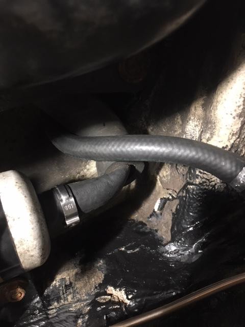

I replaced all the fuel hoses in the car and when I'd replaced the 12x18 one along the top of the tank that connects the low pressure fuel pump to the high pressure one, I ended up with a kink. This was the hose spec'd by realoem so I snapped a pic and went to find my old hose to compare. I took this pic before I massaged most of the kink out and posted it to r3v facebook hoping for an immediate answer.
and of course was treated to nothing but kindhearted and helpful responses by some of the friendliest people I could ask for. But at least I got my answer. This is a hose that realoem says correct for early 318i's and M3's. I bought one and when it came in was a dead match to my old hose. So if you're wondering, 16121178823 is the hose you want if you have a dual fuel pump system. I used oetiker clamps on everything save for the connections for the fuel filter, because that is supposed to be serviced more often than anything else.

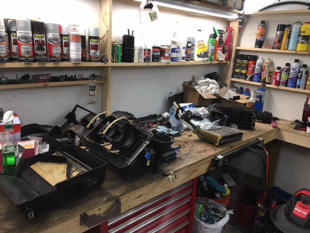

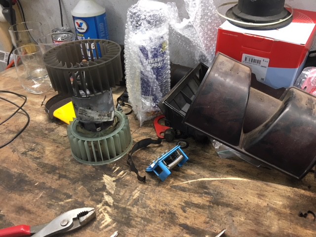

I took apart the IHKS to clean it and replace the blower flaps which I'd broken removing it from the car.

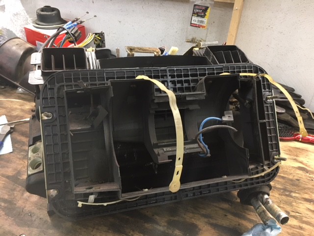

I also rewrapped the wiring harness. Or, most of it, being that I don't have a rivet gun and couldn't split the case in half. The rest of it is held together by a series of clips around the perimeter and isn't difficult to take apart.
I got the old gaskets off and replaced with new, which were $30 each from FCP. One of my straps had broken and I was able to source a good one from a friend's parts car. In the pic you can see that the rod connecting the recirc motor to the flap is actually connected to a broken flap. I used 2 part epoxy to glue that bit back together, and while I was at it, fixed a few other cracks I found in the other side flap.
I'd bought a brand new Behr blower motor and resistor a few years ago from Bavauto (RIP) so those went back in

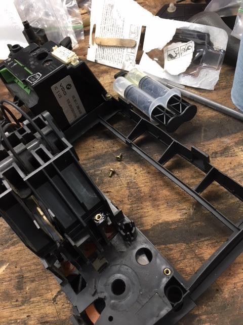

And I found more things to glue in the back of my heater control panel. The plastic around the receivers for the retaining screws securing the temp control to the face plate had cracked, so we glued them back up!

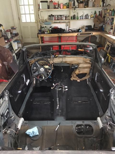

I would have rather sectionalized the build, but there were certain major areas that had to be removed together to fix problems underneath. For example, both the motor and interior had to come out to fix the rust in the firewall. My strategy was to disassemble the car from the front to the back, and then reassemble it from back to front. I put a great deal of thought into the order of operations, ie which parts had to be removed and replaced in the correct order, and the structure that plan provided kept me on track. The only part I've failed at is having to remove the brake booster like 6 times because I clocked it 180 degrees off or I forgot to attach a brake line clip or forgot to install the throttle cable. But at least it's not so much of a bitch anymore...

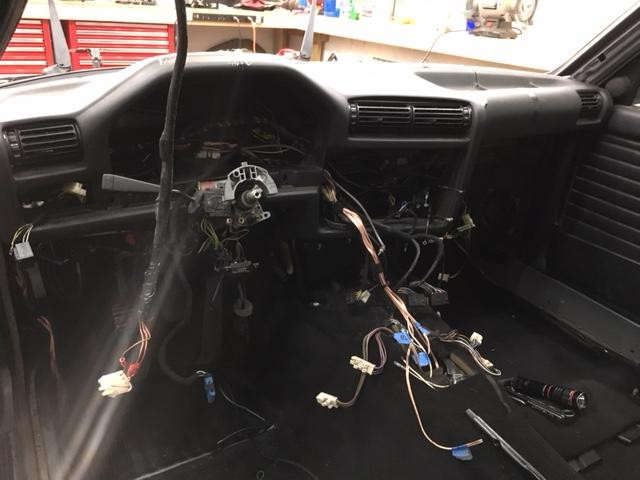

I put the heater box back in the car, rewrapped the wiring harness, and put the dash back in. My dash is cracked but I have a molded dash cap that I got for cheap so we'll try it out.

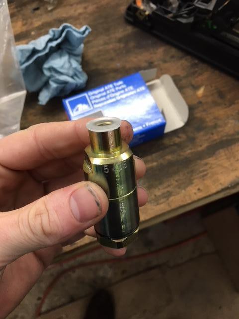

I had a recurring brake fluid leak where the rear damper is so I had to pony up the cash and buy a brand new one of these. $58 later...
I painted the charcoal canister and installed it along with the power steering stuff. Assuming this piece fixed my brake fluid leak, the engine bay is ready for the motor...

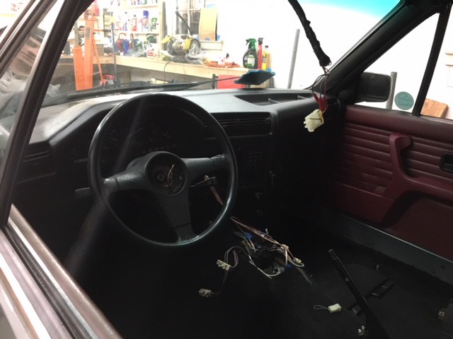

My dash is cracked af so I bought a dash cap earlier in the year when I found one for about 130 shipped brand new. That beats 300 for an uncracked dash that may just crack anyway down the line. The instructions say to glue the edges with the provided RTV and then let it sit for 4 hours. Mine was a tight fit so this is what we did! I used 32 of these lead batteries, borrowed from my work, to weigh the dash down overnight while the glue cured.
I forgot to put the steering wheel trim on when installing the dash and broke the ignition switch cramming it in, so I had to solder one of the wires back on. Here's a picture of the switch. The broken wire is underneath all the others, which was fun to deal with
So here's the dash right now. I need to install the radio and glove box stuff, but I can't do the glove box until....

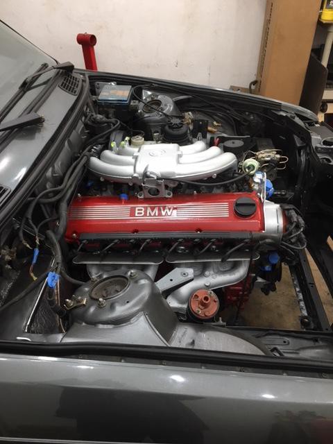

This took a few hours to set up but the load leveler made it much easier than I initially thought. We were able to install the engine and tranny together, with the charcoal canister and power steering pump removed. The harbor freight load leveler didn't allow for the flexibility I wanted but we used the moving blankets to help the oil pan over the core support and then some cardboard to help the tranny into the tunnel. Here's a picture.
My friends who made this possible! Now I have a lot of buttoning up to do...
