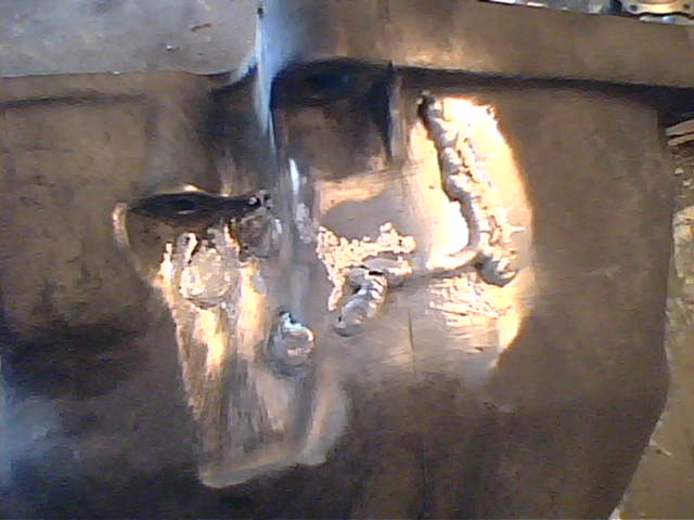

Actually, I did weld up the bell housing. I ended up counting 7 cracks (the big one and a number of other small ones that were barely noticeable) and the one hole. This was my first time welding aluminum. There is a VERY fine line between having too much heat, too little heat, not enough wire speed, and too much wire speed. It's a little tricky to weld, to say the least, so my welds definitely do not look good. I did go over them with a carbide burr bit to smooth them out.
Outside of the bell housing on the big crack:
Inside the bell housing on the big crack (you can also see the inside of the hole I had to fill):
Here is a picture of three of the small cracks that I welded over:
You can see two of them underneath the vin sticker on the bottom left side. You can also see one next to the bolt hole underneath the "Getrag" embossing.
I definitely need some practice with the spool gun to actually get the hang of it. You can see the difference in the way the aluminum welds, due to the retained heat, after you put down the first pass. You also have to have the aluminum as clean as possible. There can be NO oxidation on the aluminum due to the amount of heat it takes to melt the oxidation. The oxidation melts at like 3300 degrees and the aluminum melts at like 1200. If you have oxidation where you are trying to weld, it will "blow through" real easily due to the amount of heat that is going into the metal. (enough of the welding talk)Leave a comment:
