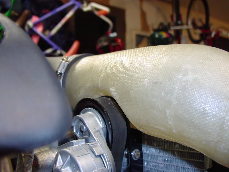

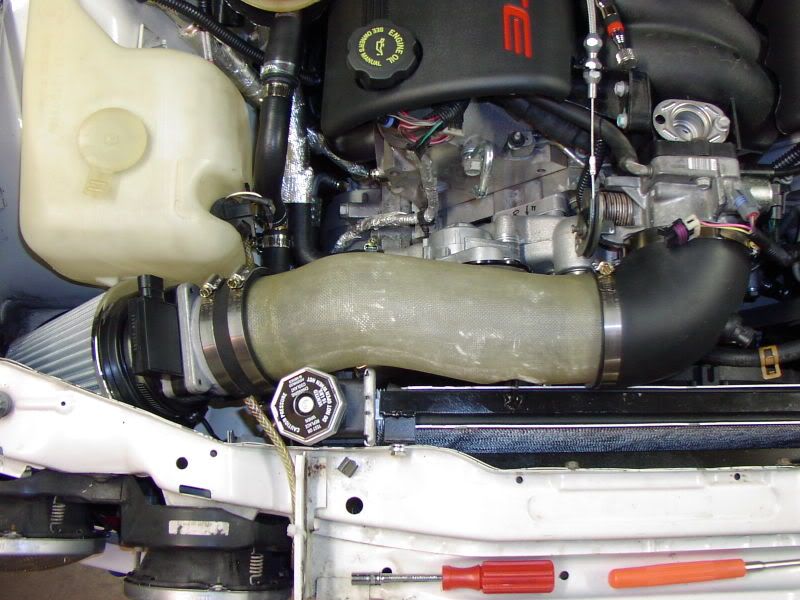

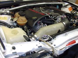

    Emissions Story: My dad took it over to state emissions on his lunch. They asked what type of motor it had and he said 5.7 L v8. Apparently they had a blank stare and then just entered that into their comps...haha. They never even opened the hood. IT PASSED EMITTING 5-10% OF THE ALLOWABLE FOR TEH e30!! lol... This was a HUGE relief for us.
    PICS!! Some are a bit old but whatev.
    The finished engine bay.
    Don't know why this one is so small...sorry

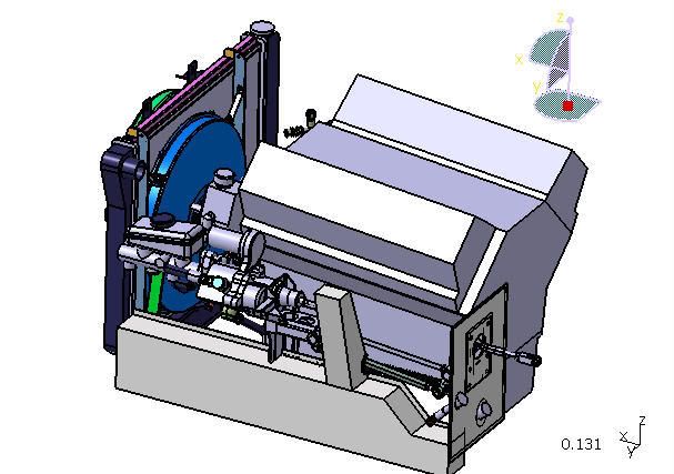

    One of many CATIA models...
    It's a LITTLE tight...lol
    FEA of the mounts. Failure is at something like 10g's ....so no worries.
