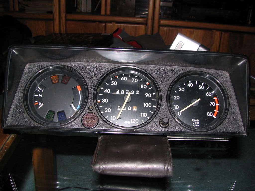

          OEM look would be the multi-meter in the middle, the tach on the left, and the speedo on the right...
          IG: @Baye30
          • Justin B
            Sikky Nar Nar
            • Mar 2005
            • 4273
            #50
            Cary, how do ya figure? Actually the way I have them set up there is they way it would be originally. Or as close to as possible anyway.
            This is the gauge cluster I bought off ebay some time ago for this project. I wont be using it all so it'll be for sale. :) It's really clean, that's just a reflection on the speedo glass.

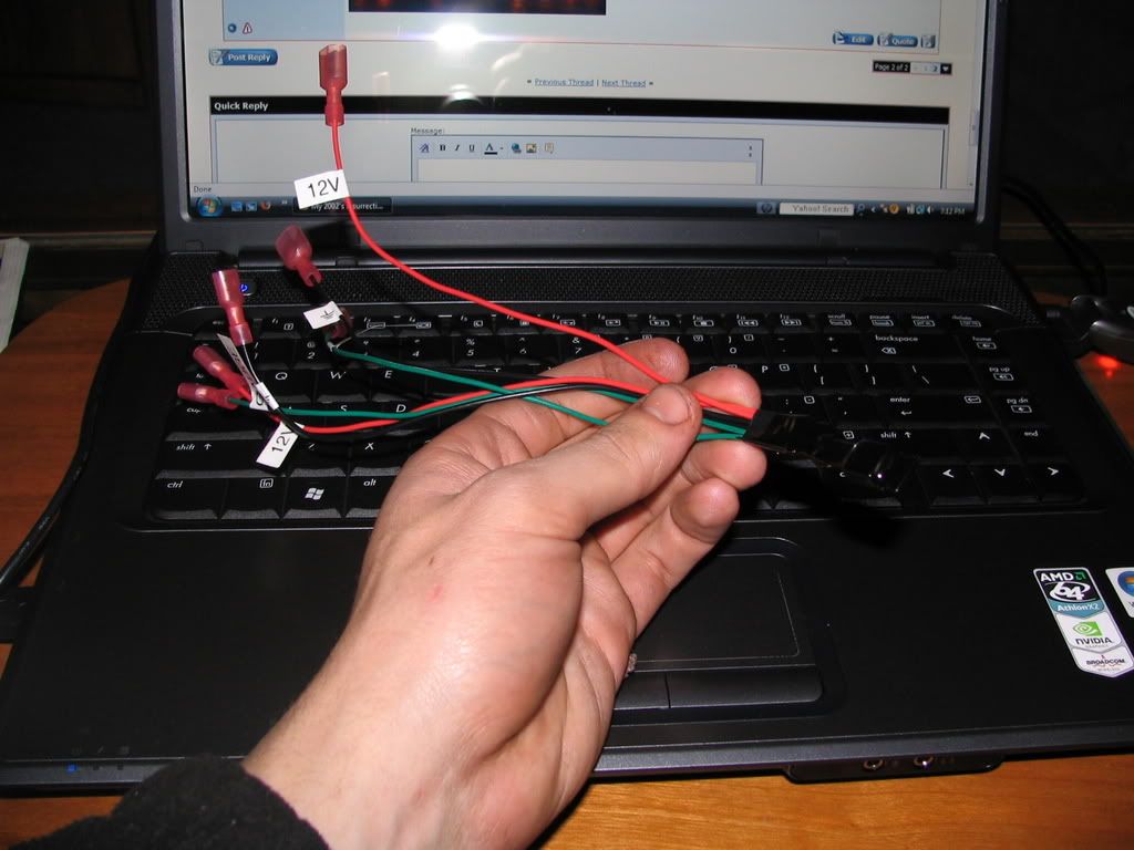

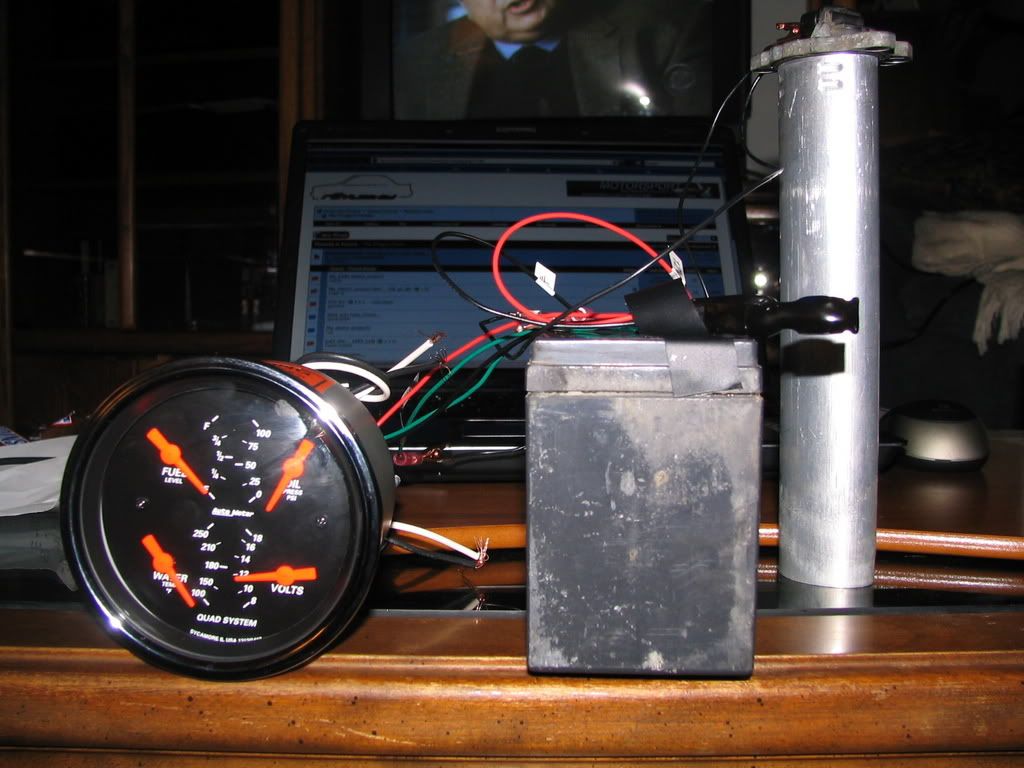

                  Well, I got a very simple circuit built that will allow the main e30 fuel sender (one of two, the one that actually goes in with the pump) to work with my autometer gauge. It's pretty damn close to perfect. Empty reads perfectly empty when reduced from full, but the maximum reading is about 7/8ths of the tank on the gauge. I can live with that though. Better than nothing at all!
                  I also removed the stock seat rails a couple days ago and conveniently cut my hand open in the process on a shard of metal. All the way through my skin on my ring fingers first knuckle. I only had troubles with two spot welds though that pulled through, so I have a couple little holes to tack up then I can get to it--probably tomorrow after work.

                      Just a picture, nothing special. Not much happening yet really. But just proving there really is something going on. lol.
                      More diagrams and mock ups to follow in the next few days while I think about how I'll deal with some issues regarding new seat rails, among other things.
                      Sender to gauge "Fix" circuit-
                      I kinda made it free form then dipped it a few times in liquid electrical tape. The components don't even really get warm, so I think that it should be safe enough encapsulated. Two resistors, a zener diode, and transistor...and a bunch of wire to fit it in the middle.
                      It goes-
                      Sender to Circuit at "SENDER"
                      Circuit to Gauge at "GAUGE"
                      Chassis Ground to Circuit at (GND Tree) M Spade
                      Circuit Ground to Gauge at (GND Tree) F Spade
                      +Batt 12v to Circuit at "12v" M Spade
                      +Batt 12v from Circuit to Gauge at "12v" F Spade
                      *+12v and Grounds are just Y's
                      Pics of the ever so interesting car without rails tomorrow maybe if its not pitch black when I get home ;p

                        Working picture of the gauge, I tried it about an hour ago and realized I put the thing together wrong. Somehow managed to put in a 3.9k resistor instead of 39ohm. Woops. Got that swapped out to what I tested it originally as and got this-
                        Looking straight at it, the needle is directly on the E line-
                        And this is "Full". Works for me-
                        There's actually one more tweak I can try, but I dont think it'll work right, or enough. Other than that, lowering one of the resistances closer to 0 just heats stuff up faster, and the difference in the reading height is exponentially less. I'm glad it reads empty properly, and pretty dang close to full without any heat sinks. A different transistor that has some sort of better suitable gain I guess and zener, I can always tweak it and try different parts down the road. It works for now. Good thing it's just something that plugs into the middle though.
