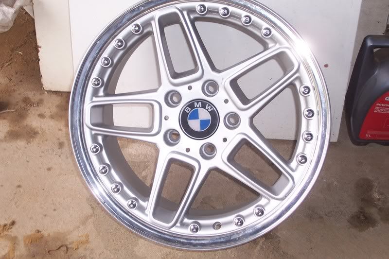

Still loads to be done, but the next step is to get the rims and tyres (Ac Schnitzer 17x8 omn 235 40 tyres) and the front coilovers done so that the car can be sent it to get it's custom made rivet on fender flares done.
