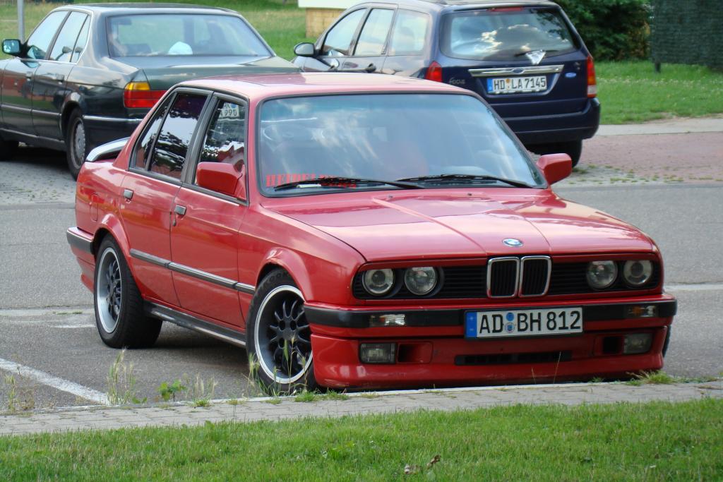

    Ok So I Found A 1988 535i TO TRANSPLANT ITS 3.5 INTO MY E30 Still Runs Smooth Doesn't Smoke, 5 Speed Trans...paid The Guy 700 Euros Drove It Down To The Shop And I Finally Get To Start On The Swap Tomorrow....:d Can't Wait To Pull The Motor And Tranny And Get To Work....gotta Love The Germans.....they Think Anything Old Is Junk.....damn Shame To Let This Drivetrain Sit Unused .....hehe Click image for larger version

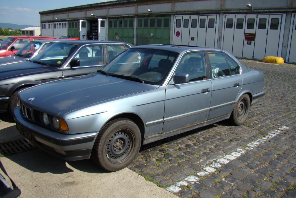

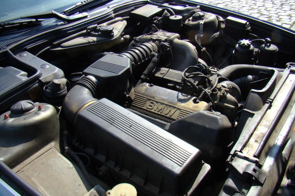

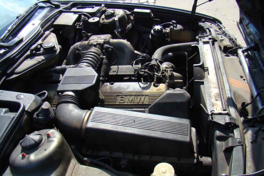

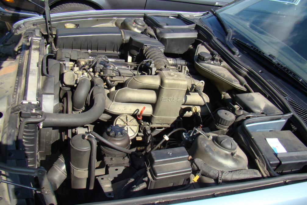

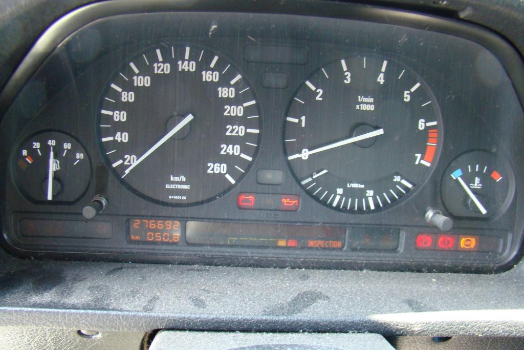

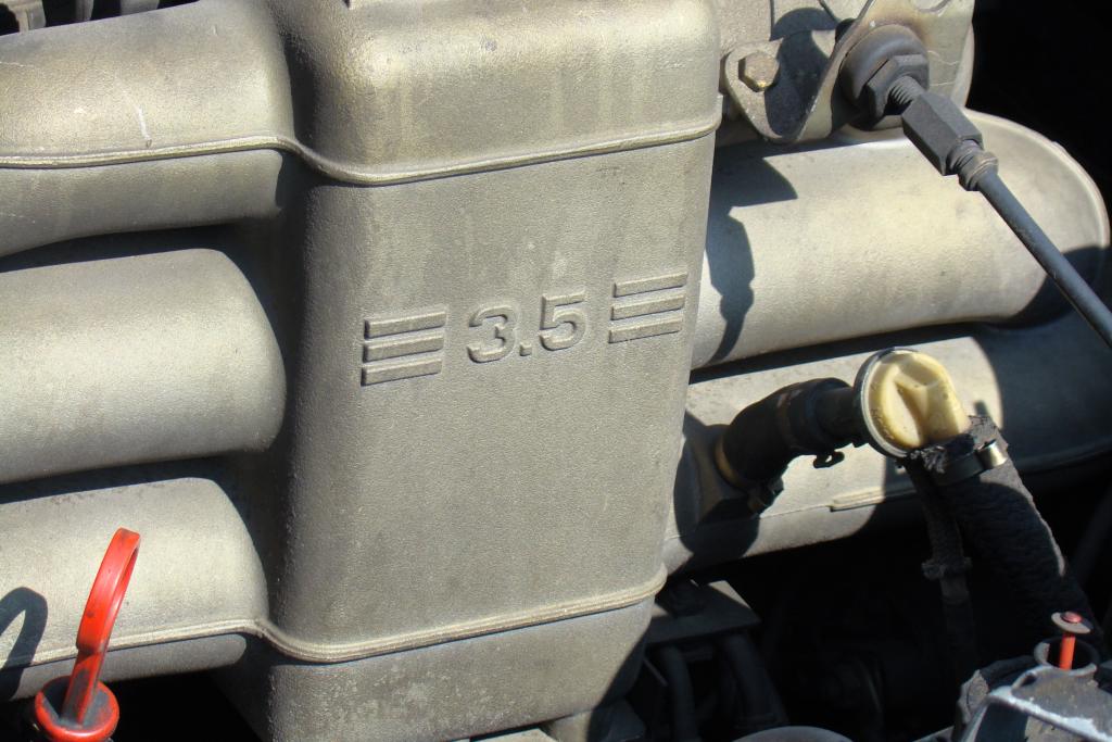

ID:	7107238ok pics of donor car this is a 1988 535i both cars are Euro spec....for now......update.......12 jun 08.........ok well this motor is ready to be pulled tomorrow....just have to disconnect one of the slave cylinder hydraulic line, motronic and wiring harness are pulled from the body....so tomorrow i'll pull it and start to clean it....this weekend i'll pull the head and send it to the shop for port and polish, new valve train and to decide on a cam.

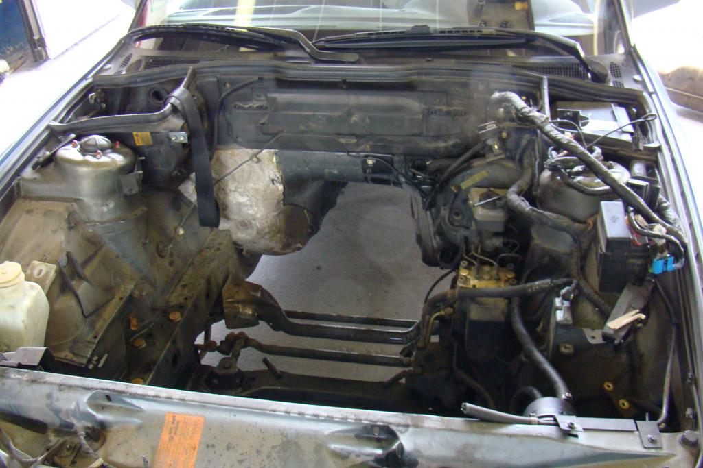

            • ghonarea318i
              • May 2008
              • 91

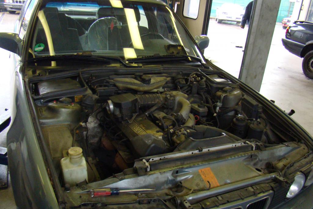

              status: getting there
              ok now it's friday 13 jun 08 motor and tranny are pulled obc and wiring harness are out downpipes are cut and car is back out of the shop.....i'll start the cleaning probably monday...due to german law i have to take it to the local oil change place to have it steam cleaned versus cleaning in the shop....how gay is that well here's a couple pics from this morning....Click image for larger version

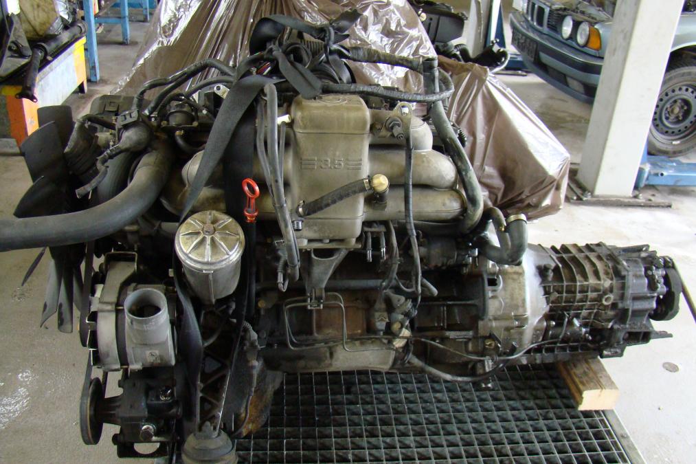

              • ghonarea318i
                • May 2008
                • 91
                It Figures!!!!!

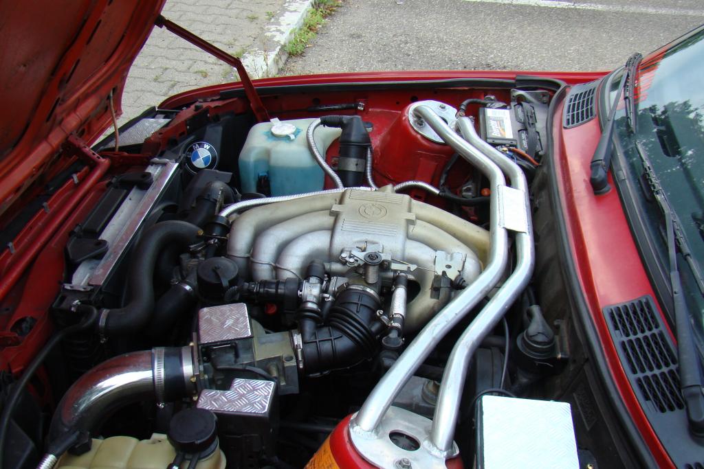

                Ok Well As Luck Would Have After Looking For 7 Mos For The Right Priced 535i Donor Car 1 Week After Buying The Donor I And 2 Days After Pulling The Drivetrain I Get A Call From Someone Who Has Already Done This Swap And Got Hit In The Rear!!!!!!! Oh Fortune How You Mock Me. Anyway So Tomorrow I Pick Up His Drivetrain....mounting Brackets And Driveshaft Included For 300 Euros.....:d So I Might Be Rocketing Around This Weekend Cant Wait! No More Opening The Hood And Seeing This!!!! [ATTACH]12469[/ATTACH]
