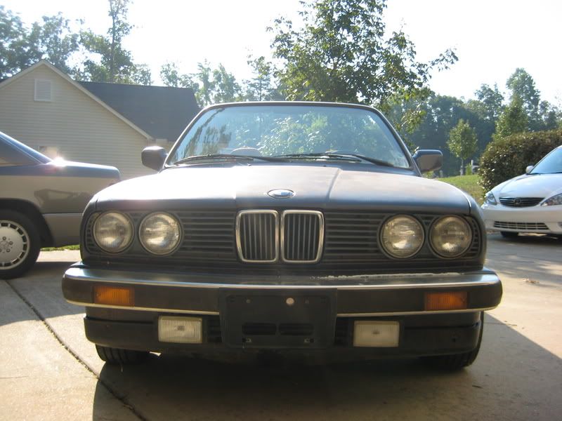

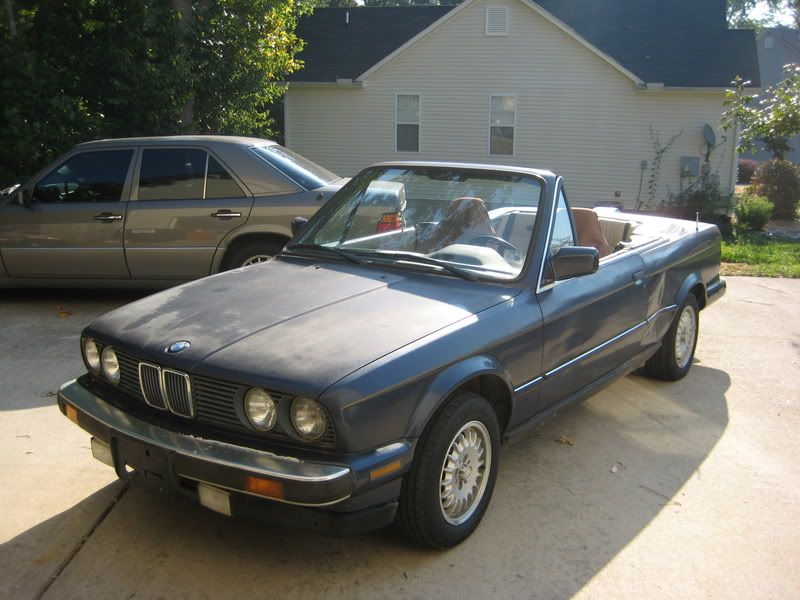

    I had a thread in GD awhile ago but I figured this was the better forum for keeping track of what had been done. SO I present to you my $500.00 project car. My daily driver is either my 97 honda 1100cc motorcycle, 91 MB w124, or 06 camry. They wife usually drives the camry as I hate the feel of it. I prefer german cars personally :hitler: . I have already read so much of this forum I think I ended up with more questions than when I started.
    Goals:
    1) Mechanically solid first!
    2) Repair body damage and get plastic bumpers
    3) Paint it back factory color
    4) Update the interior and stereo
    5) Convert to 5 lug and update the suspension
    Completed:
    -Brakes/Rotors $150 installed
    -Set of used tires for the moment $60
    -Throttle body boot(I think that is what it was called). It was cracked and caused the engine to stall if it sucked in air. $20
    -Rebuilt Transmission $500 parts and labor installed
    -Flushed every fluid and replaced every filter $120
    -Timing belt/Water pump/Pulleys/Gaskets/Seals/Fan clutch/Thermostat $480 parts and labor
    -Converted AC to 134a $21

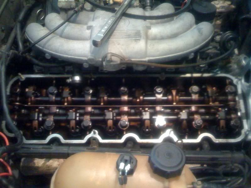

    -Found crack in valve cover - replacement bought from here $30 shipped
    Total: $1881

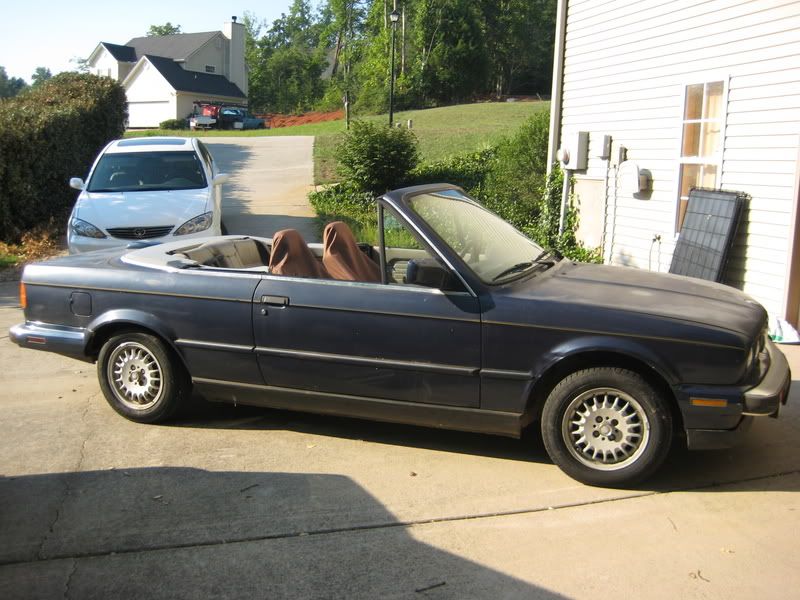

        You definitely started off the right way by taking care of the major maintenance and mechanicals first. The paint condition looks to almost exactly like the '87 325is I purchased last week-nice and faded!
        Great find for $500 and you are off to a good start. What condition is the top in?
            Laughable :( I've been watching for a good deal. The frame seems to be in good shape though. Also looking for a hardtop but that is on the bottom of the list. Once I have this car mostly done I intend to sell the w124 and take a roadtrip to wherever the hell I can find a top from. Hopefully far far away LOL!

              nice seat covers :)
              Free! Just using them because the current seats are NASTY. My wife steers it in and out of the garage and it was the only way I could get her in it at the moment!

                Looks a little worse off than my old vert when I got it back in 2000. But same color - royalblau over pearl beige.
                If I could find one for $500, I'd pick it up in a heartbeat.

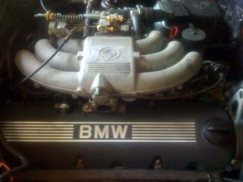

                  *Update!*
                  I finished up replacing all the hoses for the cooling system. I also received my new valve cover compliments of e30this. Good seller and prompt shipping! I cleaned it up, painted with high heat grill paint and sanded down the lines and logo, and got it installed.
                  After taking a test drive I know that next on the list will be shocks/struts/springs. I was hoping to wait on this but I might as well do it before I begin the body work. Off to list more junk on ebay LOL.
