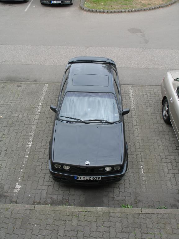

    So what im starting with is a 1990 325 mtech i got for $500.
    whats wrong with it?
    Brakes
    rear subframe bushings
    ball joints
    diff bushing
    trans output
    front main seal
    shocks and rear springs are sagging
    diff output seals leaking
    whine from rear end ( sounds like the hubs?)
    broken driver door lock
    The other day i ordered all new OEM replacement parts to fix most of the above, besides the door, what i upgraded was,
    brembo rotors
    hawk HP pluss pads all around
    red line trans and diff fluid
    IE strut tower brace
    knockoff "chettah chip" off ebay
    cone air filter+ heat shield
    Next paycheck will be IE stage 3 springs and bilstein shocks :)
    I also have a 2.5" muffler, im gona make a custom manifold back system, no cats.
    Then port heads, intake, throttle body
    Im trying to keep it on a sub 2k budget, including the vehicle cost. Ill see if i can sneak a cage in on the budget...
    This weekend, timing belt, lash valves, oil change, flud check. Nurburgring learing laps.

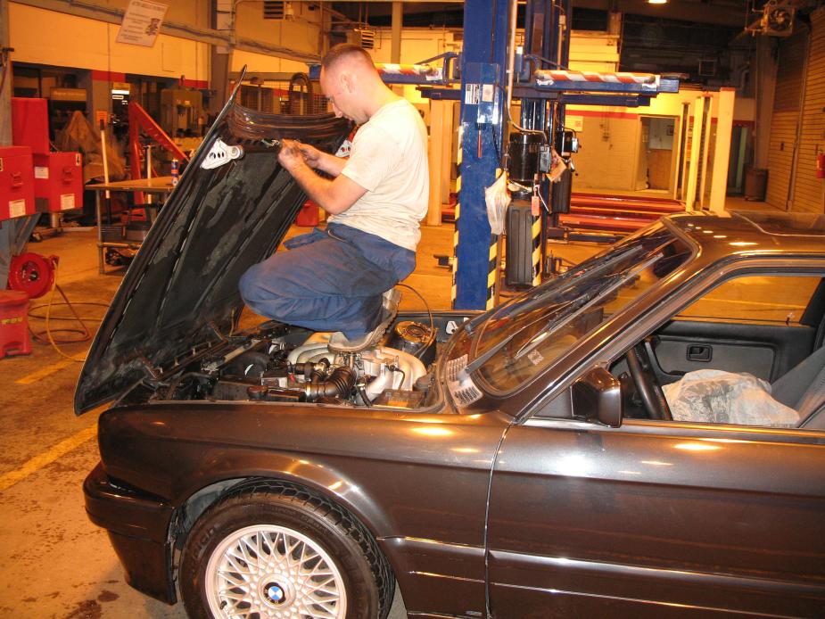

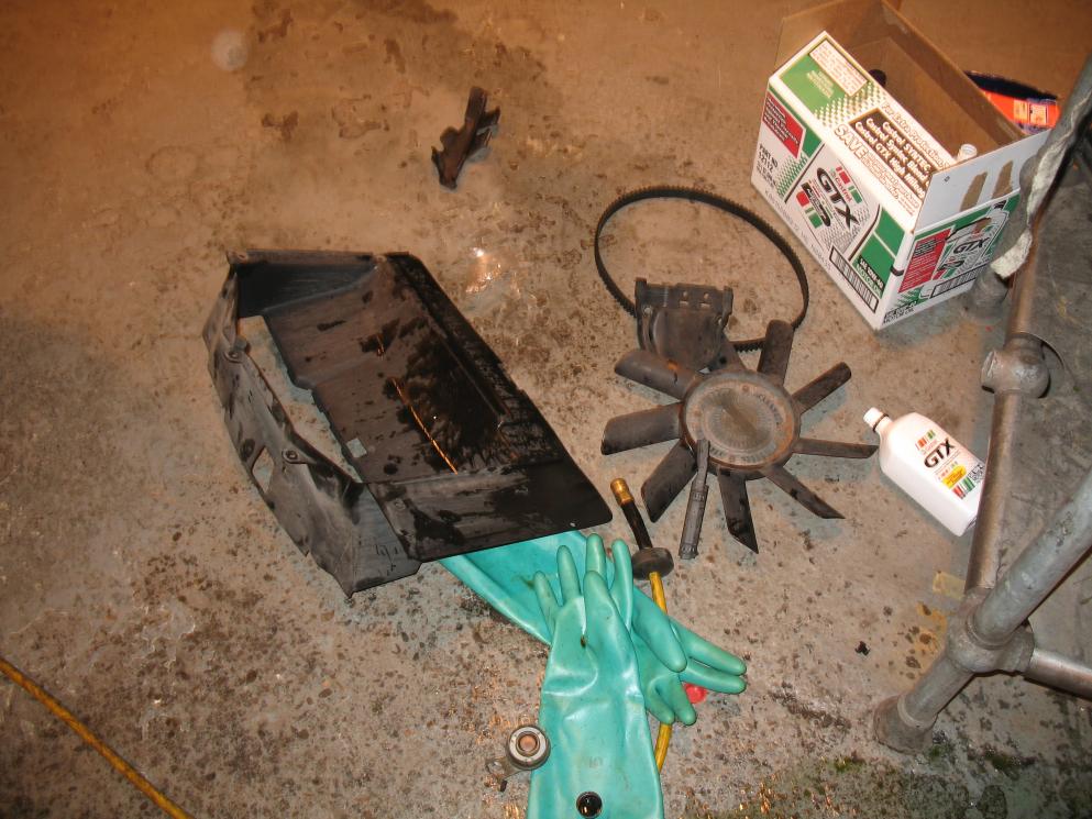

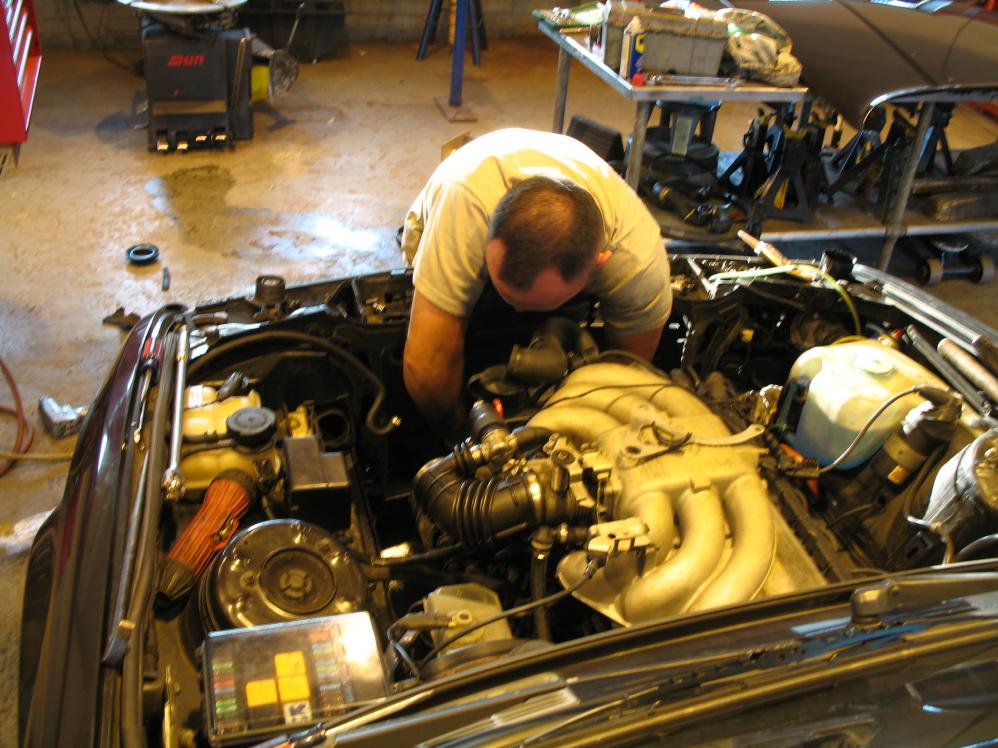

        I put in the new timing belt, water pump and oil change on friday with Yan. We did it all in under 4 hours. I pulled out allot of usless crap like the radiator fan, shroud and piceces of plastic that were useless. We utilized the 10% rule, 10% of it is garbage anyways so its ok to have extra parts when ur done :) I cleaned up the distributor and rotor,, man was there nasty carbon buildup!! It runs allot better now, pulls harder for sure. And it still runs cool as hell with no fan.
        We also pulled the ABS comp, abs light and check light. Does any1 know how to disable the abs without making the check light go off on a 90 325?
        I got a new problem now thou, last night coming back from the BMW museum my car wouldnt shut off, my ignition was stuck on. But my tumbler would move and key would come out... hopefully it wont happen again. Mabey spray some silicone lube into the keyhole.
        Also my exhasut is seriously faliing off now, we had to wire it up 2x on the trip to munich so im doing that this week. Catless single 2.5"
        So far i spent about $900 on it but i havent got the $800 in parts from BMA yet. Yan said he might sell me his barley used bilstein sports and IE stage 3s for a steal so i think im gona go that route.

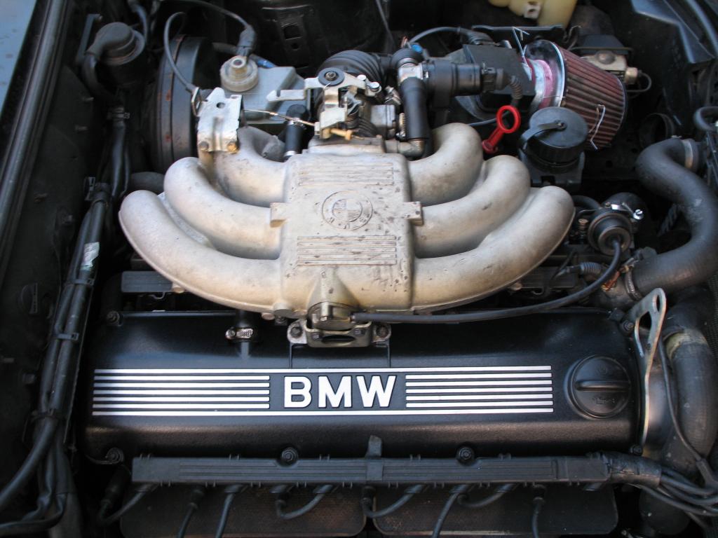

                    I put a ghetto ass cone airfilter on today, sounds nice but i dont feel any more performance. Then again i also picked up a bunch of extra parts from a friend and i had a full tak of gas when i romped it.
                    I got another intake manifold, tb, and head so im going to start looking at where i can port out. I already have the die grinder and all the works. The exhaust ports on these engines is so restricted!! Only thing is i dont want to get too much into messing up the fuel ratio by porting the crap outof it, i dont want to mess with the engine tuning.
                    Im going to make a heat sheild tomorrow that routes cold air from nexto the radiator, and i think my chip came in the mail!! Then finally get this thing on the track for its maiden voyage with me.
