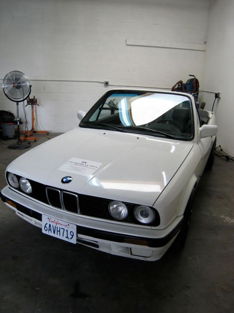

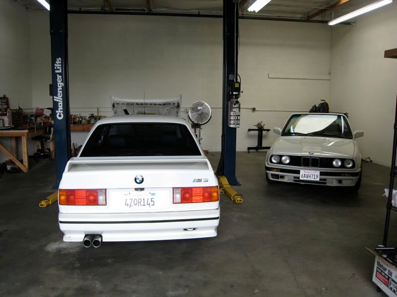

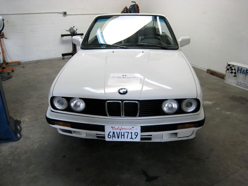

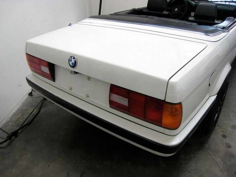

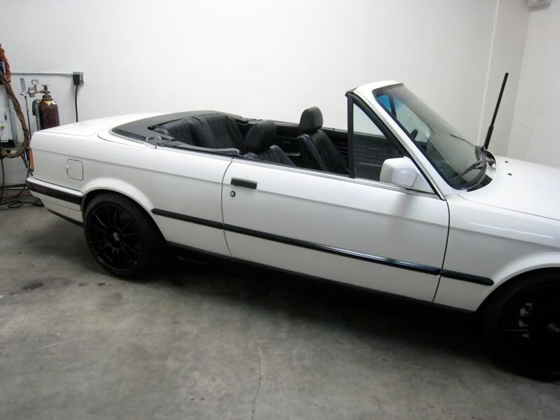

                            soo this thing was one of two "featured works in progress" at the swap meet at e30motorwerks in HB last weekend. it was tucked behind Colin's M3.
                            robert did a great job detailing it in preparation; replaced the roundels and some of the side trim and painted the grills and i'm not sure what else off the top of my head. it's looking almost ready though, and has come quite a long way since i picked it up last year.
                            various ppl's pics of it:
                            liked these 2 shots, it was a lucky thing both cars were Alpine, made for a clean display
                            interior in the car still needs attention, but robert has put a moratorium on buying anything more for the car, i think he kinda wants it gone after over half a year ;)
                            the straight-pipe exhaust got noise complaints from the gf so i picked up a resonator and a muffler for it. that has to be done, there is a new MC ready to go in, and a new stereo setup, and it should be pretty much ready to deliver after that.
                            i'm 95% there on the turbo setup, but that's going to wait until after i get home, and my orders have been extended, and i've also been slotted for yet another MOS school after deployment, so that might not be till next year.
                            oh yeah, our new (to us) E46Xi was there as well. the gf loves it. we're planning on moving to somewhere in the Reno area, i am looking forward to flogging it a little when the snow starts falling :D
                            btw, everyone who commented on the tokicos... they're apparently stiff enough in transient response to cause noticeable chassis flex in a 'vert, which necessitated the purchase of the Mason chassis reinforcements. just sayin'. i may look for a hardtop too, as people whose opinions i trust say that also helps that issue.
