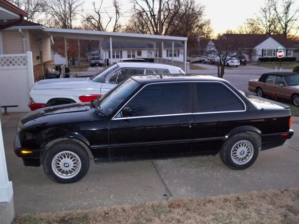

Hello all i have a 1989 325is black on tan, and it had motor problems so i pulled a motor from another e30 and had the head rebuilt and then was going to build the block myself. After some research i decided to last minute after buying all the parts for the rebuild to go with the m50, because i got a good deal on a e36.
alright in the beginning
This is the car the m50 will be going into.
