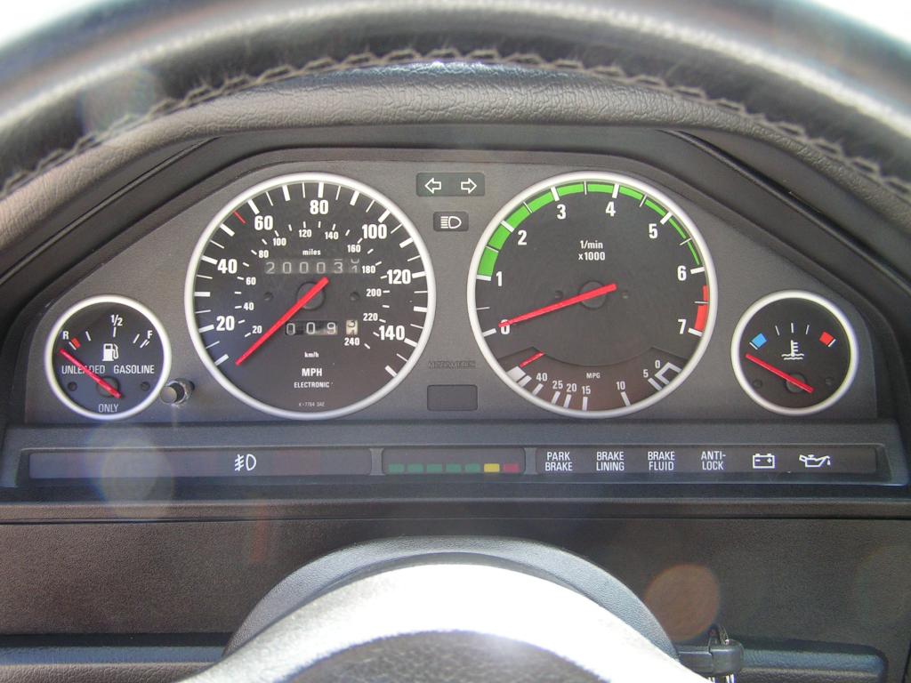

    ...and now to continue from the previous update post.
    Like I said, I decided to use a paint pen to see how it would work. I taped off all the gauges and cleaned the needles with acetone (nail polish remover actually) so there wouldn't be any contaminants to mess with the paint.
    The painting began. Ignore the wife's wish list, it made a nice place to get the paint pen flowing.
    You can see that the paint pen didn't make it all the way down to the black circle, so I had to improvise and used a toothpick to get all of the white covered. The fine point allowed me to paint all the way down.
    Two more coats were applied.
    The flash time on the paint is pretty quick and after it dried, I removed the tape.
    Speedo came out pretty good...
    As did the other 2 smaller gauges...
    A little leakage on the fuel gauge though. Luckily it blends ok with the black...
    And finally the tach. The econometer needle is a pain to do but I think I got most of it...
    I was a little disappointed with how this came out. I like the color and from a distance the needles look good. When you get right up close you can see some blemishes. That part made me a little sad but overall I'm pleased with the results.
    And now reassembly...
    For the plastic, I used Plexus glass polisher. I used Plexus on my faceshield for my motorcycle helmet and was pleased with the results. The plastic was in decent shape so I freshened it up a bit.
    So ends the refresh. It's a decent project to do yourself but don't be afraid to consider someone like Guten Parts or the like if you don't have the patience. For the most part I'm pleased.

  • jackbenny
    replied
    Cluster Foxtrot
    With the cold weather and laughable "snow storm" we received this weekend on the gulf coast, I decided to spend some quality time inside the warm house and work on my instrument cluster. I had performed some work on my original cluster, adding trim rings, replacing the SI board, changing the odometer gears and painting the needles. But the speedometer never worked and the tach started working intermittantly.
    About a year and half ago, I acquired a supposedly working cluster. It was in a bit nicer shape than my original cluster so I decided to transfer over all the good parts and repaint the needles.
    The first step was to take apart the original cluster in order to raid it for parts. There are plenty of write ups out there for this and they are all great.
    I had a brand new SI board in that cluster so I pulled that bad boy out.
    Success!
    I now focused my attention to the trim rings I had installed. These are the brushed aluminum kind and I picked them up off ebay a couple of years ago.
    They eventually popped out with some persuasion.
    The cluster was disassembled further to get the odometer gears and to take a look at the tach.
    The other cluster was also disassembled in the same manner. Note the fact that this cluster has both of its mounting ears. The trim rings were reinstalled on the new cluster.
    As I took apart the new cluster further, I had some difficulty taking the speedometer out. hmmm, this cluster has a plug that my orginal cluster didn't have. Could this be the source of my non-functional speedometer?!?
    With the speedometer removed, I began work to transfer the new odometer gears to the new cluster.
    All the good odometer gears removed from the old cluster.
    And all the gears removed from the new speedometer. The new gears are not compatible with that brass nub so you have to remove it. I used some wire cutters I had laying around and snipped it off.
    Then the new odometer gears were installed on the new cluster's speedometer.
    I had a choice of two colors for the needles: red or orange. I decided to paint one of the old cluster needles to see the difference. The wife liked red, but I preferred orange.
    The taping of the needles began. I used paint pens this time to see if it produced different results. Sadly, it seems those pictures didn't upload last night so ...
    ....to be continued...
