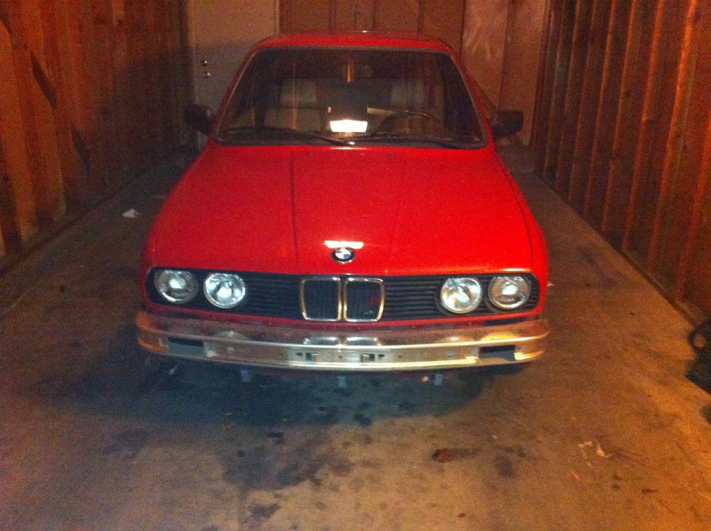

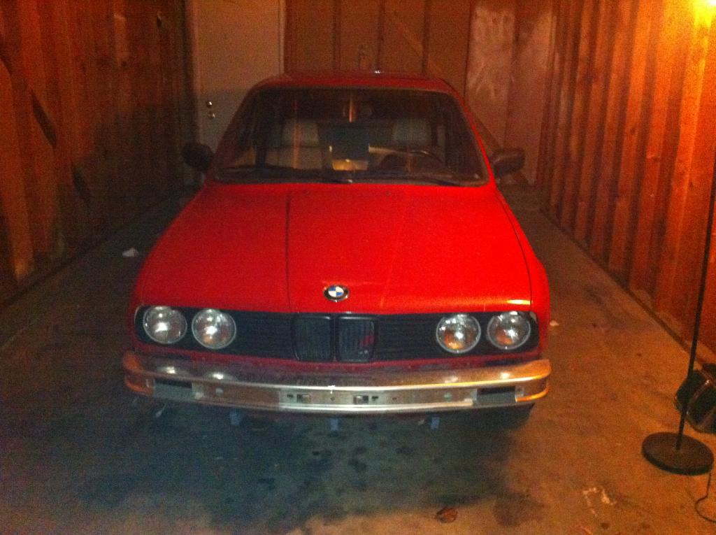

                        Before:
                        After:
                        Crappy pictures, but what you should see is Euro smilies, Euro grill, and chrome kidneys!
                        Now I just have to find Euro bumpers and an M-tech 1 kit.
                        The high beams have to be adjusted, but the studs are really rusted and won't move. I think I'll just replace them with long bolts and try to make that work. Also the wiring is not hooked up yet.
