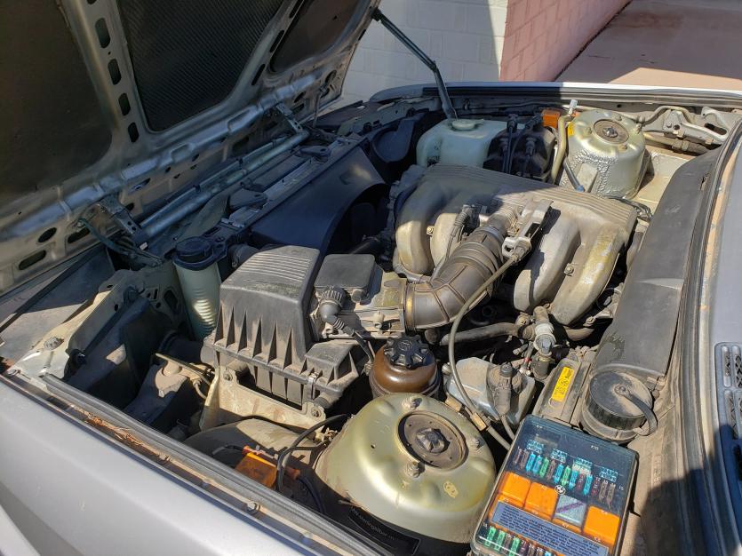

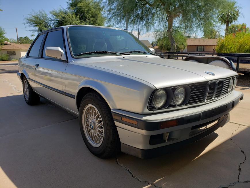

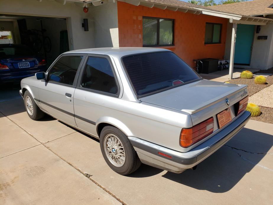

    The 318is seems to be in pretty good shape… 149k miles when I bought it, lived its life mostly in Utah and Arizona, so I haven't found much rust. Paint is in OK shape, with several pretty deep scratches that I'm hoping won't require repainting the whole car to correct. Except for a cracked dash, the interior is in good condition - the cloth sport seats were reupholstered by the PO and look good. The car runs pretty well, shifts smooth, and has functional AC that has already been converted to R134. That said, it still needs quite a bit of work, particularly in the worn-out suspension and maintenance items for the engine.
    So I think my goal is to leave it mostly stock, while cleaning up the body and interior as much as I can, and addressing all the deferred maintenance that has accumulated over 28 years. I already have a truck that I can DD and a race car, so I really just want to have this as a fun commuter and weekend car. I'll do a few mods and updates, but want to maintain the original character of the car as much as I can.

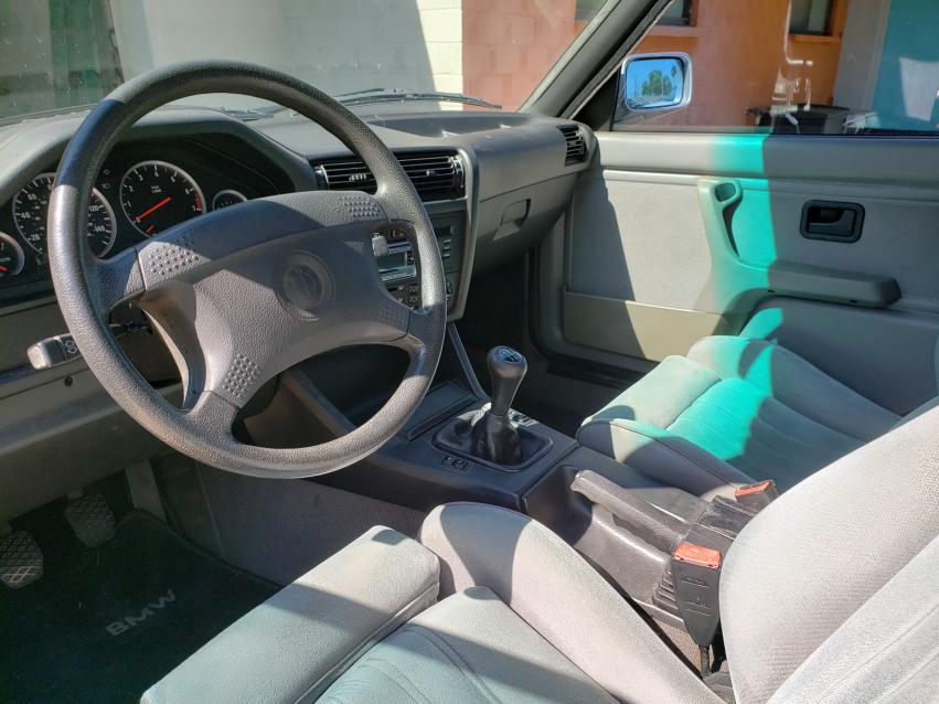

    Couple more photos to show the starting point:

      Welcome to r3v. Clean car!
      Hit those rockers with some black spray paint!

      Looks like a nice purchase! Sounds like you have a good plan of attack on the maintenance items which will also help you learn about the car. Seems like a little elbow grease and some cleaning products will get that thing looking fresh.

        great find! when was the timing belt last changed? get to it... sent from hell using tapatalk
          M42 has a timing chain. Though dropping the lower oil pan to check the upper bolts and for pieces of timing chain guides wouldn't be a bad idea.
            I have a pile of service records from the PO. It looks like the chain guides and tensioner were replaced about 5 years and 40k miles ago. What's the service interval for the guides and tensioner? It sounds like I don't need to worry about replacing the chain as long as the guides and tensioner are serviced regularly, correct?
            The lower pan is leaking like a sieve, so I will be pulling that fairly soon. Debating whether I should just do the upper pan gasket at the same time.
            • Garemie
              • Dec 2018
              • 107
              I would suggest doing both upper and lower pan if you're in there. You'll have to unbolt the motor mounts and lift the engine up about an inch to get the upper pan out, in my experience.
              EDIT: Can you post more pics of the cloth interior? I like the way they were reupholstered. Were the door cards also done?

                Yeah, seems like both pan gaskets would make sense. Do I need to buy some sort of support to raise the motor up? I don't have an engine puller.
                See my update below for more pics of the seats. The door cards are apparently original, as are the vinyl side panels on the seats. Only the cloth was reupholstered according to the PO. He said this is the shop that did the upholstery work:

                You can use a come-along to a rafter in the garage, tree, etc. Not pretty but it works in lieu of an engine hoist. Thanks for the update! I really like this car and it's great to see the transformation already happening.
                Remember to unbolt both motor mounts and only raise it 1-2" at most as needed, you will figure out the best way to get the pan in and out of there, it's not fun but it can be done.

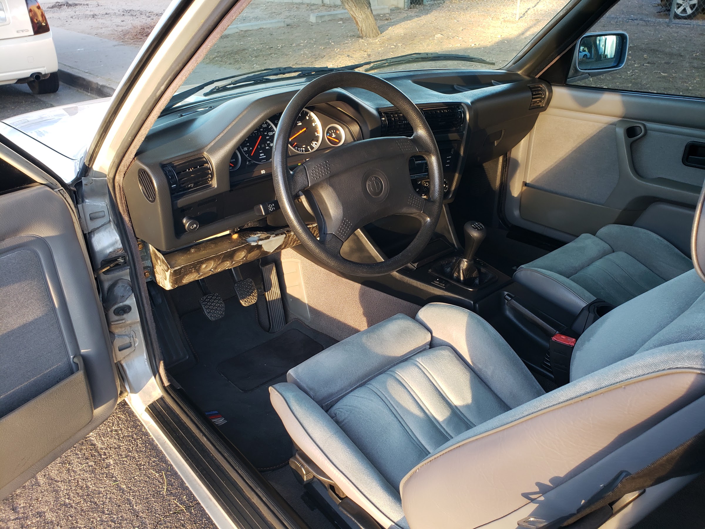

                  It's been a few weeks, but that's mainly because it took quite a while to replace this dashboard, and I've only had an hour here and there to work on it. Here's the latest progress:
                  -Crack-free Euro dash courtesy of 70ccrossi
                  -Replaced front speakers with new Focal RCX-130
                  -New shift knob
                  -New window circuit breaker switch
                  -Gearshift center console cupholder
                  -New floormats, rescued from my 135i before it went to the scrap yard
                  -Fixed a bunch of minor issues in the dash with loose bolts, etc.
                  A couple pics of the newly cleaned up interior are below. The dash looks fantastic! It has a lot more insulation around the HVAC ducts than the old dash. I read somewhere that this might mean it came out of an M3? Is that true?
                  Note the missing kick panel - the new dash seems to have a different attachment method than my old one. Whereas the factory dash had sheet metal screws attached to little threaded clip/tab things, the new dash just has slots for what I assume is a quarter-turn fastener, similar to the forward center console. I did a little research and ordered these guys to re-attach the kick panel. Hopefully they work.
